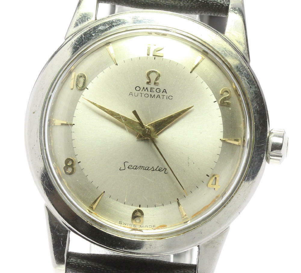

I have serious doubts. The font looks weird (the hangar S, the clinched m, well, everything is just slightly off. Also: A sunburst finish on an early 50s SM?
My vote is for redial.
10,125
57,950
Definitely a redial. The "S" in Seamaster isn't even close and the rest of MtV's comments are spot on.
