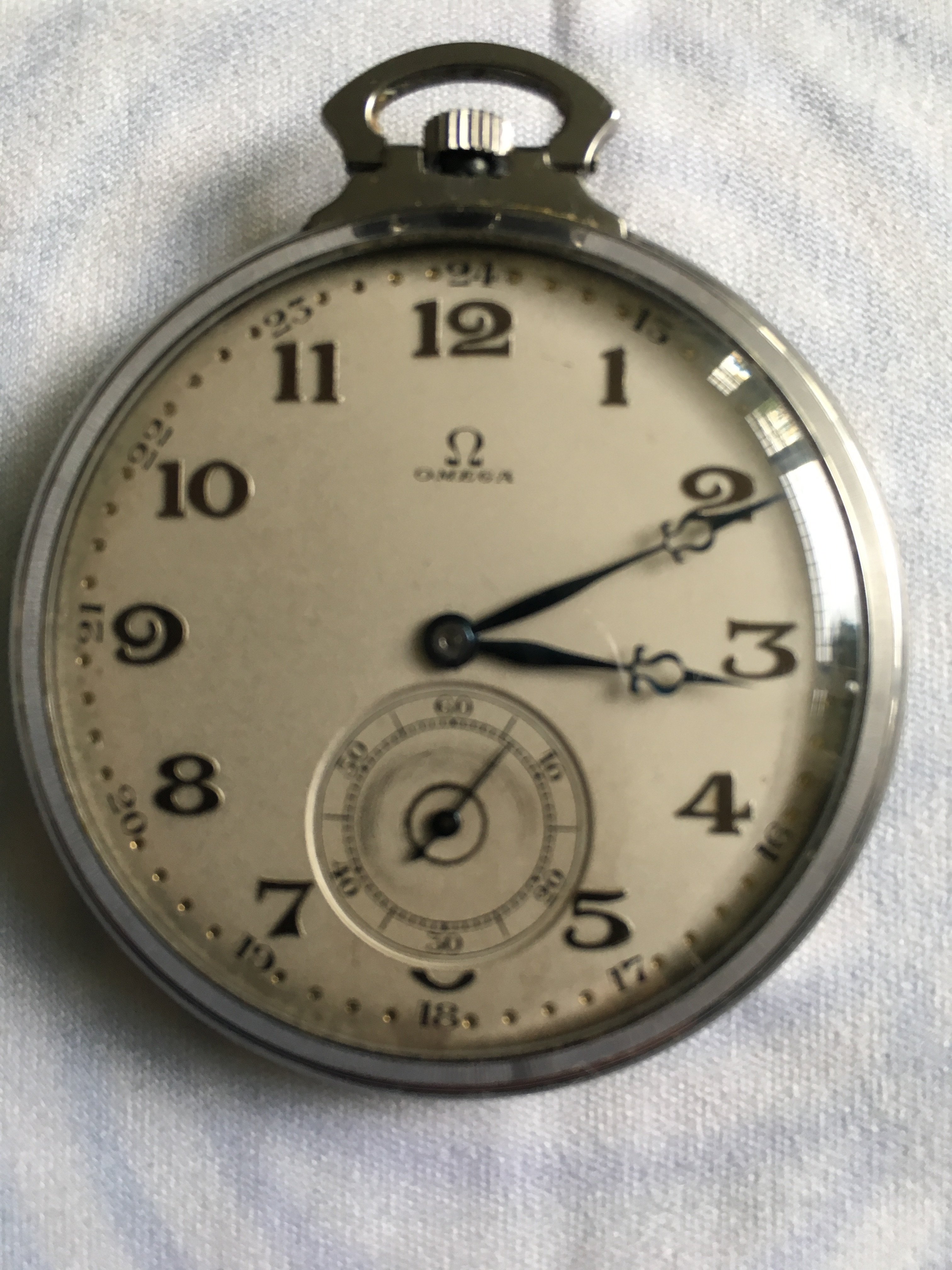

Please help to identify this vintage pocket watch
2,845
9,196
Thanks in advance if you can give me more info.
Best Hans
Can you give us more info first?
18,153
27,444
Can't ID without a movement and caseback shot.
1,531
1,087
I would guess it has a 35,5 or a 37,5 caliber. But we need pics of the movement and of the inside of the back.

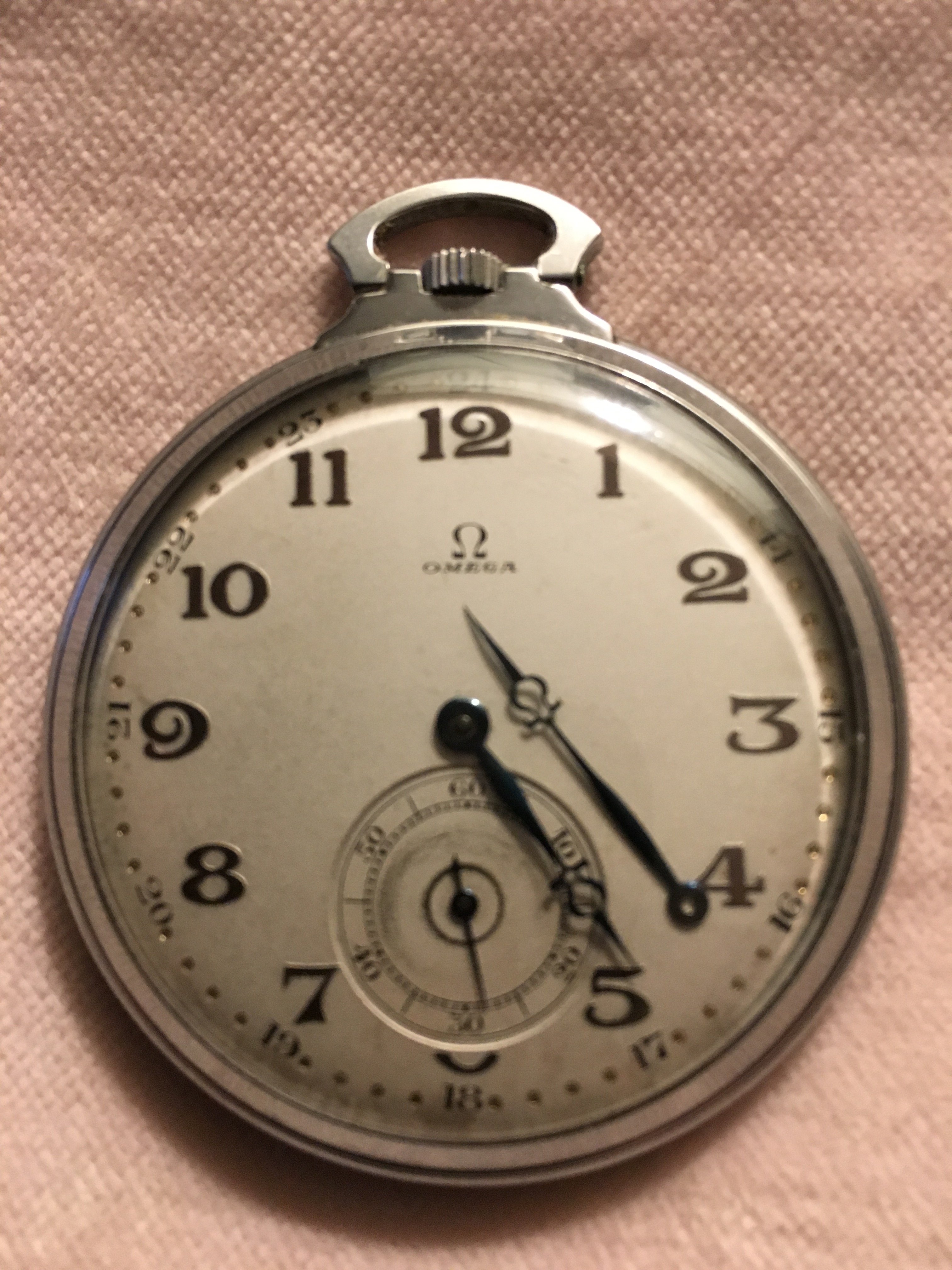

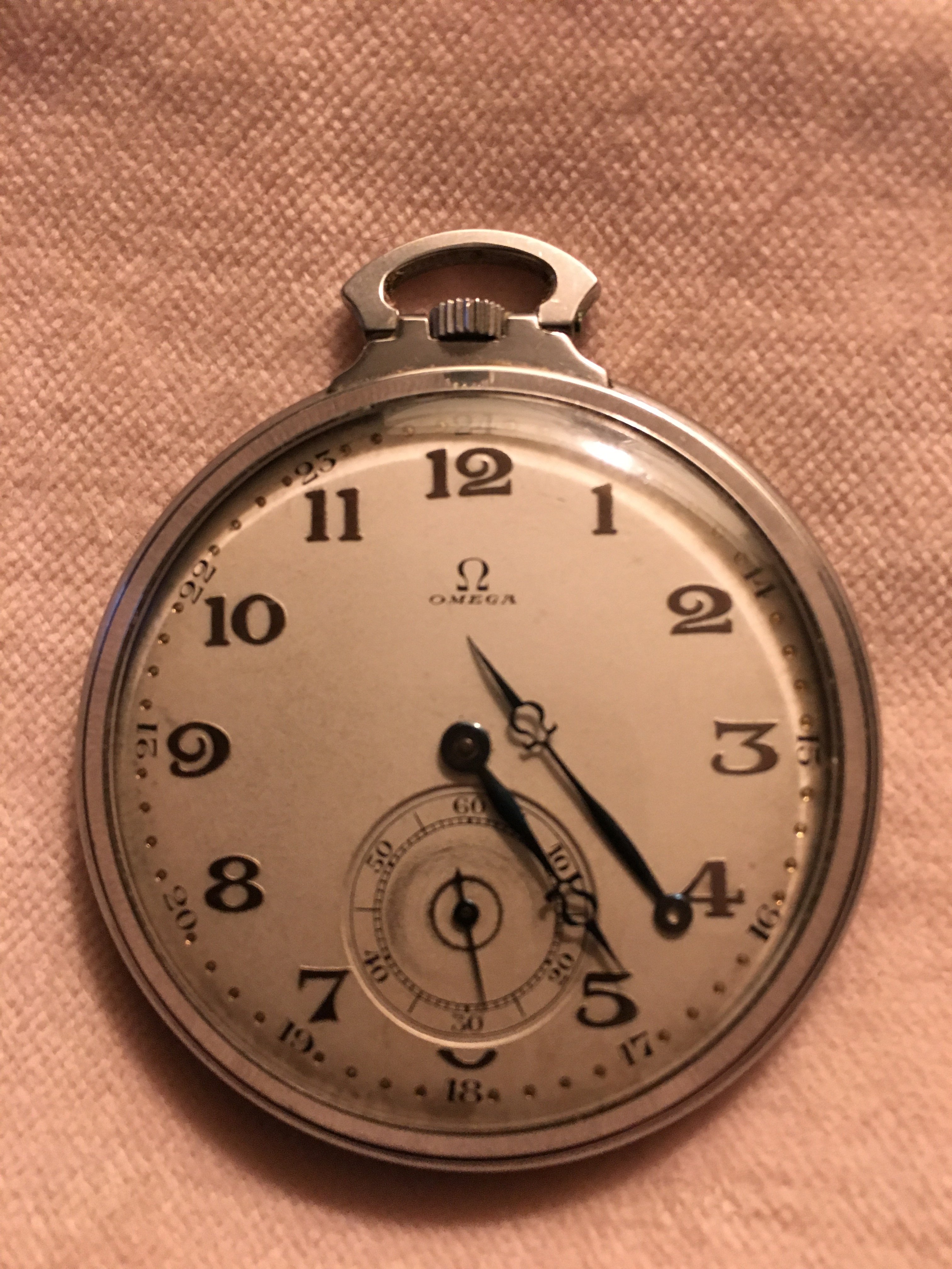

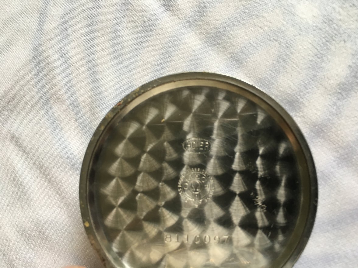

Hi folks,
Thanks for your help, find here some more pics. Serial nr 8110097.
The dial is fixed now!
1,531
1,087
So definitely a 35,5 shape. Depending on the size, it will be a 35,5 or a 37,5 - or a 37,6. It is from the early 1930's.
I like these movements, which are the pocket watch analogs of the 26,5.
4
It's dated 1935 according to chronomaddox.com. Any idea of the value?
1,531
1,087
These serial numbers are useful, but you cannot be sure of the exact year - that is why I said early 1930's.
This is a nice watch, in particular with these Omega shape hands. But, like many standard pocket watches, it has more value as a collectible watch than as a commercial item...
