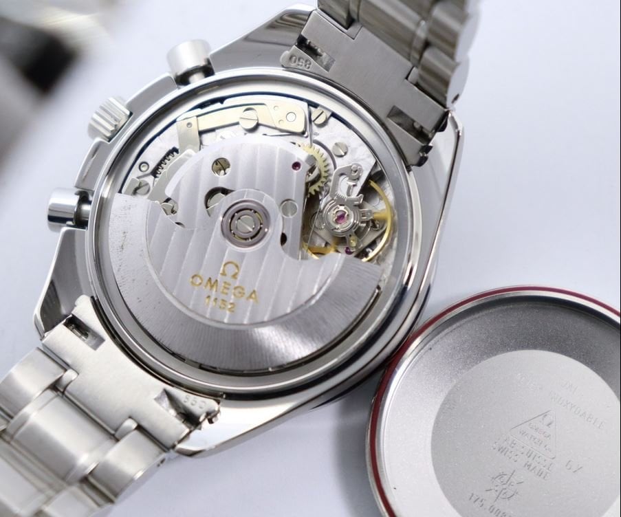

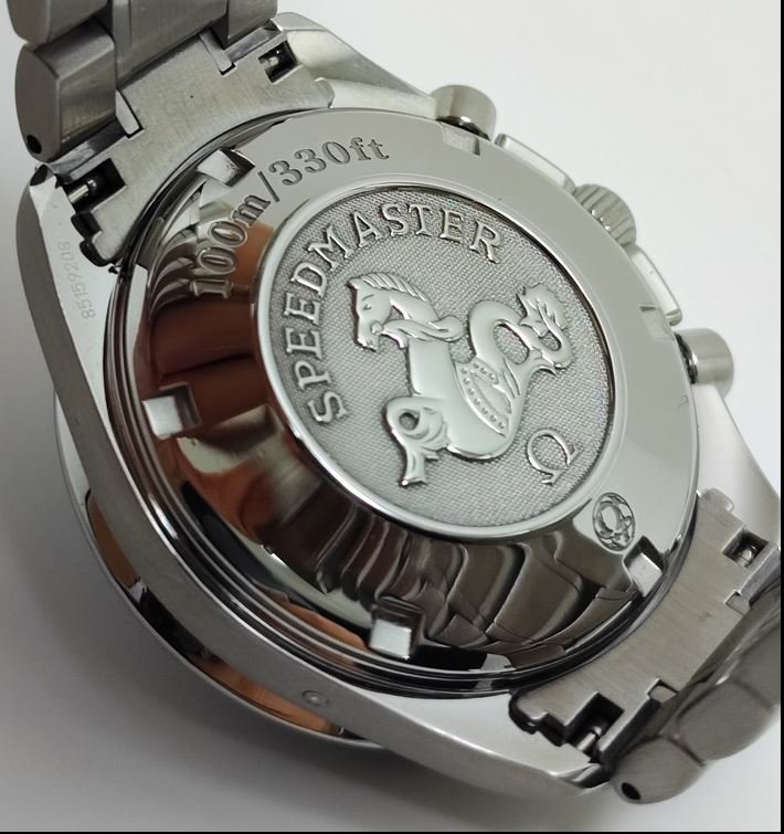

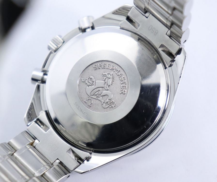

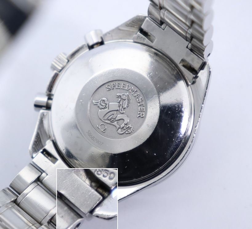

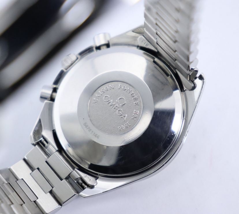

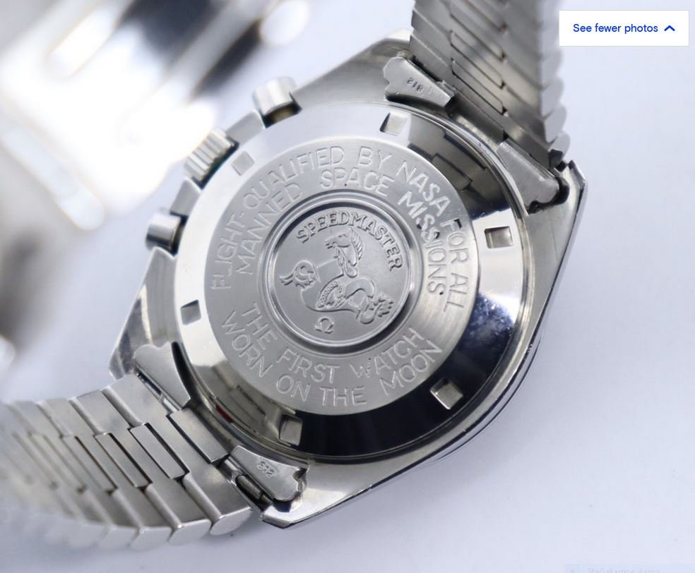

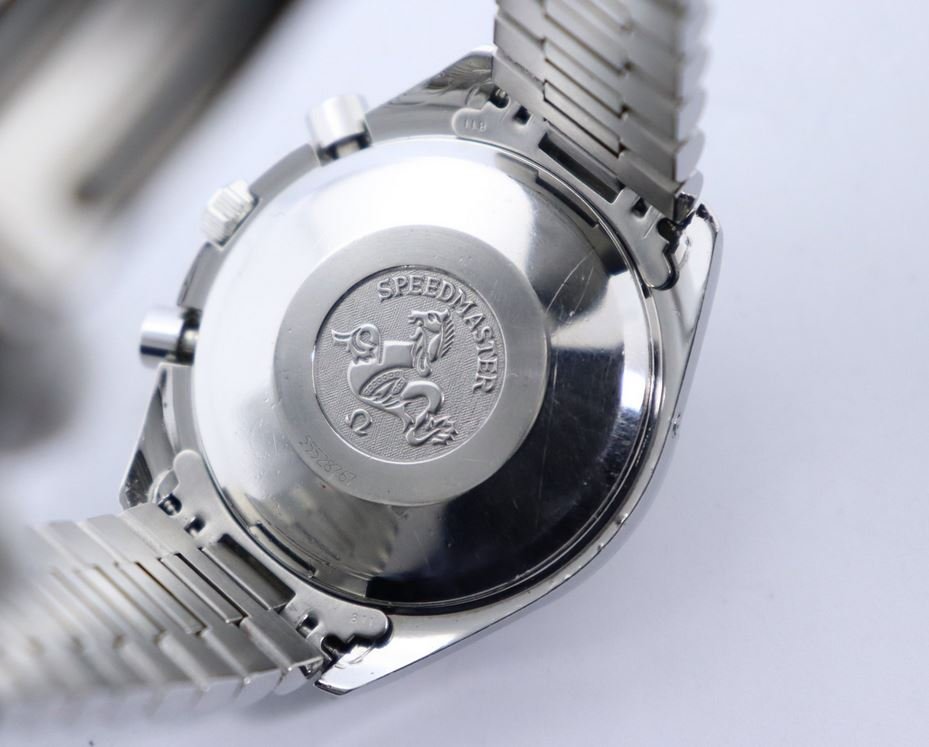

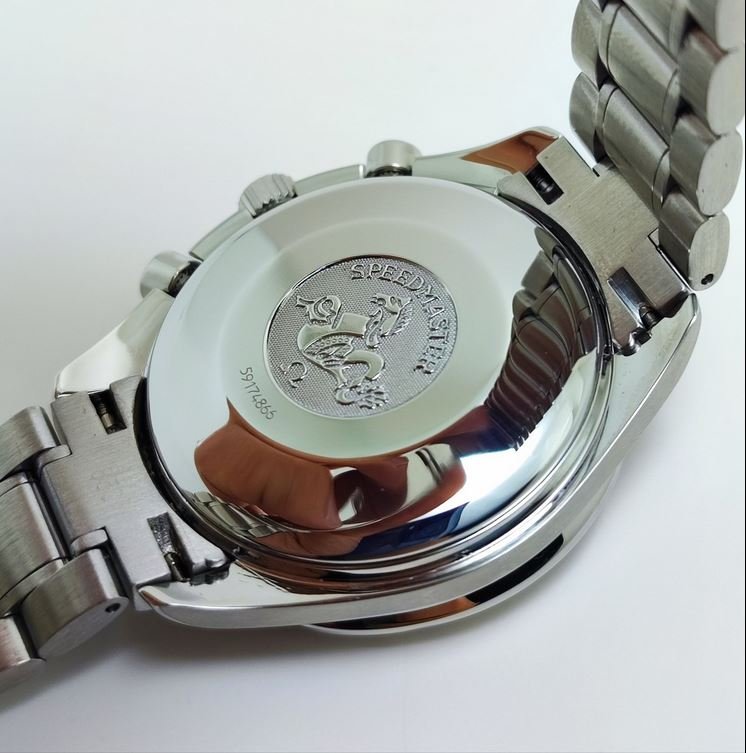

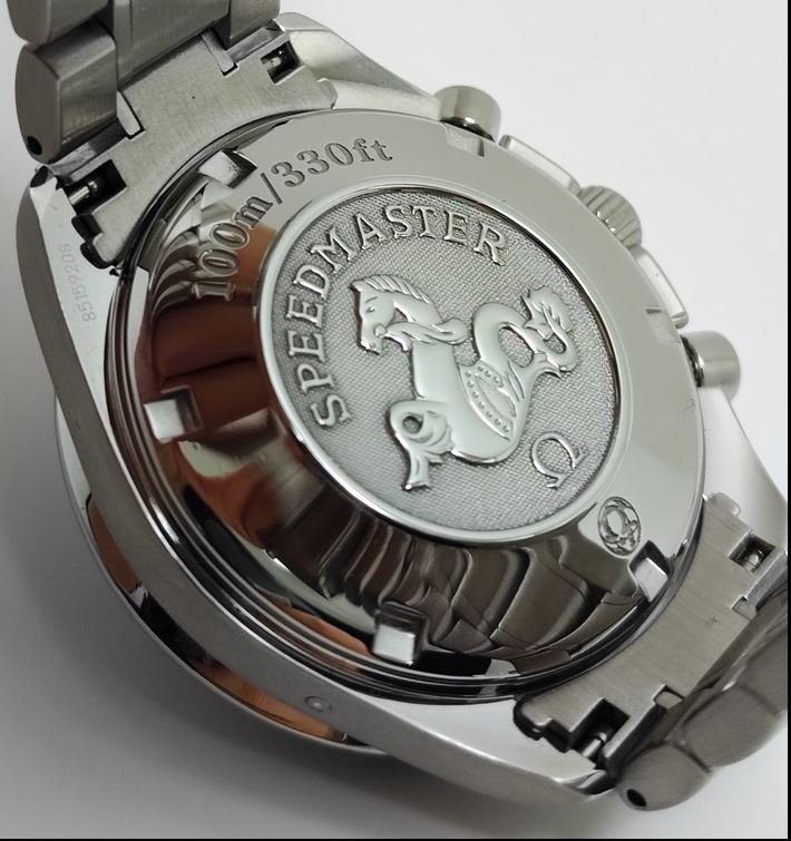

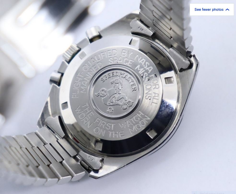

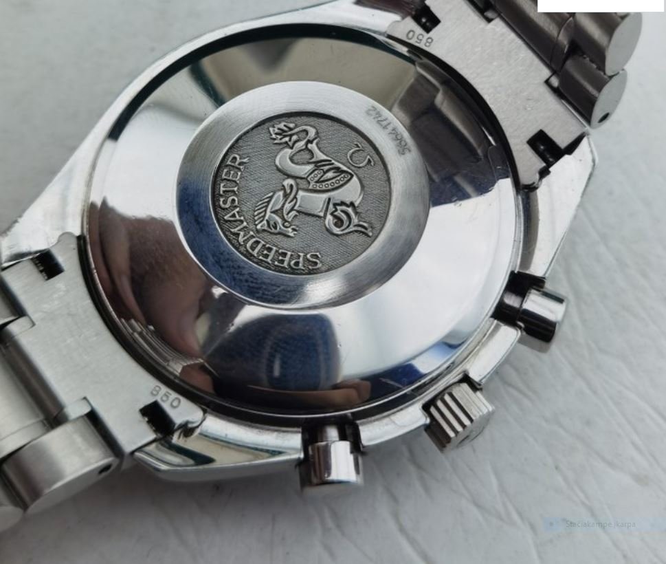

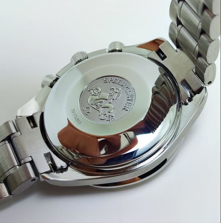

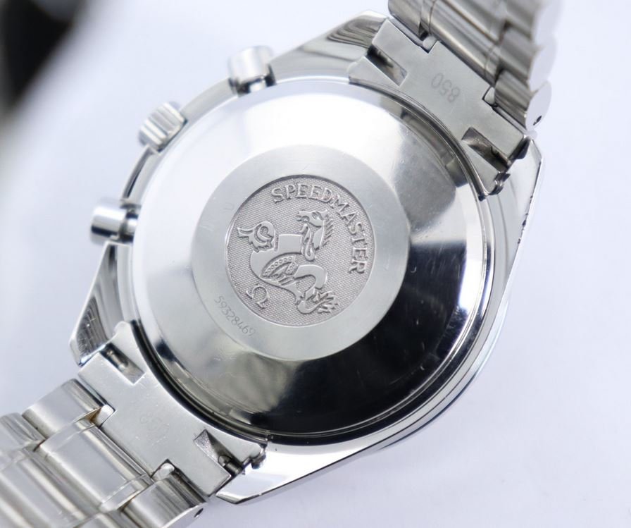

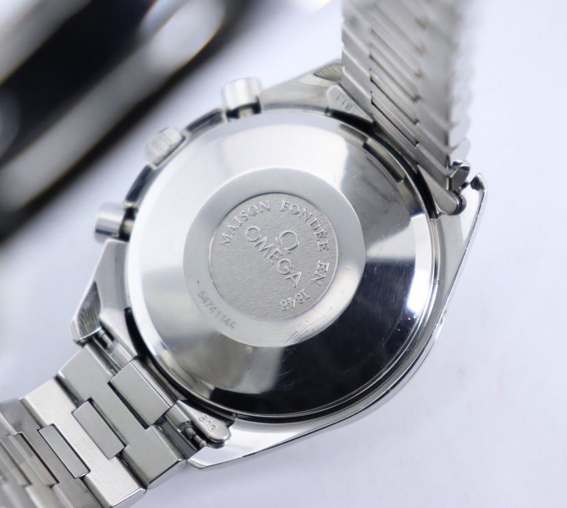

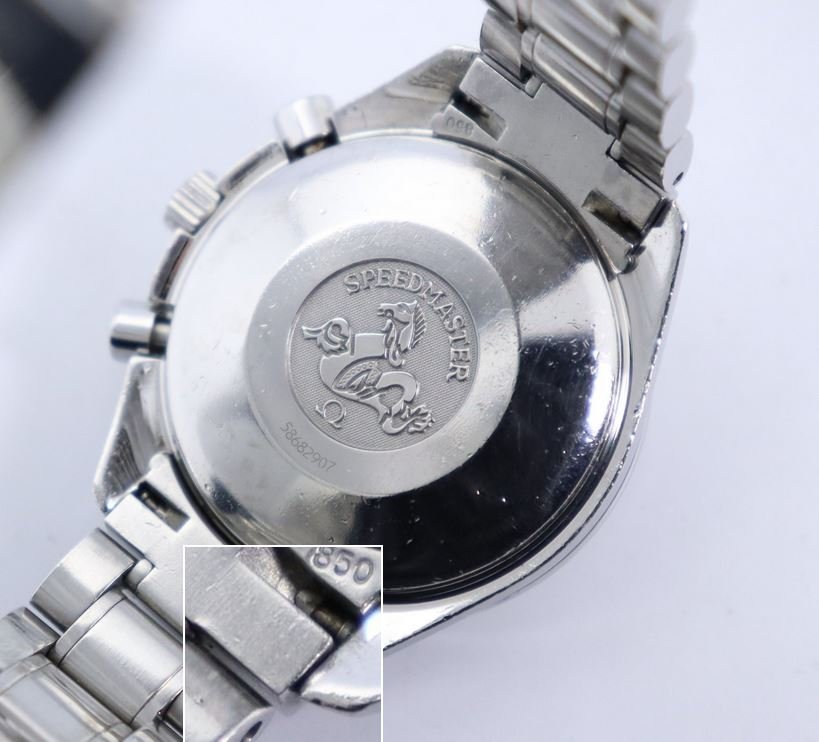

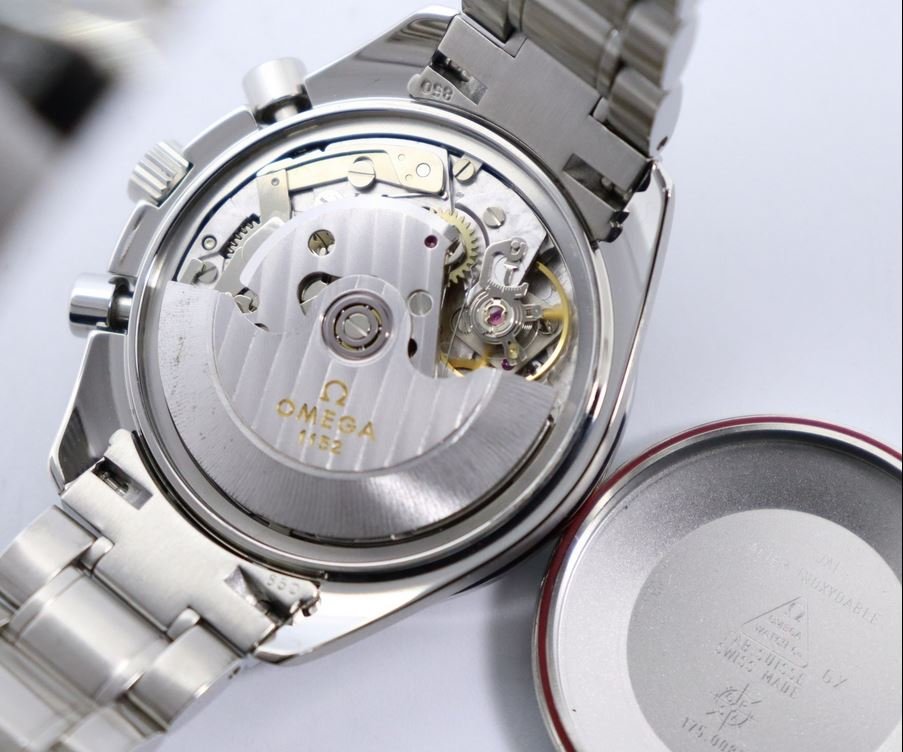

Hello. I wanted to ask the consultants. My Omega Speedmaster comes with a short bracelet 1562/850. It should be extended. I know that the price of a new bracelet in Switzerland is 1000 euros plus all kinds of fees and shipping.

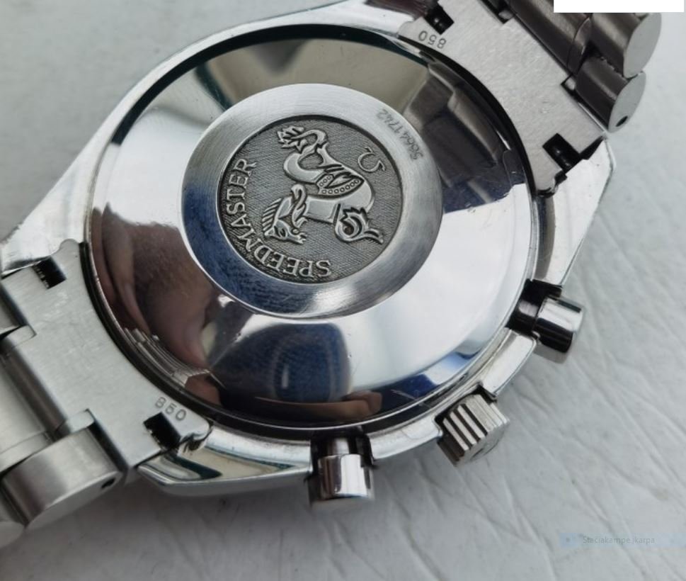

Therefore, I would like to purchase a used bracelet. However, I got quite confused when using the internet. There are watches for sale online with different bracelet markings. I'm attaching photos when 850 is marked in one place and another? In addition, Speedmaster watches are sold when the bracelet does not have a number at all?
Please help to find out the markings of Omega Speedmaster bracelets, according to the year of manufacture, ref. no, or according to the watch numbers?

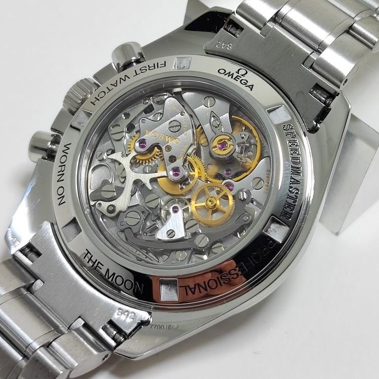

You are comparing several different Speedmaster models (a Pro and I think two different automatic versions) and that alone explains the differences in bracelets - they don’t have the same case size or lug width. First, identify what Speedmaster you have, then you can get a bracelet that fits.
Uncle Straps is a good resource as they have bracelets for the Pro and Reduced Speedmaster case sizes.
2,477
3,867
Post a picture of your actual watch. We need to know what model Speedmaster you have. You basically asked the same question as you having a Toyota and want to know what tire size to get, then posted several pictures of different Toyota models.

I clarify the question. My bracelet is 1462/850 for Omega Automatic 39mm. I don't like aftermarket bracelet like Uncle straps because it spoils the authenticity of the watch. I am interested in generally authentic Omega Speedmaster bracelets, what year, what models were used with Omega watches. I am looking for information.

I'm sorry, but you still don't understand me? I have shown a picture of the existing watch. Specifically, the model is Omega Speedmaster 175.0083, ( 1120, from valjoux 7750 ) the bracelet is 1562/850. I need to increase by at least one size from 18 mm to 19 mm. However, the question is not about a specific watch ( 175.0083), but where can I get information about all the authentic Omega Speedmaster bracelets from 1967 to 2005? According to ref. And other signs.

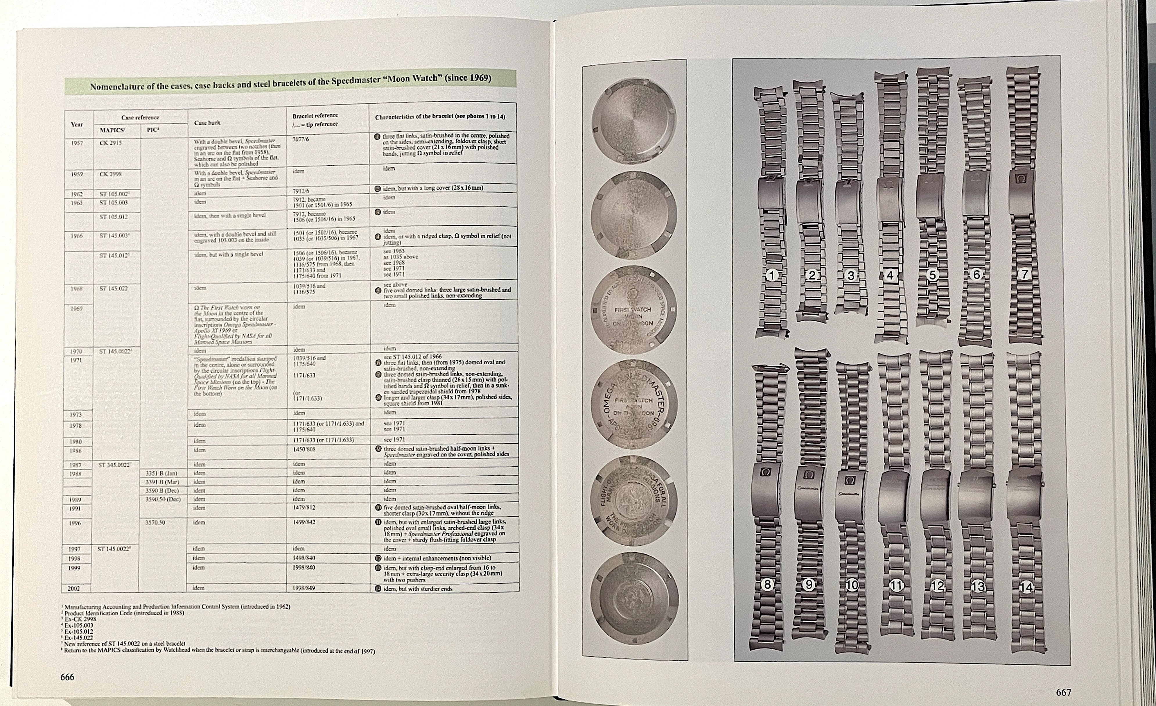

...........................where can I get information about all the authentic Omega Speedmaster bracelets from 1967 to 2005? According to ref. And other signs.
It's a huge task, but here's a start.
There is also a chart I've seen detailing cases/bracelets etc. It has been posted here but I can't find it at the moment.
10,804
16,814
I think you are overthinking this. If all you want to do is extend your existing bracelet, go to a boutique and buy a link. They are available for the recent stuff like this and at around €40 are a heck of a lot cheaper than a replacement bracelet.
ps I think you will struggle to find a single reference that covers the Reduced, Date and Triple Date models, most inc the one shown directly above cover the Moonwatch and willl be of little use since though your bracelet might look like these, it has a different lug width.
