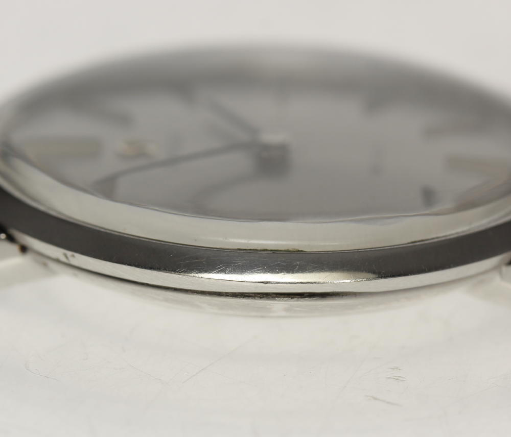

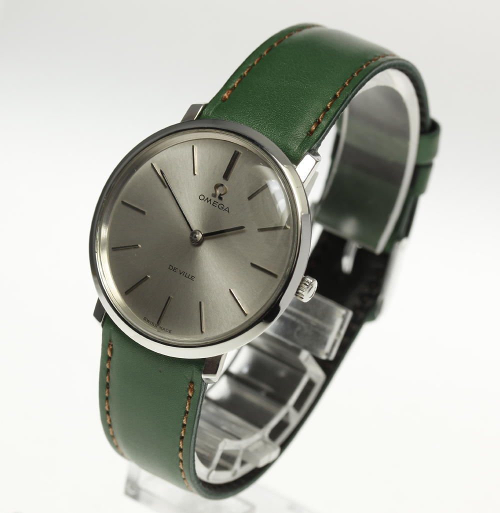

    To me, the dial and movement look clean. It has both an Omega-signed crown and crystal. I've been trying to comparing the details to other photos online but I could use an expert's eye: Is the printing on the dial correct and original? Are the case lines, particularly at the lugs, sharp enough or does it look like there's been some polishing? Is this a reasonable value? Again, looking at this as a special gift, not an investment piece.

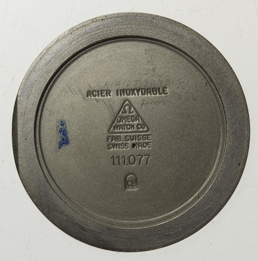

    The price seems fair to me. The dial and hands are nice, so the watch will face up nicely on the wrist. The case has obviously been polished too much for most collectors, but probably not enough to bother anyone other than a collector. There is pitting that suggests moisture ingress at some point, and the movement has been treated a bit roughly. So if you are going to give this is a gift, you would want to factor in a full service by a trusted watchmaker. As you know, the watch is fairly small.

    Just to be clear, the pitting seems to be confined to the back of the mid-case, so it may only be a cosmetic issue.
