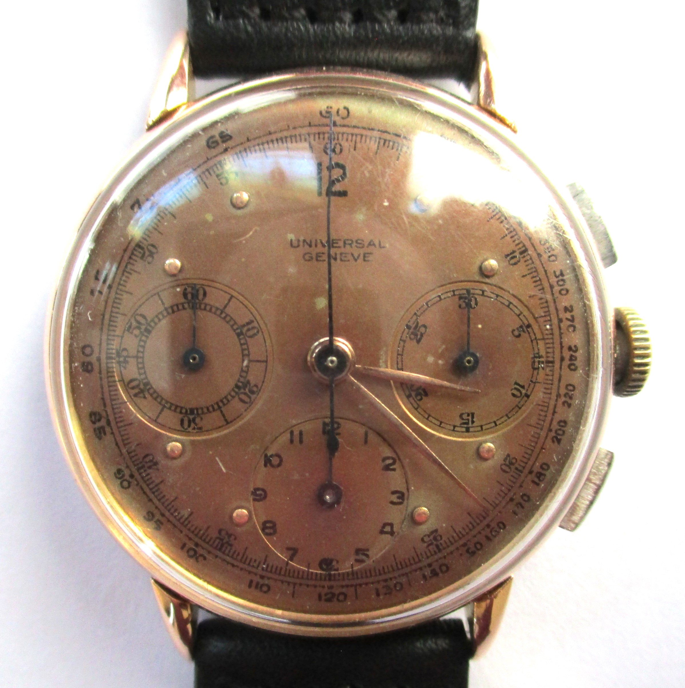

Please advise whether this triple is a Compax
19
6

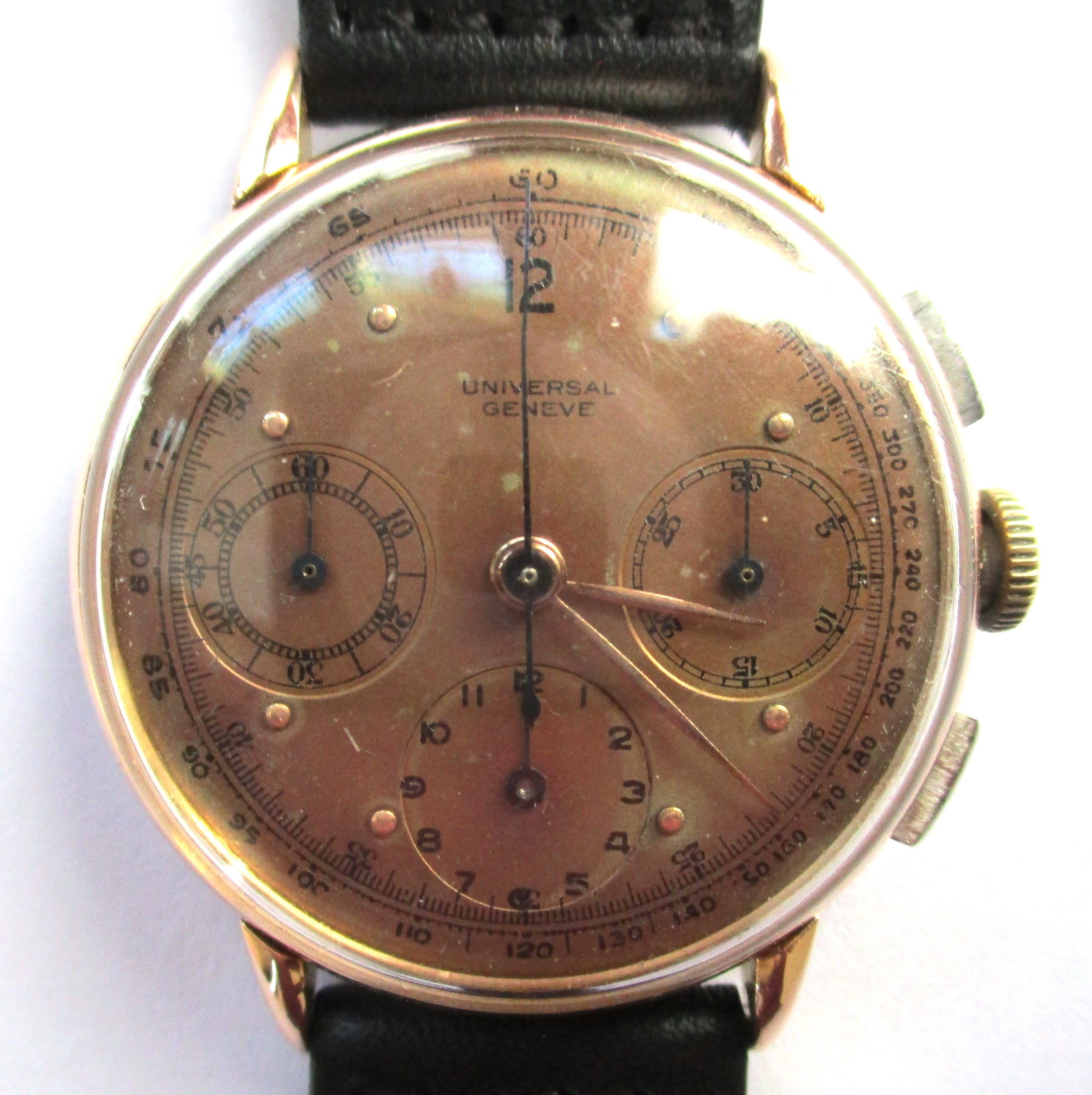

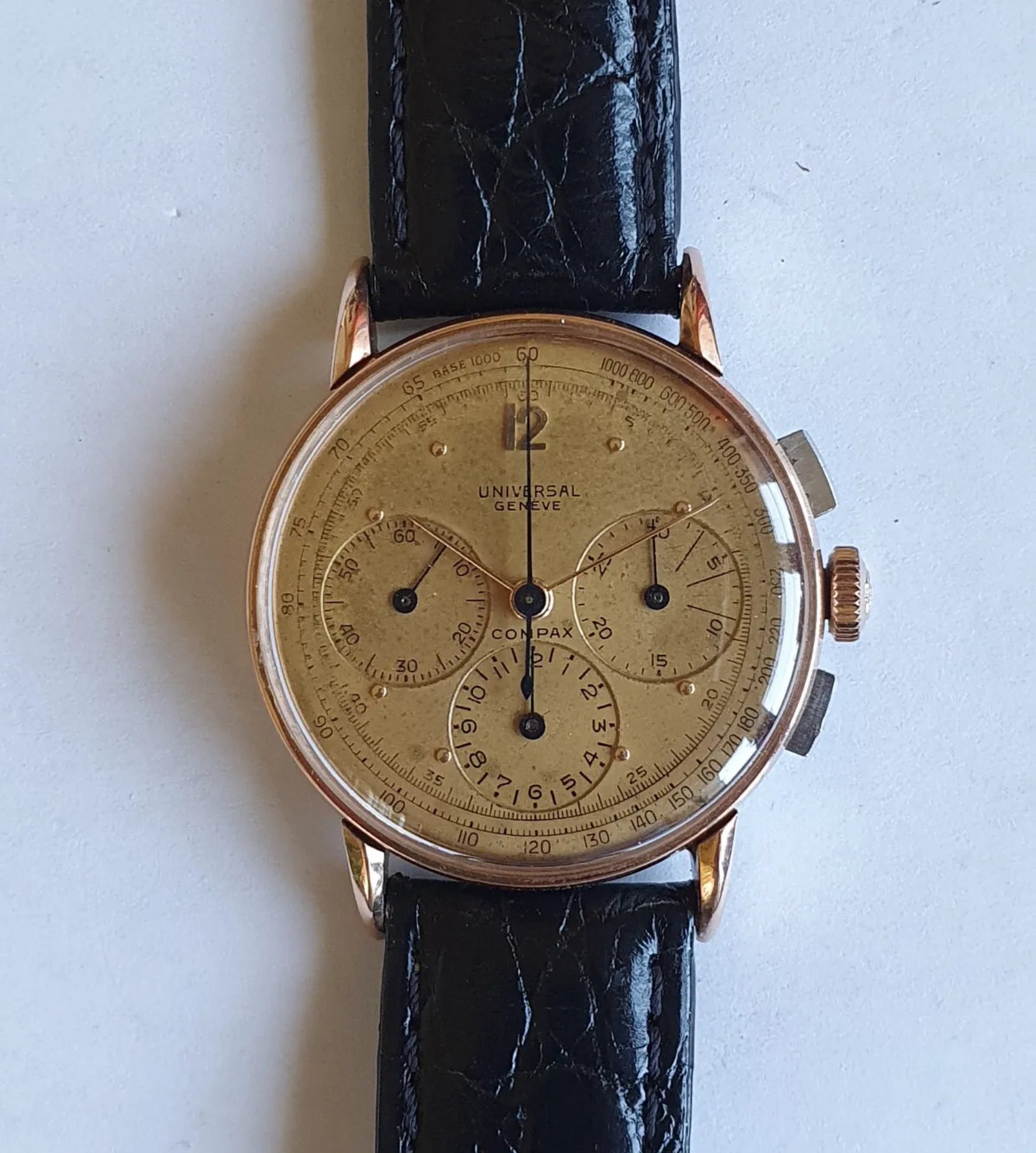

I have this Universal triple chronograph with cal. 285 movement. All the other triples I can see on Ebay have dials identifying them as a variant of the Compax ; but mine has no words on the dial other than "Universal Geneve". The dial's patina suggests that it is original.

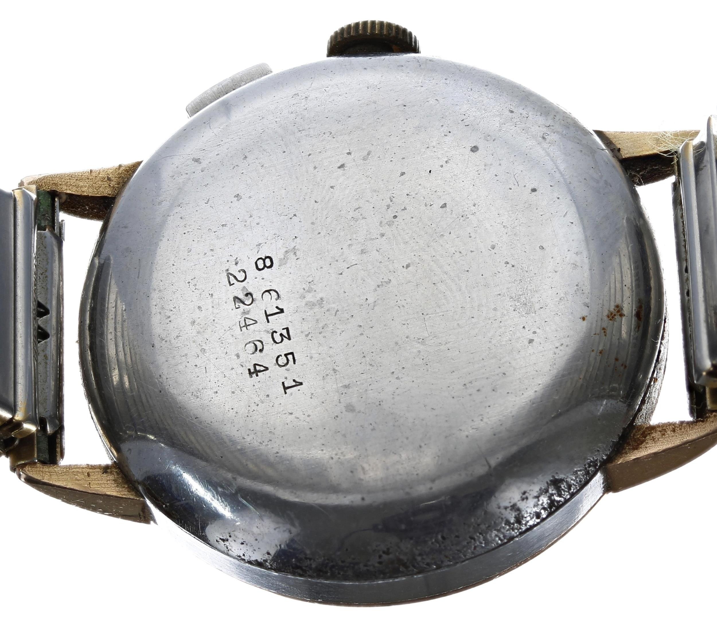

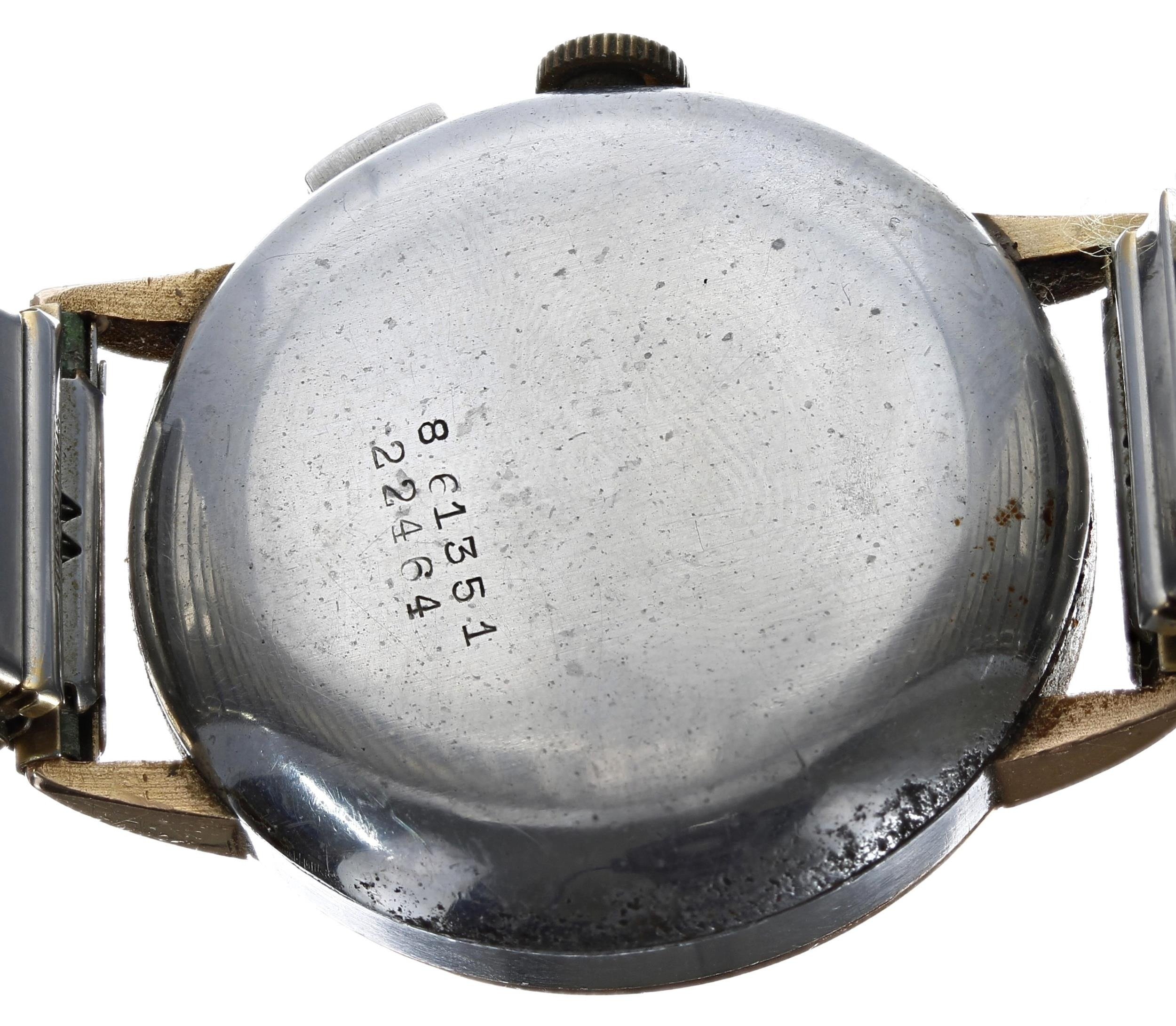

The case has steel sidewalls and back but solid gold bezel and lugs. The numbers engraved on the back are 8-61351 and 22464. I know from reading information here that the latter number correctly indicates a steel cased chronograph with cal. 285 movement, case style 64.
I would estimate that it was made around late 40s or early 50s, so it doesn't seem to pre-date Universal's use of the Compax name. Could someone please advise whether it is in fact a variant Compax, or any other designation which I can use when selling? I don't want to misdescribe it. Any info about relative rarity would also be useful.
Sorry for the poor image - it has a dark copper dial which is quite hard to photograph.
Thanks for any help,
ROB

I'm pretty skeptical about the dial, but let's see what others have to say.

What you have here is a redialed UG Compax.
Regarding when it was made, that can be derived from the serial number on the case back (the longer number).
14,005
54,324
There is just nothing good to say about this watch. The only value = movement/Hands.
3,720
8,554
Based on the case serial it’s from 1941-42
these mixed metal cases are pretty cool
too bad about the poor redial
what’s the history, does it have sentimental value?

Hello @Frontfloater ,
Your original post asked for an affirmation that your watch was a rarity with “dial’s patina that suggests that it is original”.
This style of descriptions in offers from some traders and sellers causes inexperienced beginners to lose their money.
You got the answers to all questions that you asked in your original post so no need to write things like “would have appreciated some suggestion” etc. - well, you didn’t ask for any such suggestions.
Anyway, the forum is here to discuss watches, so here is what you might be looking for regarding an original dial…

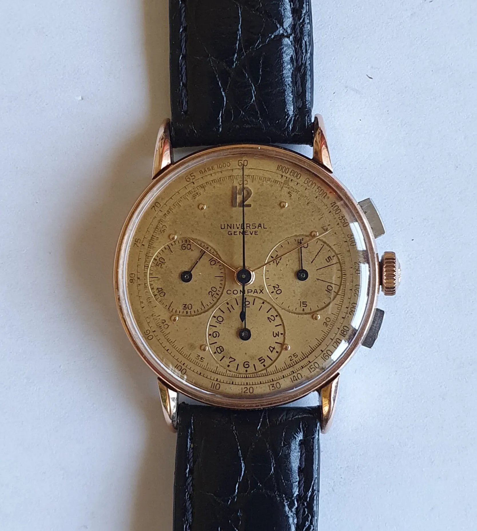

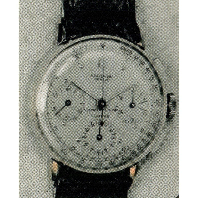

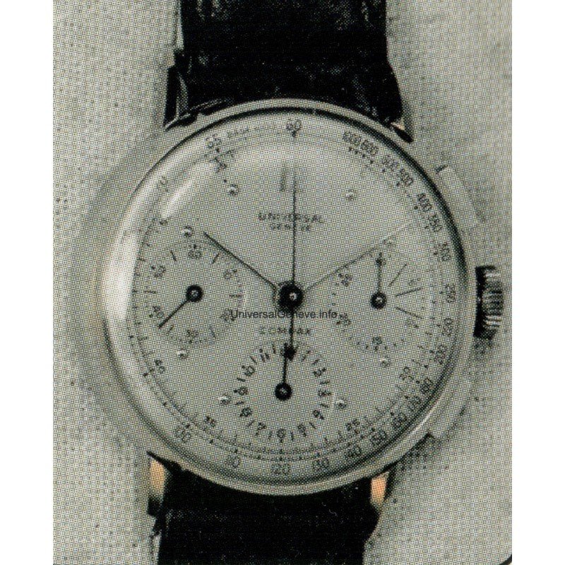

These “double metal” cases, from what I have so far seen were usually fitted with a similar style of dials - with either applied or printed “12” and gold dots instead of numbers.
Here is an image from the archive:
(Source: https://universalgeneve.info/chronographs/271-12201.html )

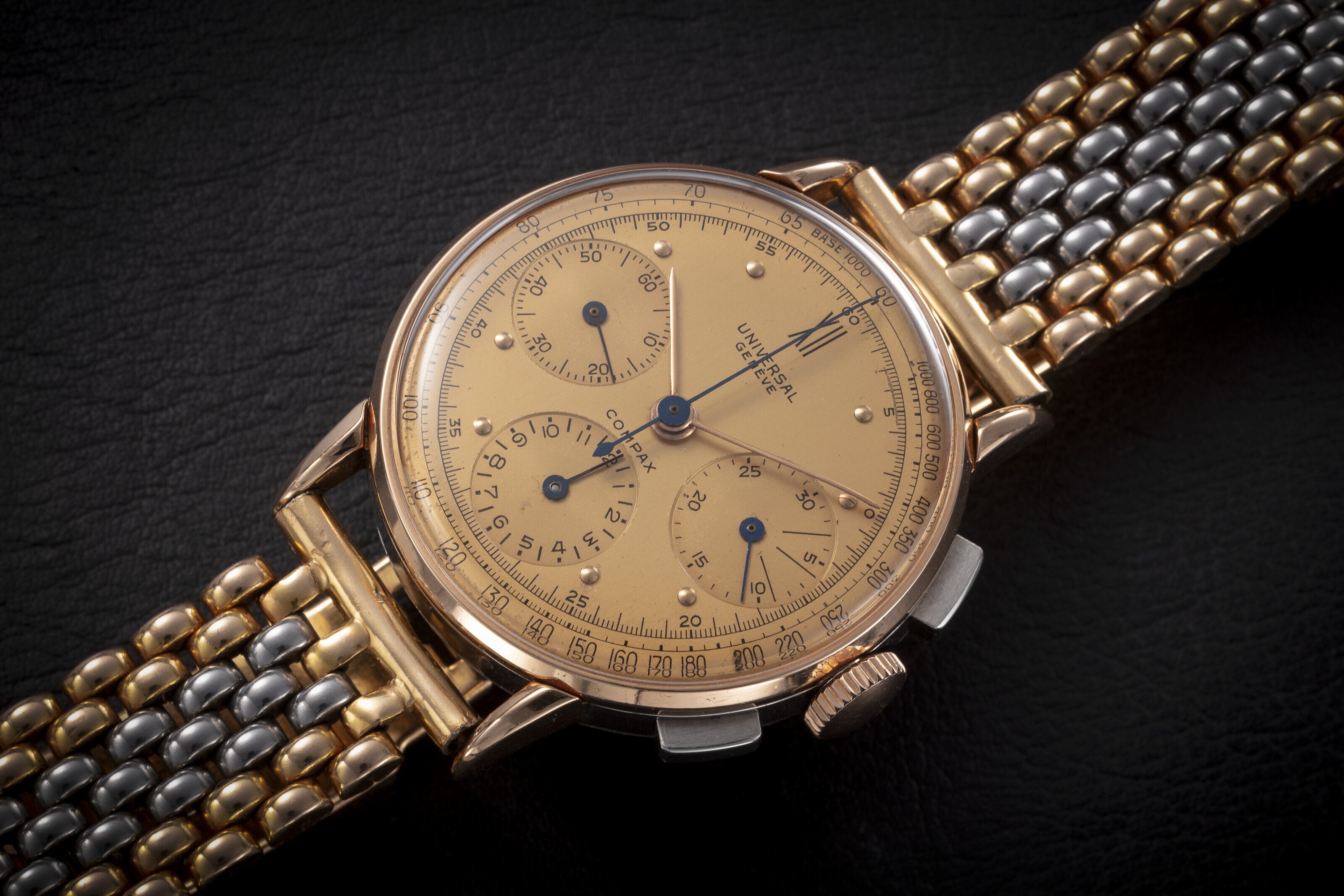

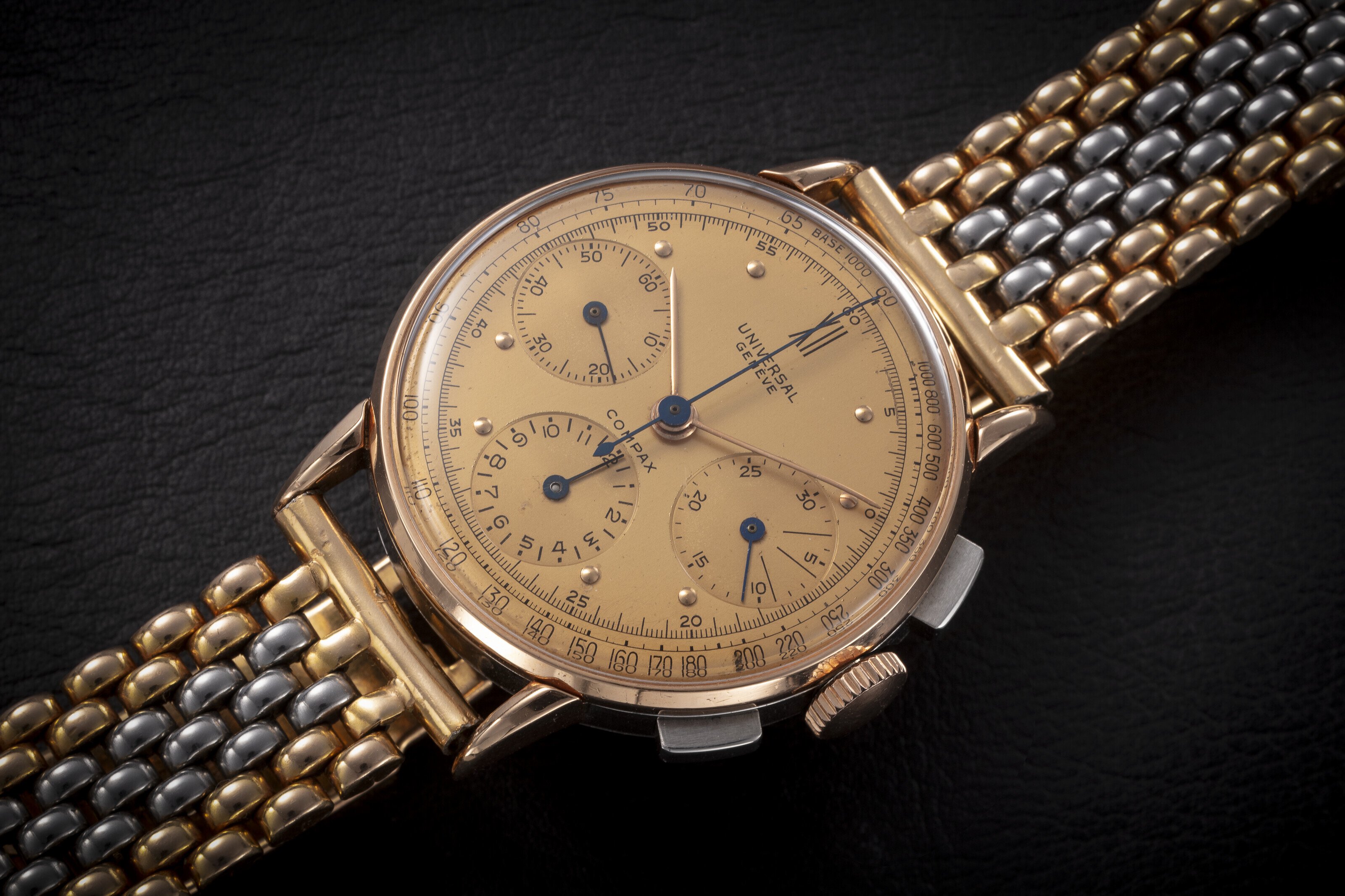

Here is an image of an example sold at Christie’s, serial 861338
(Source: https://onlineonly.christies.com/s/...tone-chronograph-two-tone-bracelet-185/165658 )
And here is an image of a very similar watch and also a close serial number (86115), but it is a smaller caliber (cal. 283, reference 22232). This dial style (but with a cal. 285 diameter) is what you should be ideally looking for:
(Source: https://www.ebay.com/itm/1262107156...xzxeK-tS-C&var=&widget_ver=artemis&media=COPY )

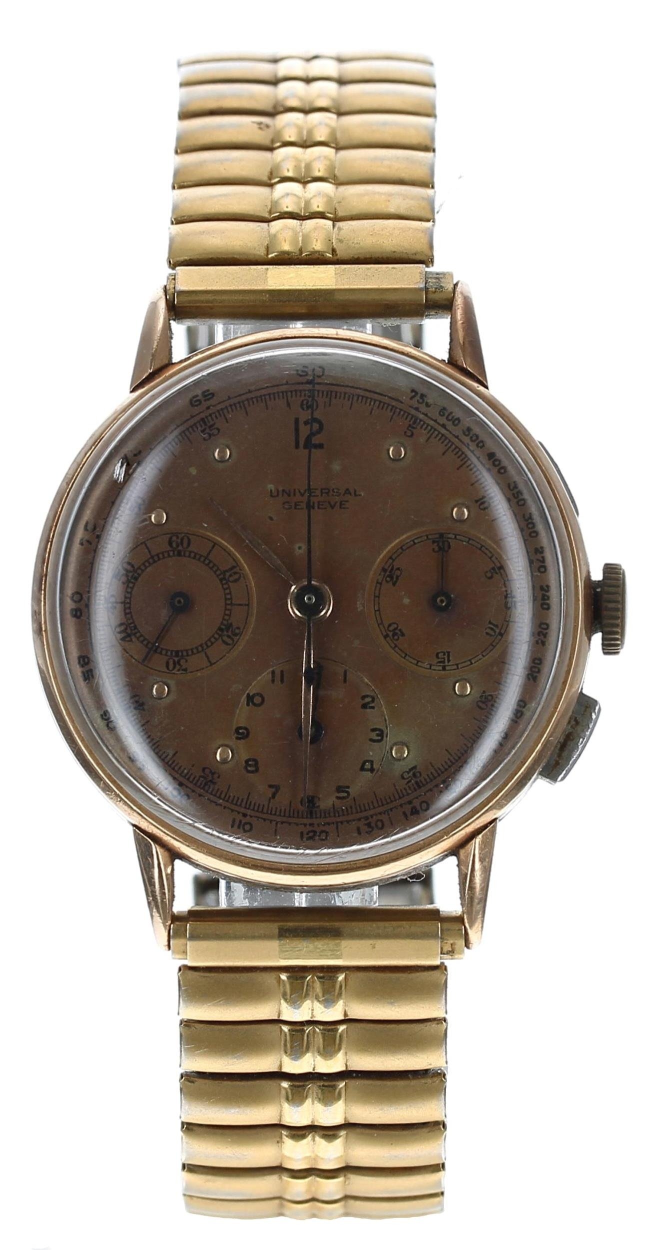

Another satisfied customer.

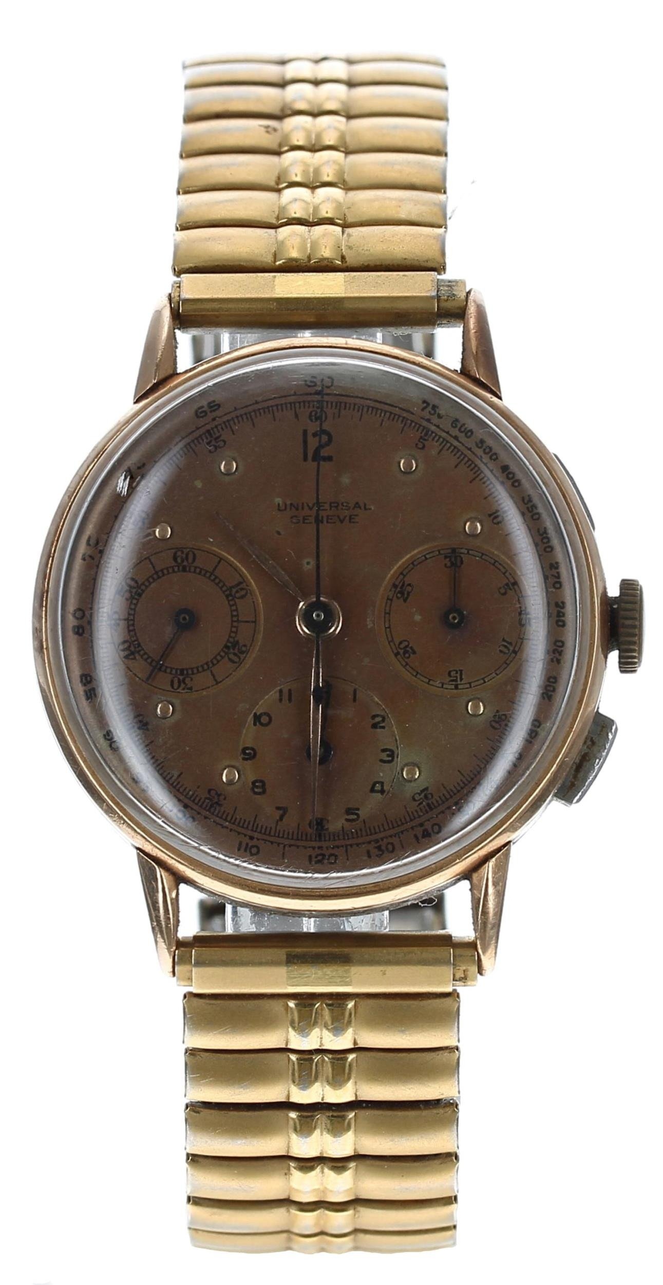

Hammer was GBP 320 excl 30% fee... I think that that is about parts value

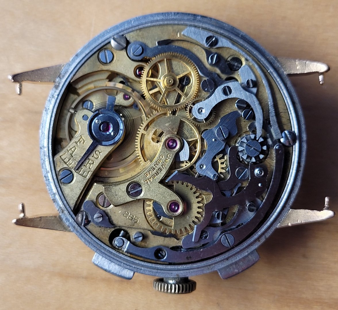

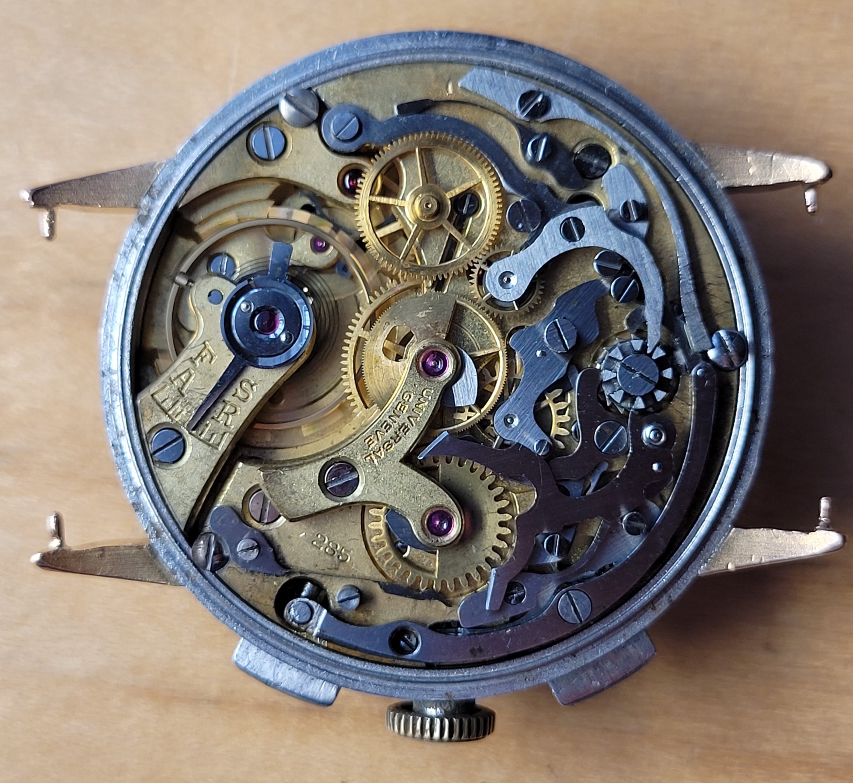

Some additional pics:
19
6
That hammer price was for a faulty watch with (as clearly visible) a non-functioning chronograph - it had two movement screws missing (a photo you did not copy), a non-running hour register, and a defective start-stop lever. So yes, perhaps parts value at that point - but now professionally overhauled and fully functional, as I said before.
