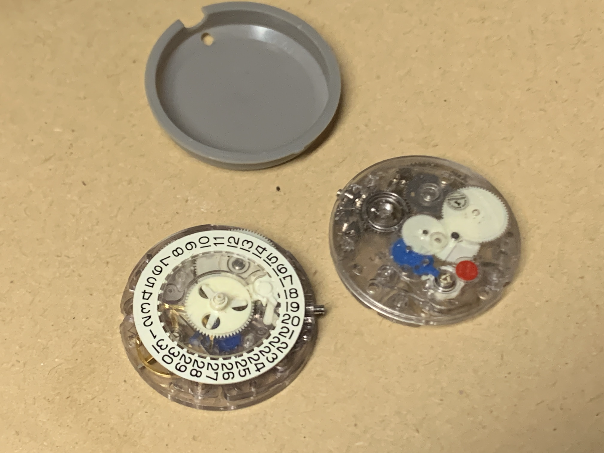

Plastic Tissot watch movements arrived.

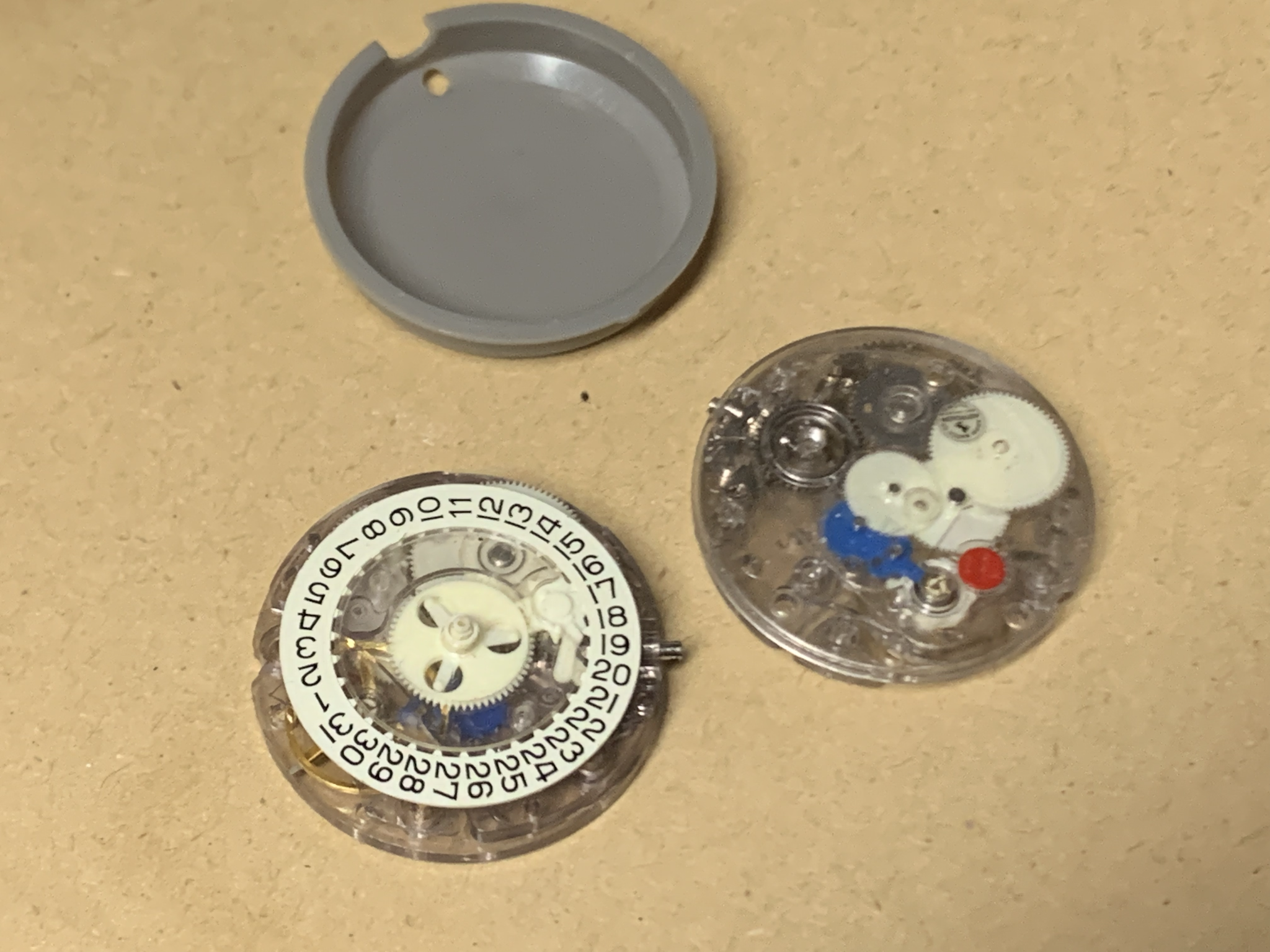

The plates seem to be held together with what look like metal pins. One of the movements is missing the motion work. The stem is a split stem. It is broken on the more complete movement.
The movement missing parts does not wind, there is no ratchet action. The balance swings free on both. I was able to put a short wind on the more complete movement and it runs. Fun to watch the balance swing.
Since the ratchet spring is missing on the other There might be a way to take these apart.
There was a gray case thingy. This seems to fit over the dial side. Not sure if it really goes with these or was some sort of shipping protector.

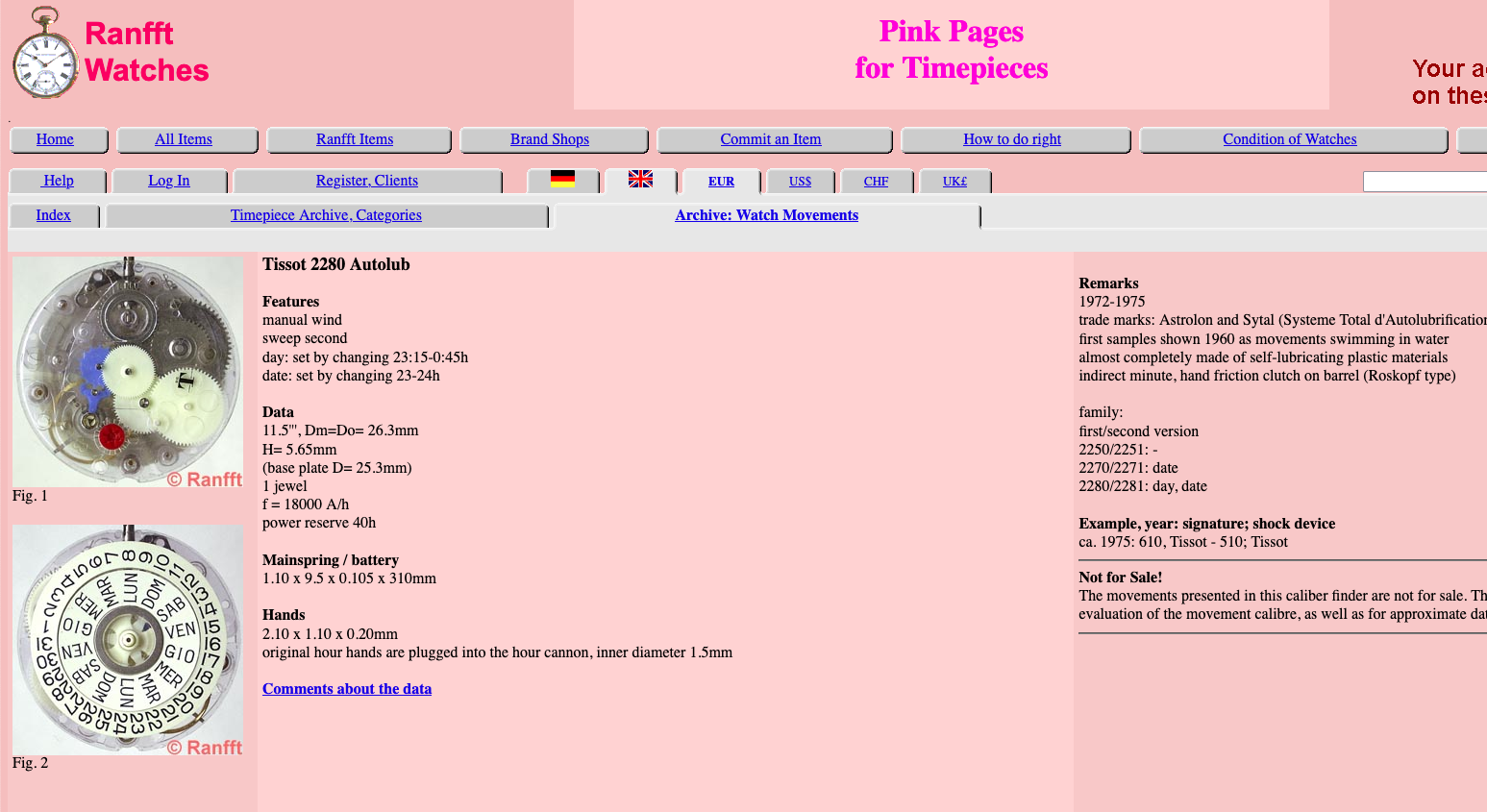

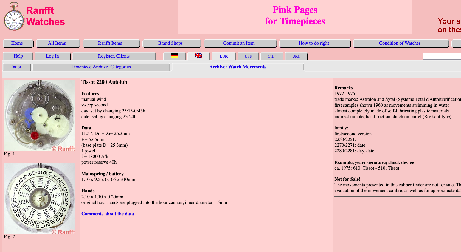

I was able to grab a screenshot of Ranfft from the archive.org site.
No datasheet on watchguy.co.uk
