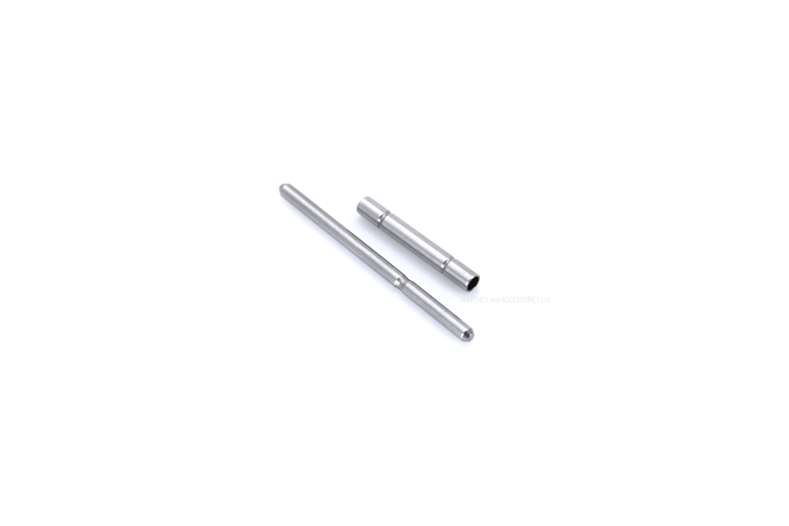

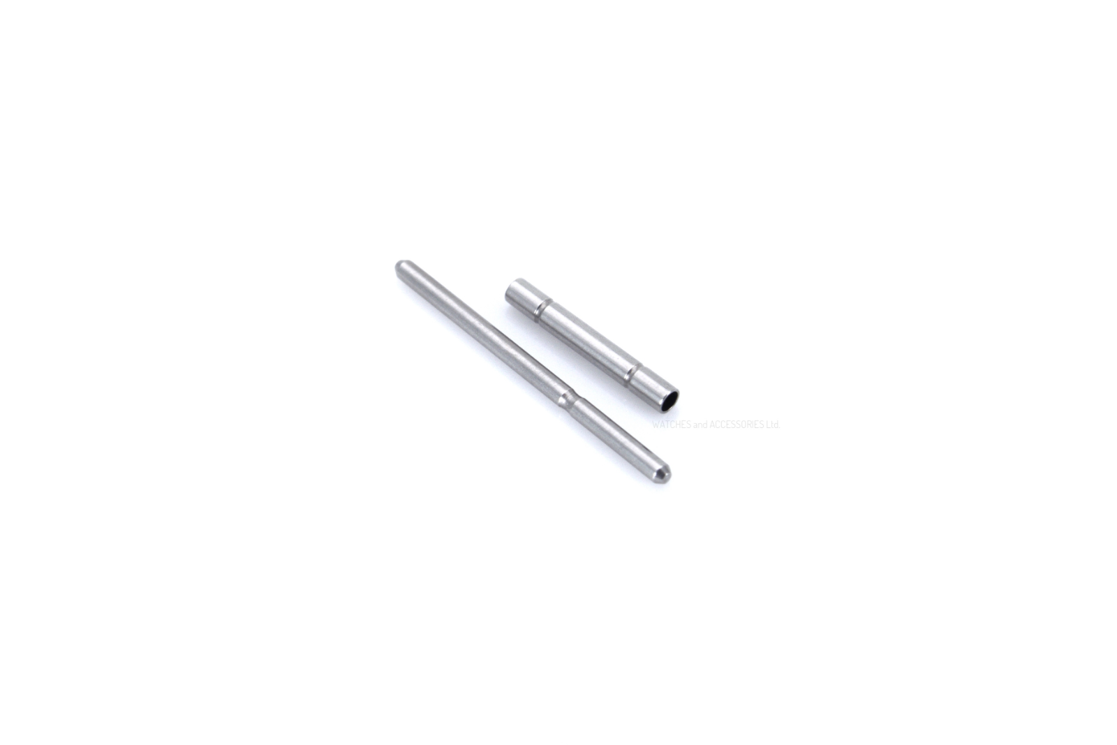

The pins are held in the bracelet by sleeves in the centre link. As they age the fit becomes loose due to wear and sometimes when cleaned the removal of the crud holding everything together lets the pins slide out more easily.
To use any form of Loctite, you would need to apply it to the sleeve/pin interface, and I can't see how you could do that. I would not advise using Loctite.
Best option is to get new pins/sleeves, but depending on how many you need, a new bracelet could be cheaper.

It is typically part of a service to check these, so really your watchmaker should be testing the pins to make sure they were not loose, and swapping the pins and tubes as needed. The bracelet needs maintenance just like the rest of the watch. Omega even makes a specific spring loaded tool to test the pins with, but I just use a pin tool, and if I can move it just pushing on it with my hand, it gets replaced.
These wear over time - in contrast to the photo Jim posted above, this is what worn ones look like sometimes:
Also, the prices being asked in that eBay link are nuts. These are $2 each from Omega, so $2 for the pin and $2 for the tube - even that is expensive IMO. These come in packages of 10 usually, but for common bracelets I service a lot of (like the Bond bracelet) I buy them in packages of 250 of each as shown below...
If you are really in a pinch and your watchmaker doesn't have access to parts (if so he probably shouldn't be servicing a co-axial, but that's another conversation) then the best way to tighten a loose pin is not to use glue or do anything with the tube, but to rough up the pin. Take a pair of pliers with sharp teeth in the jaws and squeeze the pin where the narrow spot on the tube is located to rough it up. This will get you by while you get some replacements.
