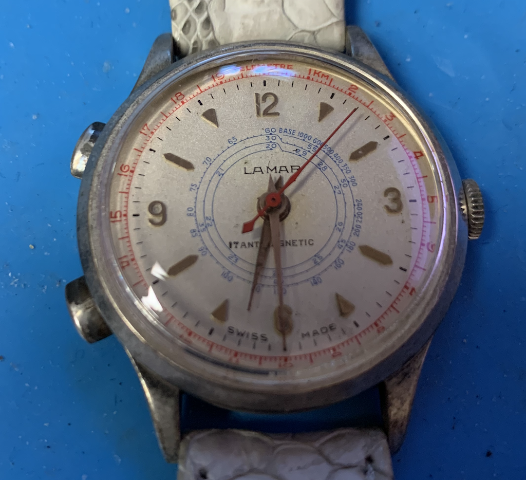

This one gets me every time. Has one of the nicer dials. But when you press the button the whole watch stops. Press the other button and it runs.

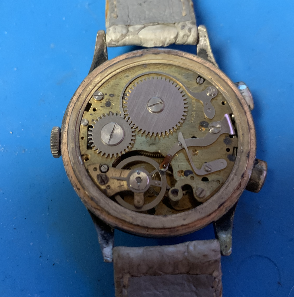

A look at the movement can see the brake is simply applied to the balance wheel.

Since the setter buttons are on the reverse side, I can not fit any of my Landeron 48 or Venus 170 movements into the spare case. I wonder if they did that intentionally.
