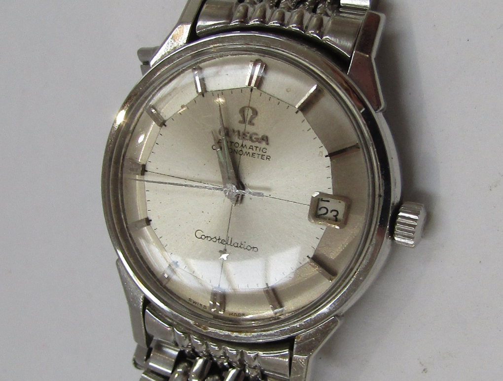

I realise the picture isn't the best but can anyone see any red flags with this dial? I can't see anything obvious, but been new to this I'm not confident enough to put my money where my mouth is........yet 馃槈

From that one picture I鈥檇 say the dial is original but it has some marks.
Crown is wrong.
Case has plenty of wear (and is it quite severely nibbled at 6?)

At least I'm making progress on finding untouched dials 馃憤
Should the crown be decagonal?
Yes
In addition the hands have been relumed and the seconds hand is too long.
The date is clicking over too early.

Second hand looks far too long, so I guess is a replacement, as could be the hr and min hand, as the lume looks to be a completely different colour to the dial lume
of course, these could be the original hands, but with newer lume
dial dates the watch to 1959-61 period

Is it possible the date clicking over is as a result of the watch been an hour away from midnight, or would the click over be nearer to the midnight hour?

How easy would it be, in terms of availability, to replace the hands with an appropriate set?
On top of what has already been said, to the above question, it obviously will need servicing
Are you thinking to buy this as you didn't mention the asking price?
Regardless of the price, though, overall it is unattractive to me as the dial, hands and case are poor as already mentioned above by others. For me, the first question you should ask yourself is "would I be happy to look at this in my wrist?". I feel that if you ask yourself that, you'll reconsider this watch.
