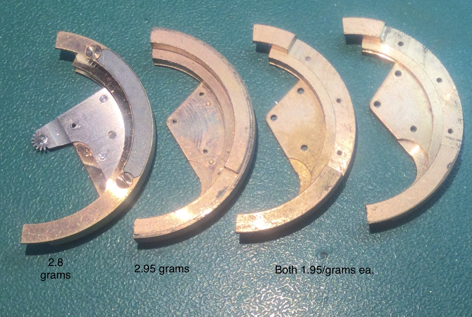

I have two containers of bumper rotors I got in parts lots, but don't which movements they fit.
Each caliber. Omega changed the weight on the underside
If you have a movement sitting in parts. I would appreciate it you can post an underside image and caliber.
In order to prevent repeat images. Please check each post (if any) to see if what you have hasn't been posted yet
Thanks
DON

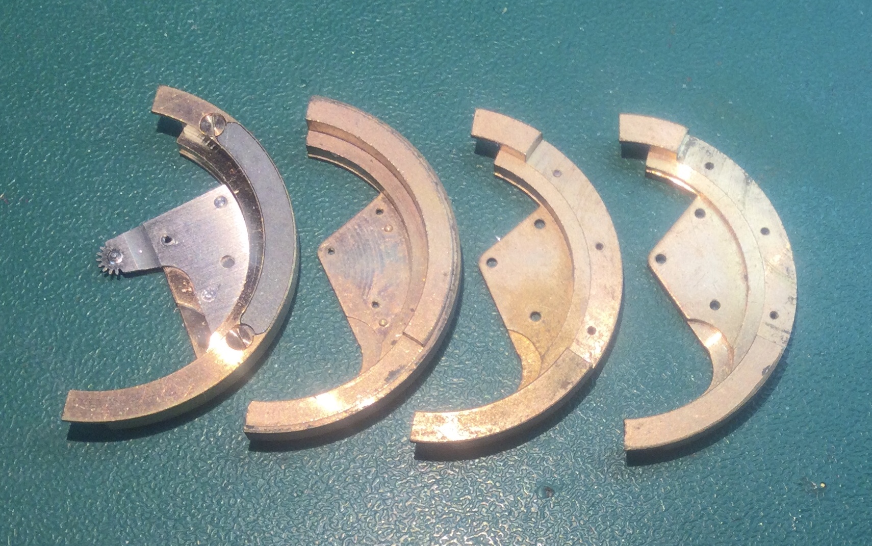

You’re right! I never noticed any differences, myself. But the differences are quite evident. Four rotors shown here. The two on the right are the same. Two others are different. Not movement caliber number shown on any rotor.

Weights as per new image. I removed the rotor post yoke from the one on the left before weighing them. I know you are disappointed that I can’t give you the calibers. Good luck finding someone with a bumper automatic that is original, and good luck finding someone with guaranteed originals who will take them apart to give you the information you want!::rimshot:: The two on the right MAY have had ballast weights removed as they appear rather light.

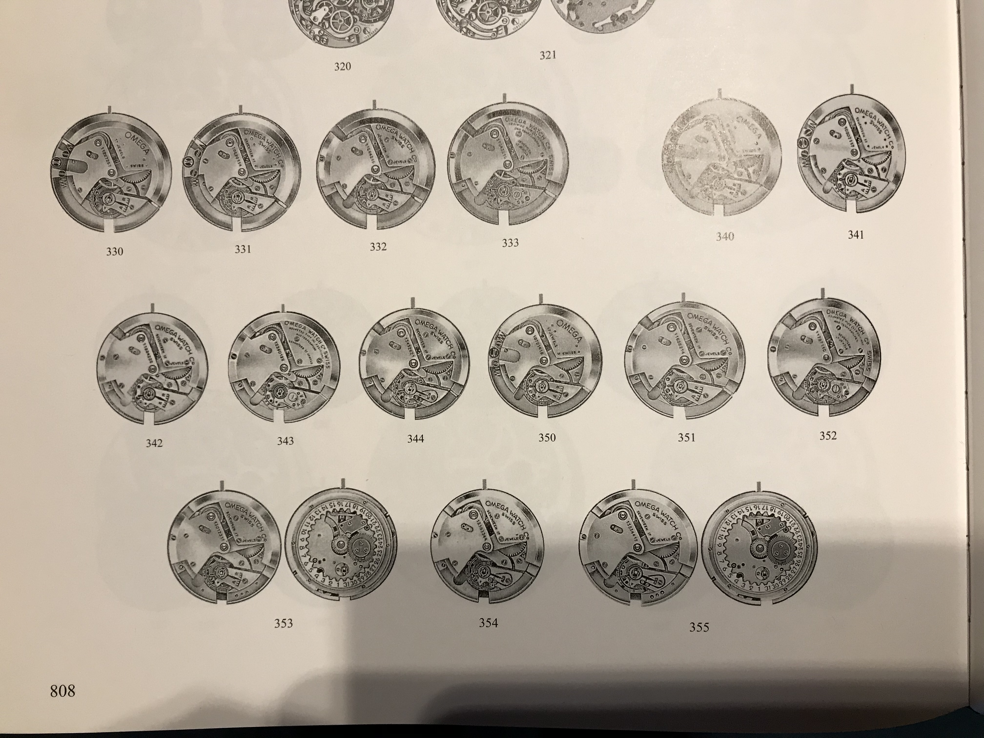

This is interesting. unfortunately I don't have a spare Bumper movement flying around, and will not take my 2577-26 apart.
in the Omega AJTT book you can see the "top side" of the slightly different rotors. the 330, 331340, 341 and 350 have the 3 small holes on the top. the others like my 354 have the screws from the top. If I look at the picture from Canuck, the second from the left seems to be the version with the 3 smaller holes. The two on the right seem to be the versions for the 3 screws which is the range from 332, 333, 342-344 and 351 to 355. That is, if the images in the book are right 😀 Funny thing is that the 350 in the middle of the range is shown with the 3 smaller holes...

Took a quick pic of the page in "a journey through time"...
If you look closely then you can see that the writing on the bumper rotor is not always the same, maybe that might help to at least narrow it down to a fewer number of calibers? Some of them were chronometer certified.
Also the dimensions, (length of the "ends") is not always the same...

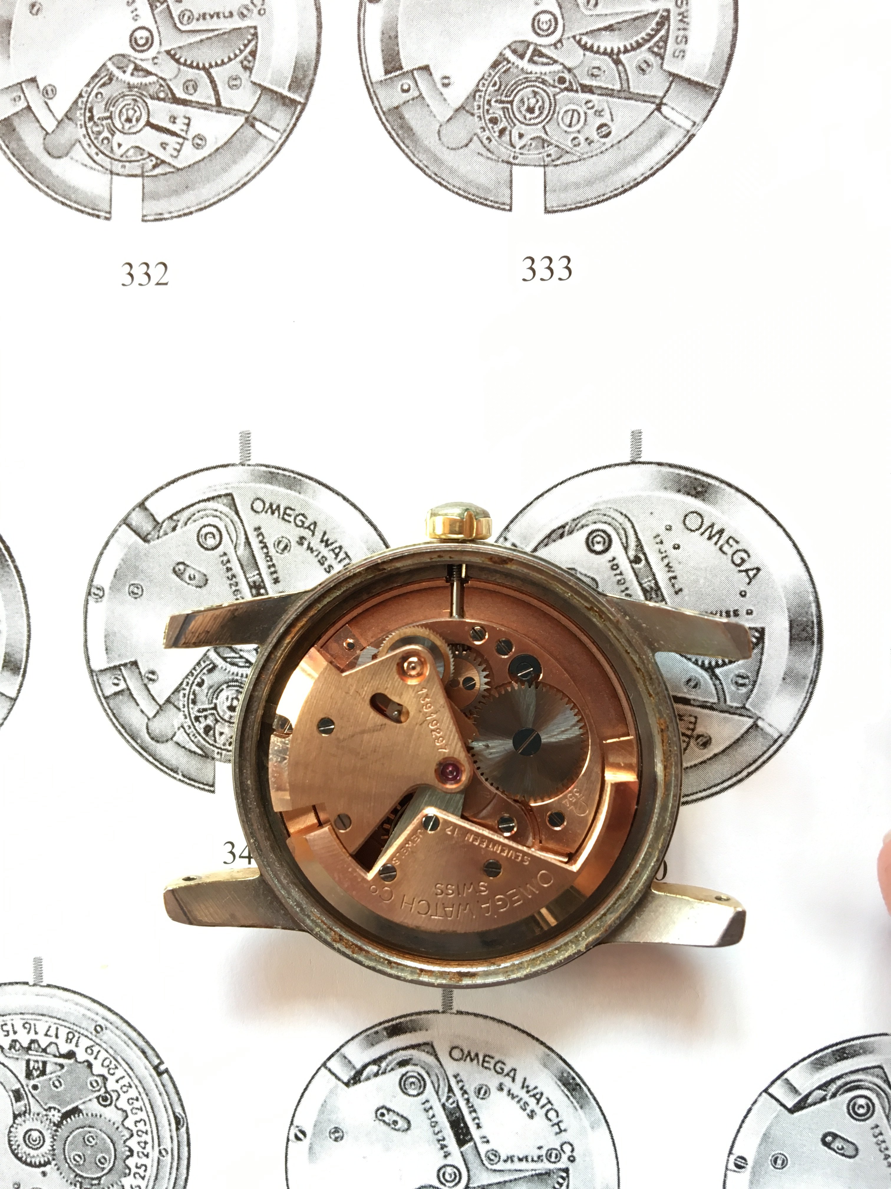

This is what I found and also noticed the tips for the springs at the end of the rotors varies in widths.
One is marked
