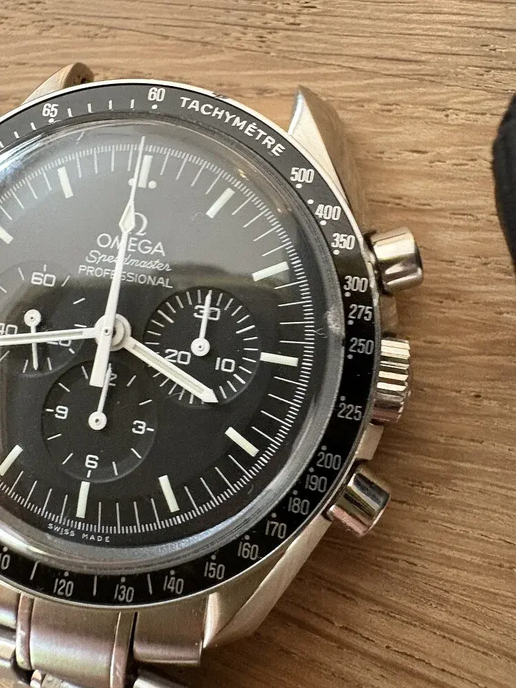

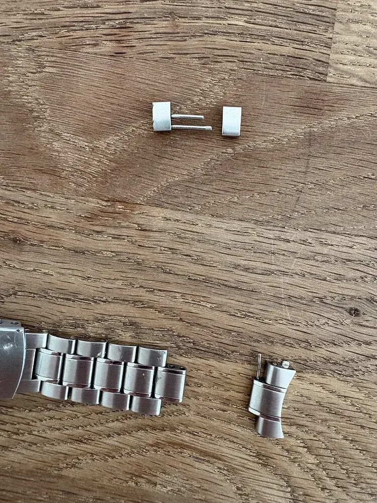

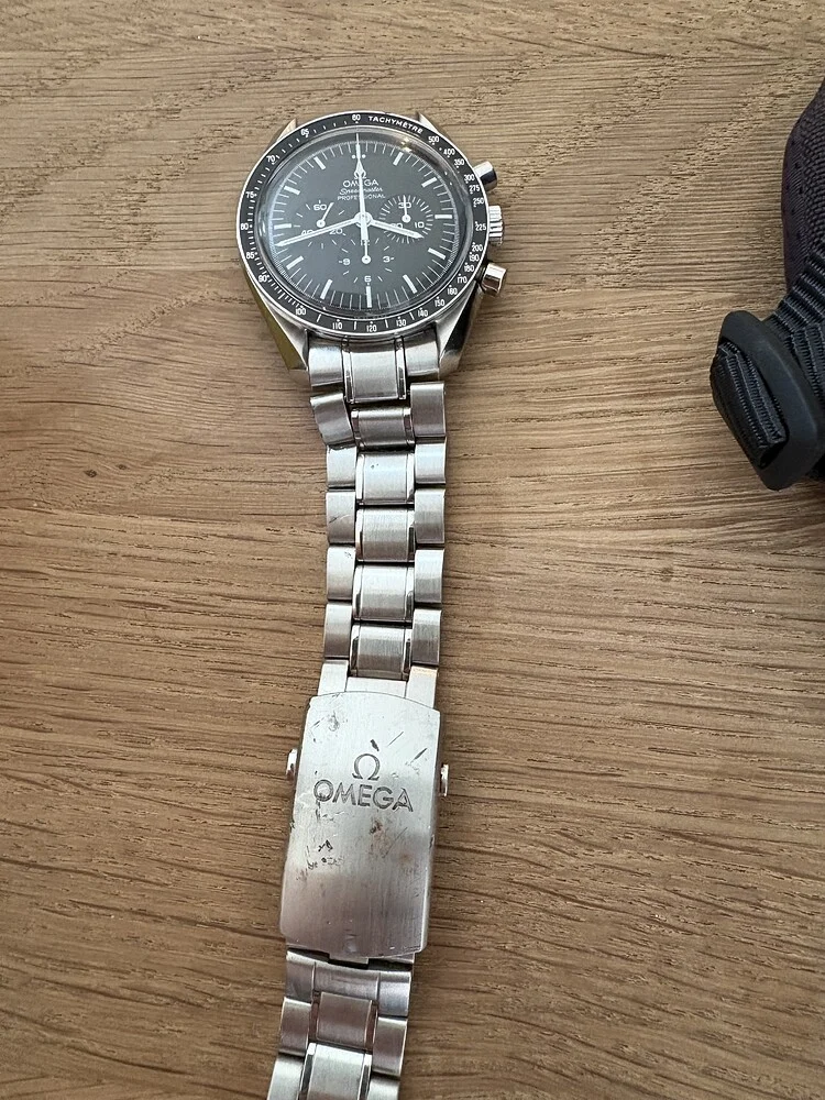

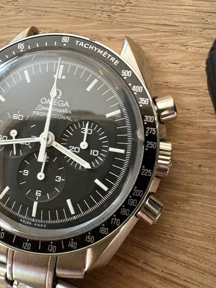

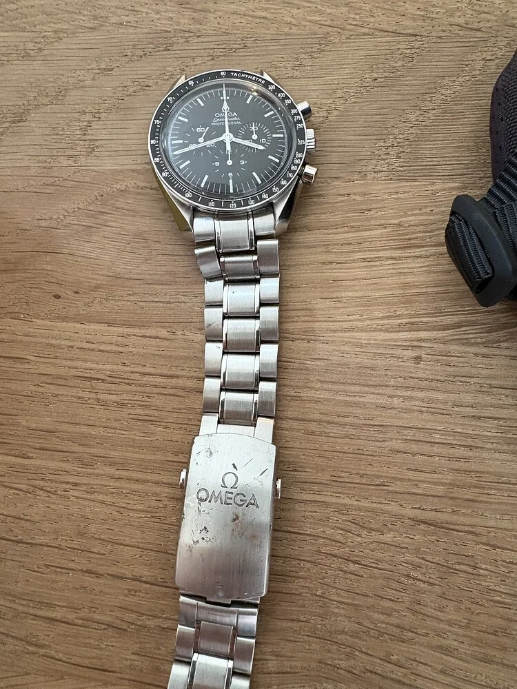

Al, can you tell what needs to be ordered from this pic (Speedmaster 1861), is it the same partsno's you mentioned;
29,839
77,222

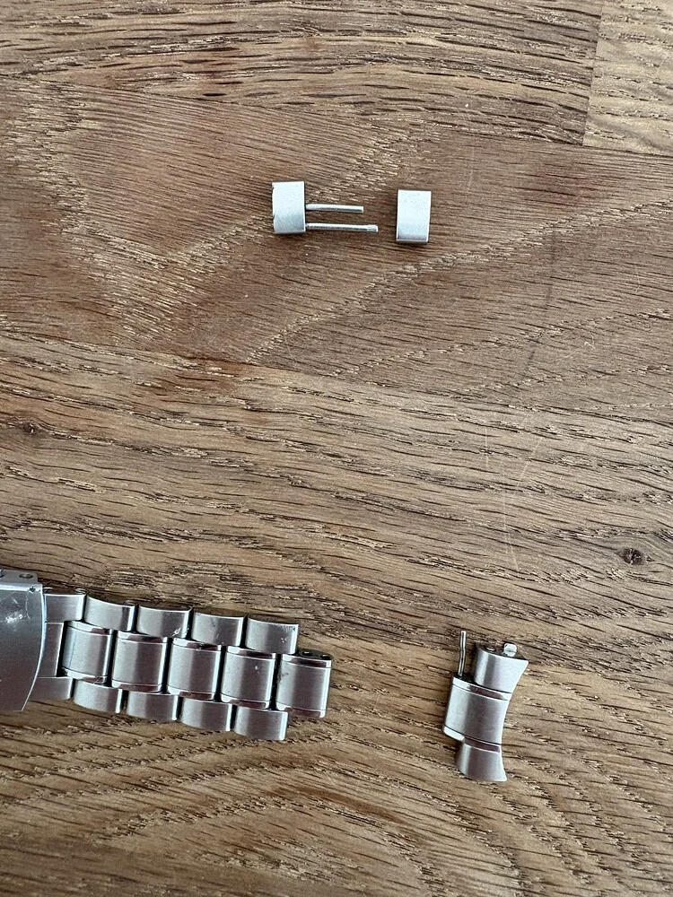

Is this a 1998849?
That is a fixed link that has come apart somehow. Those are not meant to be disassembled...
Omega used to sell a "strand" of links that went from the last link near the end link, towards the clasp to the first removeable link - the part number for that is 119ST1998, but that part is discontinued.
Possibly the link could be put back together using a press and some Loctite, but someone's made a mess of it...

Is this a 1998849?
I'm told a 1958.
