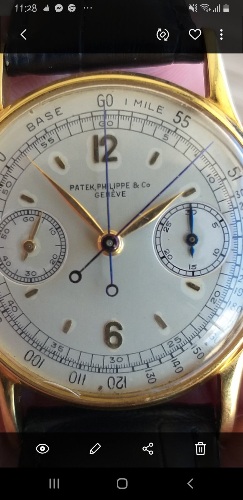

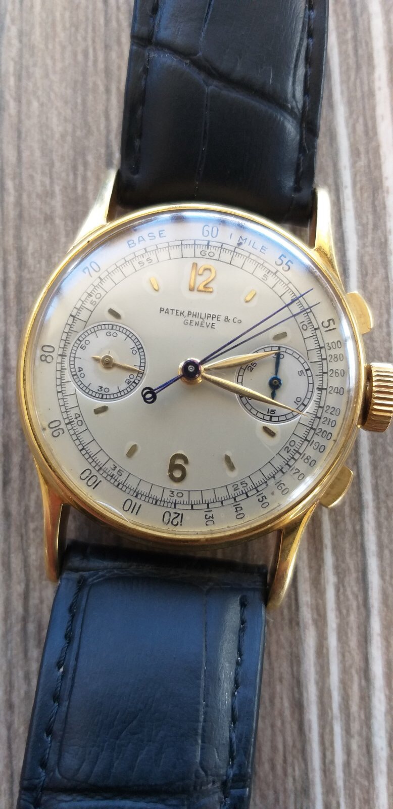

I have been offered a very rare and iconic 1946 Patek ref 1436 rattrapante but it appears to have been redialed. My question is it still worth buying this watch? Will the factory restore such an important watch? Any advice would be appreciated.

I won’t rule it out as complete redial, but the gold markers indeed do look problematic (I.e. it seems like markers were refurbished).
I Guess you already know that if you check the serial on the movement and case back and they match then it is a genuine article. And if that is the case, Patek would actually re-work the dial for you at a hefty price (but I think If this is a genuine article it is worth the effort and expense).

My vintage watch dealer consulted his PP collector Friends who said that the dial looks origina but suggested to get an archive report from Patek just to make sure.

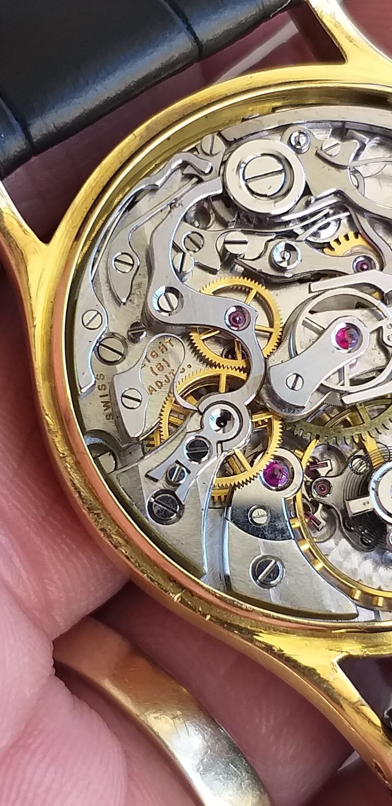

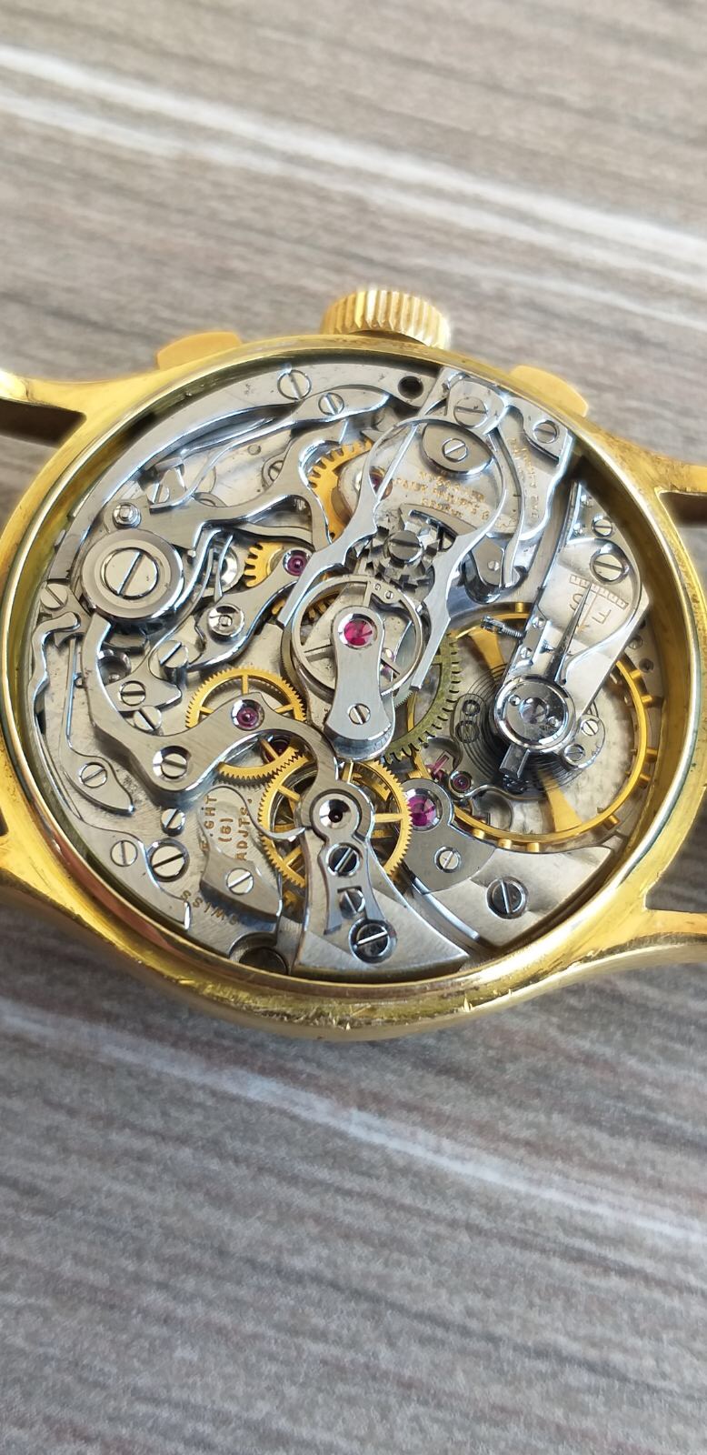

to be honest I had questions about the movement until I saw the capped column wheel which then asks a different question. Was PP doing capped column wheels in 46? I thought it was a more modern requirement to comply with geneve certification and requisite mark.
Ok did some research, PP did cap the column wheel in 1946... Learn something new every day.

The information gives to me that its from 1946 is incorrect. This watch is already a second generation which has a button on the crown to reset the split second hands and came out in 1960. All 1436s prior to 1960 would reset by pressing the crown itself.
1,217
5,230
That dial doesn't look copacetic to me.
My exact sentiment too. Problem is the owner does not want anything to do with getting it checked by PP and securing an extract of archive. This is the reason why im haggling for a really low price.
7,807
14,413
Just be aware that for PP to service a rattrapante chronograph movement you are talking time and money. It would still be worth it IF you can get it at a good price. Dial could be original and would clean up nicely, hard to tell from the pics. I don't know what's going on with those lighter areas around the numerals.. PP has redone many of their vintage watch dials and if done by them to original specifications it does not have nearly as much effect on the value as a new dial does on more main line watches. Many of the PP's in their museum have had their dials redone. A rattrapante PP from that era is very desirable and will always be in demand, they didn't make that many of them. A complete overhaul and reconditioning from the factory would give you a spectacular piece, all depending on what you can get it for.
907
1,295
Wait, this is a second generation right?
If so,there are few things that are "strange" to me. The dial and chrono hands seems to be of the previous model pre 1960 (actually for my limited PP knoledge, the Patek Philippe & co looks consistent with an early model of this reference, circa 1940/1945) but all the 1436 that i saw have a different scale. Although it could be a variant or a client request (not unusual).
The signs around the hour marker is not the first time that i see in a watch (no matter how expensive it is ) and mostly happens with applied marker like that and when the watch was used like this one.
In the end it could be good or not but it needs to be inspected by Patek Philippe, if the seller agreed......and i hope he would agree due the level and value of the watch.
