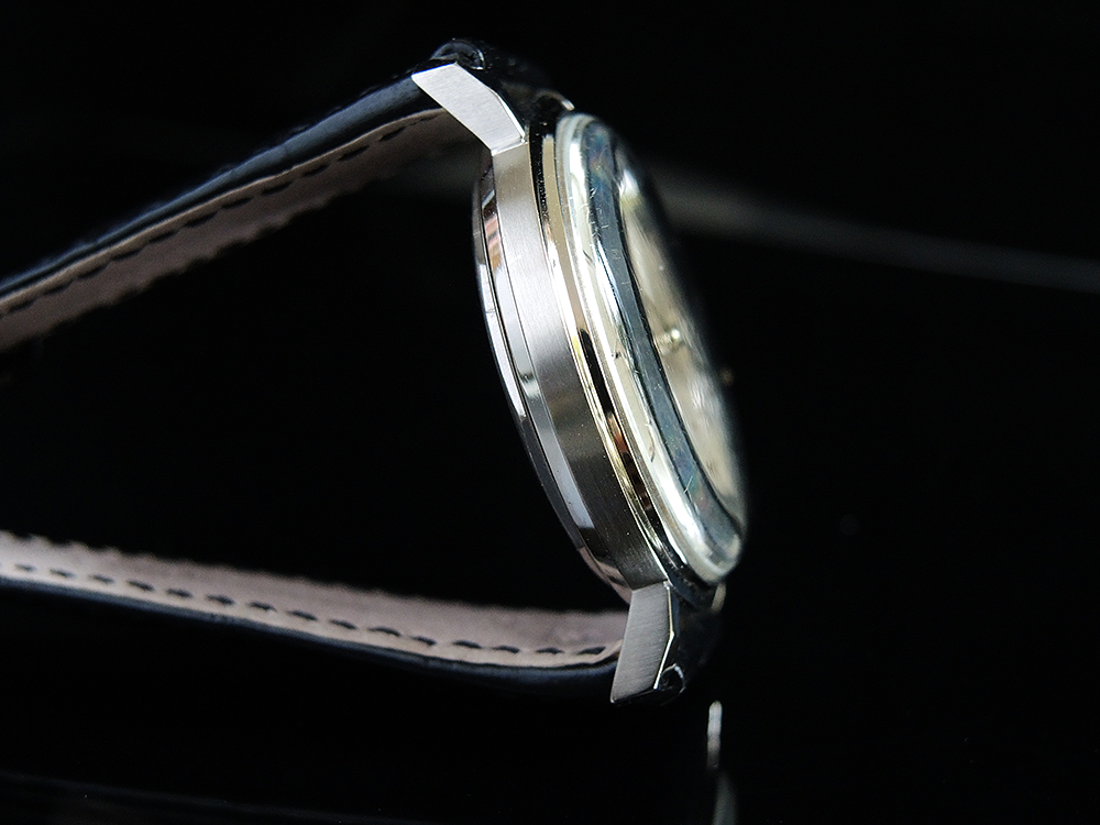

    dear all,
    How is this Patek 3445? does the case look to be overpolished?
    what do you think market value?
    thanks
    [​IMG]

  7. Tony C. Ωf Jury member Apr 9, 2015
    7,385
    24,202
    Classic watch. Has certainly seen some polishing, but I wouldn't say "over-polished".
    I do think that it may be a replacement crown, as I am used to seeing the later style on the 3445 model. Perhaps these were used on early ones, though.
    I don't follow the market closely, but given the polishing and crown question, probably $8-10k.
  8. Xtof Apr 9, 2015
    91
    396
    IMHO the crown with the sysmetric "P" is an interesting feature that adds interest and value - it is much less common than the calatrava cross on the crown usually seen on the 3445 - but only if the extract of the archives confirms that this 3445 was produced in the early 60s.
    However, the negative point is indeed the polishing of the case. Its sides should have a satin brushed finish.
  9. mnementh May 6, 2015
    4
    14
    This crown first appeared on the 2526 (first automatic watch by Patek in 1953 - cal.12-600AT).
    You can see it only on the 3445's first years of production.
    here on a 1958's 2551
  10. mnementh May 6, 2015
    4
    14
    A bit strange to see this kind of crown on a 1964/65's 3445, imho this crown was probably replaced at one moment, maybe to valuate the watch.
    The angular lugs are one of the "must be checked" point for original condition.
    btw, you're right about the brushed sides on the case, vertically on the lugs.
    cisco and Xtof like this.
