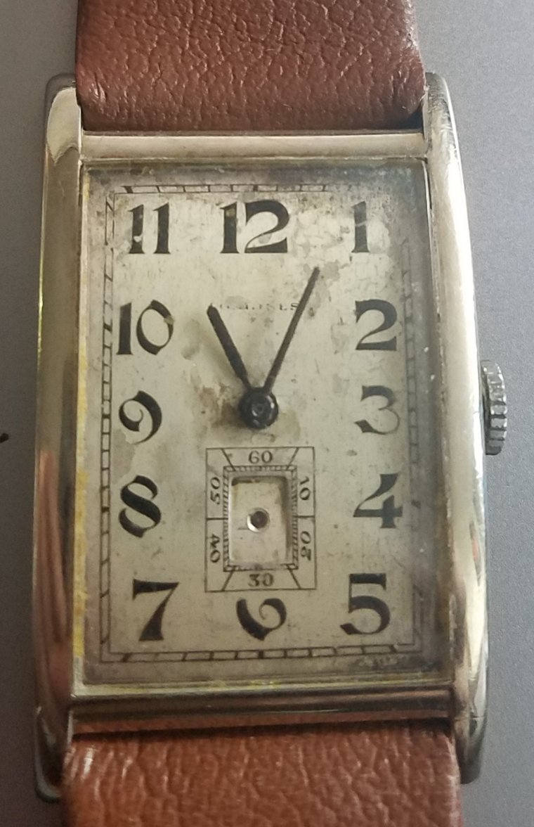

Does anyone have or know where I can get a setting lever and (extended tube) seconds hand for a late 20s Longines cal.10.40 please? It is a kinda huge, rectangular white gold 1927 watch with rather beautiful art deco numerals and I would like to get it working properly.

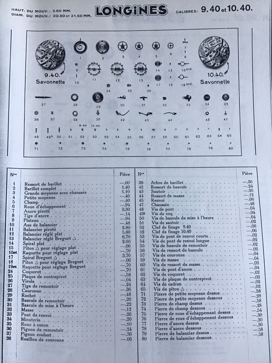

According to Longines parts catalog the 10.40 uses same parts as the 9.40
Maybe this can help you to widen your search? I imagine the second hand
will be no problem to find. I probably have one in one of my drawers😀
Disclaimer: Please ignore this post if it was old news to OP
No, it was really helpful, though I did know it already from an earlier problem I had had with this same calibre. Thank you for your intervention.
Now I know the number of the movement retaining screw which i also need, which I assume is 64 (vis de cadran). I suspect the seconds hand came off because the dial retaining screw has been replaced with one that is slightly too short. Whoever had done it had also put glue on the movement to hold the dial for slightly longer. It was all soft and gooey!
