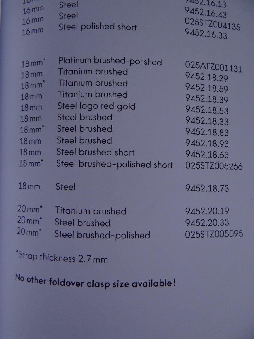

Assuming you mean 98000210 which is 20mm blue rubber. It most likely tapers down to 18mm. Heres a list of clasps.
I found this list of clasps when I was looking a year ago and now it seems like I post it for this question weekly. I don't mind but to eliminate clutter of the same questions, simply google omega folding clasps and click on the first or second OmegaForum result. Comes right up.

So that narrows it down for me, but I'm not positive whether I need the 33, 73, 83 or 93. I can narrow it down farther if I know the strap thickness, but I still can't tell the difference between the 33, 73 & 93.

I misread. Blue dial..... thought you also stated blue strap. Dont forget you need the metal accent end pieces for that strap. I believe I read they are not included and need to be ordered separately. As for the 33/73/93.......
You order the clasp that fits the taper size. So if it's a 20mm tapered to 18mm you order an 18mm clasp. From there you order the finish... brushed, polished, silver gold ect....
I have the 93 clasp with the blue rubber strap and the clasp fits perfectly - I fitted it to my 2017 AT. By the way, just be aware that there are different sizes for the rubber strap. I got the large one and it's almost too big (I'm on the second to last hole), especially after losing weight.
