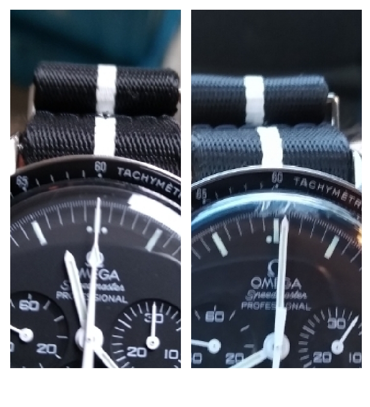

Here is a before (right) and after (left). Had a deep scratch I could feel with my fingernail at 12:00. Polywatch and a cotton ball and it was gone in 3 mins.

nice result! i never polished my alaska but when i read this thread maybe i should give it a try!
do you protect the bezel anyhow or deos polywatch no harming to that anyway?
