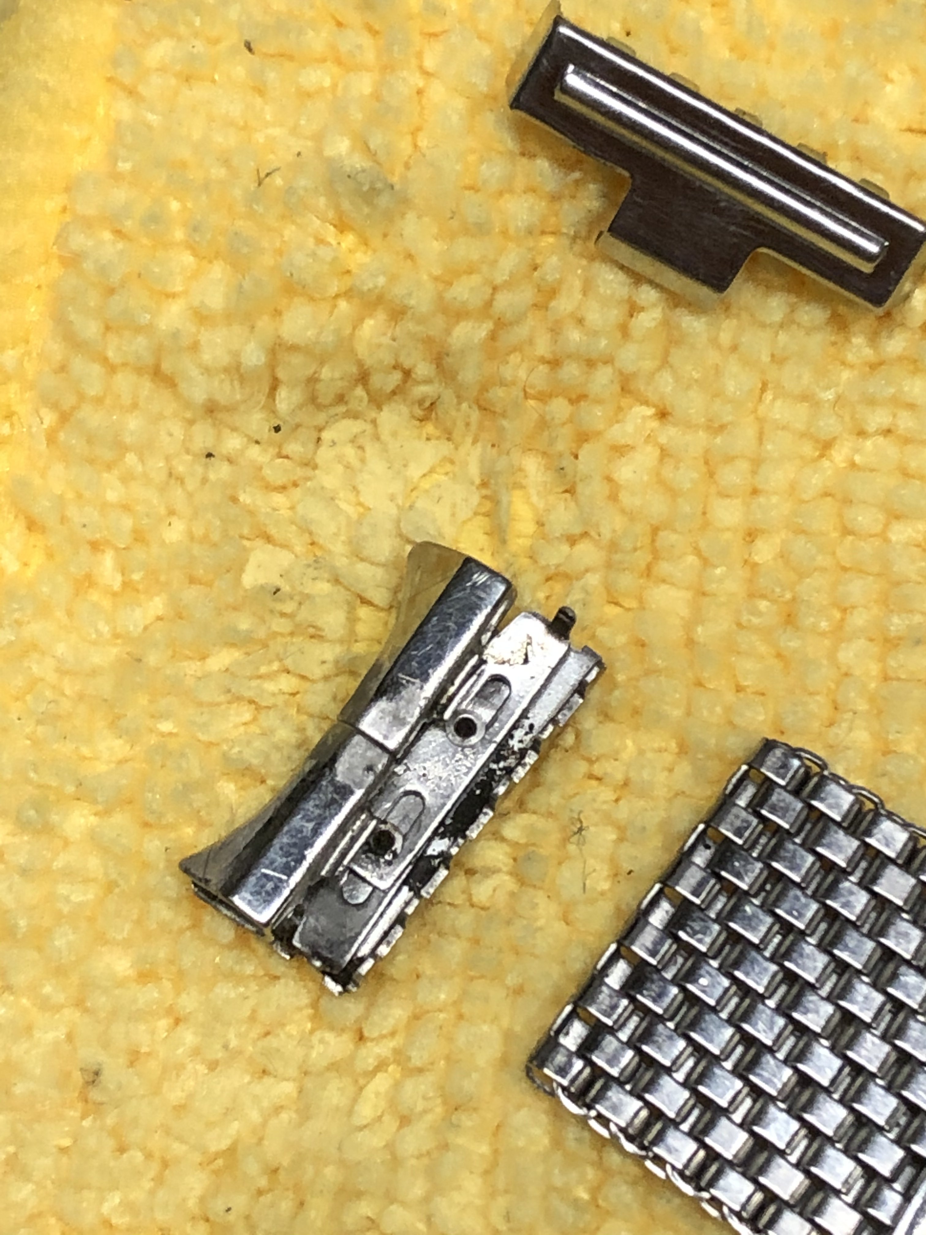

Thanks for the link guys- I followed the instructional and my spring is indeed gone...hmmm.
Now I need a spring

It was surprisingly easy to take apart...after watching someone else do it.

Getting it open is the easy part. Closed back up just a bit more challenging.
Channel locks wrapped in electrical tape (to prevent tool marks) actually worked perfectly to push the cover sides back in followed by flat bladed pliers (again wrapped in tape) to finish off the tabs.

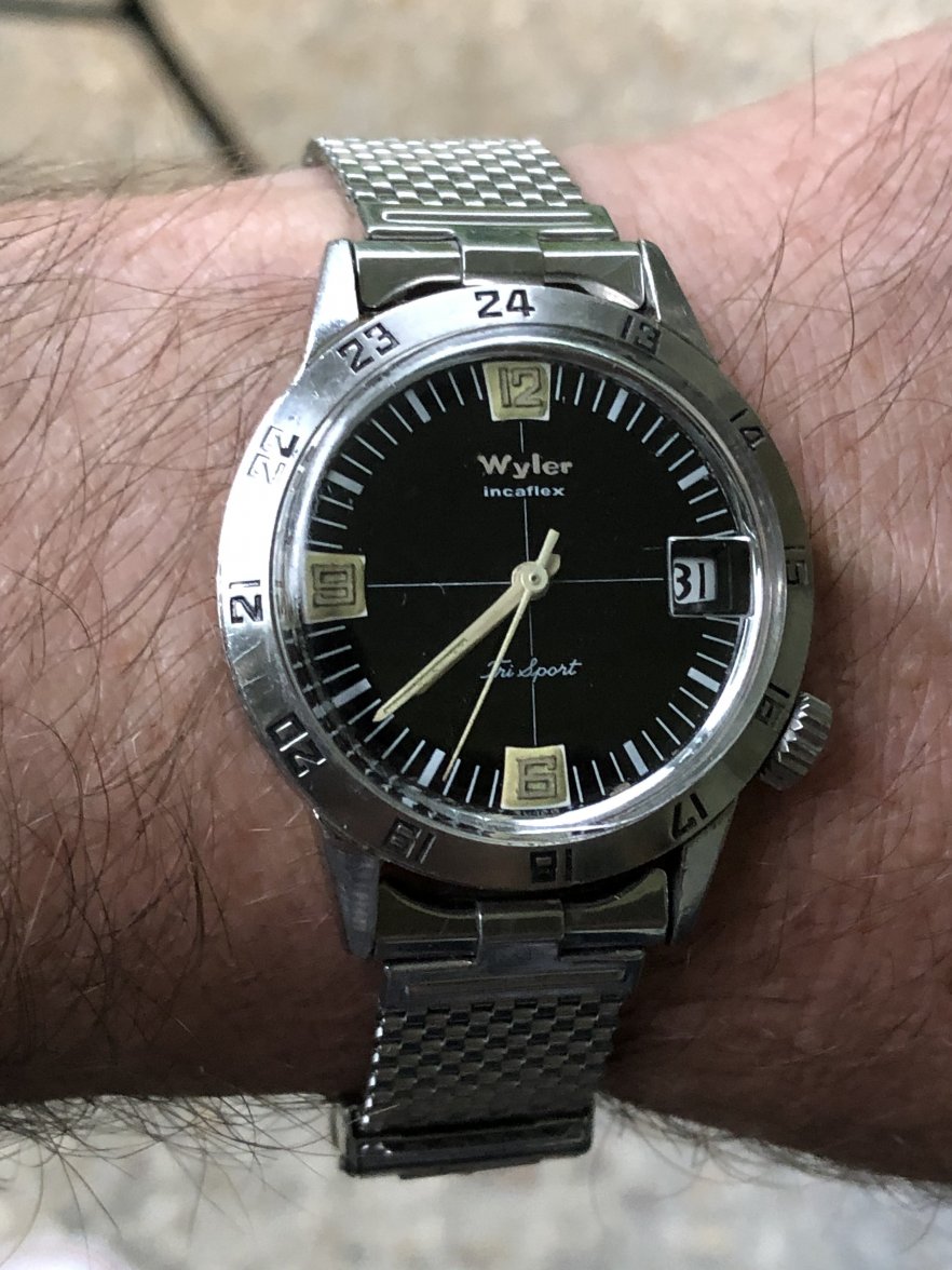

No, it doesn’t- if it’s applying pressure, it will wear. In fact the watch I took this off of had the chewed up lugs. But, that watch had 18mm lugs (the Sprung endlinks only
Go to 19) and most likely had been worn daily, and for decades with this bracelet-as are most we see that have the lug damage.
I am putting it on a watch with 17.5mm endlinks that may get worn once a month in my rotation- I’m doubting it would cause much wear over the course of a decade. But on a Speedy with 20mm lugs (as this bracelet is most known for), it wouldn’t even touch the sides and there would be a gap, so it shouldn’t cause any damage other than maybe some scuffs inside the lugs from sliding around- it’s not applying pressure.
But this brings up an interesting idea- that of reducing spring tension.
Has anyone thought of cutting and stretching the spring to reduce its tension applied to the lugs? Would that reduce the effectiveness of the spring loaded covers to hold against the lugs and not show a gap?

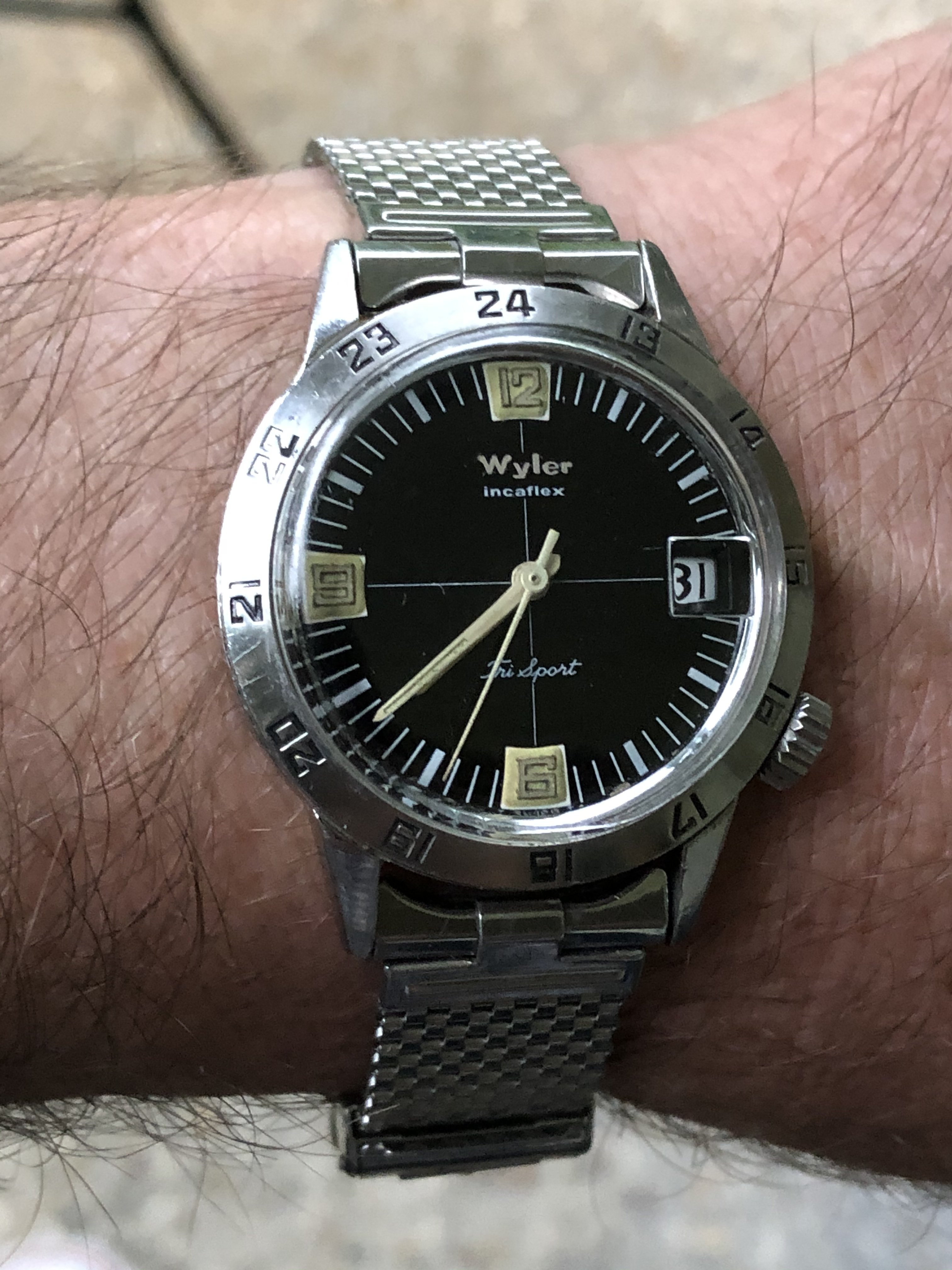

Thx JW, they look great, I hope you can MacGyver a fix for yours.
16,305
45,025

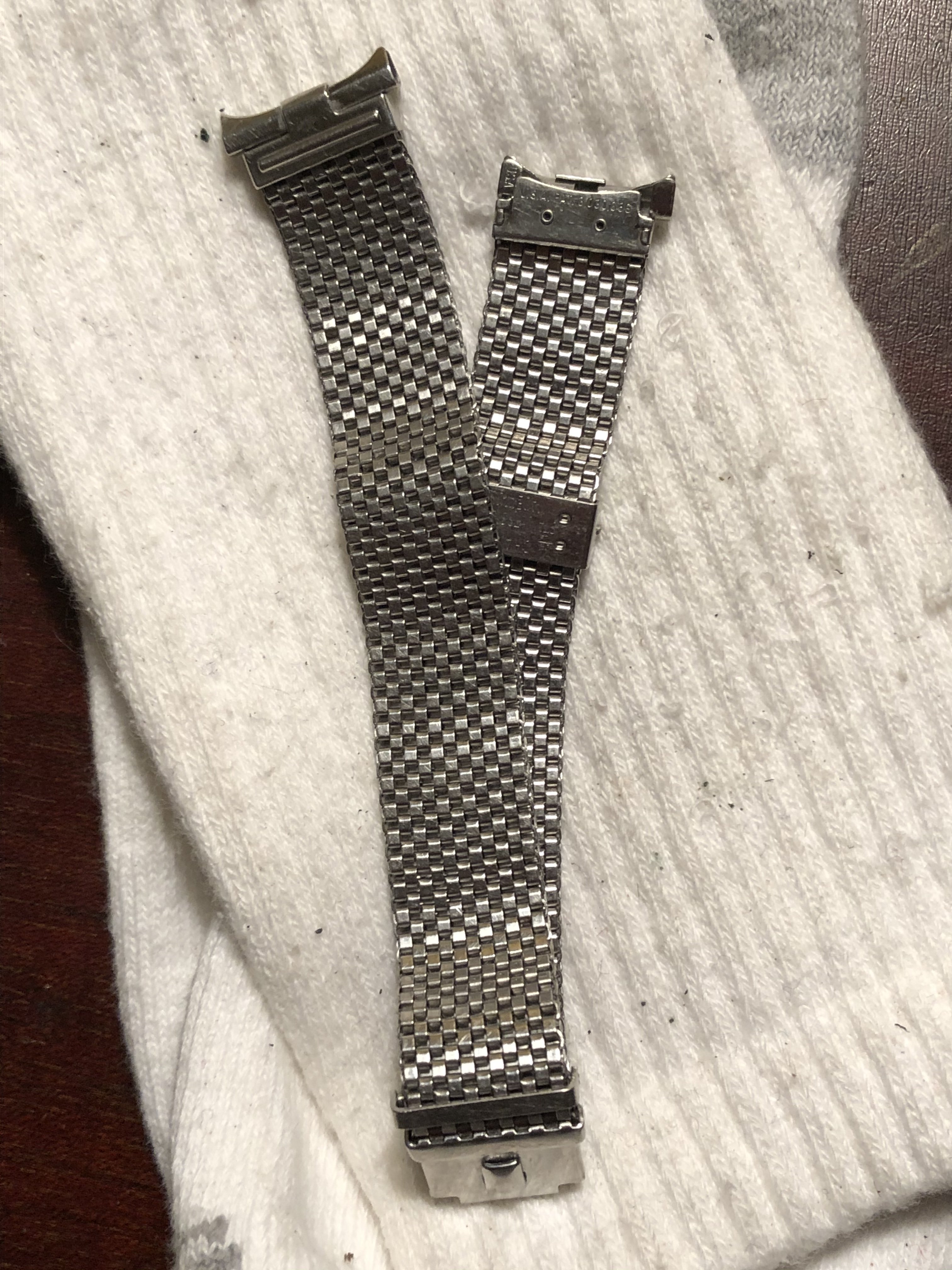

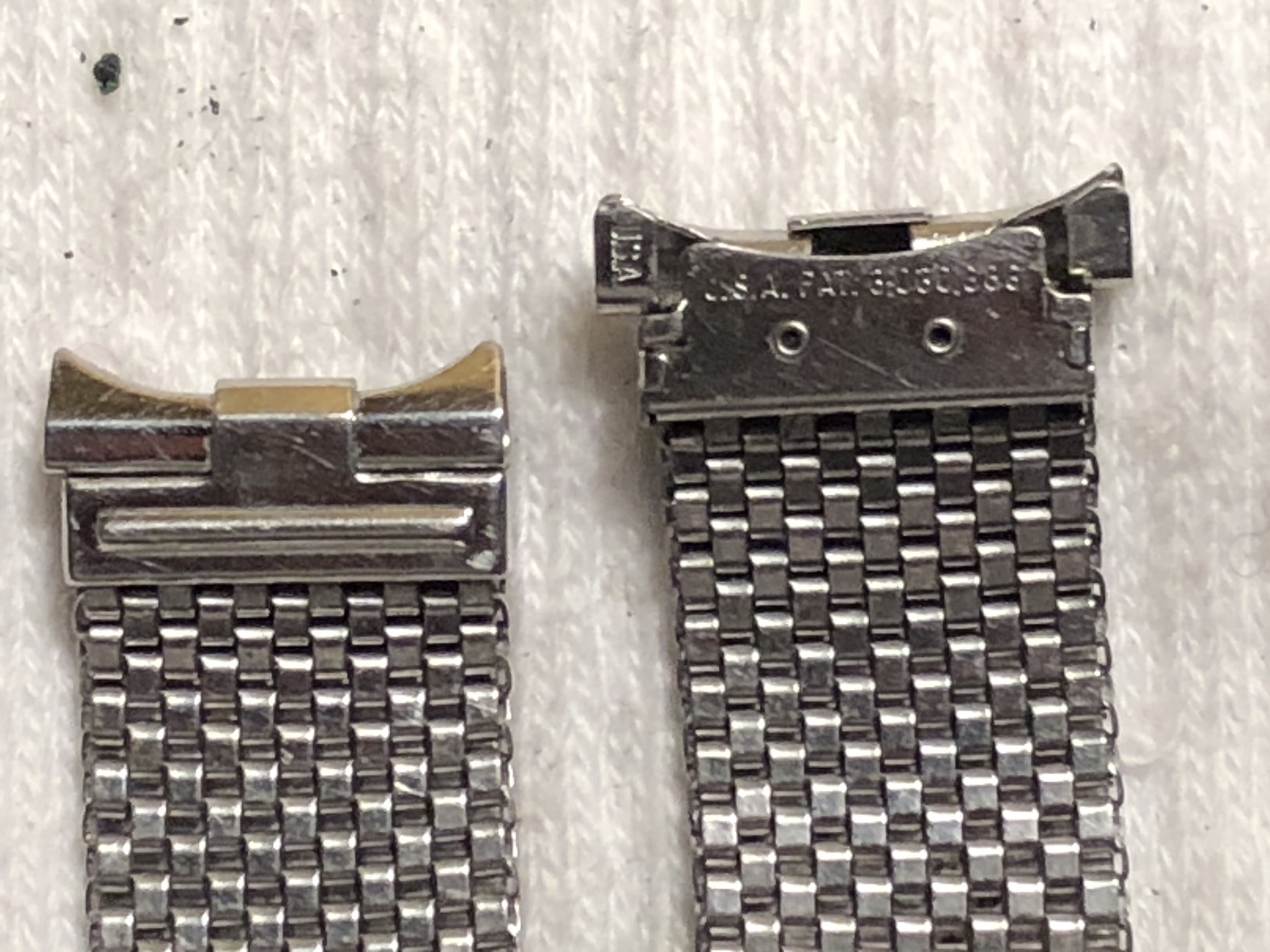

It’s still wearable, it just shows a little gap and the covers creep back periodically. And the endlink rotates down whereas the pressure on the other side keeps it pretty well aligned.
7,382
23,843
