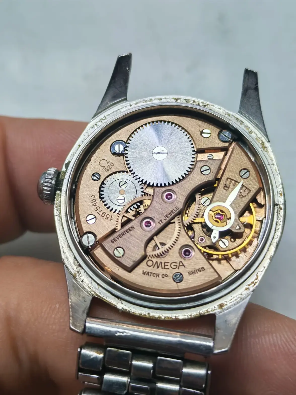

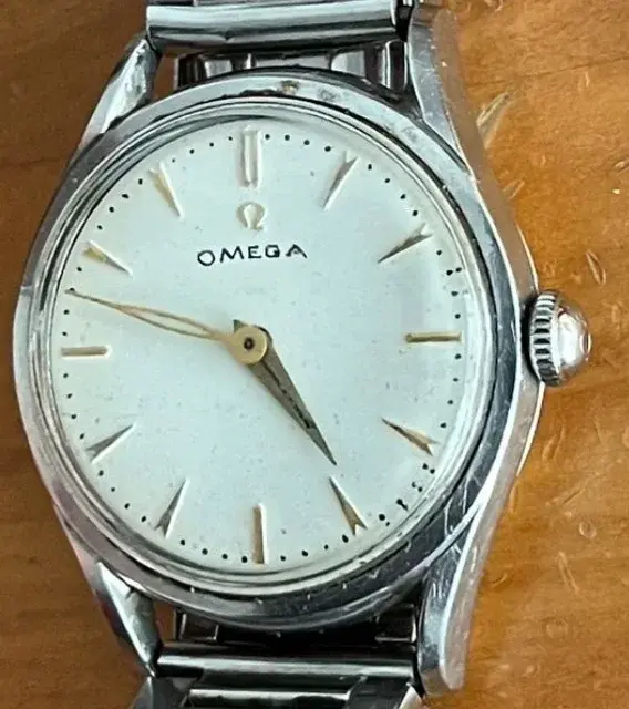

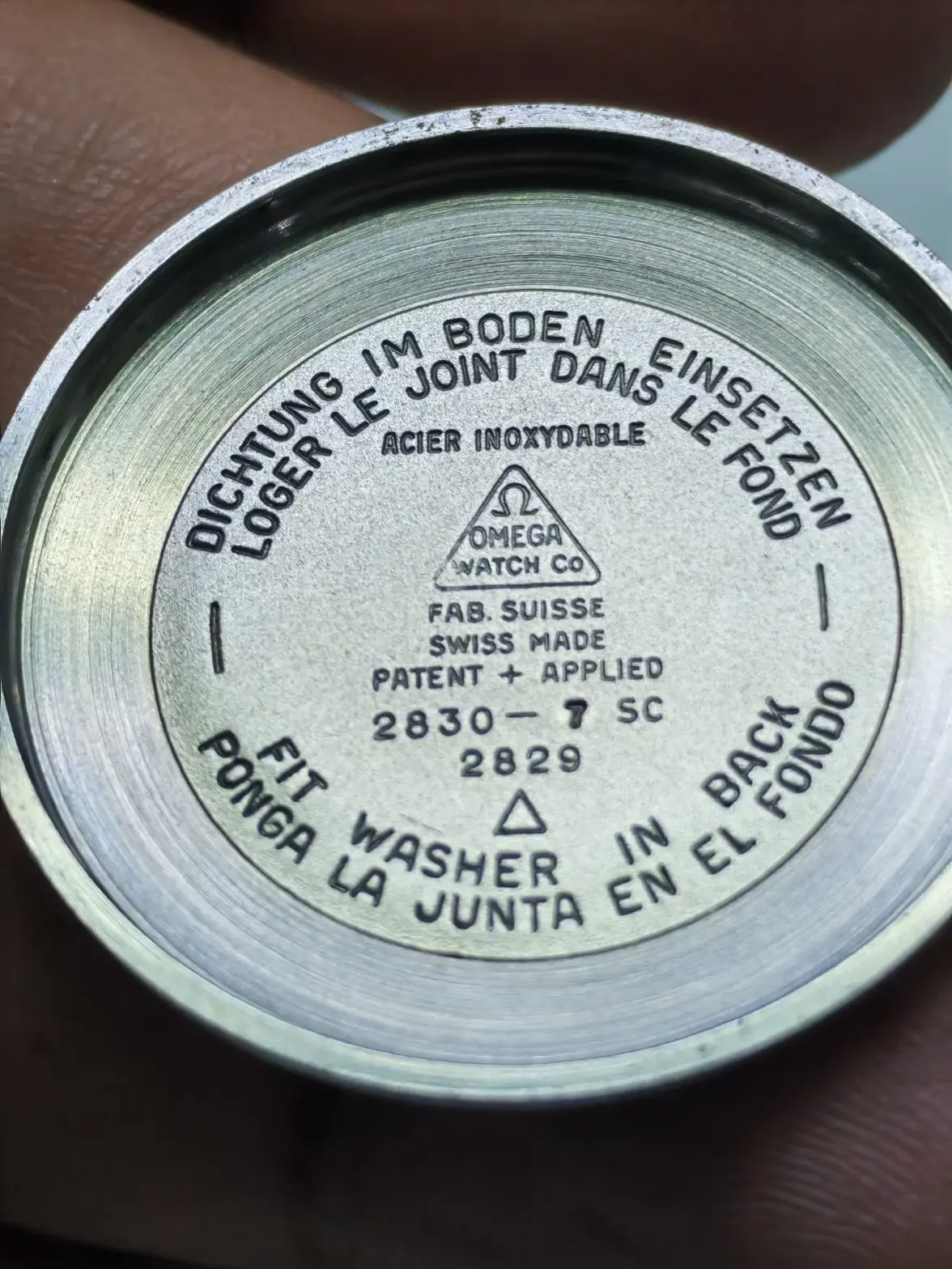

Hello everyone,
I'm restoring my grandfather's Omega Seamaster ref. 2830-7 SC, Cal. 420, serial 15975463 (1957). The hands were replaced at some point and I'm sourcing NOS Dauphine gold hands to restore it to original configuration.
I've confirmed through photos that the original hands are Dauphine, gold - but before purchasing I need to know the exact minute hand length (center hole to tip, in mm) correct for this reference.
Does anyone have a 2830-7 SC with original hands they can measure, or know the correct length from experience?
Photos of my movement and case back attached. Thank you very much.

Just measure to the end of the markers. That will be close enough. Same for the sweep hand.

Thank you for the reply! I should have clarified this in my original post, the hands in the photos are not original. My grandfather replaced them at some point, so measuring them won't give me the correct reference length.
The current hands are stick/baton style (not the original Dauphine). I've confirmed through other photos online that the original configuration for this ref. 2830-7 SC was Dauphine gold hands.
My question is specifically: what is the correct minute hand length (center to tip, in mm) for the original Dauphine hands on this reference? The dial diameter is approximately 27-28mm for a 32.1mm case.
Does anyone have a 2830-7 SC with original hands they can measure, or know this from a parts catalog? Thank you!

You didn't read my response. Measure the dial from the pinion to the end of the markers, that should be quite accurate. It is unlikely someone is going to remove the movement from their watch to measure the hands for you. And honestly, the measurement you can make using the dial will be just as good. It's always better to make your own measurement than to trust someone else, unless you really know them well.
The hour hand is plausibly correct, but obviously when the dial was repainted, the lume was removed from the ends of the markers.
