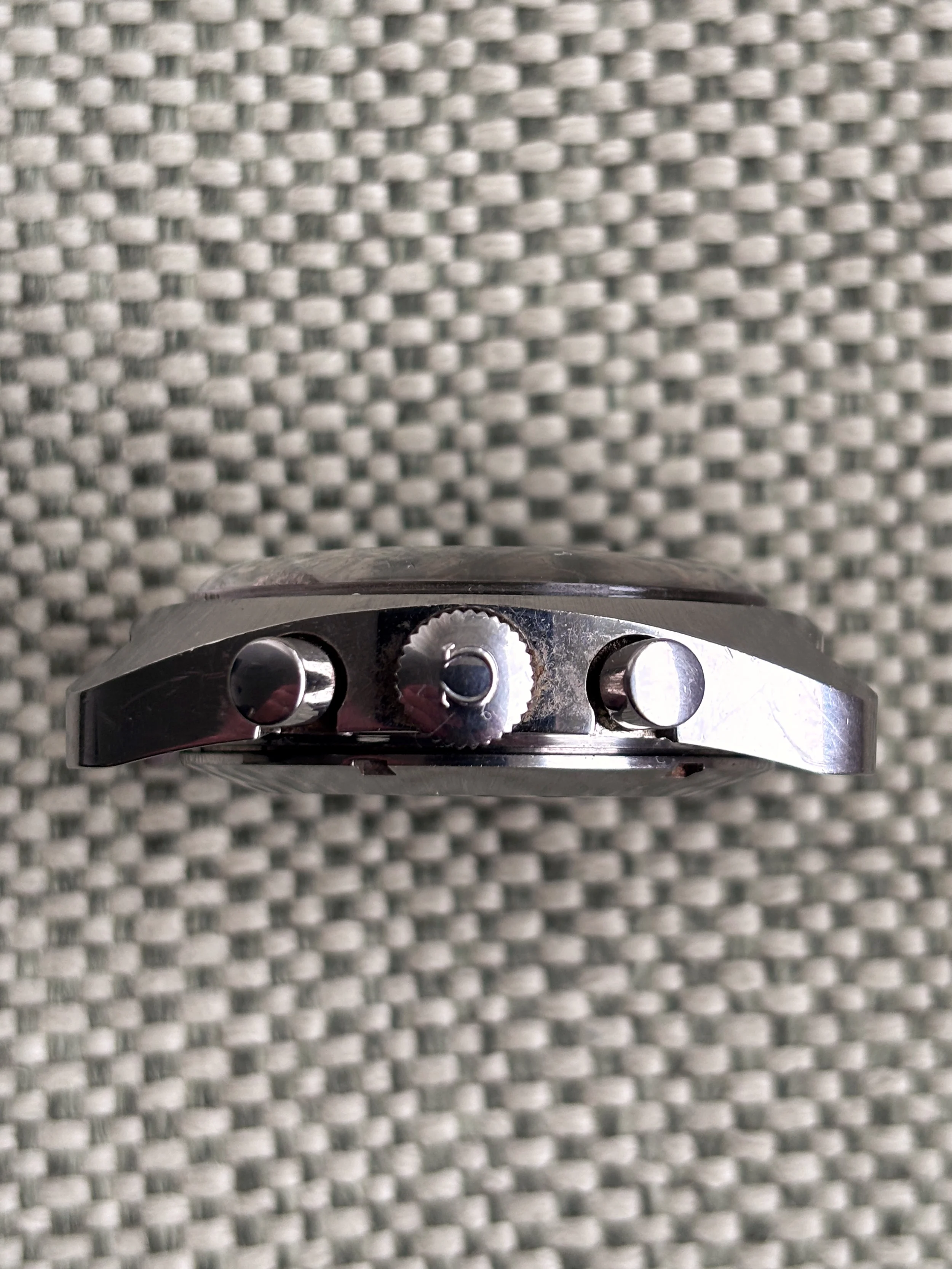

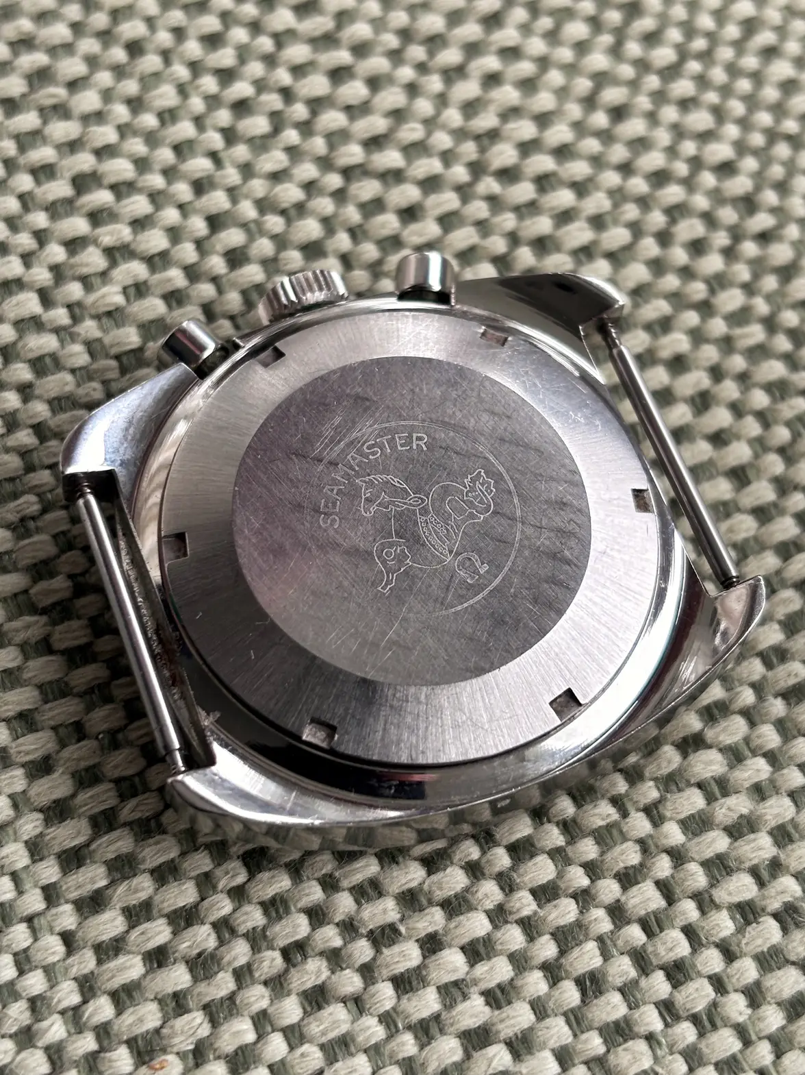

Hi all,
Following on from my earlier post about picking up this 145.029 cheap because it had been listed as quartz, I'm now working through a decision on the service and want the collective wisdom here.
My Omega certified watchmaker has said that if I want a guarantee on the work and a proper pressure test, the crown and pushers need to be swapped for new genuine parts. If I keep the originals, he'll still service it, but won't warranty the work or pressure test it.
So it's a straight trade-off... full originality with no guarantee and no confirmed water resistance, or a warrantied, pressure tested watch with two non-original though correct new service parts.
For those who've faced this call before, what would you do?
Keen to hear how others have handled it.
Matt

I consider anything that old to be splash resistant at best anyway, just don't get it wet. Not sure why it would impact warranty for anything other than water intrusion though, if its all clean and lubricated the crown and pushers shouldn't be a factor?

Get the new crown and pushers and guarantee waterproofness. This is standard practice in the industry. Any authorized service would require this as a condition to warranty the watch.
At the end of the day, they're just pushers, and should be very similar to the vintage parts (could be minor logo changes, etc.). This isn't a patina'd dial in question. Non-issue in my opinion.

Funny enough, I was just having a conversation with @Ron_W in another thread about this. I am also wanting to have original parts but maintain water resistance, specifically keeping humidity and moisture out. Apparently, you can dig out the old seals from the crown through an arduous task with tweezers and then poke in a couple of replacement seals. This can see you up to 3ATM which is more than you are ever likely to need on a 60 year old watch!

I mean that this isn't a rare part being swapped out. They're just pushers and a crown, and having modern variants on the watch makes no impact on its value. It's only upside and no downside, plus you'll have the originals on hand.

Doubt the authorized Omega watchmaker would do that and spend 2 hours surgically removing dried up rubber from a crown. Cool concept, but replacement is the industry standard.

It’s something you would have to do yourself or pay a watchmaker to do. It’s a pain but that’s the only workaround if you want to keep all original parts and maintain water resistance.

Thanks for your responses… although I’m getting some mixed messages. Right now I’m leaning towards keeping everything original, there’s something nice about the way the crown angles into the case… from memory the modern crowns have a more flat profile on the case side of the crown…

If the pushers have screwed on caps you can change to new pushers for safety ( they have new tiny O rings ) and screw the old caps back on if the new ones are to different in color or shape. That worked fine on my Speedmaster.
I dont have experience with Seamaster crowns so i am not sure if the gap in the back is large enough to clean out the old O rings nor do i know the size for the O rings. Tube in the case outside diameter minus 0.1 mm = inside hole for the O ring .
Best option is to change to a new crown for safety and enjoy it, then wait for a rainy Sunday to see if you can clean out the old one. Also ask your watchmaker for an extra stem to use for the old crown.

If it’s going to be worn twice a month I’d leave the originals, if you’re wearing it more frequently I’d have service items used and keep the originals.

I’m of the camp to always replace crown and pushers during service, even on a vintage watch, unless it is so much more valuable as an original untouched version that replacing them devalues the watch by a significant amount.
And this isn’t that type of watch. 😉

Thank you all for the valuable advice, very much appreciated. I’ve now been swayed back to new pushers and crown. I’ll post pictures once the service is done, looking forward to wearing this one. Thanks, Matt
