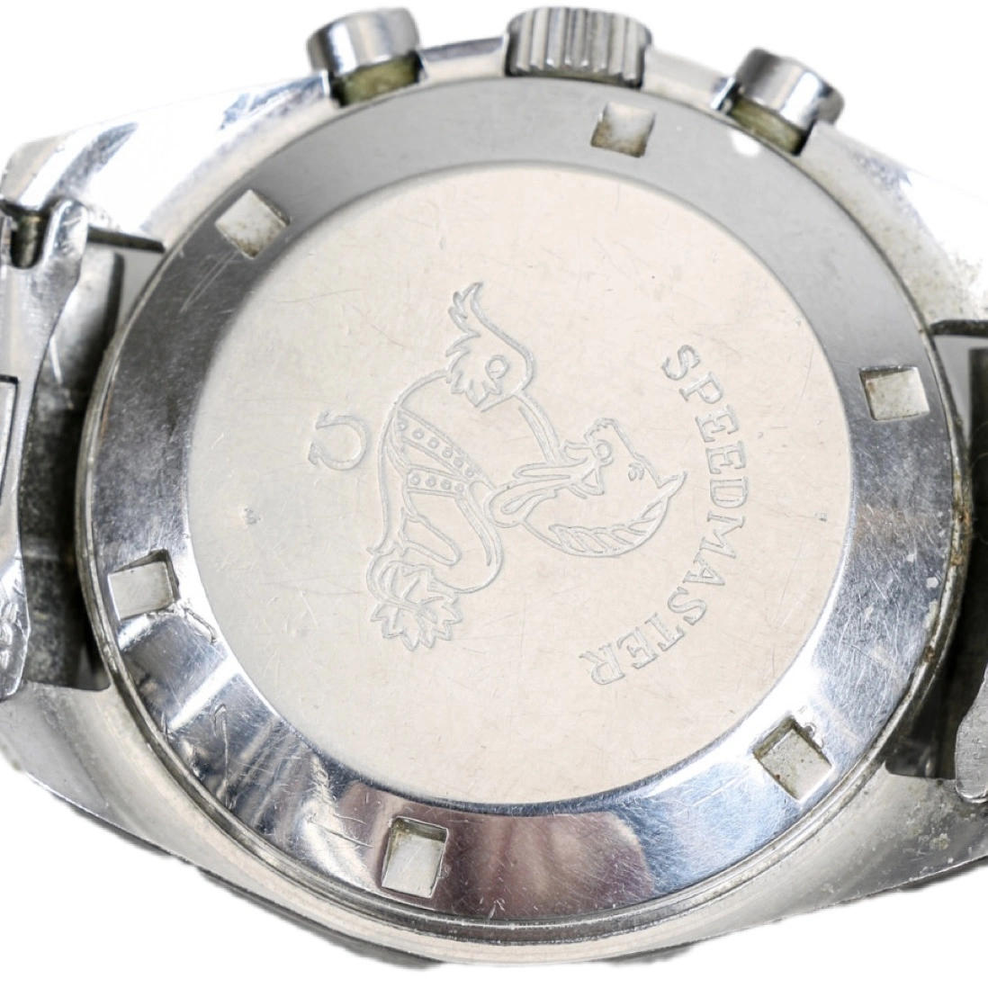

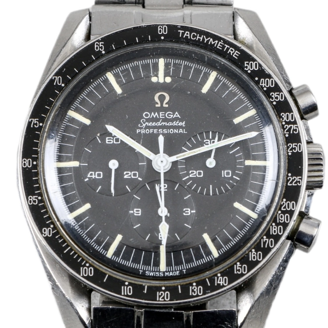

Hi!
I have the opportunity to buy a vintage speedmaster but I feel lost in the jungle of serial numbers and small variations in appearance.
Does it look like this one has the original and correct dial, hands etc. and what is the approximate market value?
ST 105.012-66 CB
2495XXXX
Cal 321
13,553
23,497

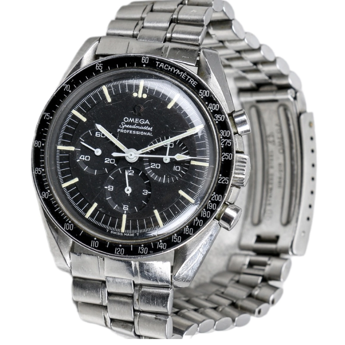

It appears largely correct, but;
1. The case has been polished. It’s not possible to say how badly from those photos.
2. The pictures are highly enhanced. It’s not possible to judge the dial condition or attractiveness from them.
3. Bracelet is wrong.
From what I can see it could be worth anywhere from £3500 to £6000 depending on the condition.
24,833
55,242
The lume on the dial looks kind of weird and toothpasty, but the photos are also really bad. The case is obviously pretty rough, but at first glance I'd say the most important thing is to get a better look at the dial.
Strange end-links.

Looks like most of the important bits are there. The biggest detractor is going to be the case. For a CB case, you want to see those facets.

7k € or offer, I do not have the chance to inspect it further but have asked for better pictures. The seller is legit but not specialised in watches. I can return it after inspection but at a cost…

Strange end-links.
I thought so too, what about the colour of the lume, shouldn’t it be darker by now if it is original?
24,833
55,242
It’s not possible to generalize about that. But better photos will help.
