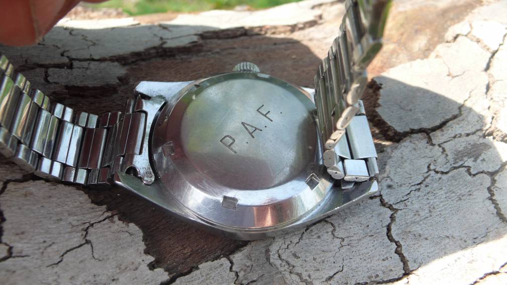

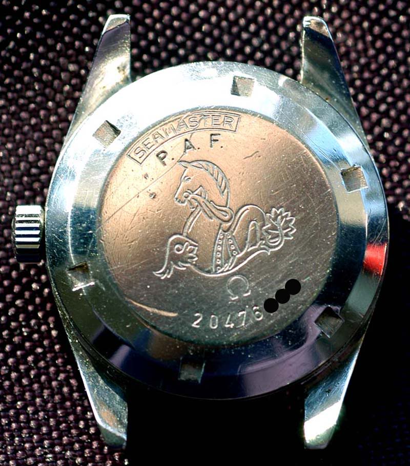

  9. sohail Mar 19, 2013
    445
    154
    jimin excellent info and new to the internet forums... great . Here is a sample of corrcct military railmaster /seamaster watch back . please note the movement number engraved under the PAF markings. railmaster 001.JPG
  10. watchyouwant ΩF Clairvoyant Mar 19, 2013
    5,010
    8,347
    yes, but PAF is pakistani airfoce; not peru. PAF must have a seamaster amag. dial , not a flightmaster dial. kind regards. achim
  11. sohail Mar 19, 2013
    445
    154
    Yes it has a Seamaster dial , what I wanted to stress was that the military railmasters/seamaster s/ flightmasters should have the movement numbers engraved on the outer back.

  13. watchyouwant ΩF Clairvoyant Mar 19, 2013
    5,010
    8,347
    not all, only the pakistani version had the mvmt. number outside. kind regards. achim

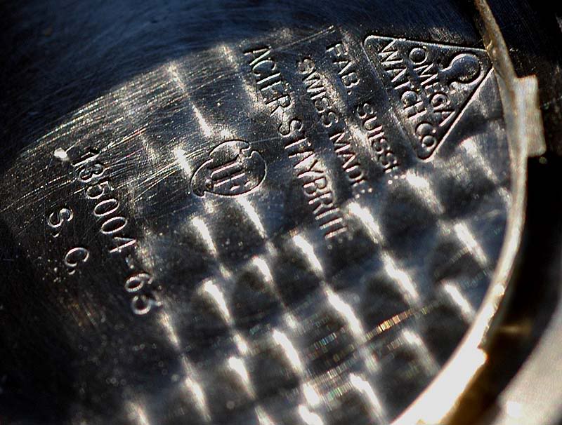

  14. pitpro Likes the game. Mar 19, 2013
    3,068
    3,526
    Here's info I have. Taken from seller's description in eBay auction.
    Take for what it's worth.

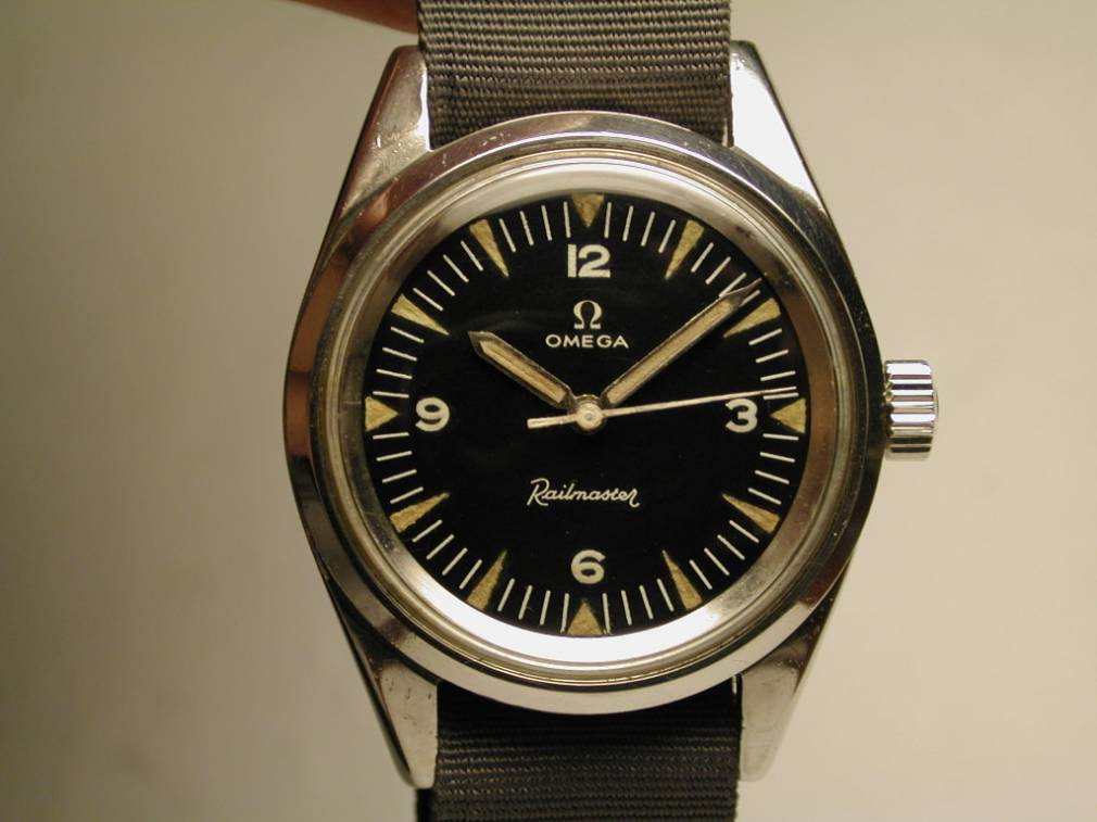

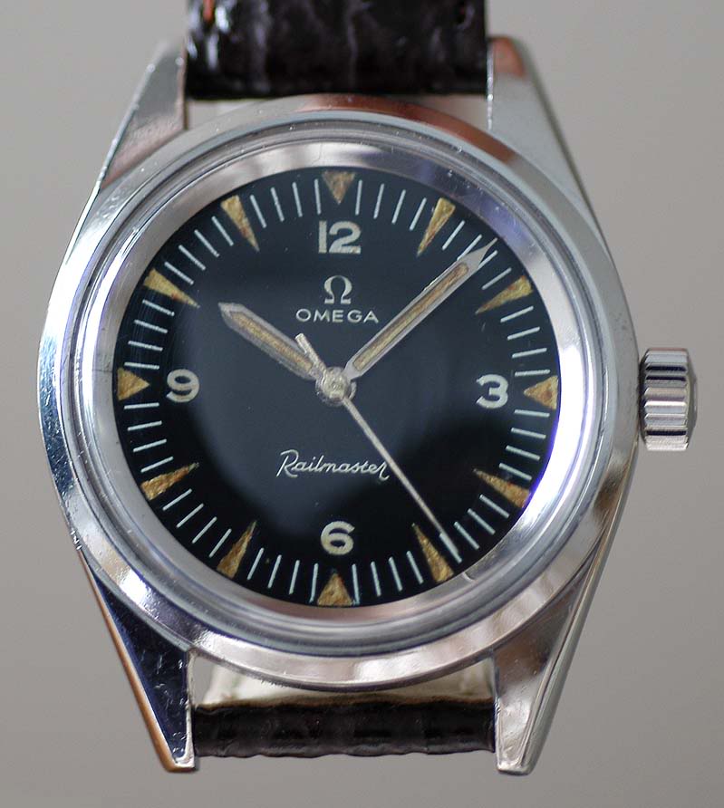

    Pic I have of last Railmaster 135.004 which is what ebay above is supposed to be lastRailmaster135.004.jpg
    PAF Railmaster. 135.004 Pics borrowed form Franco
    PAF_railmaster-Franco.jpg PAF_insideback-Franco.jpg PAF_rail_back-Franco.jpg
  15. watchyouwant ΩF Clairvoyant Mar 19, 2013
    5,010
    8,347
    yes, your pics. are correct. both watches are the same; just a different angle and light. i sold this watch with omega confirmation to franco. kind regards. achim

  18. sohail Mar 23, 2013
    445
    154
    Hi pitpro the sellers description is for the normal railmasters ... Not the PAF ones . I am 100 percent sure that none of the railmasters were delivered to PAF with the normal railmaster logo. All of them were with the Seamaster logo. Ck 2914 and 135.004 were both delivered to PAF . Ck2914 did not have the seahorse logo and the movement number was engraved at the outer case back, also a tiny PAF was also engraved on the movement. The 135.004 had the seahorse with the movement number engraved outside of the case back. The 135.004 to my knowledge did not have tiny PAF engraved on the movement. There is a huge price difference in the normal and military railmasters , therefore a lot of them u will see in the market are converted PAF ones .
