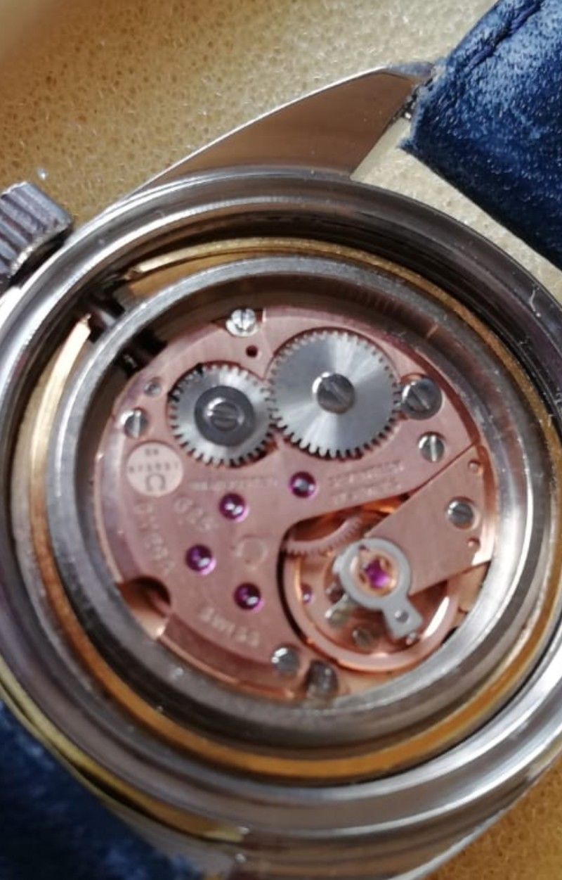

    Hi,
    This I am told is a Seamaster 120 32mm with a manual cal 625.
    I can't find a similar 2 hand 120 anywhere.
    Is this a Frankenwatch?
    Best,
    Ian

    Those hands don't look correct.

    Ref 535.007 should have a caliber 630 movement which has second hand.
    OPs watch is a complete mess, the caliber 625 is completely incorrect for this reference, or any ladies SM 120.

    Thanks for your advice. I will steer clear of this one.........
