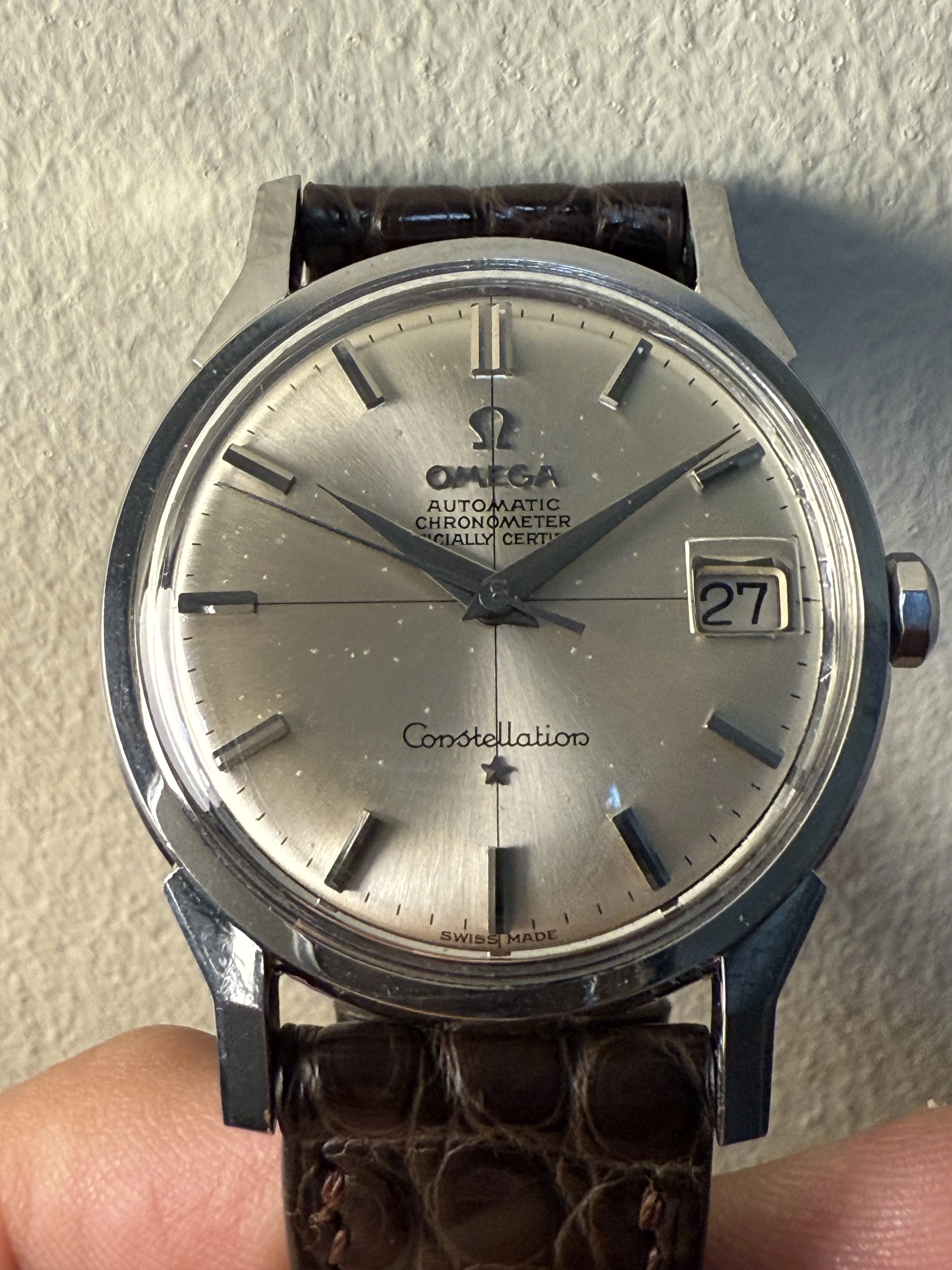

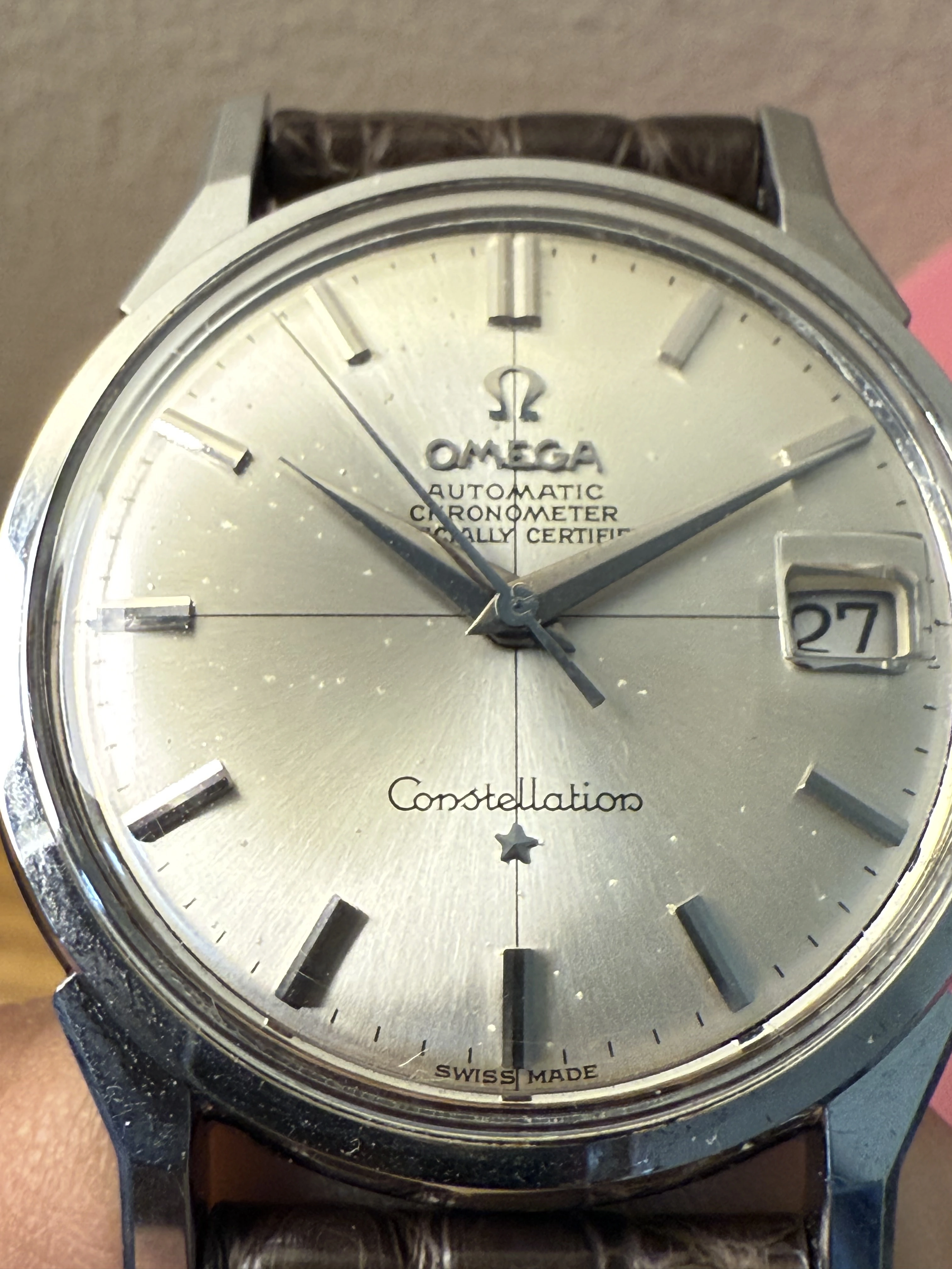

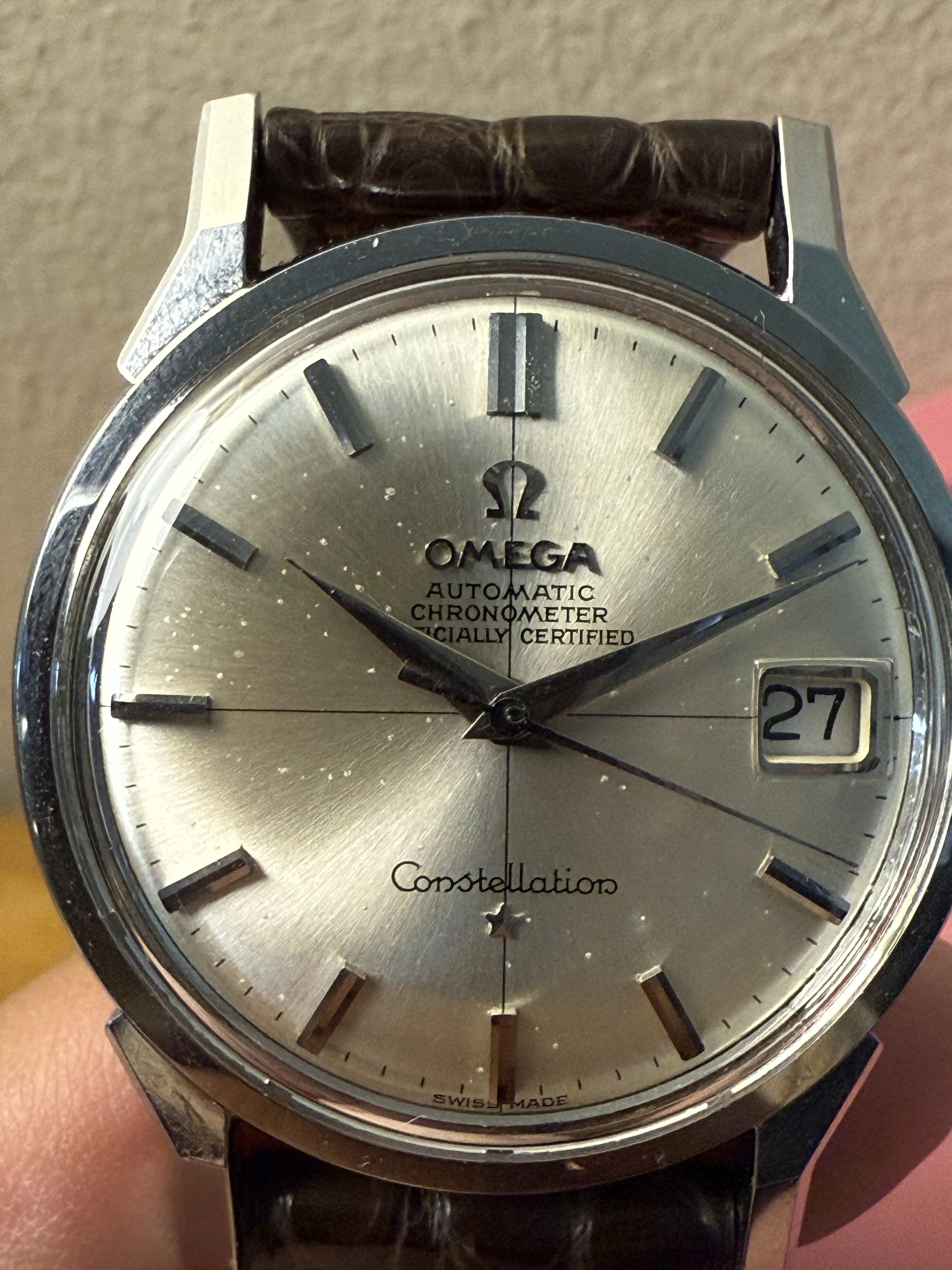

I just found this one on a local group and wanna close the deal but the one thing that gave me concern is the star doesn’t seem well-aligned with the vertical line (and the distances between the vertical line and “swiss” and “made” are not the same). Please give me some advices!!
2,814
6,941
I think the star is fine. I’d want the watch to be cheap with those spots on the dial though.

Tks for your opinion. The price is 728usd. Is that cheap enough

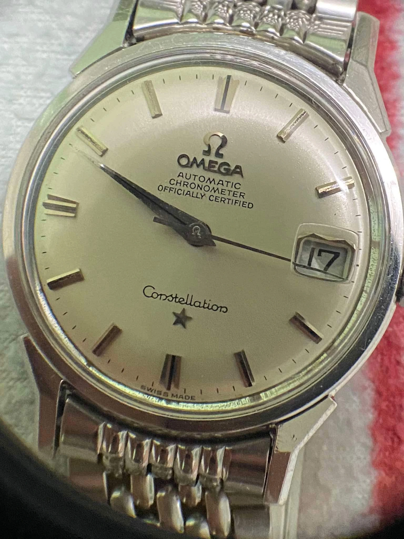

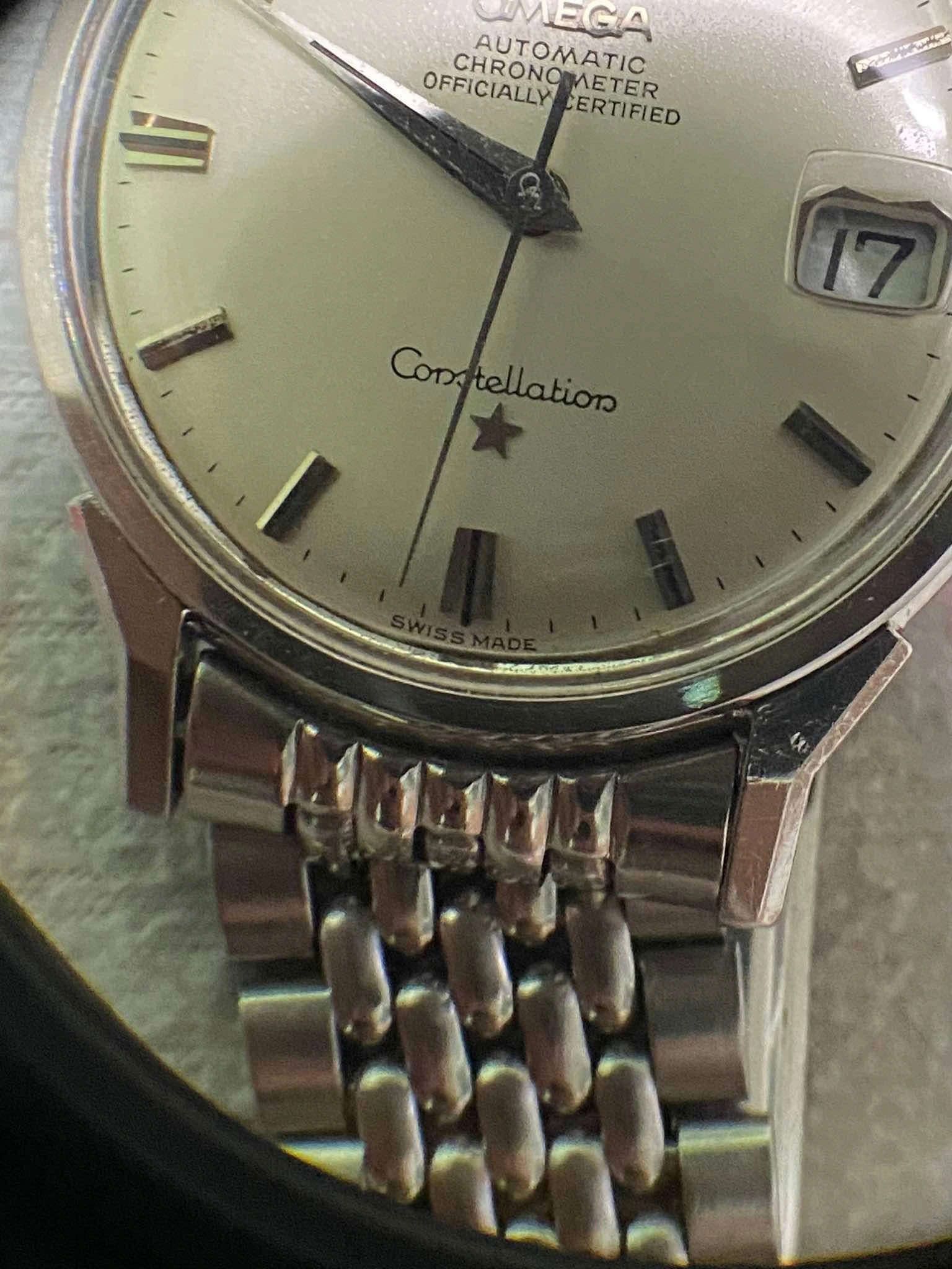

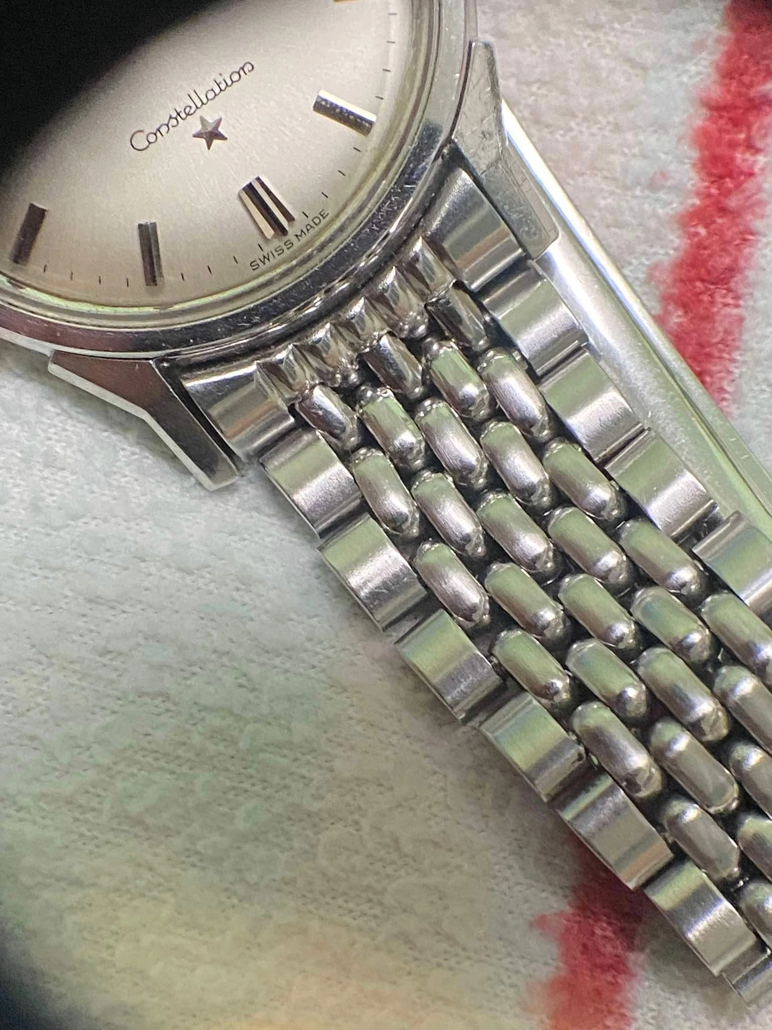

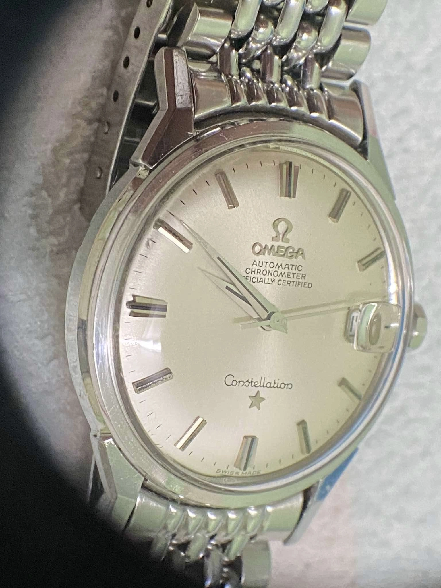

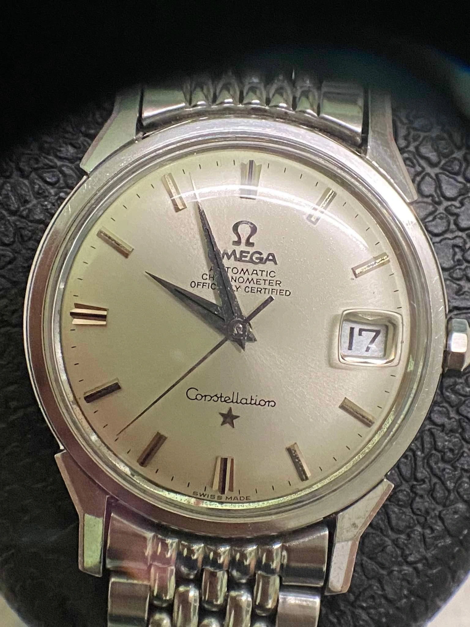

Here another one but this one only get onyx at 6,9,12 marker. Is that normal because this was the first time I saw one

The second one they ask for 104 bucks (bracelet included).
6,765
10,421
It’s not onyx, it’s paint and it’s simply worn off the other indices.
6,765
10,421

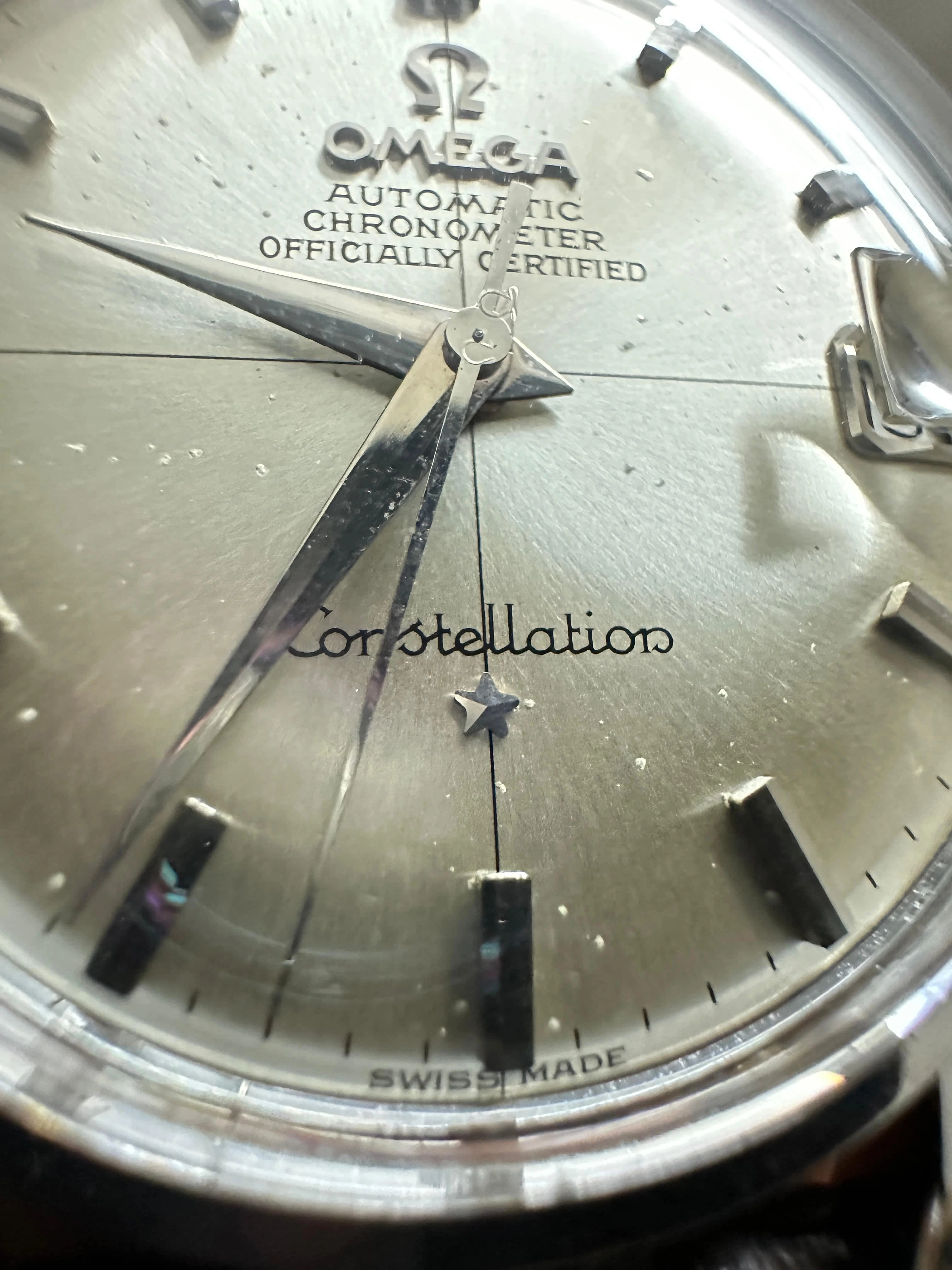

Regarding your comment about the crosshair on the first watch.
If you count the letters in SWISS MADE and include the space you’ll see that the crosshair is smack bang in the middle of the two words.
For the first one price is still ok, i'd say. Dots are reducing the value but the case is ok (not too much worn). For the second the price is very fine if 104$ is the asking price (and not 1004$). Second one seems to have some slight dotting too (not soo much visible).
617
1,967
Wow very sharp eyes you have. Thank you so much
617
1,967
perfect!!!
Sorry. I typed wrong. The seller asks for 1004usd hehe
A bit too much with the worn off paint on the indices
