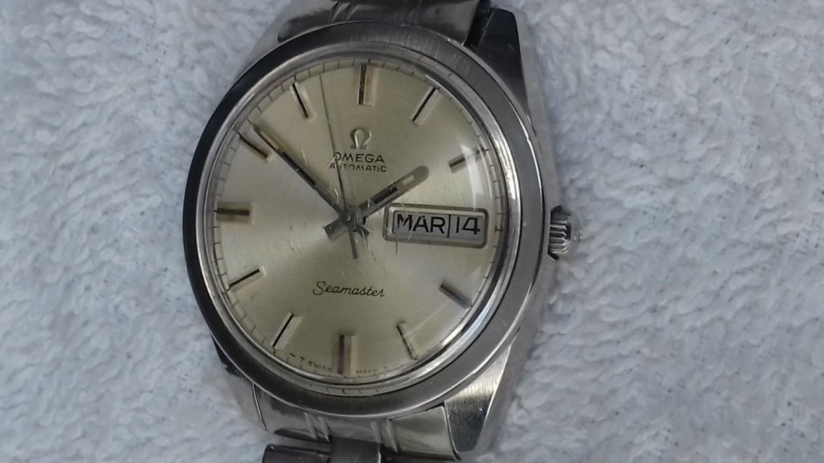

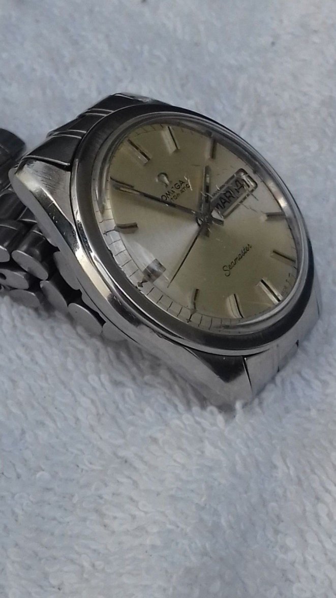

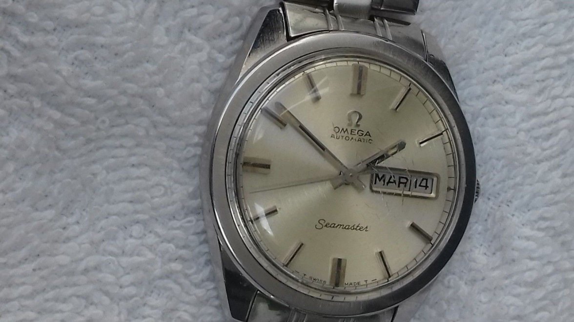

    Hi folks am looking at this 166.032 (with spanish day wheel, my native language ;) ) for sale, owner says is running well (recently serviced/adjusted) for about $600. Does the dial looks original? How hard is to get new genuine plexiglass for it? Crown looks correct? Good deal?

    Do they provide evidence that it was serviced? The scratched crystal is a big indication that they are either lying or that this "service" was something pretty weak.
    I'm bad at detecting this, but does it look over polished as well? (I will let others chime in)

    The crown is not correct. Diameter is too small.

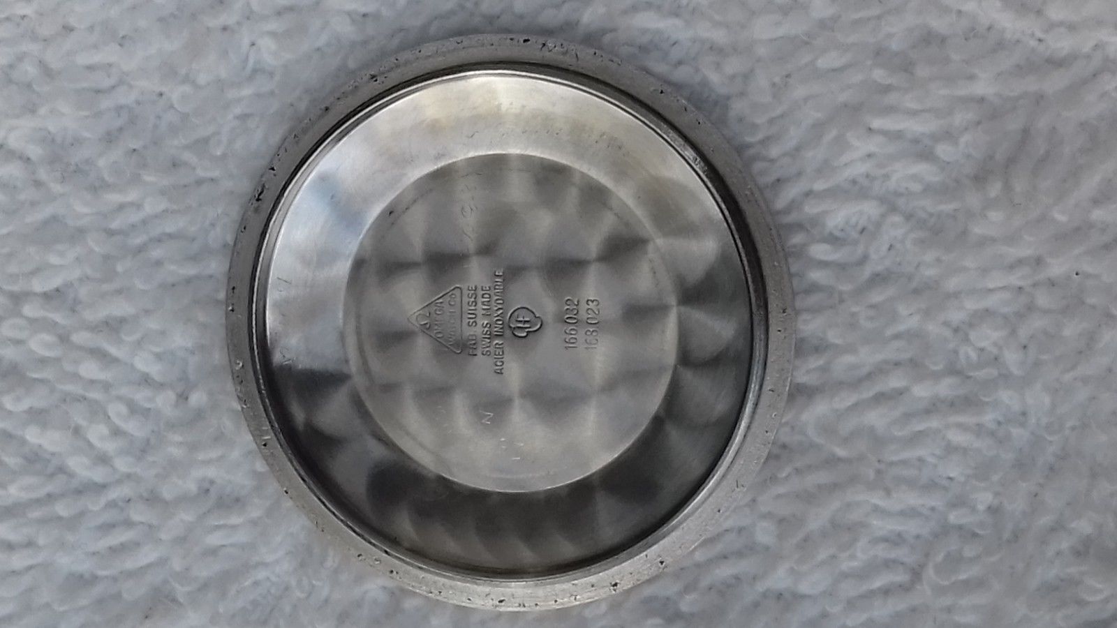

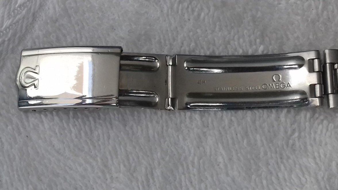

    Dial looks original, case and buckle were polished. Back gasket looks iffy, you should assume it would need a service, some refinishing, a crown and a crystal. Rotors marks on the caseback!
    If you really want it you could make a low offer, but refinishing a case is not always easy. The plain model (not chronometer rated) is not rare, you may wait for a better example. As it is, this one is too pricey imho.
    FYI, my 168.023 was in the same range price-wise, but it has an original plexi and crown, is not polished and the movement is very clean, even if it need a service, it is dry.
