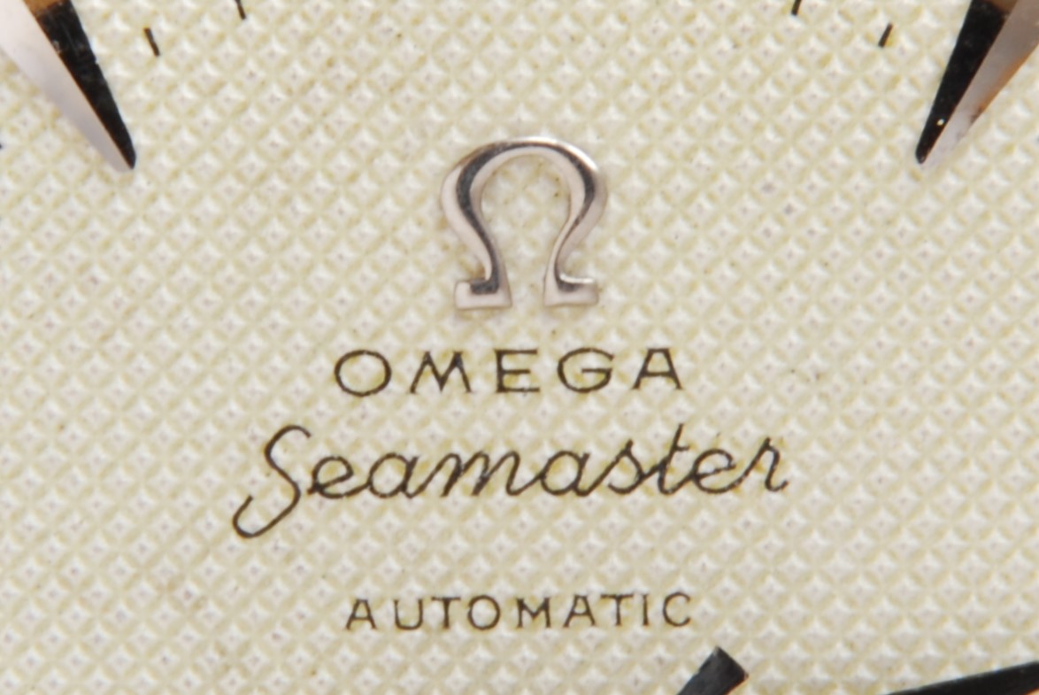

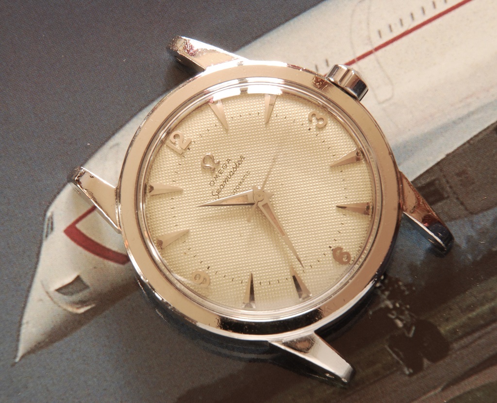

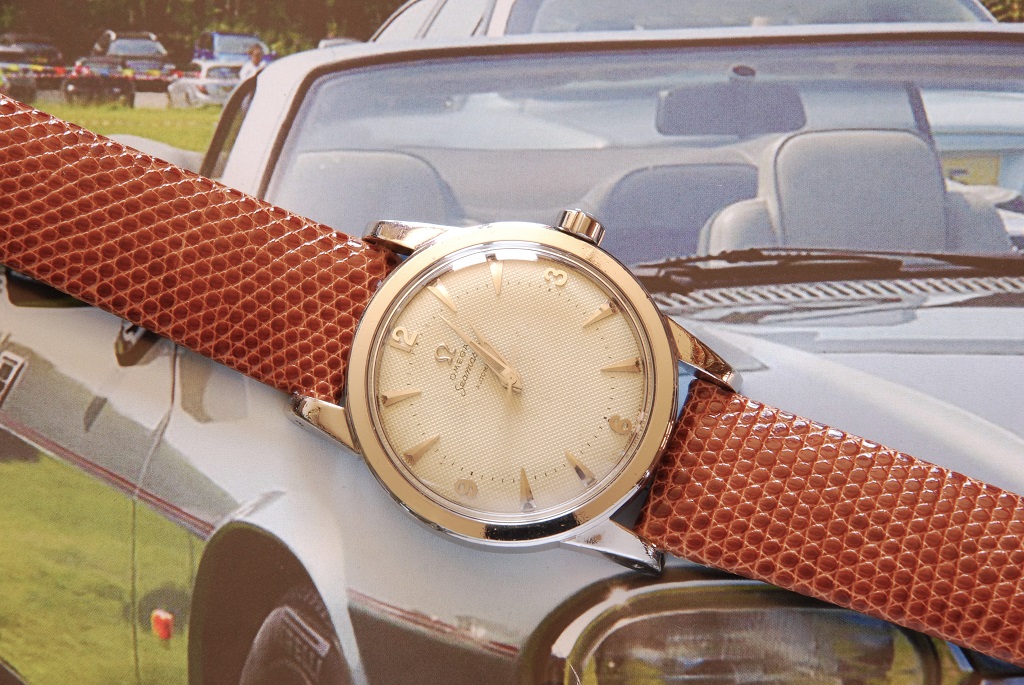

    Evening Guys,

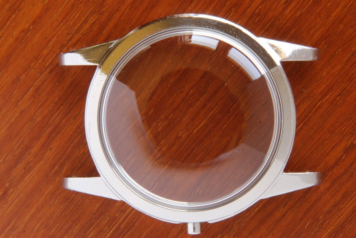

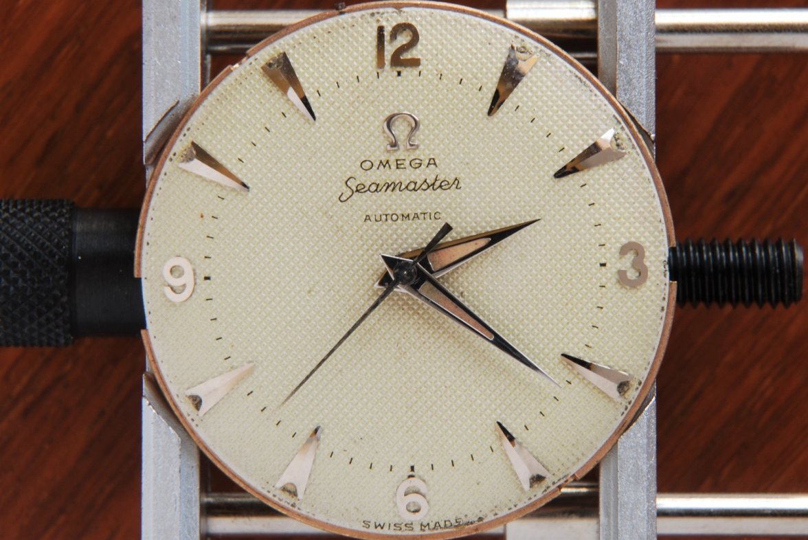

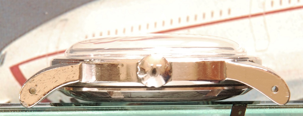

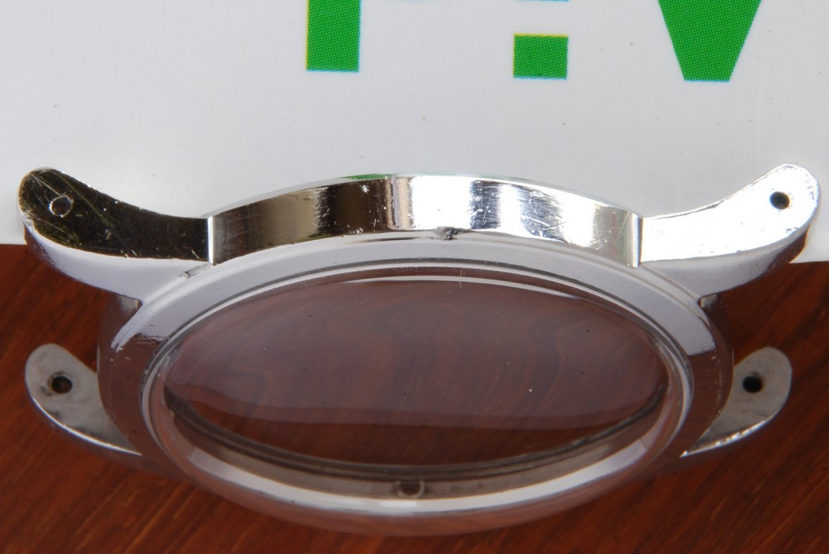

    Another one again for some feedback! I've asked a few fellow collectors over PM, who quite rightly pointed out it's been polished. Some say overpolished and are some are saying it's not bad at all. In terms of the dial, all feedback has been really good. I want to get the experts opinion if that's possible, I'd appreciate it so much.
    Research shows (to my virtually untrained eye), that the waffle dial looks original and the fonts are correct for an early fifties Seamaster but, I'd want to see a picture of the Swiss Made at the bottom of the dial before I go any further. Hands look the correct length as the minute hand is lining up with the markers. And the minute markers all look like they are on the right track. The piece is for sale from another member here on OF, who've I have asked permission to post this and use his photos.

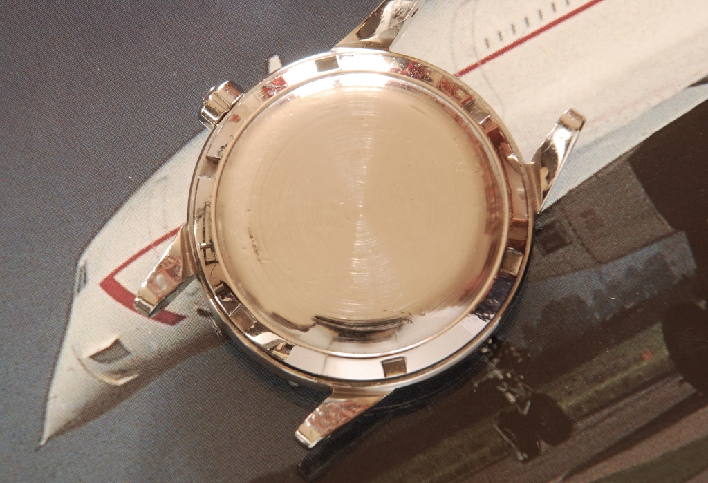

    Case has the age marks which doesn't bother me too much and there is some marking on the back, possibly from some kind of a NATO strap I would of though. Movement looks clean enough and complete to me but I see a little corrosion on some screws? I'm told it will get a full documented service if I were to make the purchase.
    What do you guys think of it? :)
    Thanks! :p
    - Dan

    I guess a closer pic of the Swiss Made will confirm it is a nice genuine dial!

    You are correct about the (over) polishing. Not sure about the hands. They are the correct length, but these usually have just a thin strip of lume.
    Movement looks nice. I think that the dial was cleaned and re-lacquered. I have no problem with that as it is a good job. That is why the printing has faded slightly.
    All comes down to price. IMO this is a $250 to $300 piece, unless it was serviced recently by a known watchmaker. That would add a little to it.

    From the pics you provided, the minute markers look unconsistent and uneven which mean a redial.
    Do you have better pics?

    I echo the sentiment about it having been cleaned and it being done well :)
    $300 is a fair bit off, IMO. A seasoned collector would probably pay that, but not a new one, nor someone looking for a single vintage watch to wear occasionally. Also, if it is in Europe (which I'd expect since the OP is in the UK), the price would be higher. I wouldn't be surprised to see a price at around $5-600 which it would definitely sell for on the open market.

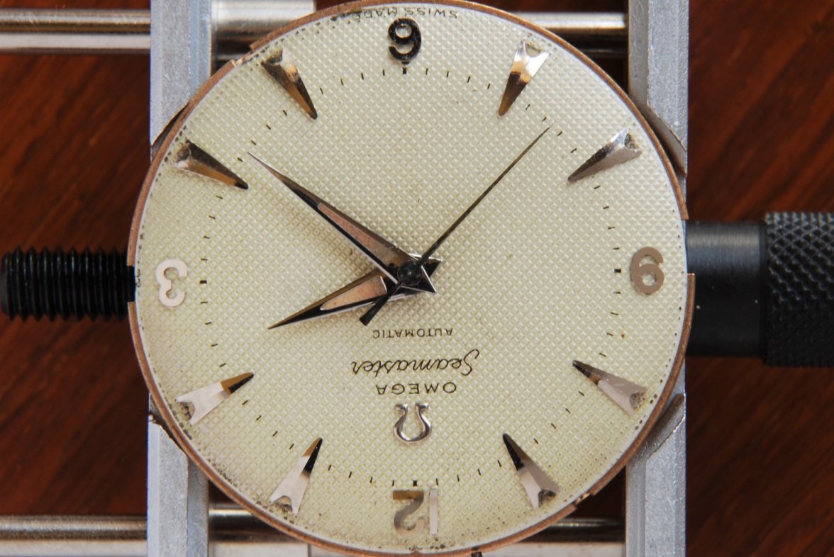

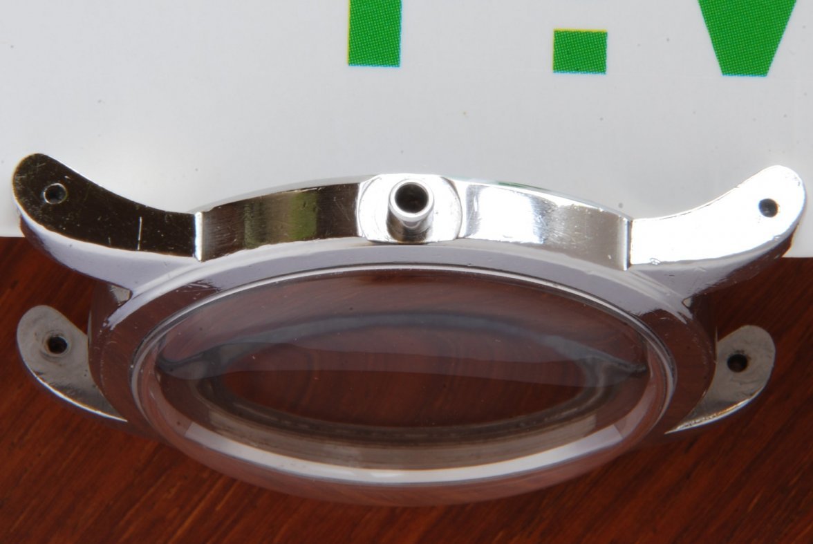

    Hi guys,
    Seller has kindly sent the following photos across to me. Would love to know what you guys think. From your comments I don't think I'll go ahead wit the deal, taking onboard what you have said, I'm sure it is the right thing to do. Either way, here are the photos of the dial and case. Thanks! :)

    Original but as Gator guessed, I would say it has been cleaned - see the yellow parts around the scipts, that could be rests of the old laquer. But it has been nicely done.

    The difference is the so-called "newbie tax". Which I would like to see the OP avoid, since he had the foresight to inquire here first.
    That being said, it doesn't take much in the way of customs duties (diligently collected in Europe and rarely so in the US) and/or VAT to make up that difference.

    Looks like there are two different opinions! Cool!
    Do you still think it's a redial, or are you leaning the way of @François Pépin ? :)

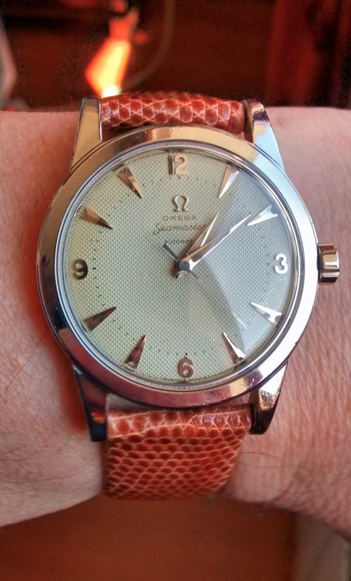

    Here's one I had, now sold, the hands are the same.
