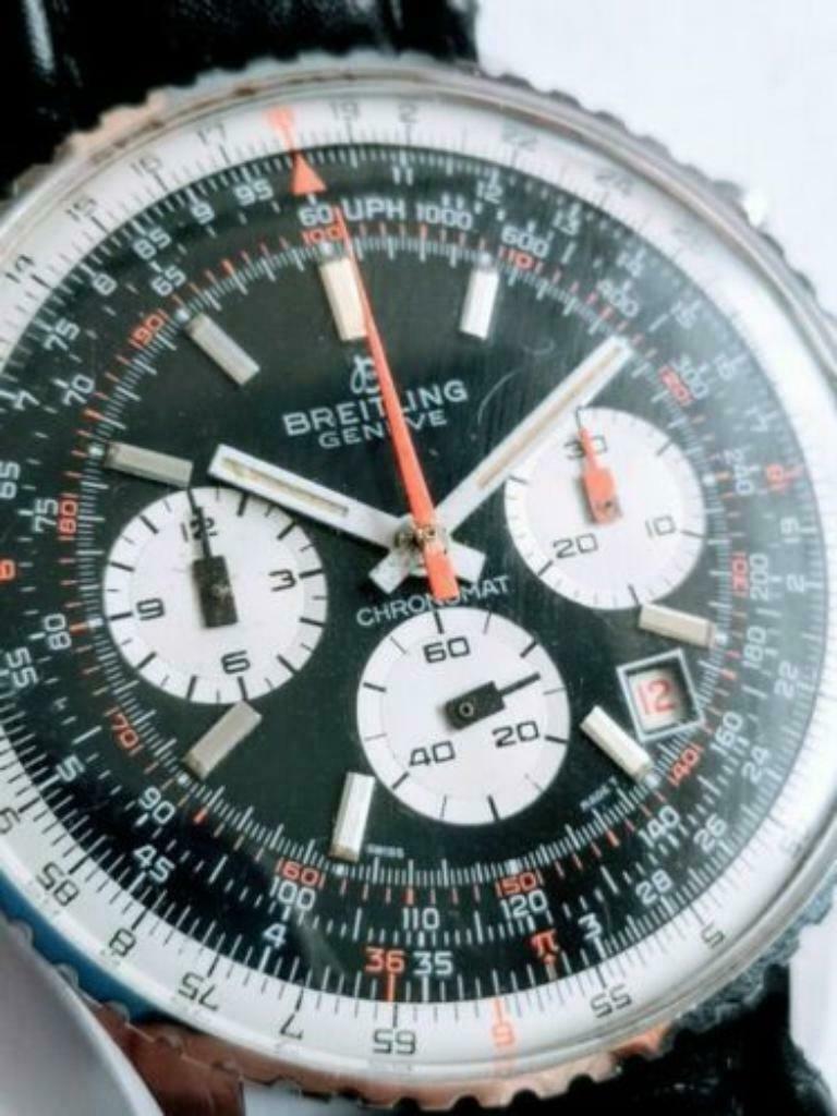

Could you kindly give your opinion in relation to the authenticity and condition of this vintage 7808 Chronomat?
I know that the photos resolution is not great.

The movement, dial and hands look fine to me. What is your cause for concern?

I am wondering if it's missing one orange hand on the 9 o' clock sub dial. Otherwise I would enjoy owning this piece.

That's funny, you're right. The black hand in the hour register doesn't even have the right shape.

In many of these, the shape found at 9 can/should be the black placed at 6; meanwhile, the shape and orange at 3 duplicated at 9
Point being, I *think* the hand at 9 should be moved to the 6
For what little my opinion is worth, funny things with subdial hands is no deal breaker on these 60’s Breitlings if the price is right and it’s intended as a wearer or mini-project. The 60s were so zany regarding inconsistency of factory or replacement parts that one might consider such inconsistencies only barely “incorrect” ... at the right price

I believe you are correct - it looks like the hour sub-dial hand was replaced with a black one. As stated above, this would not bother me that much on a watch from this era, if it was well priced.

Than you guys for spotting the inconsistency and the helpful advice.
The asking price is US$ 5,600 (plus taxes), which now seems a bit too high based on the info above.
I wonder how difficult (or feasible) would it be to find the right orange hand to place at the 9 sub-dial.
