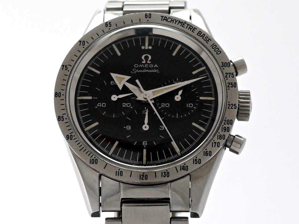

OMEGA Vintage Speedmaster Pre-Moon Broad Arrow Ref-2915-1 Stainless Steel Bj- 1957, For Sale 39,000€

All parts authentic from the time of production.
Right of the bat, the crown isn't.
Who wants to add the next part.
Next...

the bezel is one of the recently produced copies; made in Germany. and more problems for the others to chime in..... kind regards. achim

C'mon, you guys are too exacting. Time of production doesn't necessarily suggest "original" now, does it?

The hands have been replaced. Take your pick on which ones. 😗

I thought that German watch dealers were more regulated than most, ie 30 day return option is law except in case of an auction. How does a "dealer" get away with listing this watch in this manner?

Will someone buy that at €39,000? That's $45,000 USD...

for an investment banker and his yearly bonus this is stamp buying money..... you never know. kind regards. achim

Hey, its got #6's..........who cares about the rest of it!
Seriously nice looking, although $E39,000 of nice looking, not so sure. The hr and min hands look too nice

All the hands look too good to be true, like new replacements from the 3594.50?
I think for the price I can stick with mine for 1/20th the price 😝 ::facepalm1::

I'm not an expert at all - but just to say something positive about the watch - the flattened "O" and the short hashes on the minute sub-dial would be right for a 2915.
443
819
Bezel, hands, upper pusher and crown as well as the inner protection cover are not correct.
On the other hand: How oftern per year does an all correct 2915 show up?

Lugs and dial are nice
yes indeed. Looks like it is the all correct -1 dial.

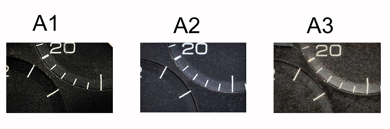

BTW, have you noticed that the diameter of totalisators are different between -1 and -3 dials? This is a feature not yet mentioned in the book. The -1 totalisators are slightly larger.
I cannot see any difference between A1 and A3, based on my pictures. I tried to scale all 3 images and see the difference of space between the totalisators... Do you have other pictures? Thanks.
