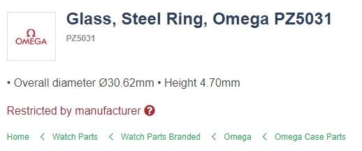

Hi OF,
I have a vintage Omega Seamaster Chronometer 168.024 caliber 564 which I believe is using acrylic crystal part number PZ5031. According to cousinsuk, the dimension is 30.62 diameter & 4.70mm height.
While exploring options considering price & shipping fee (I am located in Malaysia), I came across with this NOS Stella Omega DeVille from ebay. Seller told me the diameter is the same, except the height is 4.5mm. Silver tension ring is present.
Must the replacement crystal be exactly the same part number? Given the slight difference in dimension will it fit perfectly to prevent any water ingress? Will it devalue the watch?
Thanks for your attention!
