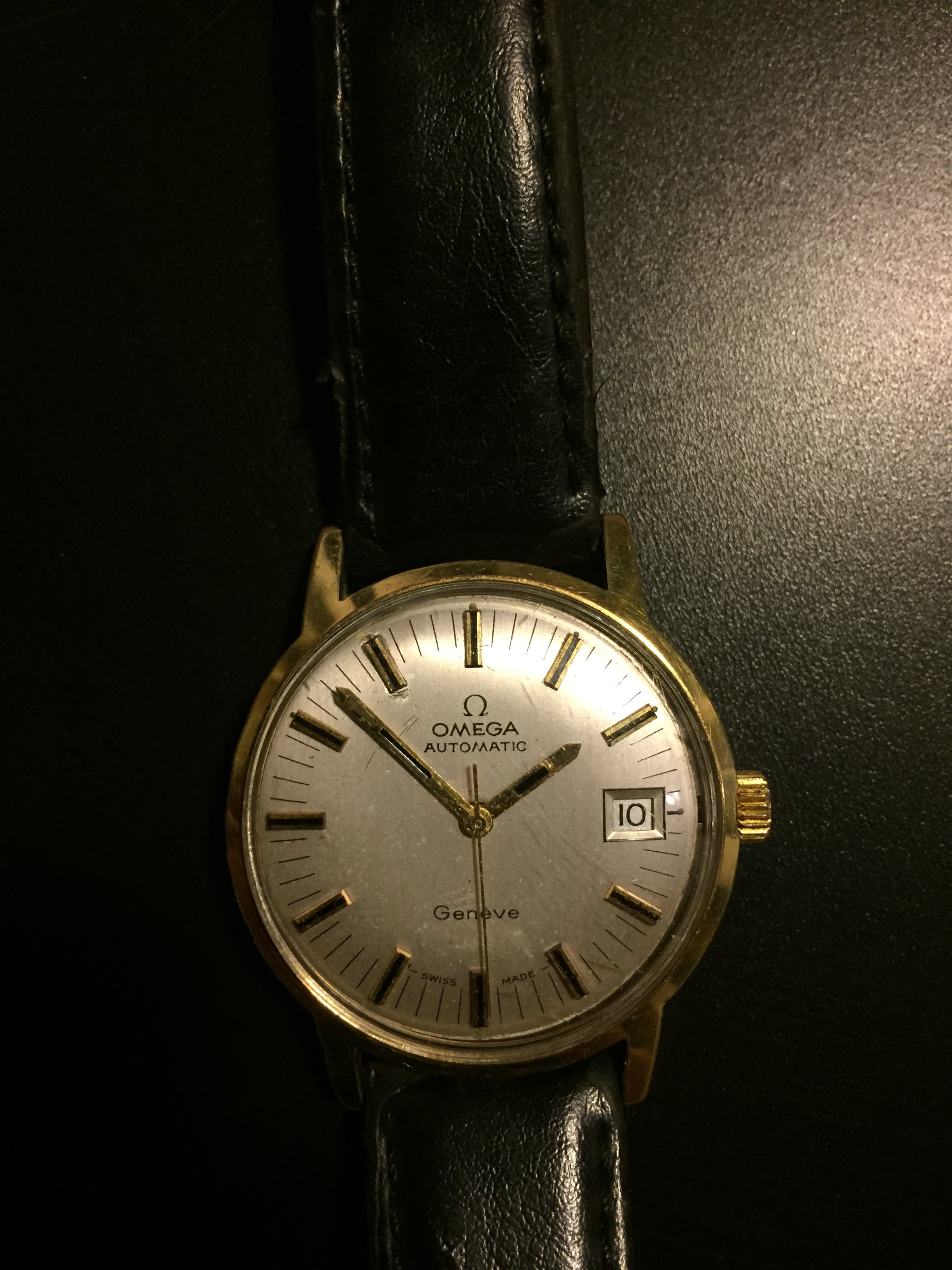

Ive recently inherited a vintage omega watch.
I Dont know which model/when was it produced/serial number etc. But after googling i guess it is a geneve omega circa 1970?
Im not sure if it is fake or original as well.
It is automatic and still functioning. Condition is poor in my opinion. Straps are not original.
Casing is gold. Have not sent to a shop to get the casing opened.
Any information would be of much help at this point. Also ask if u guys need more information.
Regarding if it is original/fake/model/restoration cost/value?
Thanks in advance!

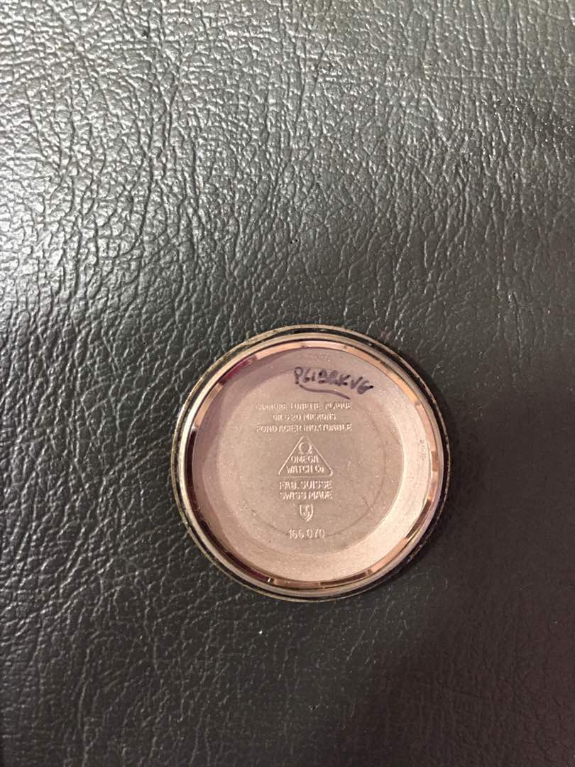

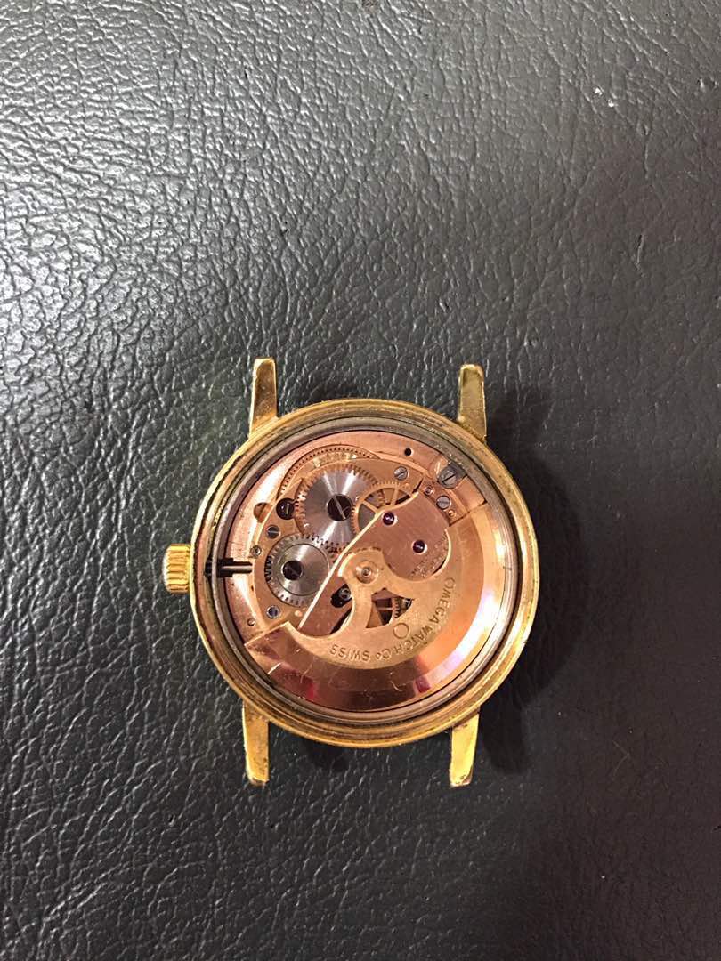

Hi guys, i would like to know more information regarding my watch after i manage to get its serial number. any idea if it is original or semi original? and i would like an estimation value of the watch as i need to do a major servicing for its movement (time not accurate). Anyway i've sent my watch for servicing and awaiting quotations.
Any info/advice would be appreciated from you guys 馃榾

The dial is rather odd with the "Swiss made" placement. I am not expert but i dont see any reason to suspect this watch is fake and i believe everything is original.

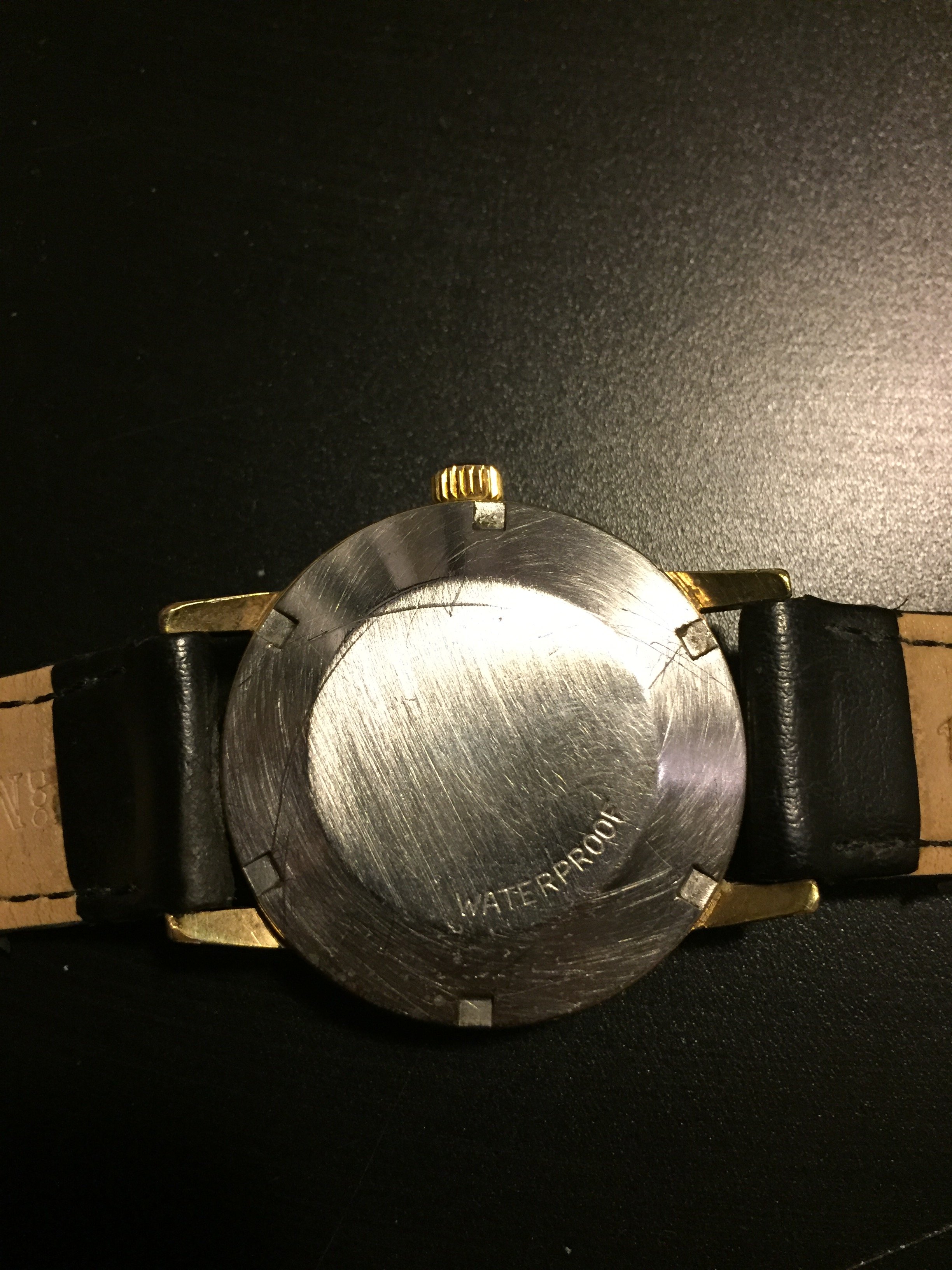

These watches are worth from 250 to 500 depending on the condition. Hard to judge from those pics but i would say the condition is fair, but not great. The caseback especially has been tortured ::facepalm1::
8
Thanks for the respond! condition is not too bad, only scratches here and there. only the movement is deranged. hopefully the service does not cost more than the watch :O
This value, assuming you are talking Euro's is optimistic. The dial is in very poor condition (see the 11:00 indice) and I think a redial. The case gold plate and I think I see spots on the lugs where the plating has worn through. Missing crystal tension ring. The dial and therefore the movement, have shifted in the case. Looks like the rotor is or was rubbing on the case back.
refurbishment will most likely exceed the value of the watch. If you have a sentimental attachment to the watch that is another consideration.
My estimate was a general estimate for what Geneve watches like this are worth. You are right, judging from these pics this will definitely be towards the low end. What makes you say this is a redial?
2,720
5,551
As you noted the T- SWISS MADE -T is in an odd spot. I have not previously seen T's that were smaller and located above the hyphen.
