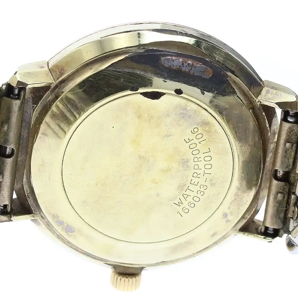

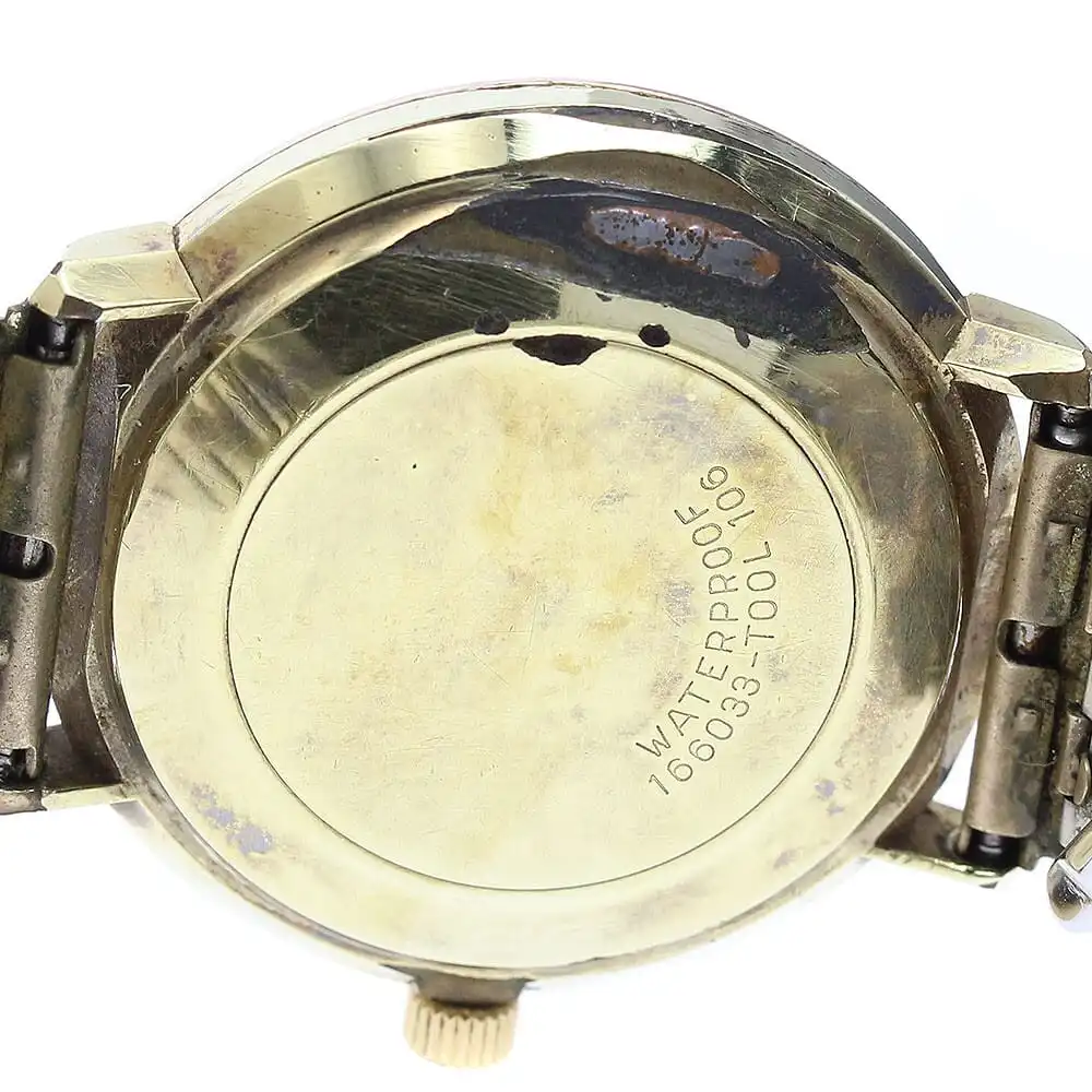

Below the photo of a badly worn gold plated Geneve you wrote that at such state the watch is for parts only.
I thought that maybe it is something that can be restored, especially since as you wrote these watches have basic shapes.
Of course, a collector would like to avoid that, but it could be worth to know for the assessment of the watches if there is a risk that the watch can be restored.
Have you seen any restored examples or do you know if it is even possible to do that with some kind of acceptable finish?
Regarding replating, that might be worth an article on its own some time.
It varies in price drastically by location, I have helped arrange it on two watches in the past, one was an Australian brand Hardy Brothers watch and the other was an Omega Quartz from the 1980s, both with significant sentimental value to the owners.
Getting it done is a lot like having a car repainted, in the sense that the actual gold-plating isn't expensive at all, and you can get it done for under $50 at some places. To have it done properly on a watch though, you need to dismantle the watch, completely remove the existing plating, and then re-polish the surface of the watch case to a uniform finish, then prep it correctly for plating.
If it's done by a professional with the correct equipment and prep, the results are very good, but here in Australia that was about $350-$450 at the time several years ago. Having it just re-replated without any effort or prep looks terrible, and it degrades rapidly, just as rattle-canning a car would to cover up paint damage.
Given how much of the cost is labor, it is probably vastly cheaper in countries with low labor costs so potentially you could have it done there for a lot less, but when a perfect gold-plated Geneve Cal 552 is around $250-350 on eBay, there just isn't much point buying a rough one for $150 and trying to have it re-plated.
The watches it would make some sense on are pieces like the Speedmaster Mark II, rare Constellation ultra-thins and similar oddball Omegas that are worth owning but often have badly worn cases.

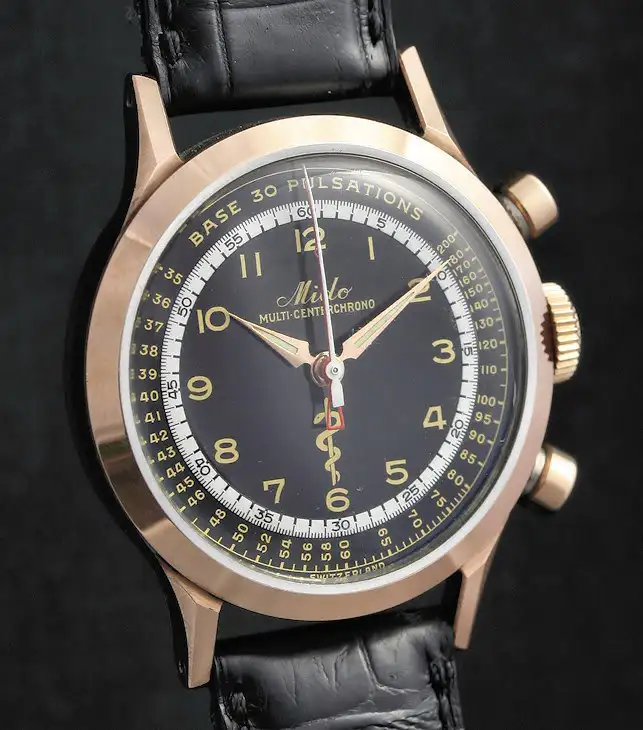

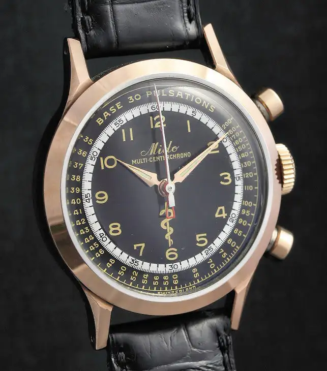

While I could be mistaken, and my observations are purely anecdotal, I have long believed that some gold-capped models appear be of higher quality than many others. I would use vintage Mido as examples. I don't know whether it is possible that they used a thicker layer of gold, or if, perhaps, the alloy which they employed was more durable than most. But in my experience, they have typically weathered the many decades better than most others.
