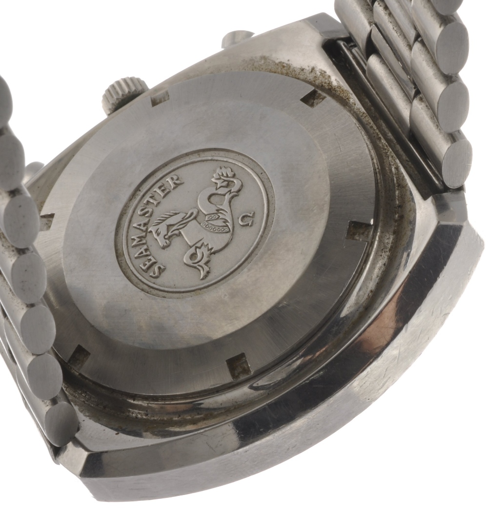

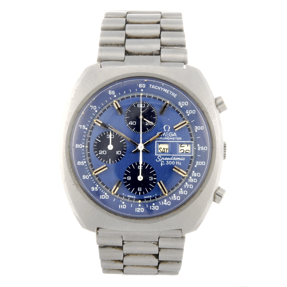

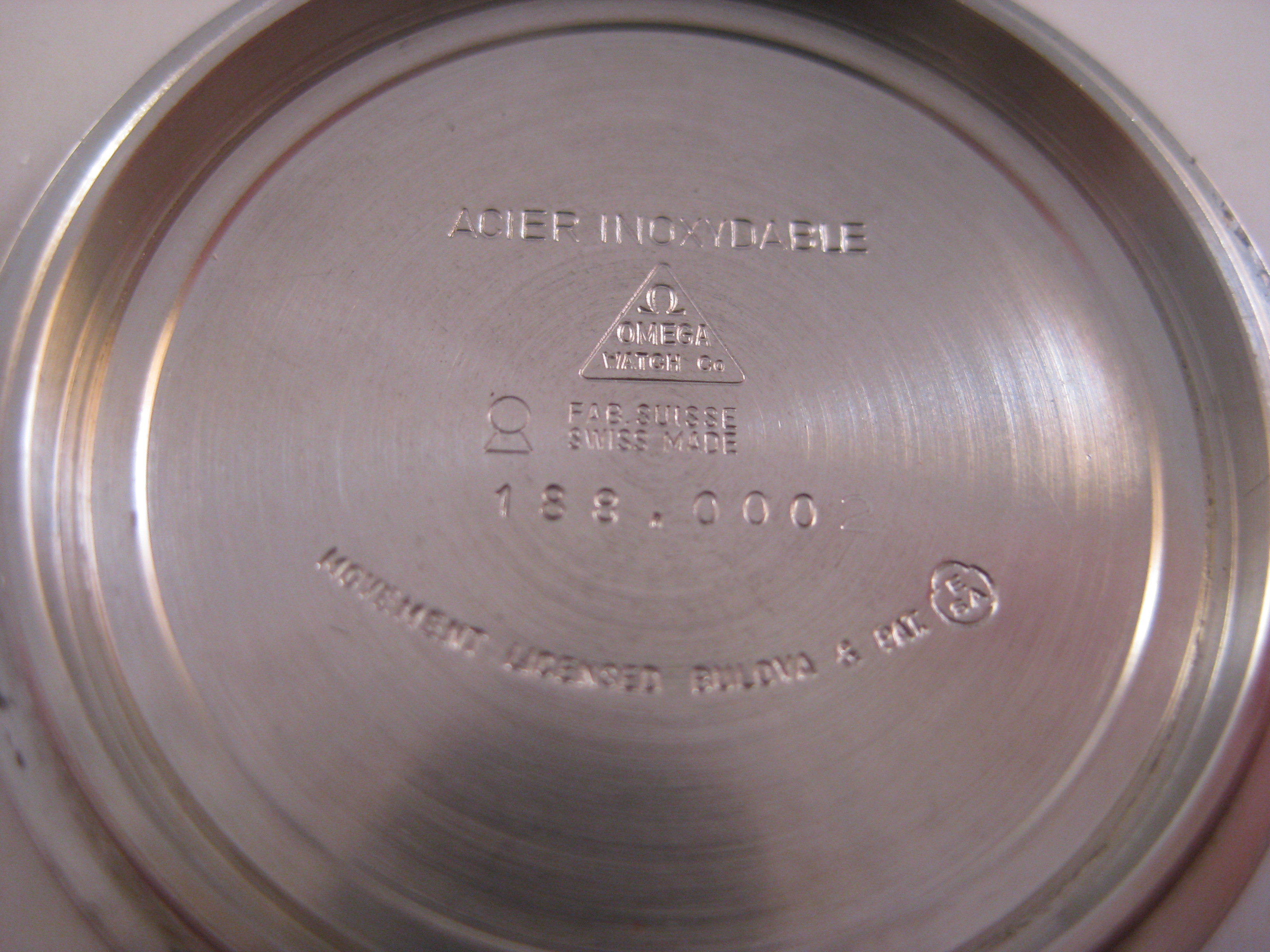

    What are your thoughts on this Speedsonic f300Hz ?.
    I've seen a few pics of these on the forum but not any real views or opinions. I'm looking at this one but its not in good working order, so my question to you guys is, because its not your usual movement how easy is it repair ?. Is this watch known as a 'tuning fork' ?.
    Here's a couple of pics.
    OMEGA stainless steel electronic chronograph gentleman`s Speedsonic f300Hz bracelet watch, the blue dial with hourly applied silvered markers, bordered by a minute track, day and date apertures positioned to three o`clock, subsidiary second, hour and minute counters positioned to twelve, six and nine o`clock, all surrounded by a tachymeter scale, tonneau shaped case, numbered 188.0002, fitted to a steel link bracelet with folding clasp. Case width 43mm.
    Omega bracelet watch, movement is functioning intermittently.

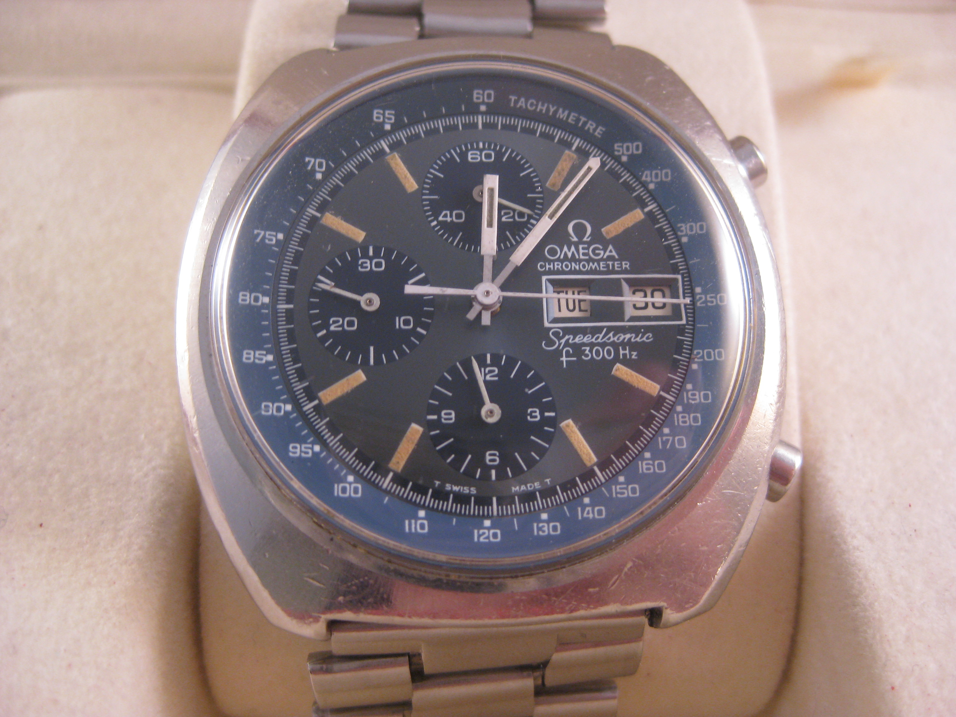

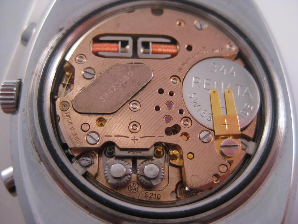

    Have several F300 tuning fork and it's wonderful watches. My advice is to buy it. Omega Speedsonic 18 feb 2010 017.jpg Sonic 2.jpg Speed 8.jpg Omega Speedsonic 18 feb 2010 010.jpg Speed 3.jpg
  5. dsio Ash @ ΩF Staff Member Apr 8, 2012
    26,755
    32,470

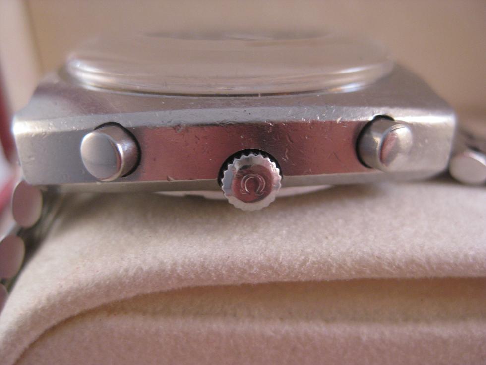

    Interesting that the pushers are offset like that, is that just part of that design, or does the F300 chrono use a piggy-back module for the chronograph functionality?
  6. ulackfocus Apr 8, 2012
    25,983
    26,968
    Bingo.
  7. dsio Ash @ ΩF Staff Member Apr 8, 2012
    26,755
    32,470
    Ah, now I'm starting to get the picture, you've got a piggyback module which adds to the cost of servicing alone, then you also have a less than common base movement.
  8. ulackfocus Apr 8, 2012
    25,983
    26,968
    Then throw in the cost of the coils and index wheel which is getting expensive.
  9. Steve Apr 9, 2012
    899
    133
    I guess the best thing is to buy one in good working order. To buy one as a 'project' doesn't sound to appealing, the repairs could easily out weight the value of the watch ??.

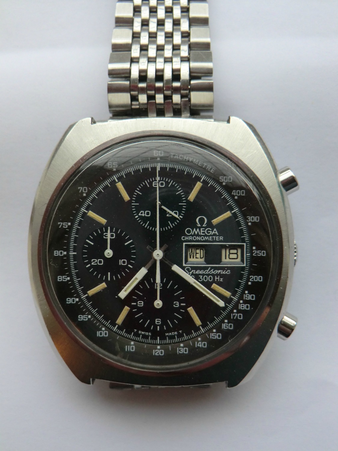

    This is my Speedsonic F300HZ.
