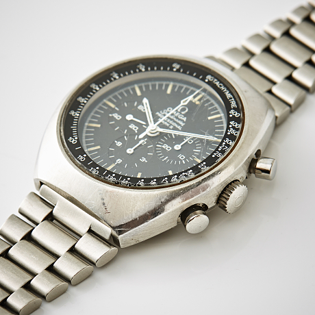

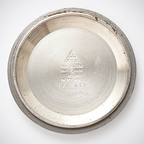

Hi,
I just bought this Omega Speedmaster Mark II «Telestop» at an auction, it was mislabeled as a regular Mark II.
I’m taking it for service at my local vintage specialist.
Anyone know the corrects order numbers for the pushers and glass as they are different from the regular Mark II model? I would love if someone know about all the unique parts he should order to make sure he can do a full service. He can order from Omega, but I want to be sure that he orders the correct parts!
Thanks for all the help!

Hi yes you are correct glass and pusher are different form the original MKII , if I remebember the glass is 0.5 mm thicker the the MKII.

Do you know the part numbers so the correct parts can be ordered?

Pushers are 086ST0026
The crystal depends entirely on what scale you want on it. Tachy is 063TN5219TA.

Thank you, will post photos when it’s serviced 😉
