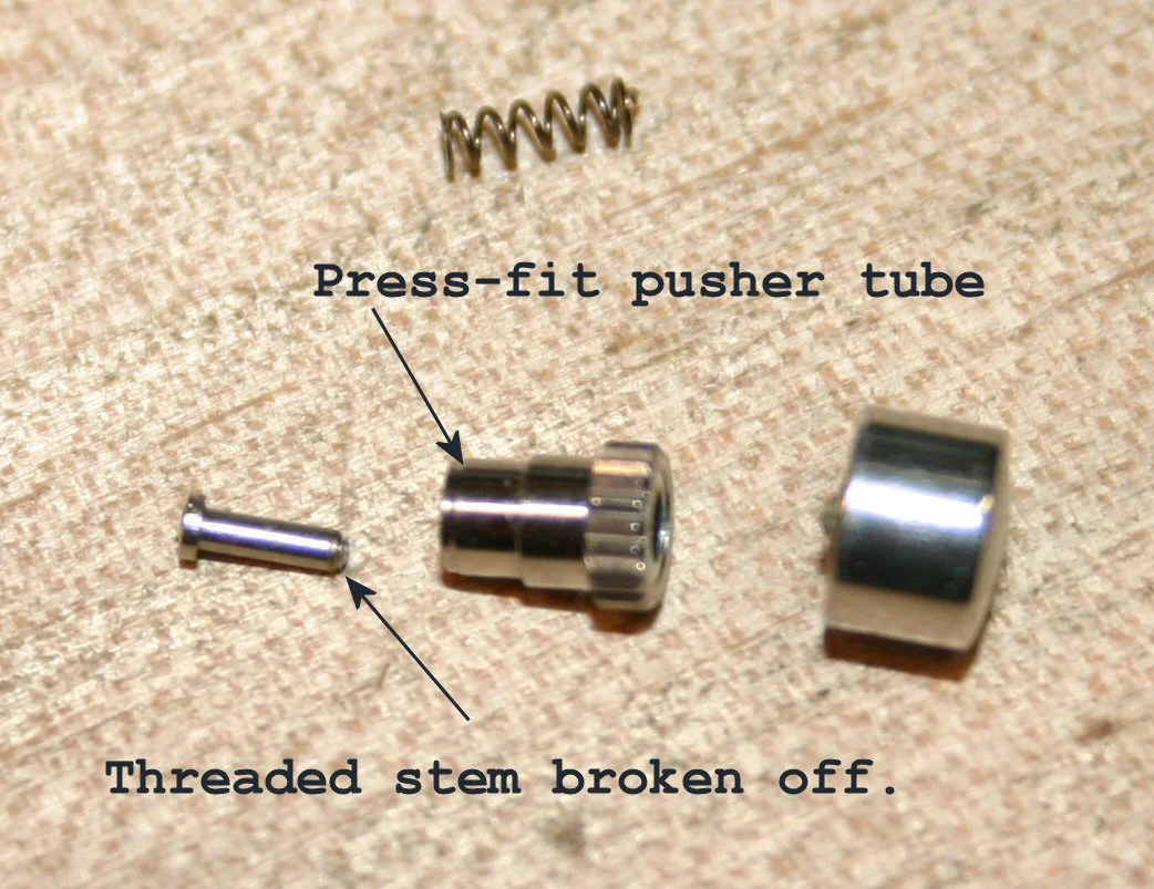

Hi all,
I am currently looking for the screw that holds the pusher cap in place for an Omega Speedmaster Reduced. They have a flat head instead of the long head used in different older models.
The thread on them is quite small and can break quite easily ( lesson learned ).
Does anyone know where to find a spare screw? Thanks
29,815
77,157
The screw is not sold as a separated part. These pushers are press fitted into the case, so they are pressed in as a unit, and are not disassembled for that.
The are not really designed to come apart, except when you are replacing them. The cap is removed for that so you can use a splined tool to loosen the tune that is pressed into the case. Often when you try to unscrew the screw for the cap, it will snap off. Now you are left with a piece of that screw stuck in the threads of the cap, held in with Loctite. So the easiest thing is to replace the whole unit.
The part number for the entire pusher is 086ST0079.
