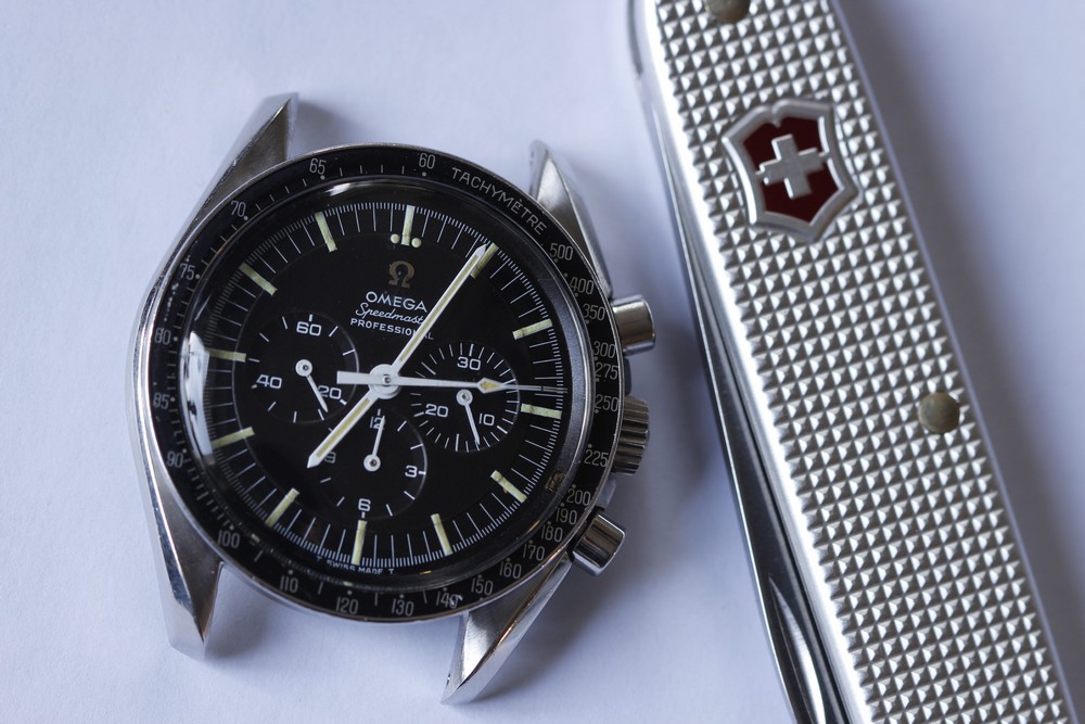

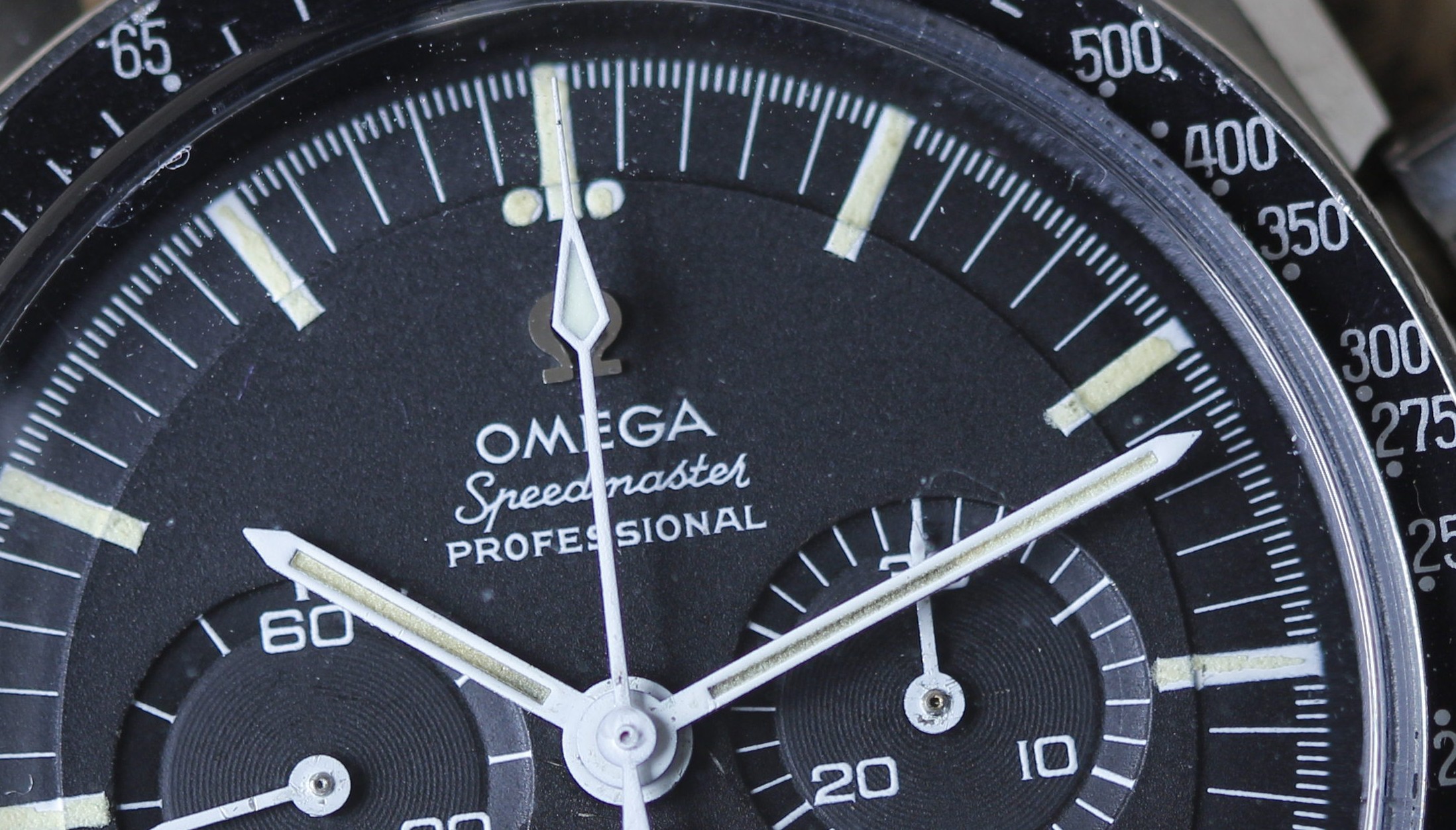

What do you seriously think about the dial? could it be "washed"?
13,201
22,957
No, lume is present on the markers.
1,270
572
strange that diffrent dials look so diffrent, but maybe it is just diffrent dials, it is a 68 below, but it seems the stepdial is diffrent on this
18,202
27,530
Lume has been removed in some of the areas and is not present inside the case on the dial floating around. It could have been "washed" ie the flaking stuff could have been removed via service.
I see signs that the lume may have been removed "washed" and new lume applied and has started flaking off. Look at 2 and 3 hour markers.

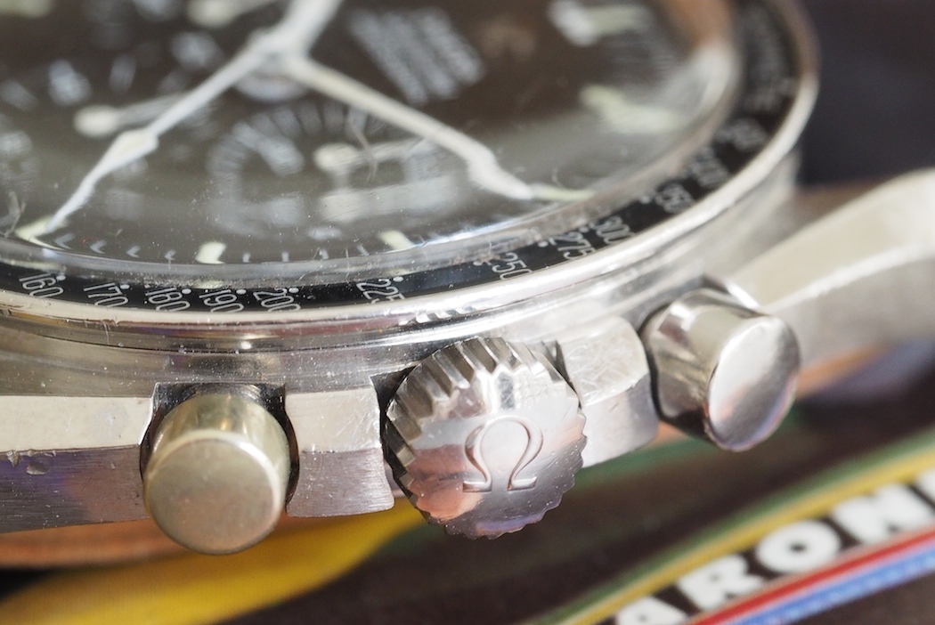

Is that a service crown, thought it was supposed to be the flat foot?
couldnt it be the original lume that has fallen off?
18,202
27,530
Could but look at the lume on the dial outside the hour markers at 2 and 3. How many from that period have that?
215
995
Lume on the chrono hand looks quite different to both hour/minute hand and dial lume - both as to colour but mainly the texture of it.
Might be (super-) luminova and not tritium? How does it look after exposure to light in a dark room/at night?
1,270
572
Yes it is changed
6,872
12,626
Great DON bezel, good case & caseback... pitty of the lume issues & wrong crown
323
254
Just a photo found online... How can you tell though?
Okay, the edge of the crystal is not round but square... I hope my explanation is clear.
215
995
I see. Thanks...
