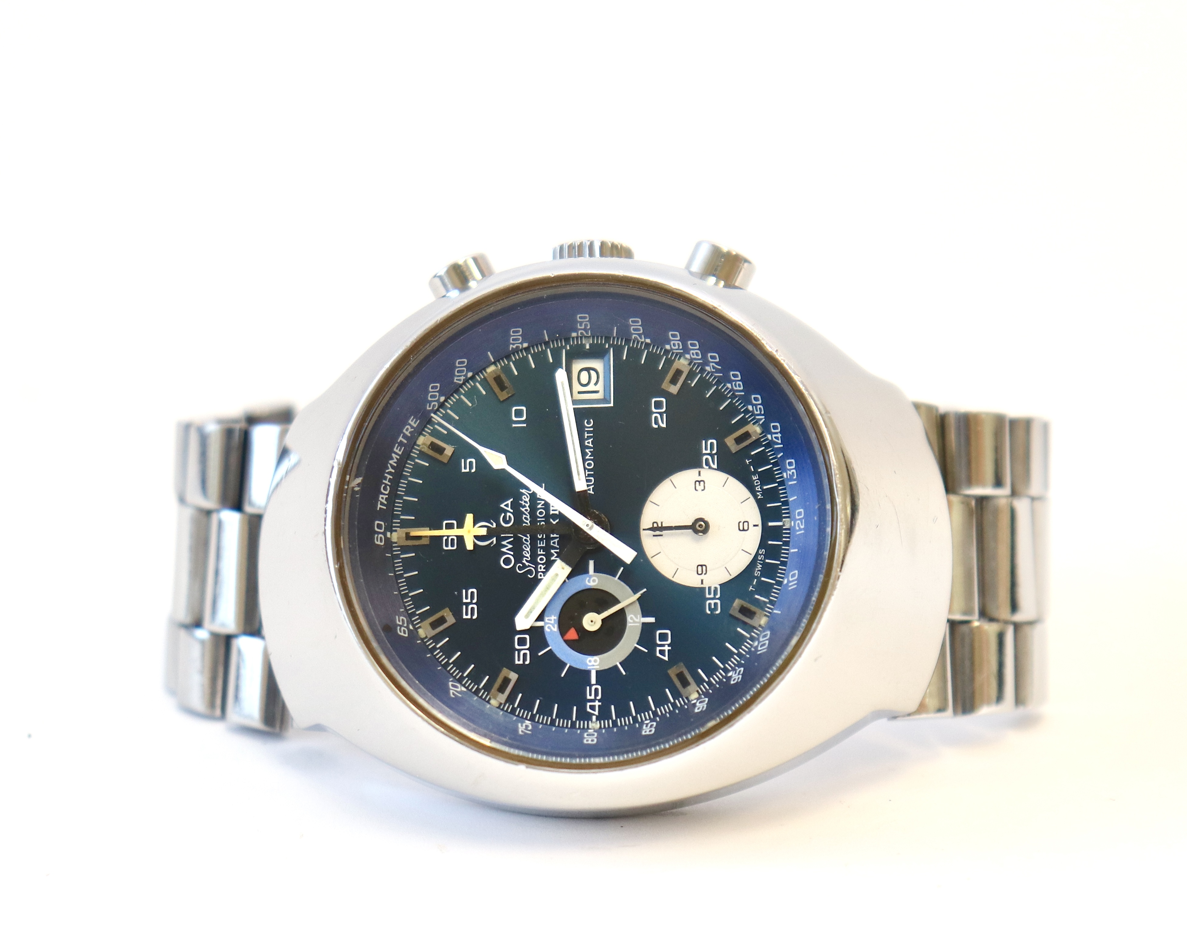

Hi vintage Speedy fans!
This piece came in last year from the Niece of previous owner so my questions were not really answered…
An interesting question from someone that encouraged me to create this Thread, Does this reference or similar references come with Sunburst Brushed polish on case around crystal or does it come with high polish? Based on comparing more than a dozen similar pieces I still can’t tell. Maybe someone can help with the question of what does the Original factory finish look like on these pieces? TIA
285
221
From my knowledge sunburst brushed polish but I am not an expert. Waiting for opinions of more experienced members.
212
315
Yes, a Mark III should have the radial brushed finish.
If it doesn't, it can affect value, but if it doesn't bother you then leave it alone.
You can restore it to at least a semblance of the original finish yourself.
Mask the crystal and the crown and pushers, and then lightly rub it with some very fine grit emery paper, or scotchbrite in the radial pattern.
Works to clean up the case on my Mark II.

I appreciate the direction, I may try and share results. Thank you

For the love of god, don’t even consider doing it. Don’t know why anyone would even suggest such a thing to a new member here in the forum. This will devalue the watch immediately if not done by a professional watchmaker.

Never mind “devalue” it will just be bloody awful.
There is so little material on the case as it gets to the bezel edge that any restoration of the case needs to be done incredibly carefully by someone who knows what they are doing.
And even then, depending on how much the case has previously been polished the results might not be quite what you’re hoping for.
Would highly recommended you tread carefully and talk to one of the places who know what they’re doing… Lewis in Australia and STS in the U.K. spring to mind… there are others, but not many.

Keep your hair on! 😉
If it is already polished, what's the harm if carefully executed?
A careful masking and brushing is easy for anyone with a modicum of mechanical sympathy.

You could easily make it much worse than it is - and make it harder for someone who knows what they’re doing to fix…

I can tell you that repairing "home made" refinishing is often much more difficult than just refinishing a worn case.
People should really leave this kind of thing to the professionals, who are properly equipped for the work.

We do have in-house technician for in-house repairs but we usually leave the vintage stuff as is, My goal was to find out how these left the factory. I probably still have steady hands although I haven’t operated on a movement for a number of years now only busy with sales and client satisfaction with that being said learning the basics of watchmaking at 19 years of age was a lot of fun I never liked Polishing even plexiglass or acrylic crystals not to mention metal. I rather get busy with photography and sales, I appreciate the comments though.

I agree, I usually leave vintage pieces in as is condition. I like how the wear and tear communicates the original character that the watch built over the years.

I didn’t touch the piece we left it in as is condition and surprisingly someone fell in love with it just the way it was.

Doesn’t hurt for sure I wish it were not as polished and luckily someone was already satisfied with the as is finish.
