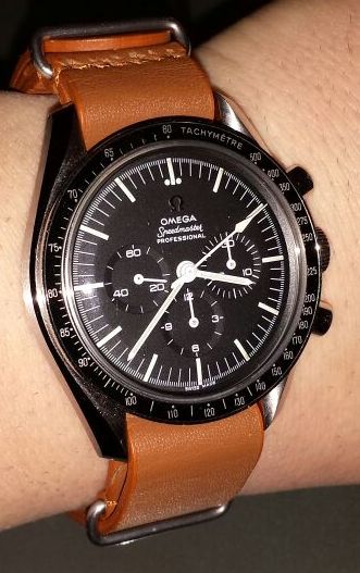

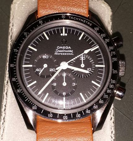

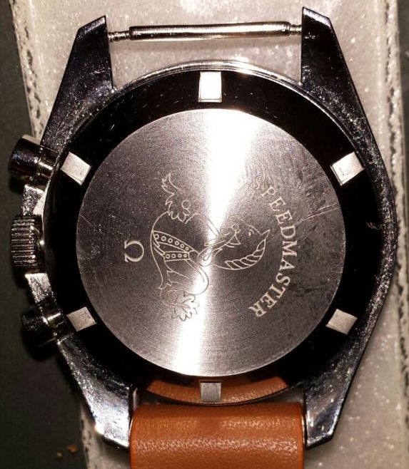

just got offered this 321 - only the head of the watch, no strap, no box, no papers for 2500 euro. shall i go for it or are there better prices out there?
i already asked for a movement pic and a ref number -- but until then please examine the case and dial because i think its too clean! (pictures below)

Don't sweat it, another will come. That was a good price, but for a bit more you can get a much better one.
Get familiar with the price chart, http://www.speedmaster101.com/price-chart/. It'll give you a good range for considering prices when opportunity arises.
5,860
16,788
Put your money back in your wallet, put the wallet in your pocket, zipper your pocket closed and STUDY what is important about vintage Speedmasters. The last watch is an excellent example......of what to avoid.
Start with www.speedmaster101.com
5,860
16,788
If it is true that this is a 321 Speedmaster, the watch is pre 1970. Unfortunately, it has been serviced, probably by Omega, and every bit of vintage value has been sucked out of it by replacing all visible parts, dial, bezel, hands with modern replacements.
127
15
yes. thats exactly what the "seller" told me. The previous owner had a dispute with omega and they gave him a "brand new" caliber 321 manufactured together of "new old stock" 321- parts... (sounds strange...)
what i do question is whether or not the parts are truly genuine omega
5,860
16,788
The parts appear to be genuine Omega parts
5,860
16,788
If you desire a watch that looks new, why not buy a new, or barely used watch? Perhaps a reference 3570.50
