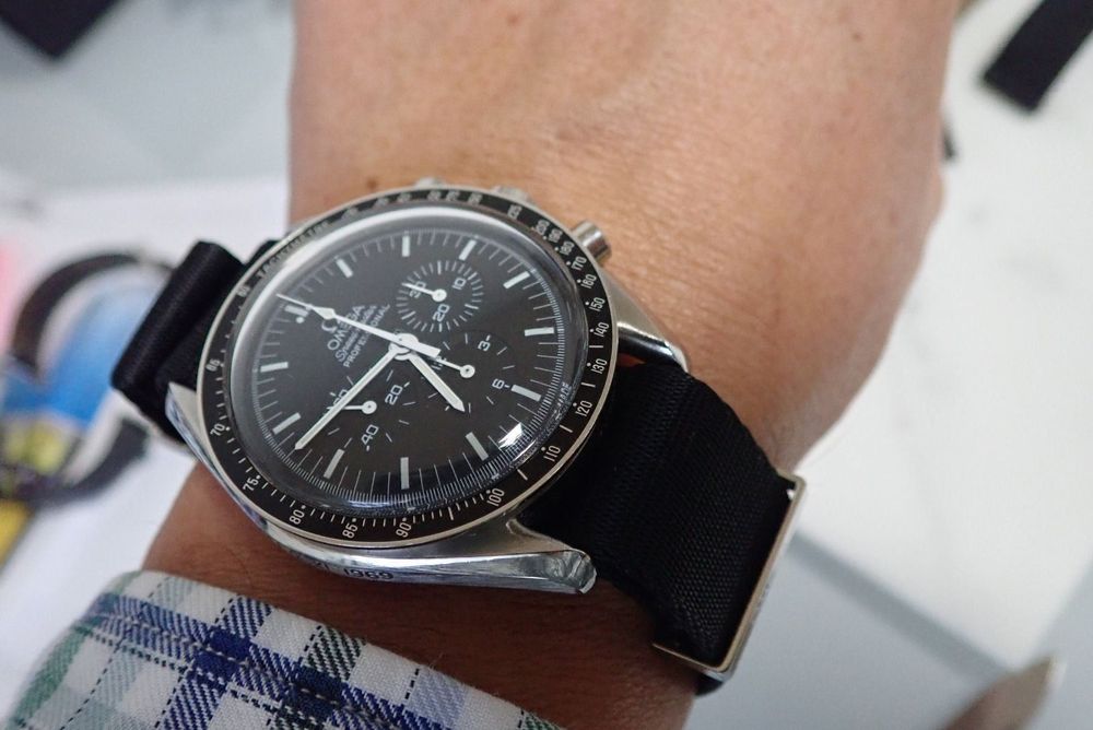

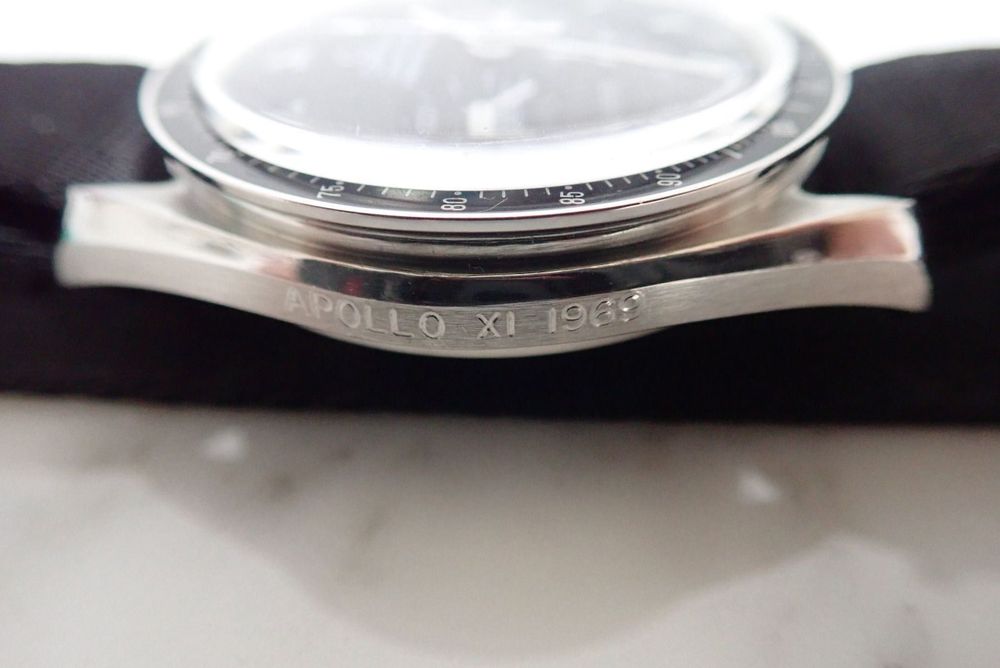

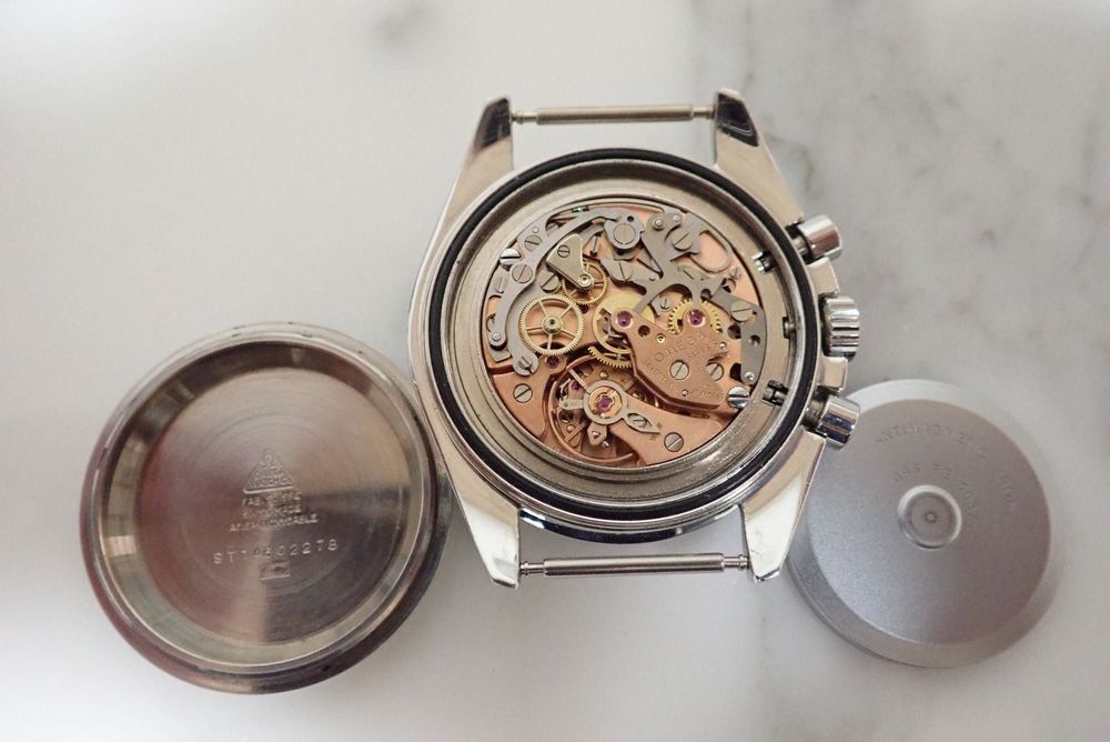

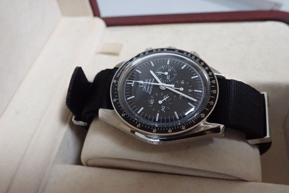

Hi
I found the following watch on a auction. What is confusing me are all the different version of watches with engravings “Apollo XI 1969”. As well I’m a bit confused regarding the “ST145.02278” engraving, as I thought this watches were created in the 80s.
Is this watch legit?
thx for the help
137
70

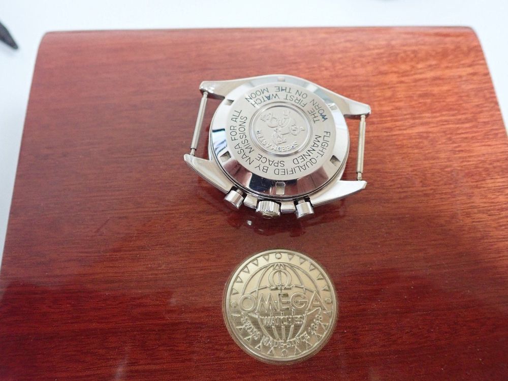

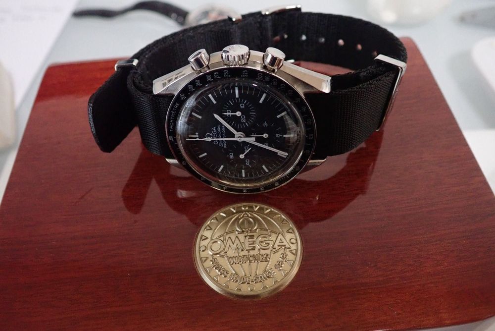

As well, should it not be a tritium sial? And is the box the right one for the model?
Thx for the help

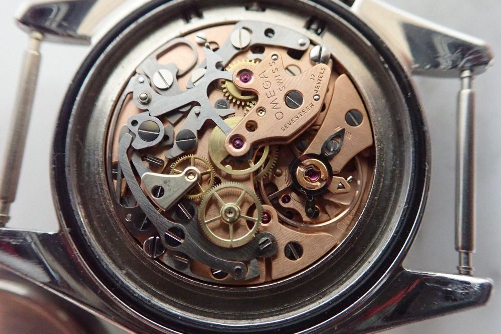

Looks off to me. Is the serial blurred out or is it non-existent. Also, this should most definitely have a tritium dial. Bezel is too modern. And lastly, the case back is off as well.
12,148
40,474
I think this thing's a total franken - -78 case. Apollo XI 25th caseband from 1994 (Or could be 20th, still from 1989). Dial and bezel from a 3570.50 onwards, 1998 and newer. Add to that the blank bridge, and I'd stay far away from this one.
