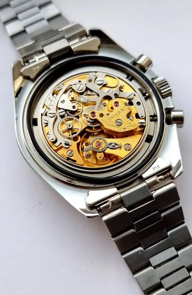

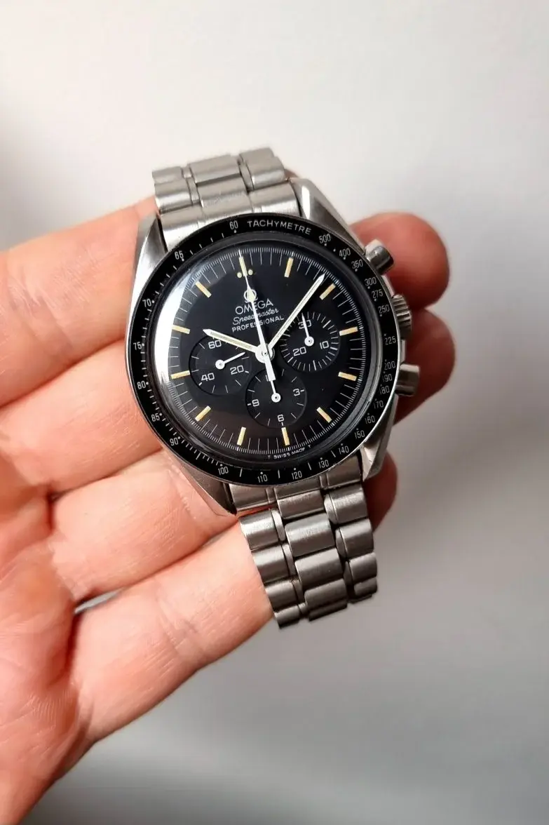

What would be interesting to me would be a repository of actual examples with serial numbers and what bezels, cases, dials etc they have. How much overlap was there etc.
A start with mine:
Serial: 48,276,xxx (c. 1991?)
Dial: C5 short S
Bezel: B4
Case: ADB (fir tree)
Caseback: C5 short tail
Movement: "transitional" labelled 17 jewels but has 18 jewels
Crystal: A5 no logo (which I think could be correct, mentioned in MWO)
