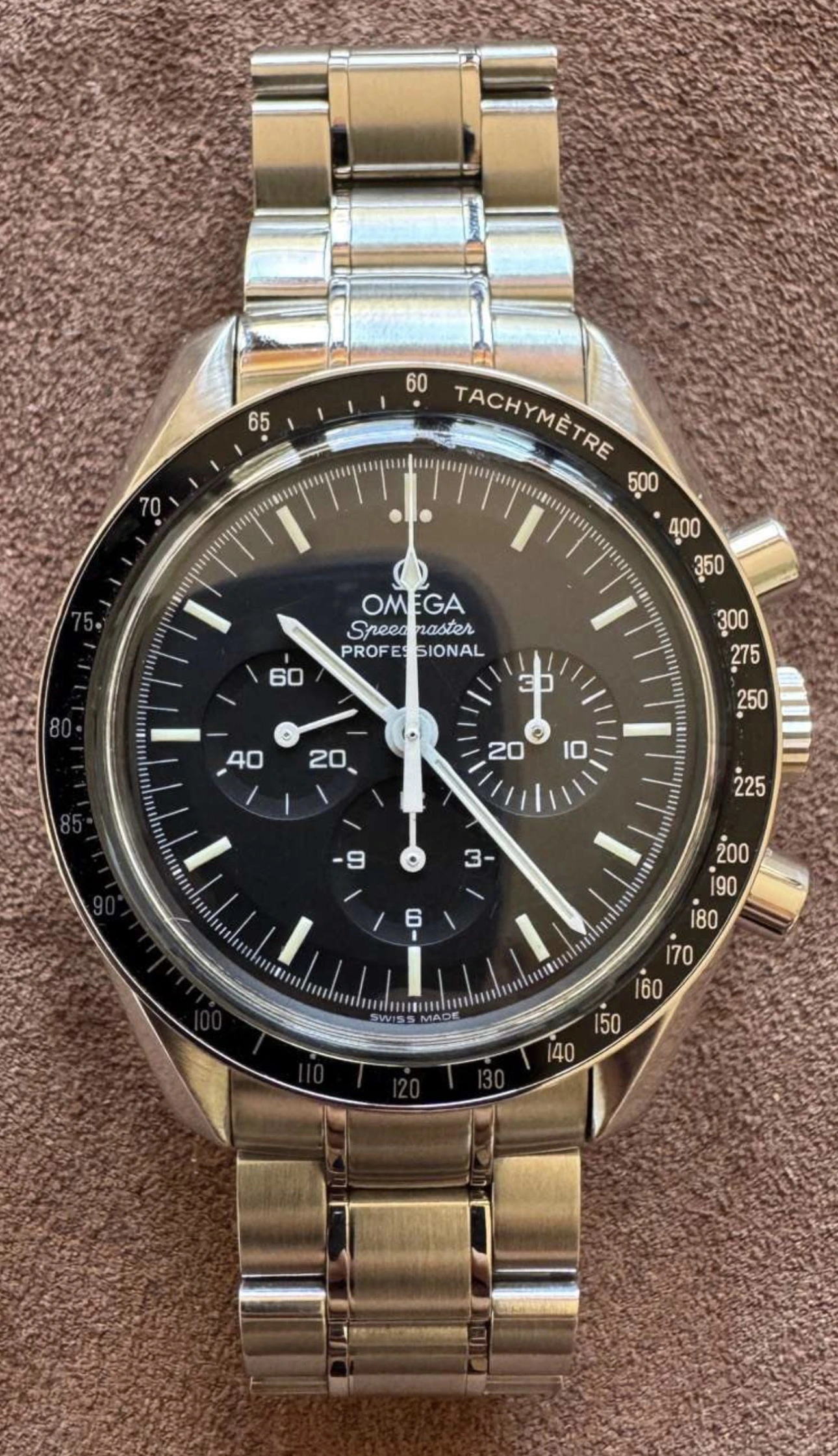

Please let me know if this looks real or not!!

That’s not a 3570 it’s the display back model whose PIC I can’t currently recall but is similar. 3573.50 maybe? It could also be the one with the Hesalite glass and sapphire back that sold briefly a few years back. The seller suggests it’s a 3572 which is the latter option. Nice watch. Looks legit. Use common sense though with a platform like that.

I think you can be confident that the watch in the pictures is genuine and seems to have not been messed about but what would worry me is if it actually is in the sellers possession and will he actually send it. Is there any buyer protection with Gumtree? If not I'd be nervous to do anything other than a face to face purchase there.

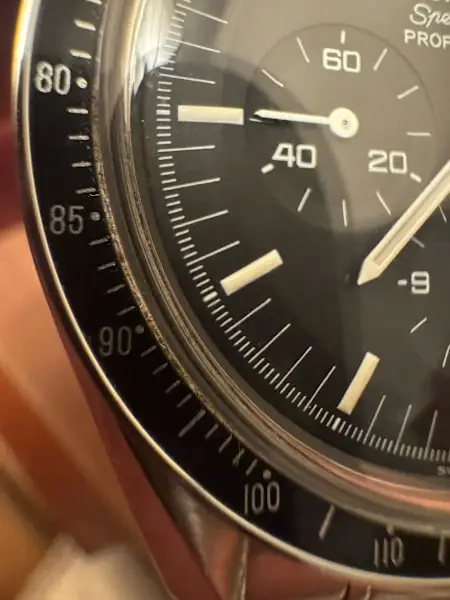

You might want to enquire if the mark on the crystal at around 93 on the tachy scale is just dirt or a chip in the crystal. A new crystal isn't mega bucks but it would be shame if it were damaged. It might be nothing.

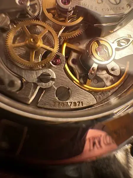

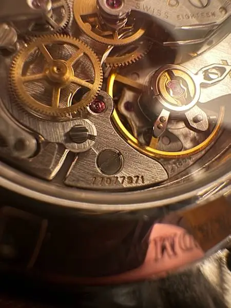

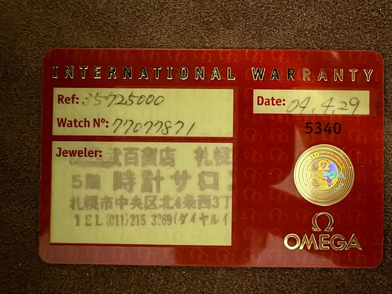

One thing you could ask for as an extra precaution is a close up of the serial number on the movement and a pic of the card to make sure it matches. I suspect there is nothing there to worry about but if he provides the shots at least you know he actually has the watch and isnt reusing someone else's pictures.

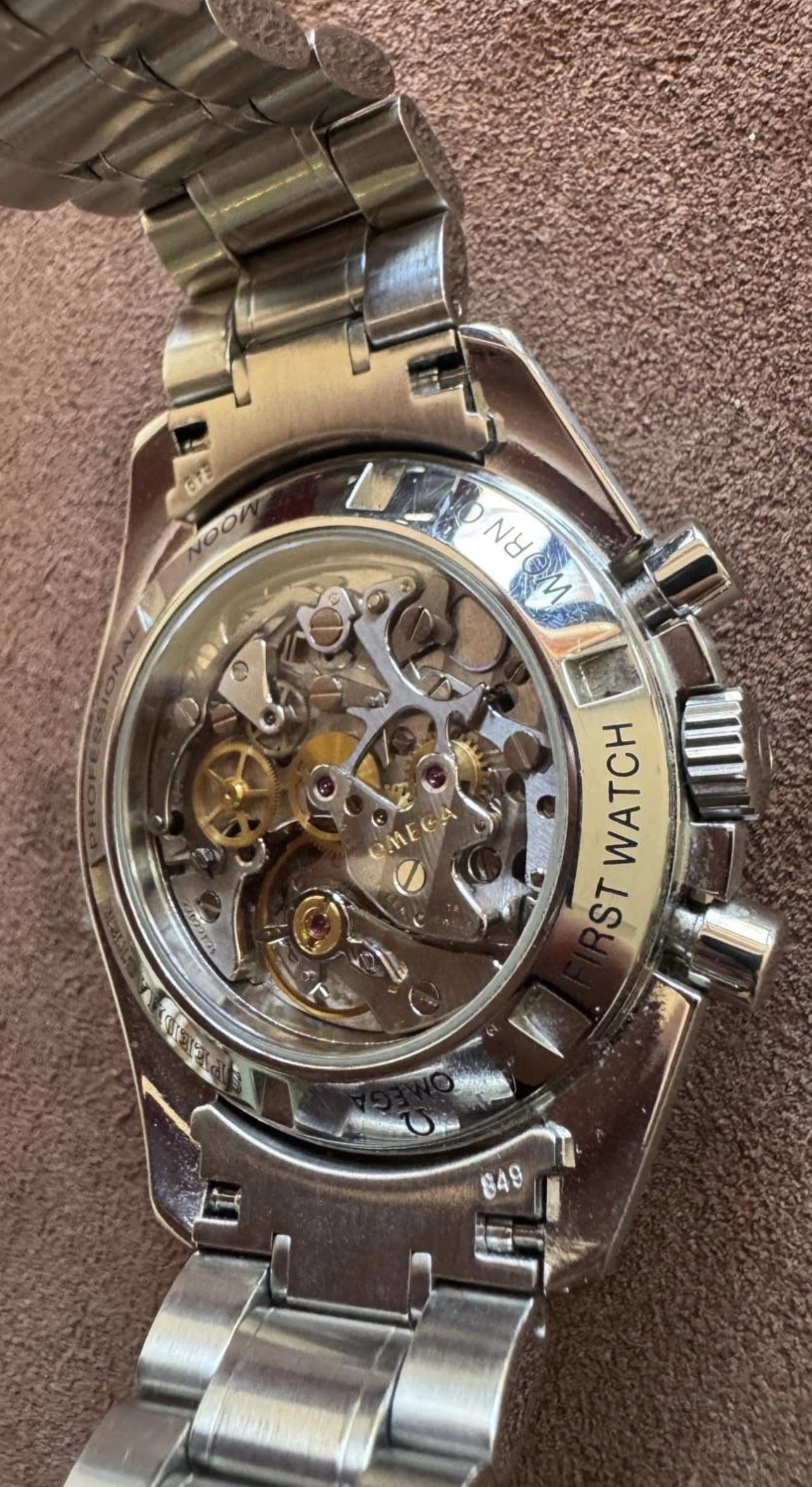

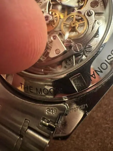

Here are the photos he’s provided, including one of where it looked like there may have been a scratch on the crystal.
Watch Number on the warranty and Watch seem to line up - anything else I should look for??
10,812
16,817
Looks good to me, and the mark on the crystal must have just been a hair or similar. It is a nice reference that one and not commonly seen. You get the warmth of the Hesalite crystal on the front but still have a great view of the engine room so its win win.
Anyone else see anything amiss? I don't.
Take Jim's warning about the inherent risks with Gumtree seriously though. The seller may well be a straight up guy and if he's providing ID thats a good sign but take care all the same.

I double checked the serial number on the Omega Extranet and everything checks out - looks like a good one.
Serial number: 77077871
Article ref: 35725000
