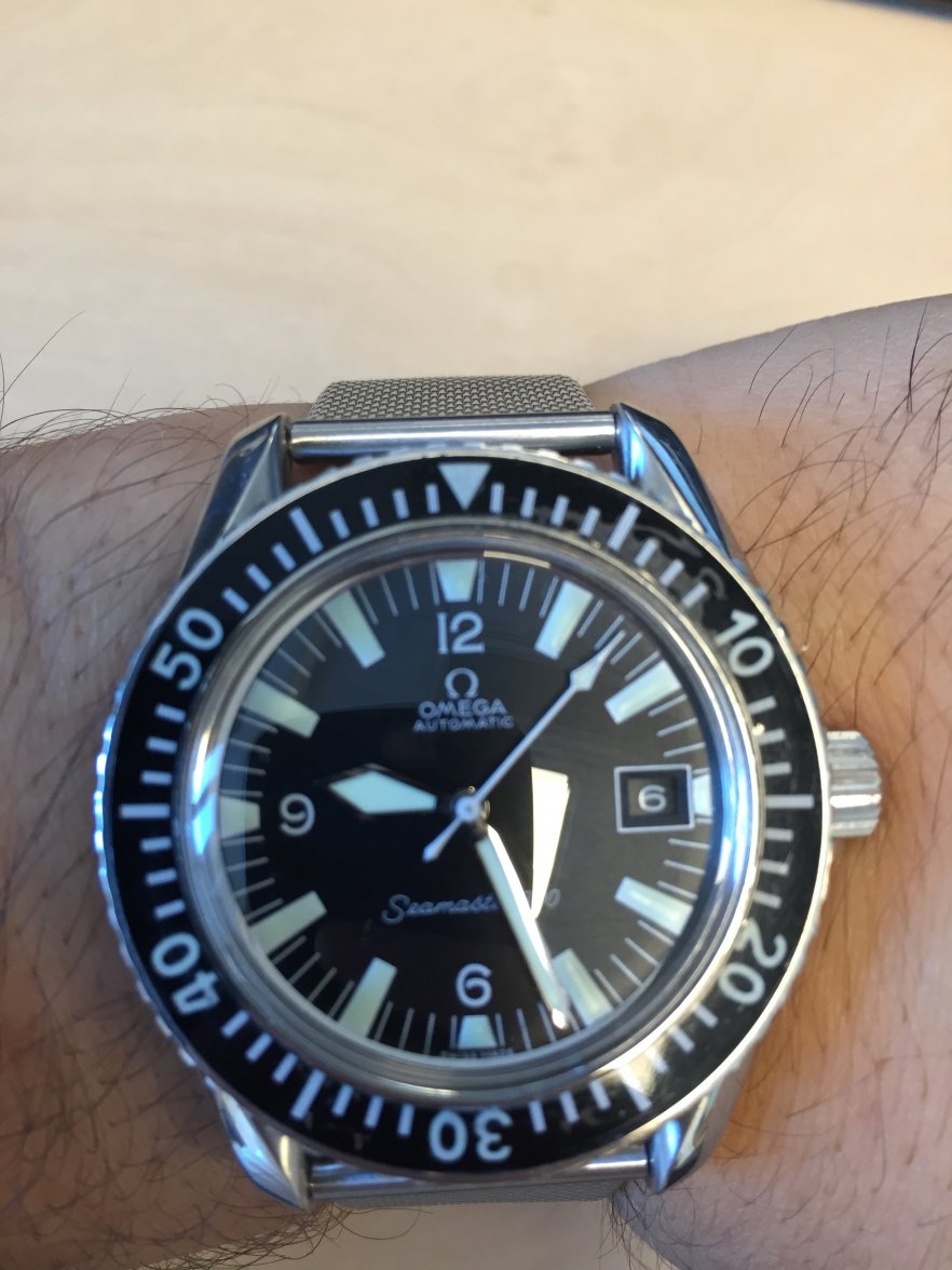

    I just bought this SM300 Watchco, and i noticed that the bezel isnt in its right place.
    It functions perfectly but the minute markers doesnt hit right with the dial.
    Either its the dial thats set wrong or the bezelinsert is wrongly put to place.
    Is this an easy fix, can i remove de bezel and set it right myself or do i have to take it to a servicecenter/watchmaker who checks both the dial and the bezel?

    Just eyeballing it, I'd say that the dial looks properly aligned, but the bezel insert is off. Your local omega-certified watchmaker can get that bezel off easy, but as far as shifting the insert over slightly, I doubt most would be willing to do that job. Local watch shops I checked with just wanted to pop on a new bezel.
    Once the bezel is separated from the case (honestly more difficult to do at home vs a speedy bezel--unless you're willing to risk damage with a knife), you could try following this to pop out and realign the insert:
    https://omegaforums.net/threads/how-to-separate-an-omega-speedmaster-insert-from-a-bezel.46387/
    At least with newer seamaster bezels, there's no specific spot to lock it into--you can move the insert in the bezel as you please (probably the same with your vintage seamaster). You might need the press to get the insert back on the bezel, but I don't think the press would be used to get the bezel back on that Seamaster case.
    It would be a lot easier to just return it or send it back so they can do the work. Since it's a new purchase, it really shouldn't cost more than the price of shipping to resolve? I honestly wouldn't have any work done on it which might invalidate your right to a return--if there was any chance you'd go that route.

    Pretty common with Watchco 300s

    Replacement bezel is really the only sure fire solution...

    I had the same issue with mine, was slightly off though not as much as this one, just had to live with it

    If you have a SM300 Watchco you will most likely have this issue, I believe the problem was with the service bezels being sold by Omega at the time. I just move it the 1/2 click so it sits aligned if I feel the need but most of the time I don't worry...if it worries you buy another bezel.

    It probably is. I had my spare SMP bezel off, took me less than 5 minutes to determine the proper case-press dies, separate the insert from the bezel, reposition, and press them back together. The hard part is getting the bezel separated from the case--a watchmaker probably wouldn't charge much for that?
    After comparing images of several of the same model, it appears that there's no set place to line up the bezel/insert. I'd highly recommend making two small marker marks for the corrected boundary locations of 0 for easy repositioning after separation (ie 0.5mm to the left in this case). Then a couple of swipes of rubbing alcohol on the bezel edge to remove the marker residue. Otherwise, you may end up being off again and repeating ad nauseam.
