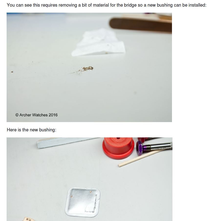

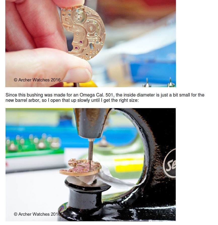

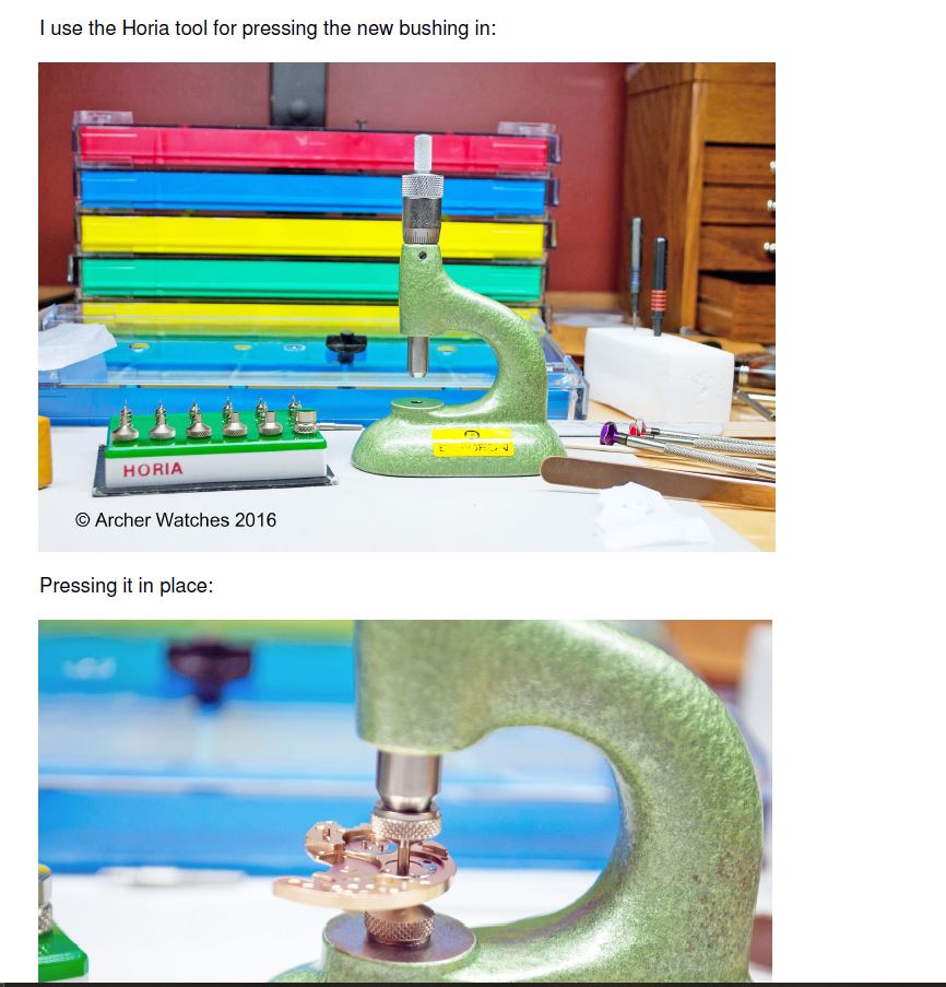

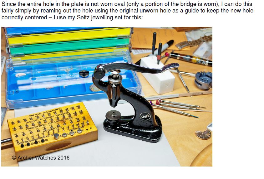

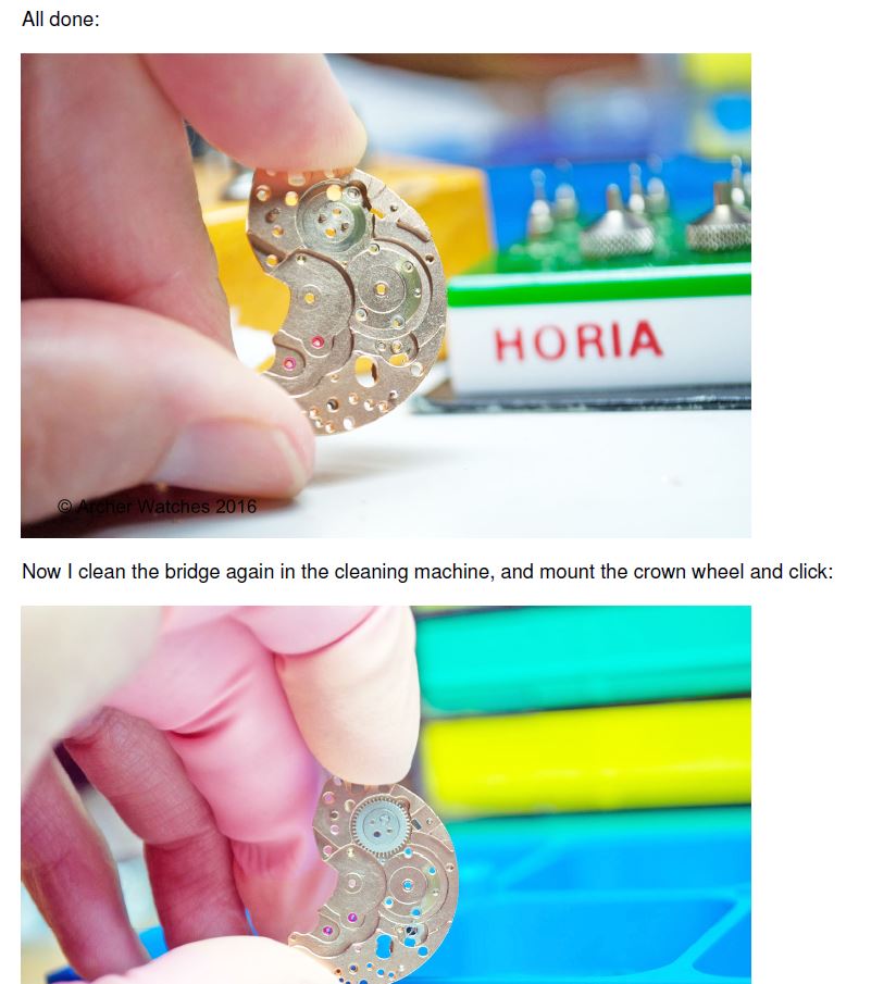

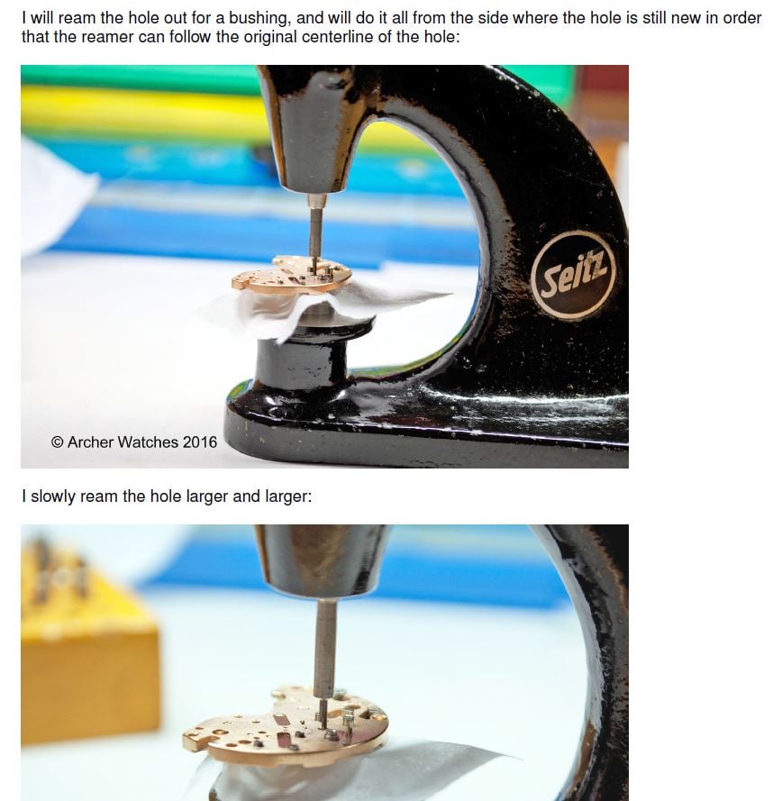

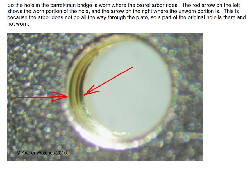

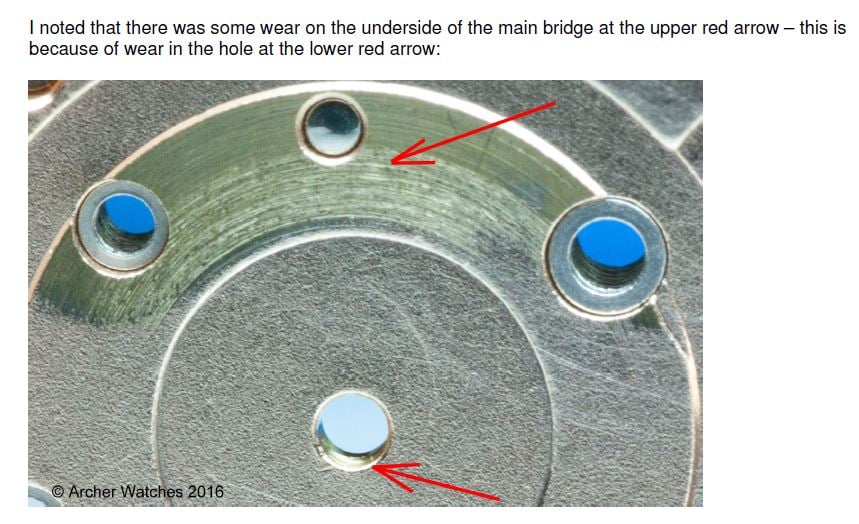

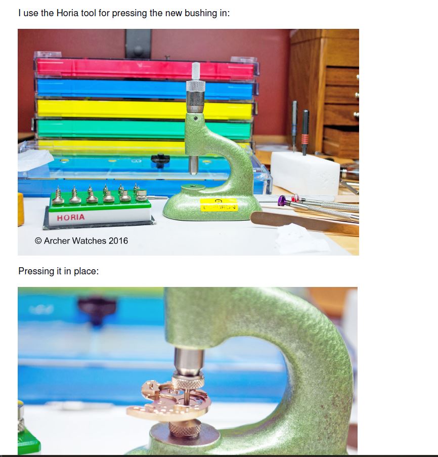

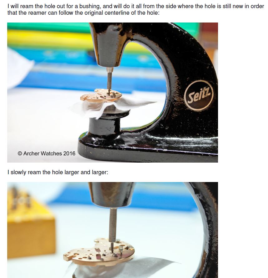

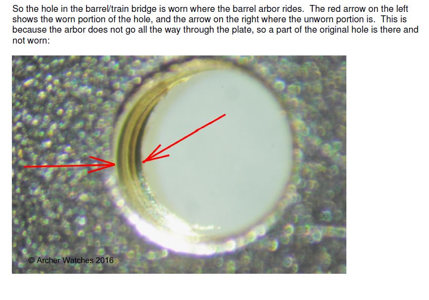

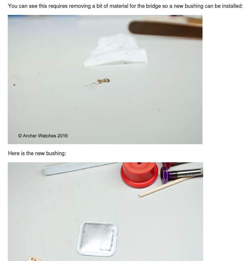

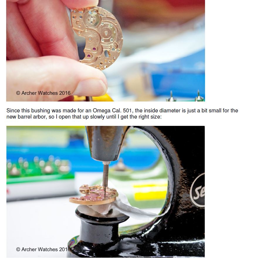

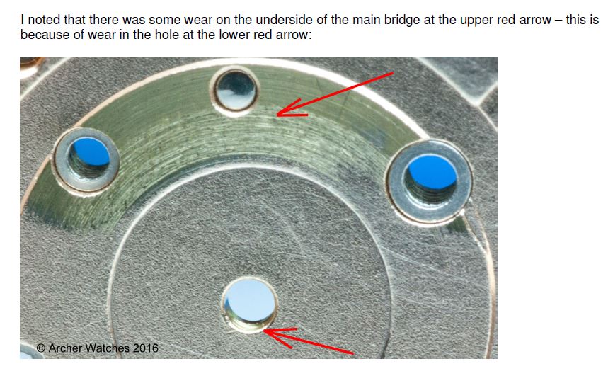

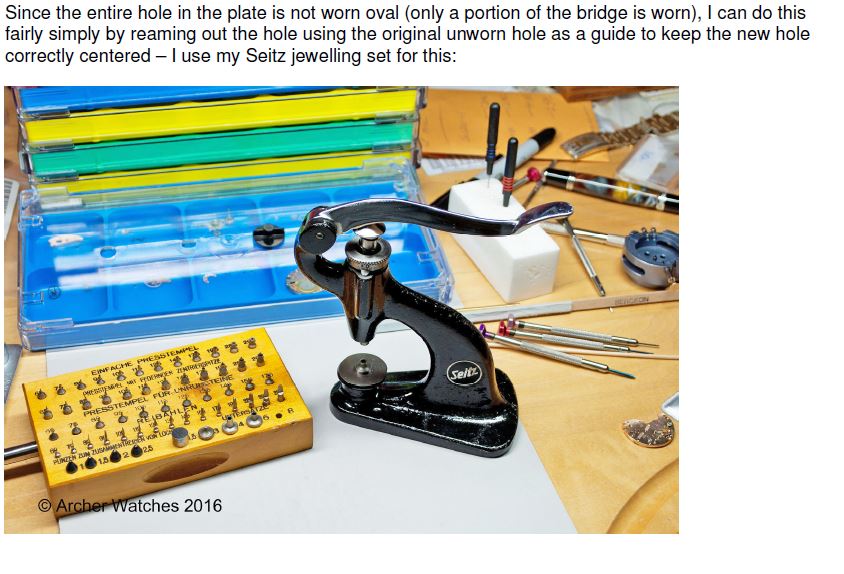

So there are things that an independent can do that Omega won't do too. About 4 years ago (how has it been that long???) @Archer serviced my -76 Speedy. There was uneven wear in the main bridge, in the hole where the Barrel/train bridge is mounted (as I understand it). Typically, for an Omega service, this would have necessitated the replacement of the whole main bridge, at a cost of somewhere around $800 at the time. Instead Al corrected the issue with a bushing, as shown below.
