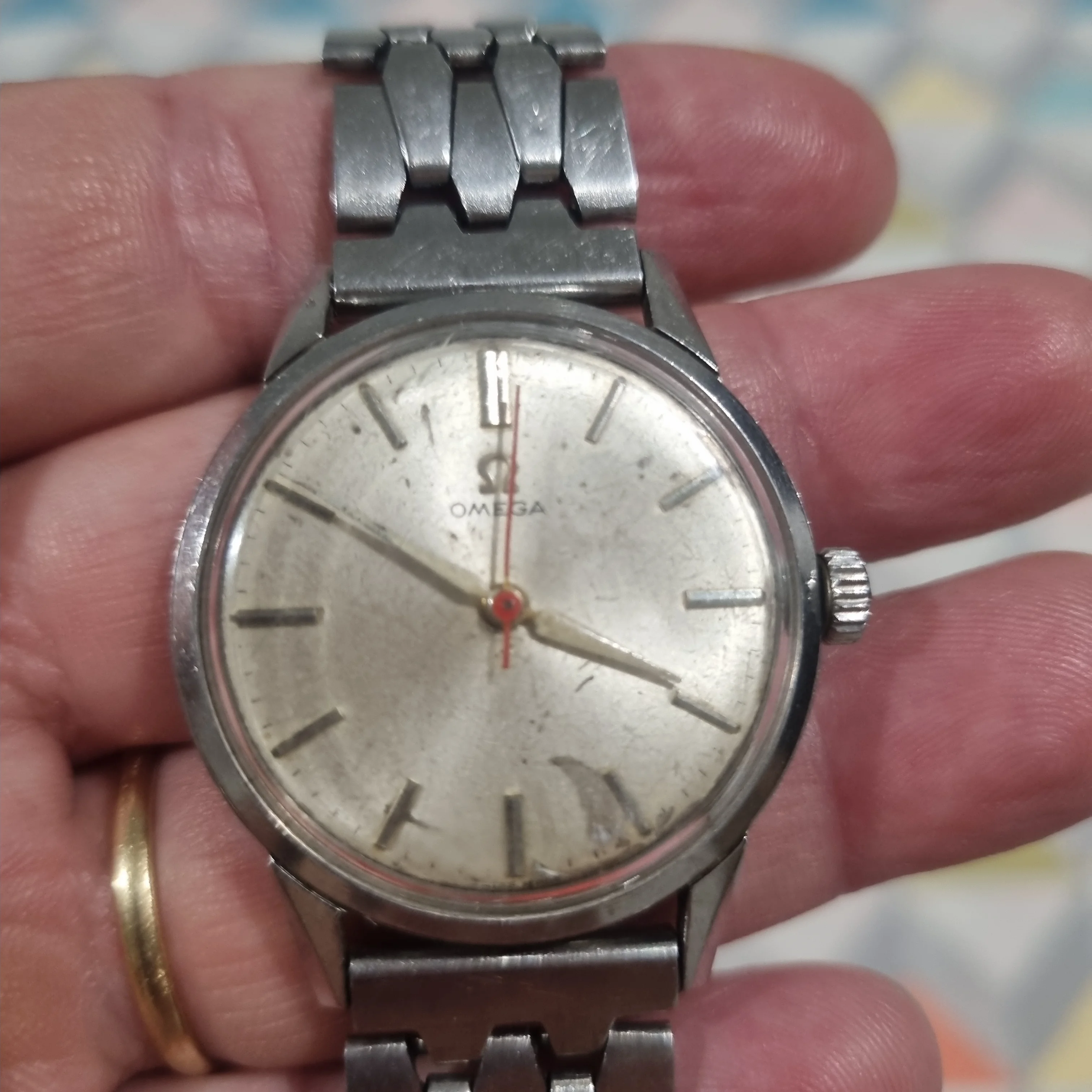

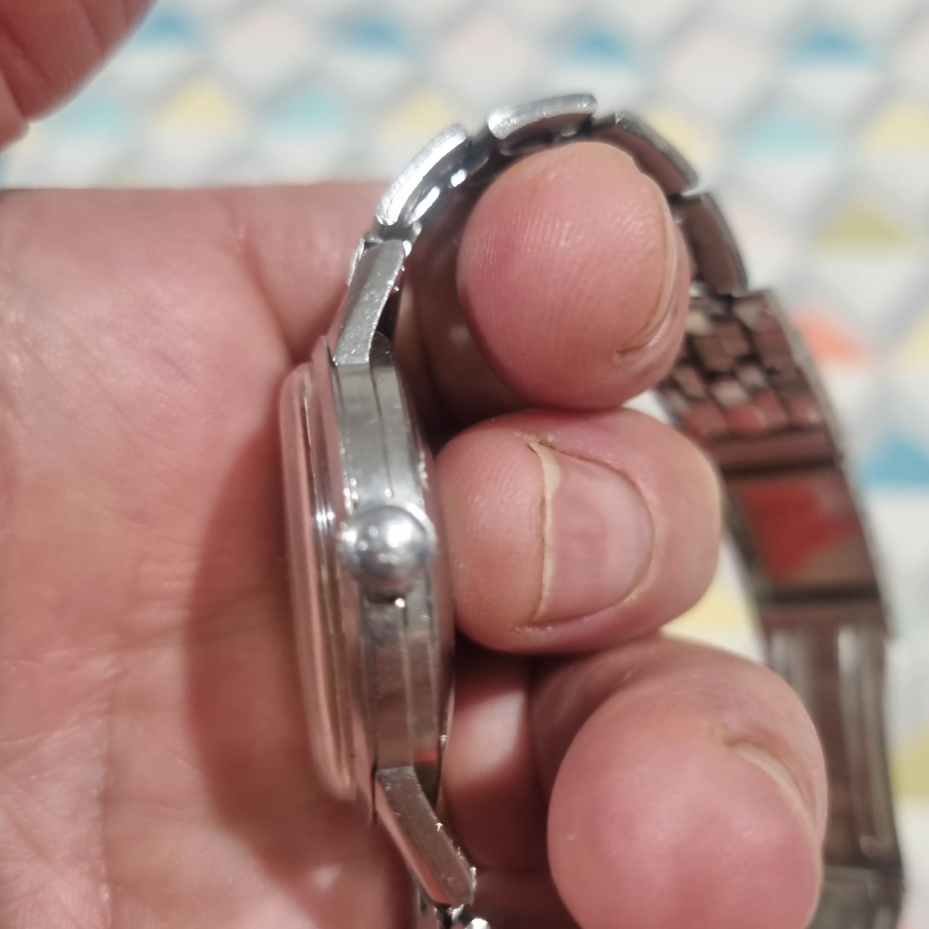

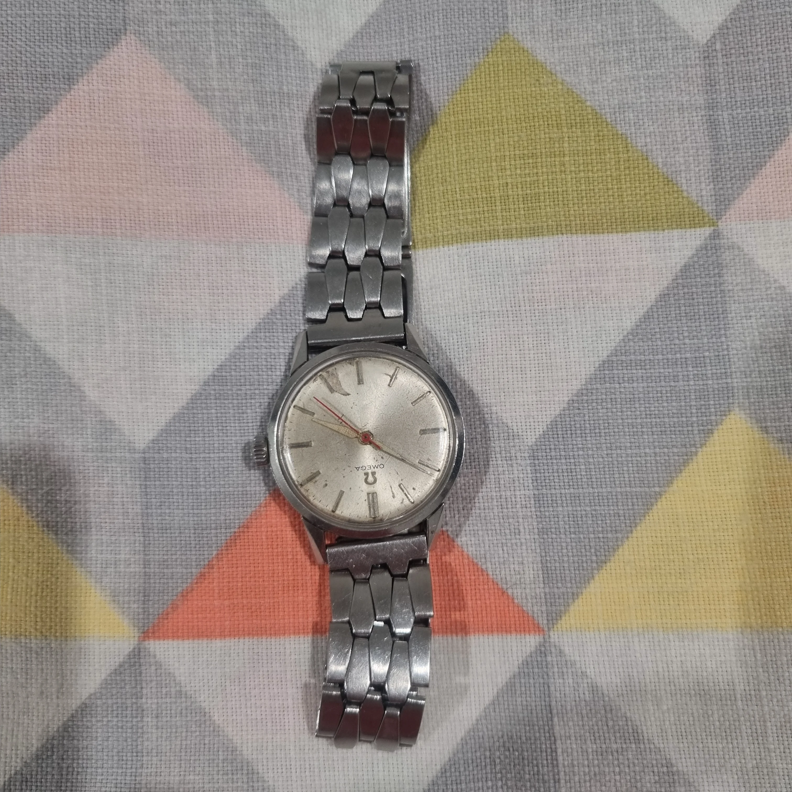

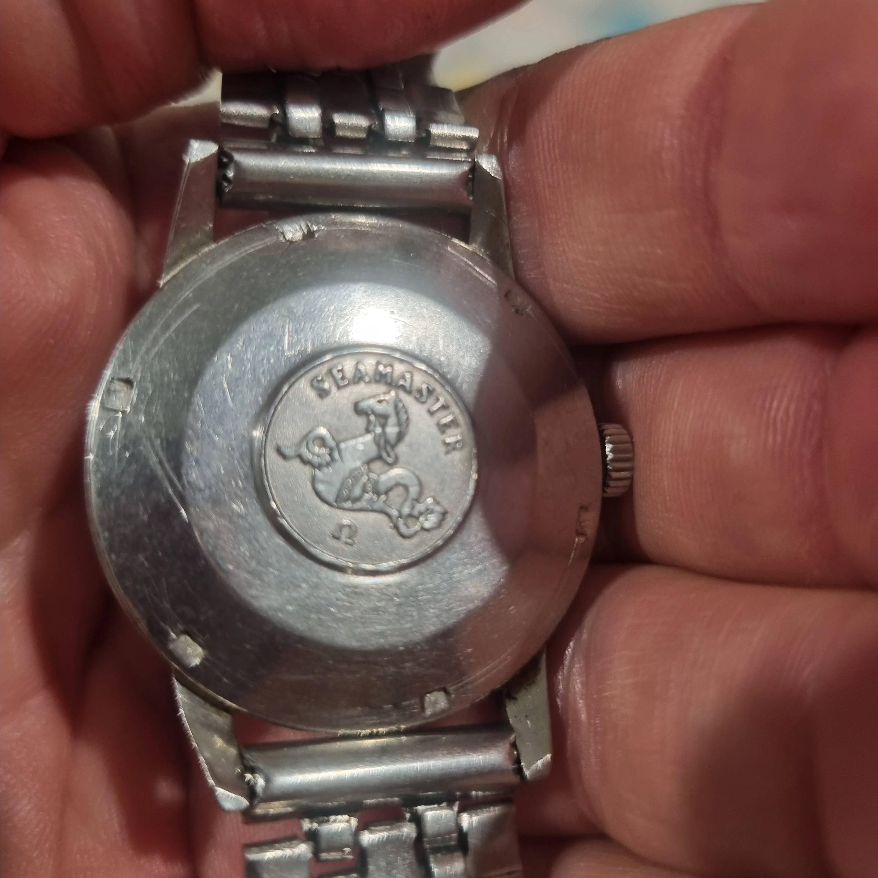

Hey guys I am trying to understand what would I need to restore this watch and what cost would it be involved.
This was from my grandfather, I beleive it might be somehow from the 59's but I might be wrong.
It's cord and still works.
I would appreciate any advice.

Looks like early/mid 60’s. I can’t recall the reference for that case but someone will likely ID it. If not the reference is inside the caseback.
Unfortunately it’s been well worn. The dial is heavily worn/damaged, all the hands are wrong and the crown is wrong.
One option would be to have it serviced and simply wear it as is. That’s the cheapest quickest option. If you wanted to go the whole hog and bring it back to what it looked like when it was new, you would be best confirming the reference number and buying a donor watch, salvaging the dial, hands and crown to use with your case and movement.
