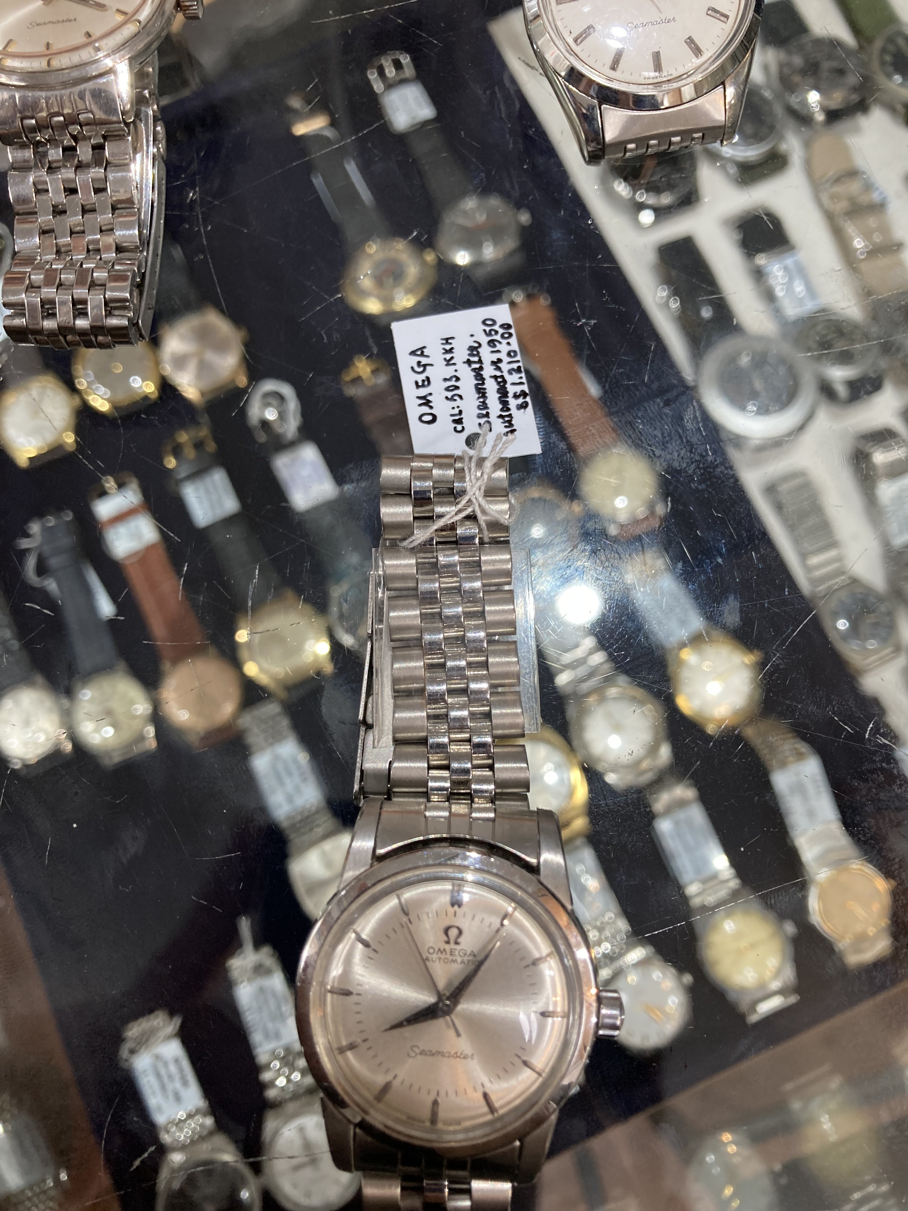

Omega Seamaster vintage 2846-1SC cal 503
4
Hi all - have been offered this piece but haven’t seen this caliber, case, and dial come up as one online. Anybody more familiar with these 50s watches? Cheers
3,596
13,553
It's a redial. Also, a 2846 should have a cal 501, not 503, but I guess that's not really relevant given that it's been refinished anyway. Lugs look weird too, by the way, did they brush the top of them?
/edit: 1210USD?! 😲
13,493
31,814
Mmmm, as above plus caliber 503 is a date movement.
13,493
31,814
Good saves thanks heaps
Glad you asked before buying
Hate it when someone comes here asking about a watch after they've bought a mess.
Happy hunting.
