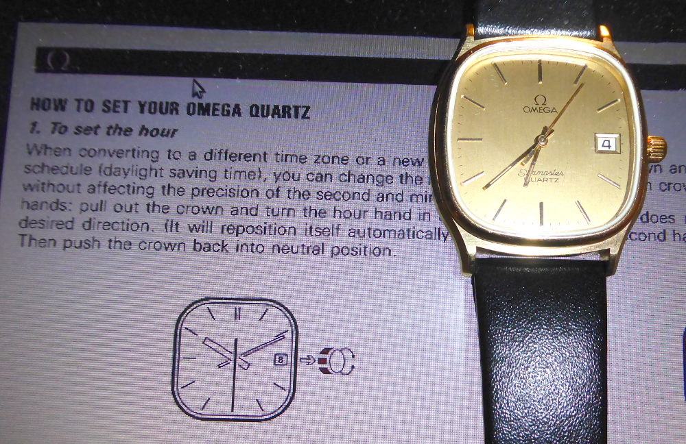

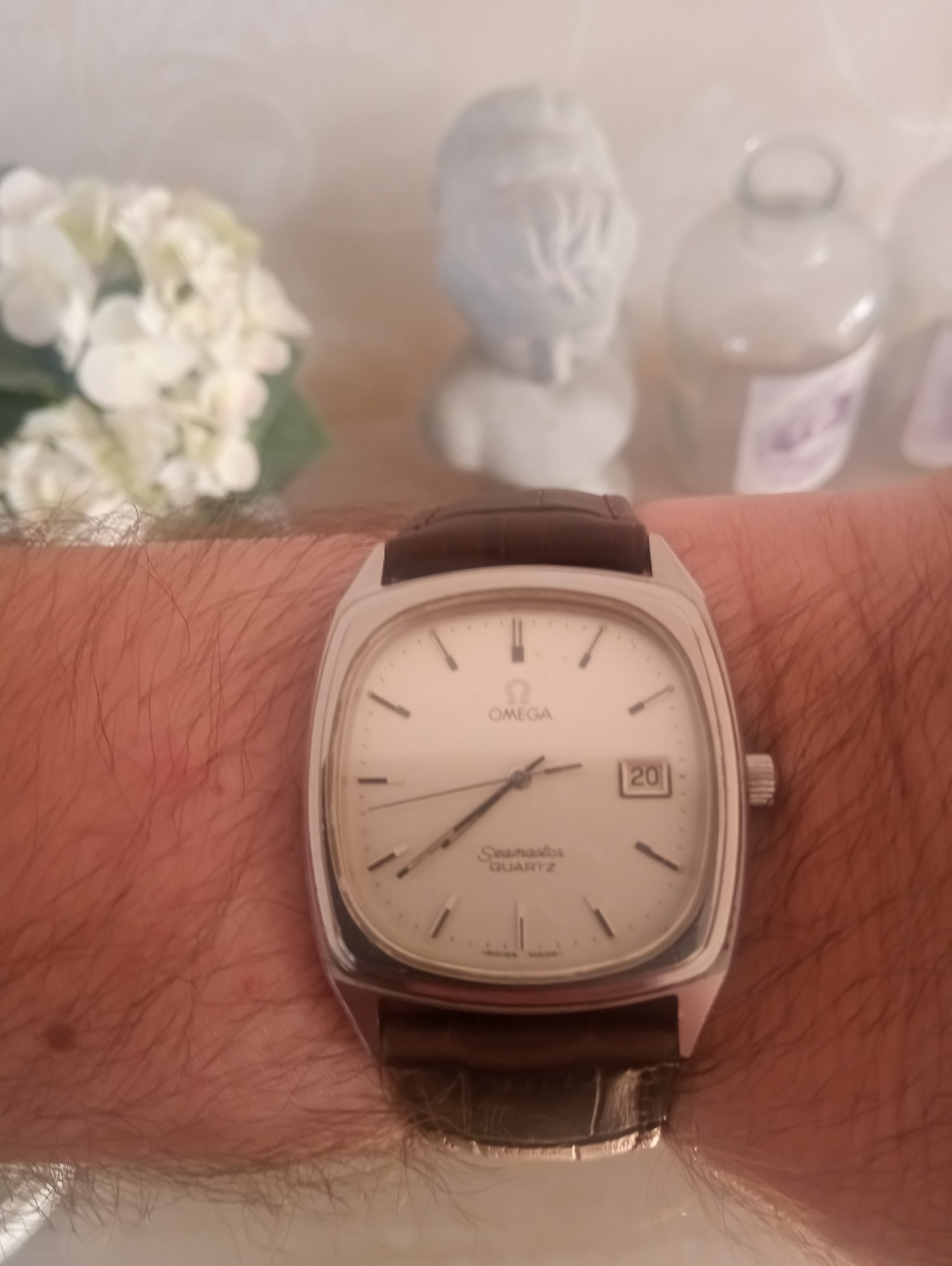

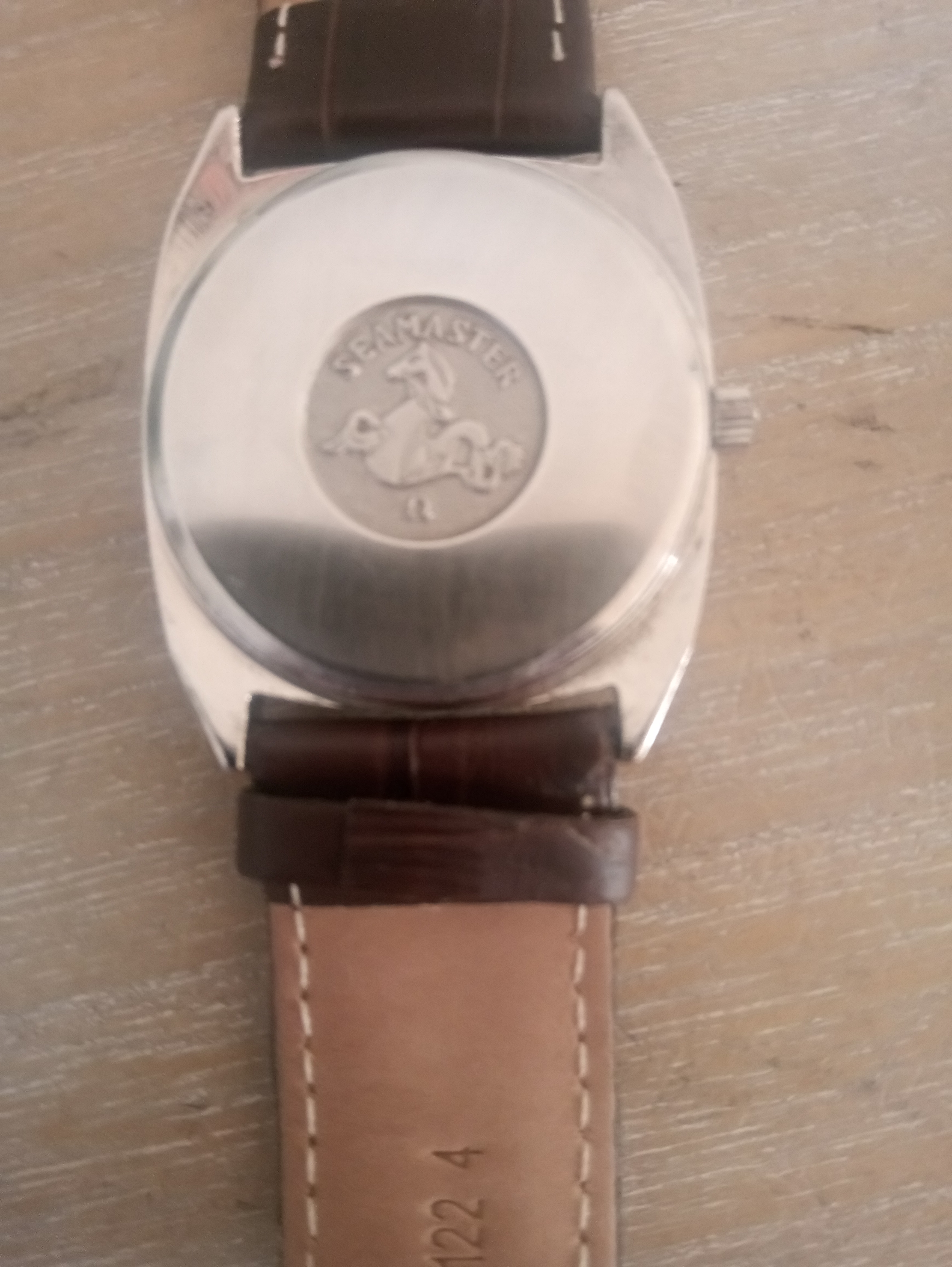

I have had now for a few years my Seamaster Quartz which is dated about 1979
It has the calibre 1342 quartz movement
It works , had new battery's fitted etc ...but it seems to lose about 2 -3 minutes every few weeks
Is this fixable or will it slowly decline and get worse ?
I have added pictures of my watch for reference
Many thanks
Mark
