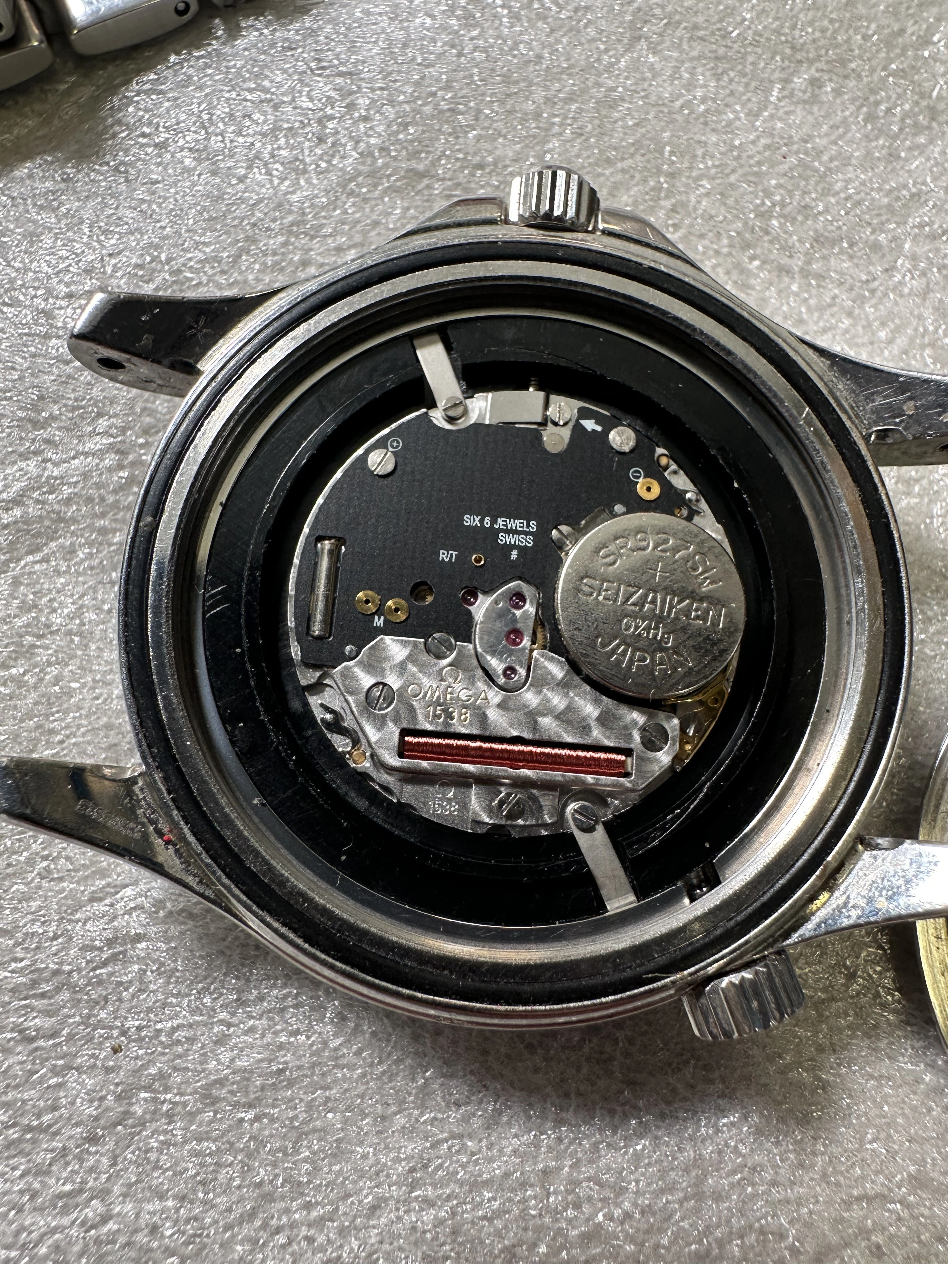

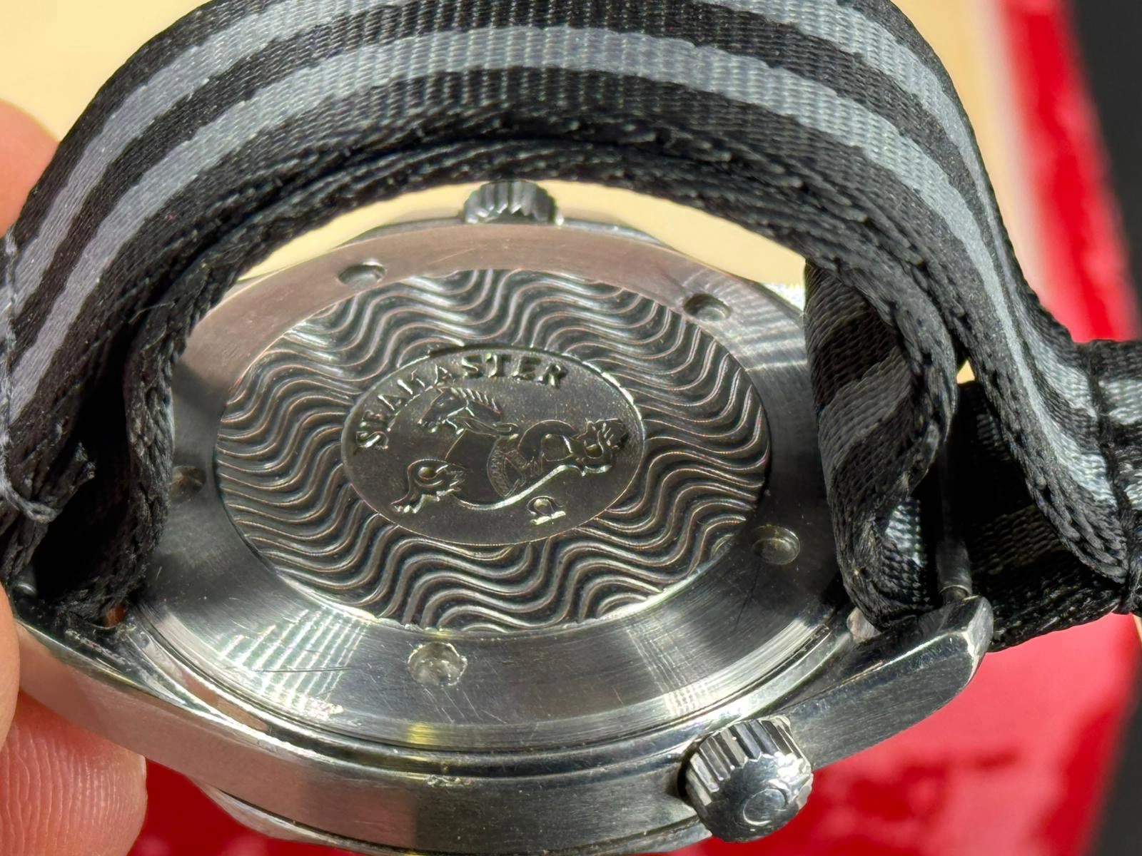

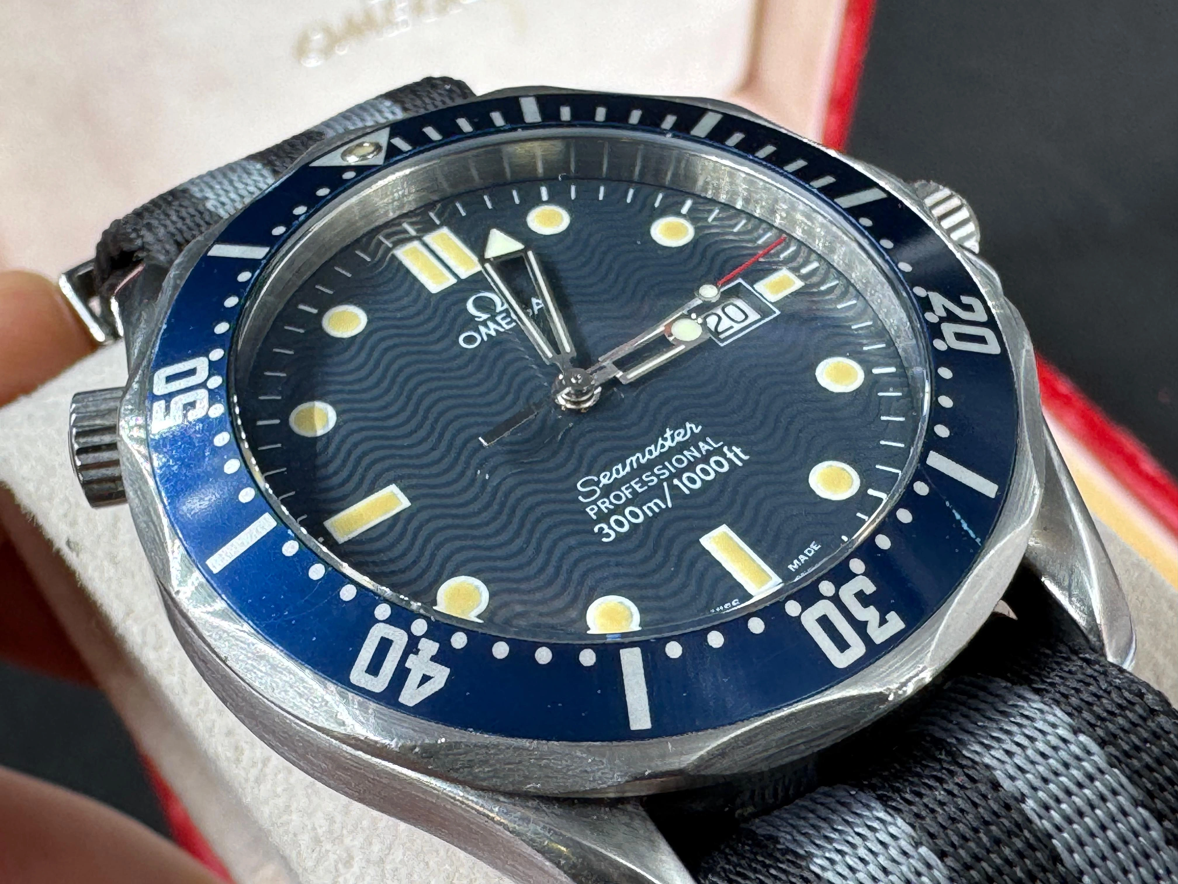

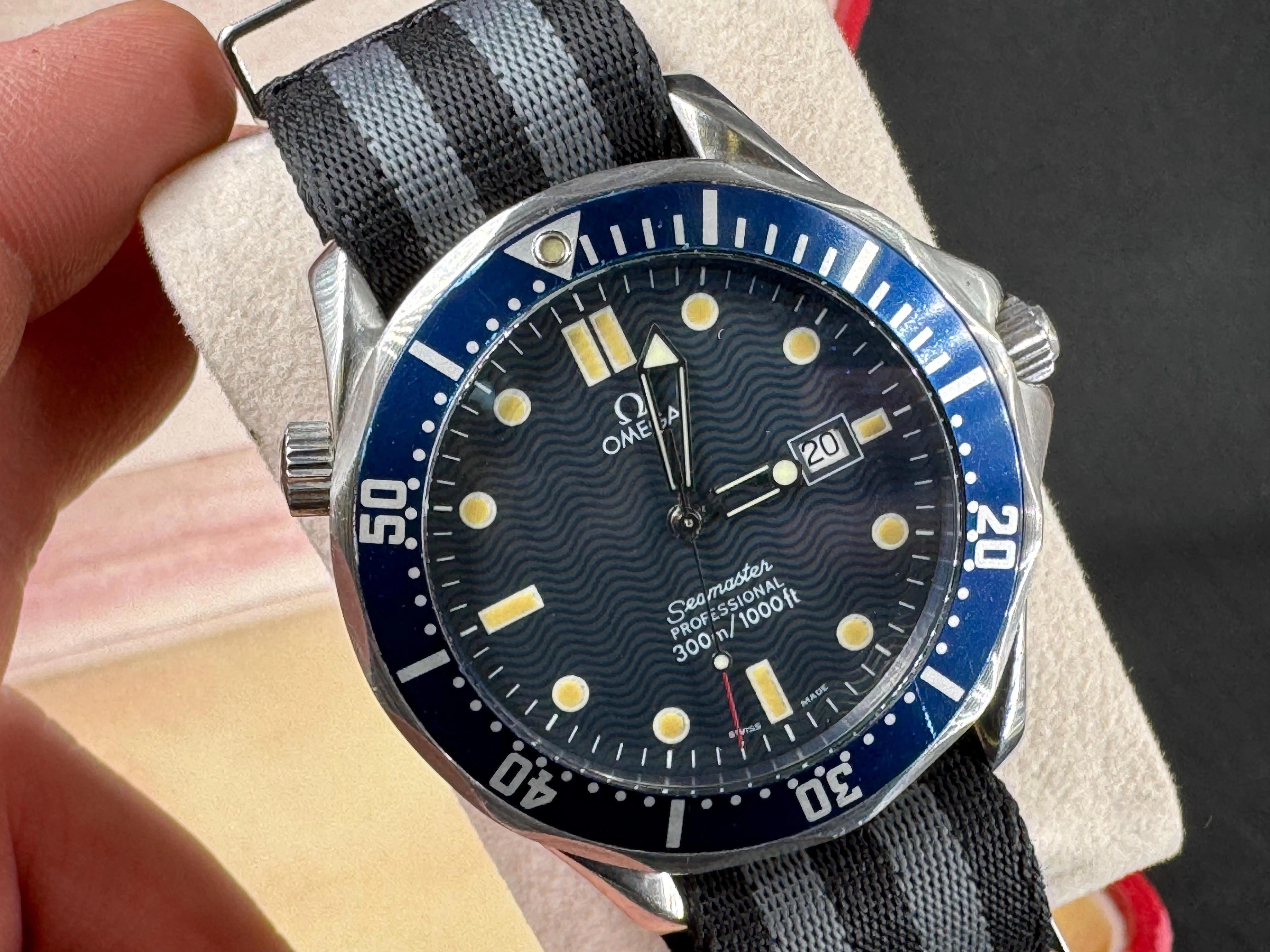

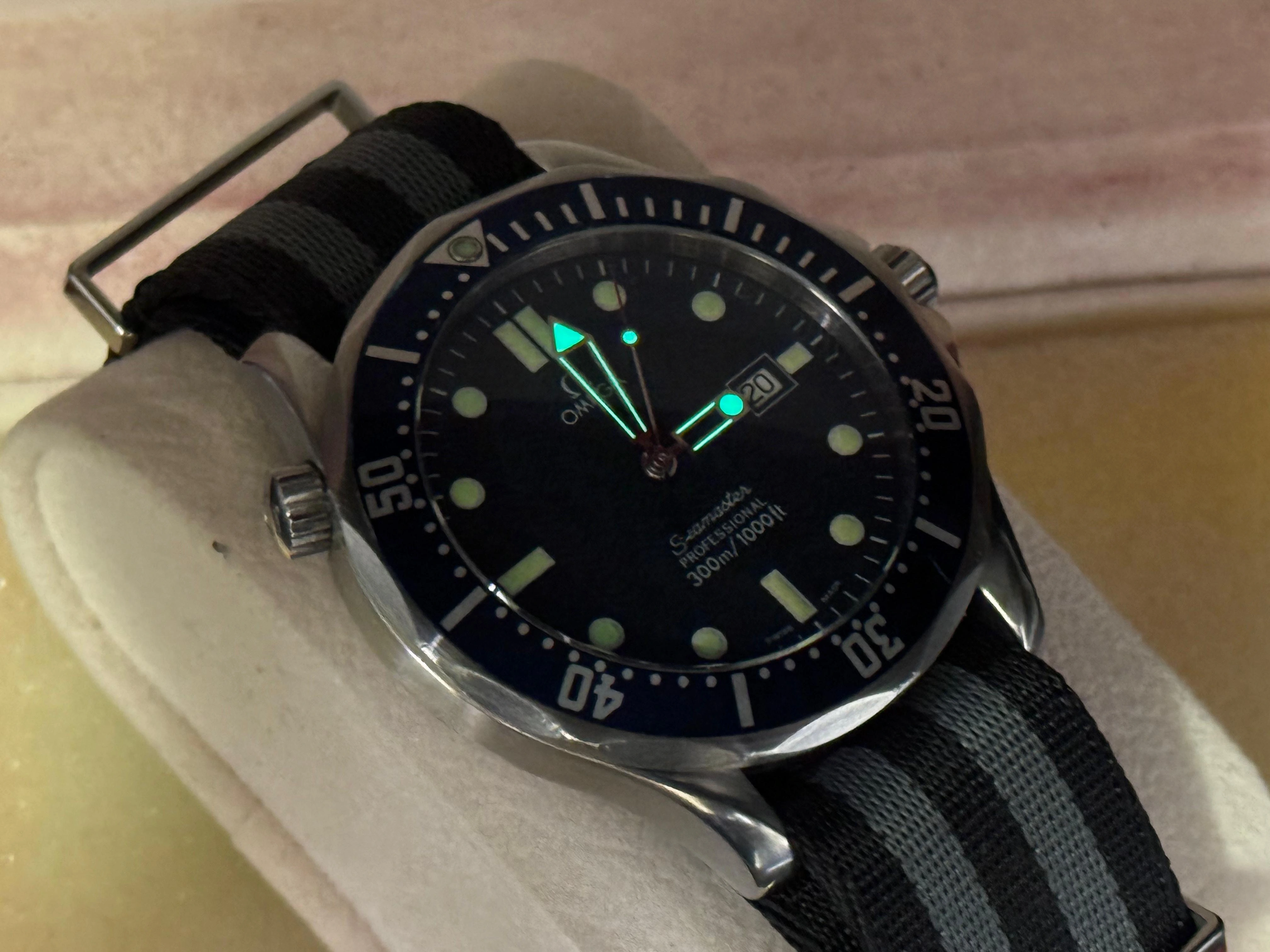

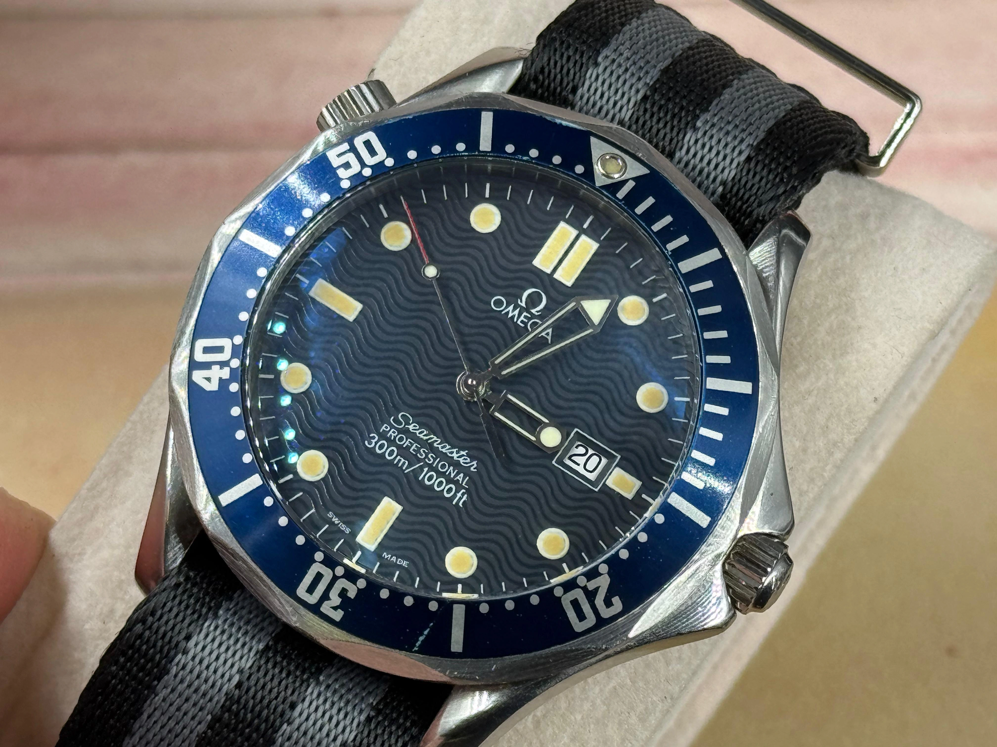

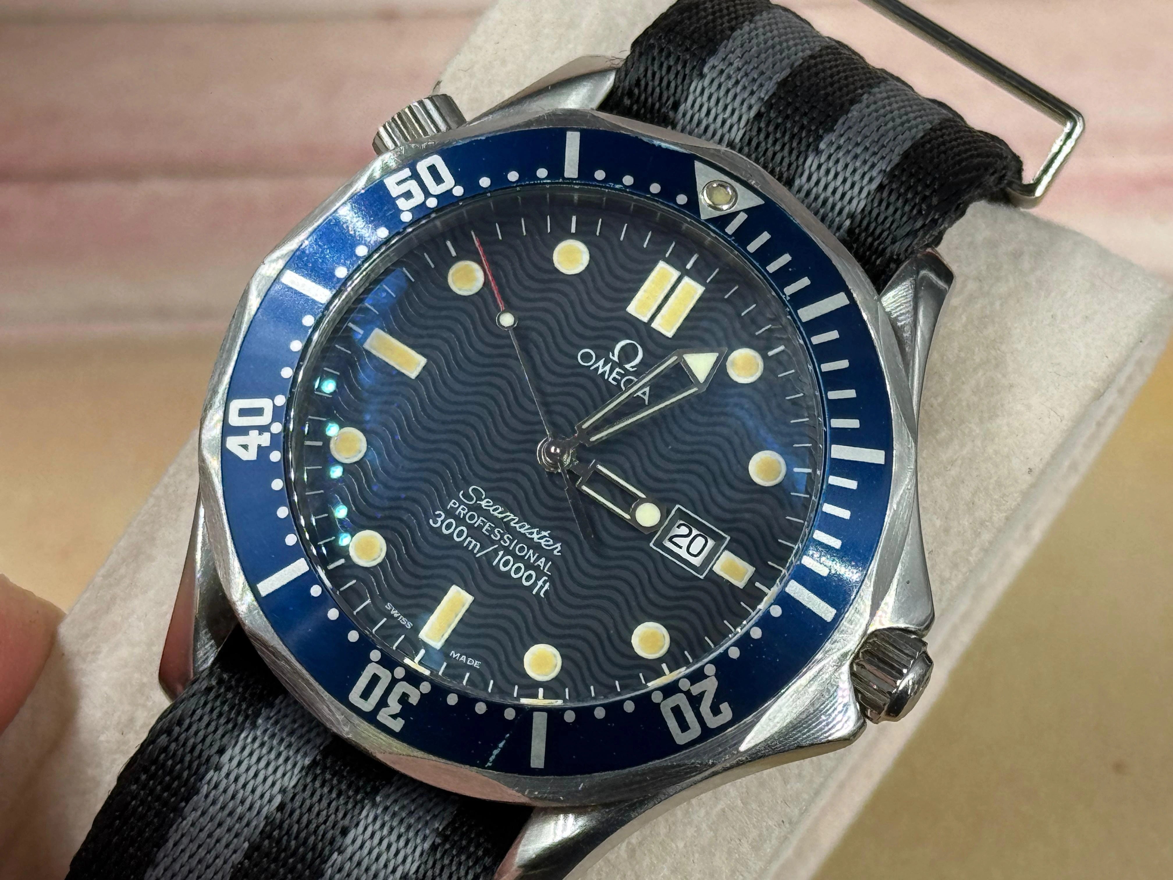

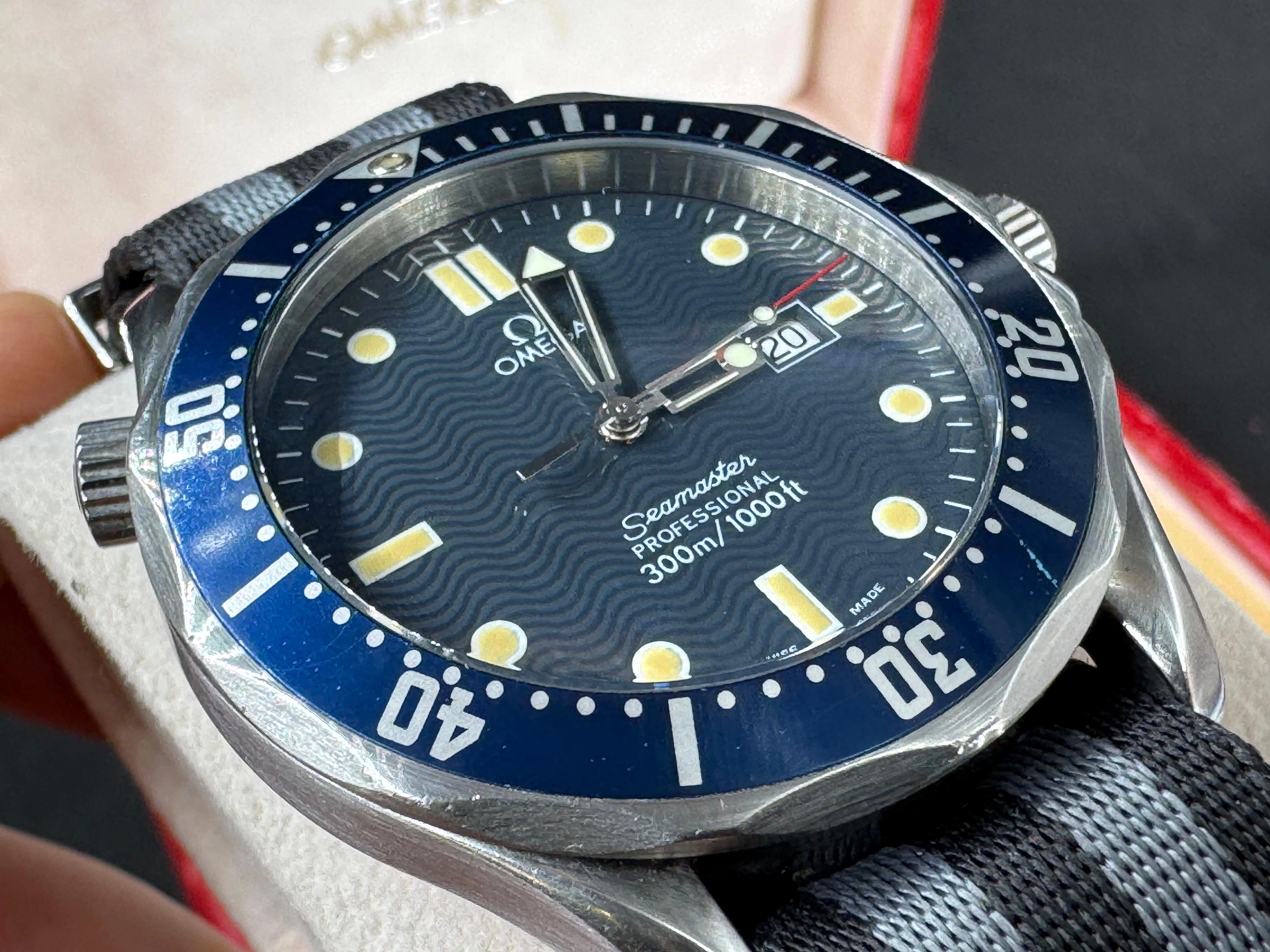

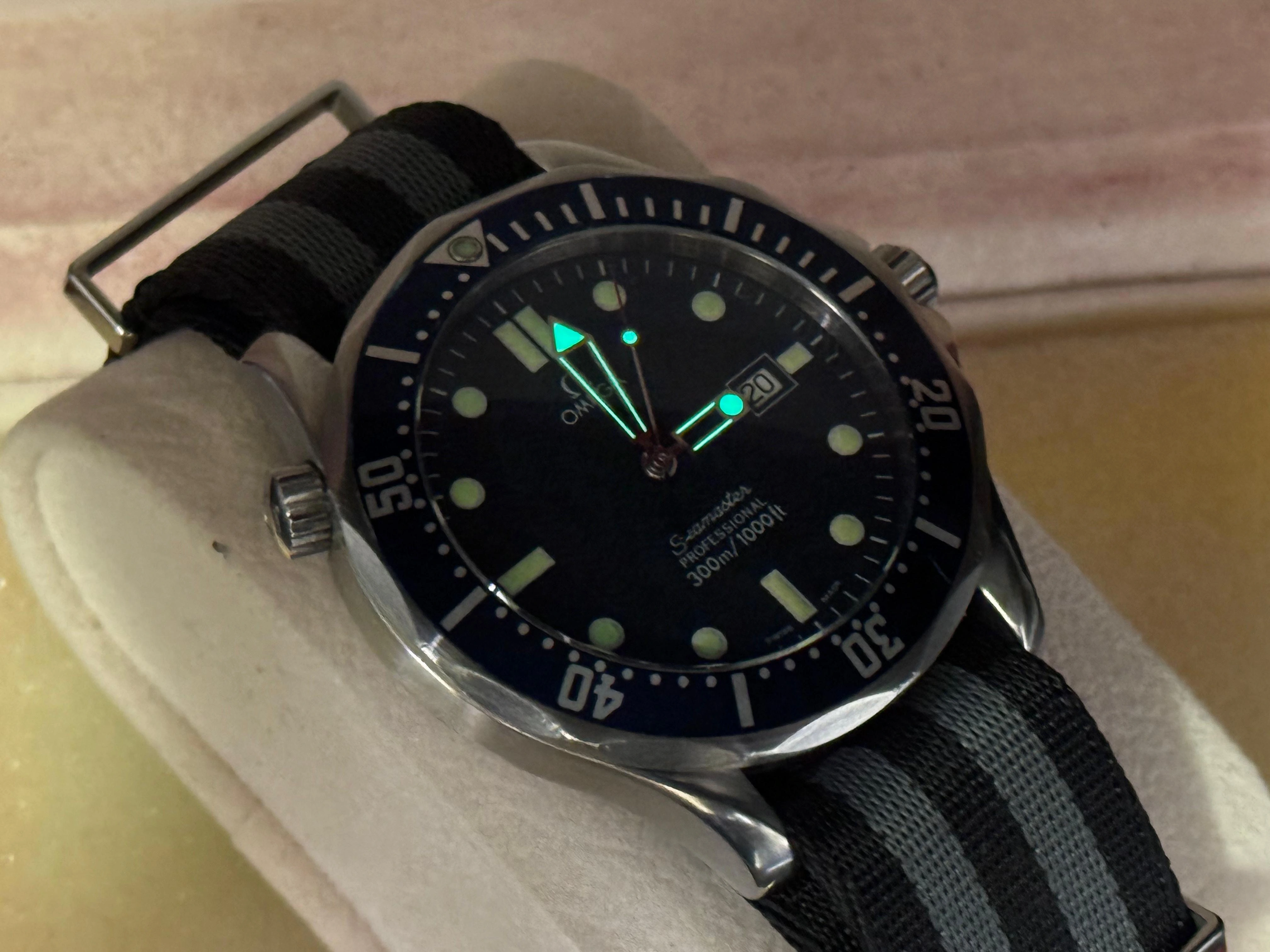

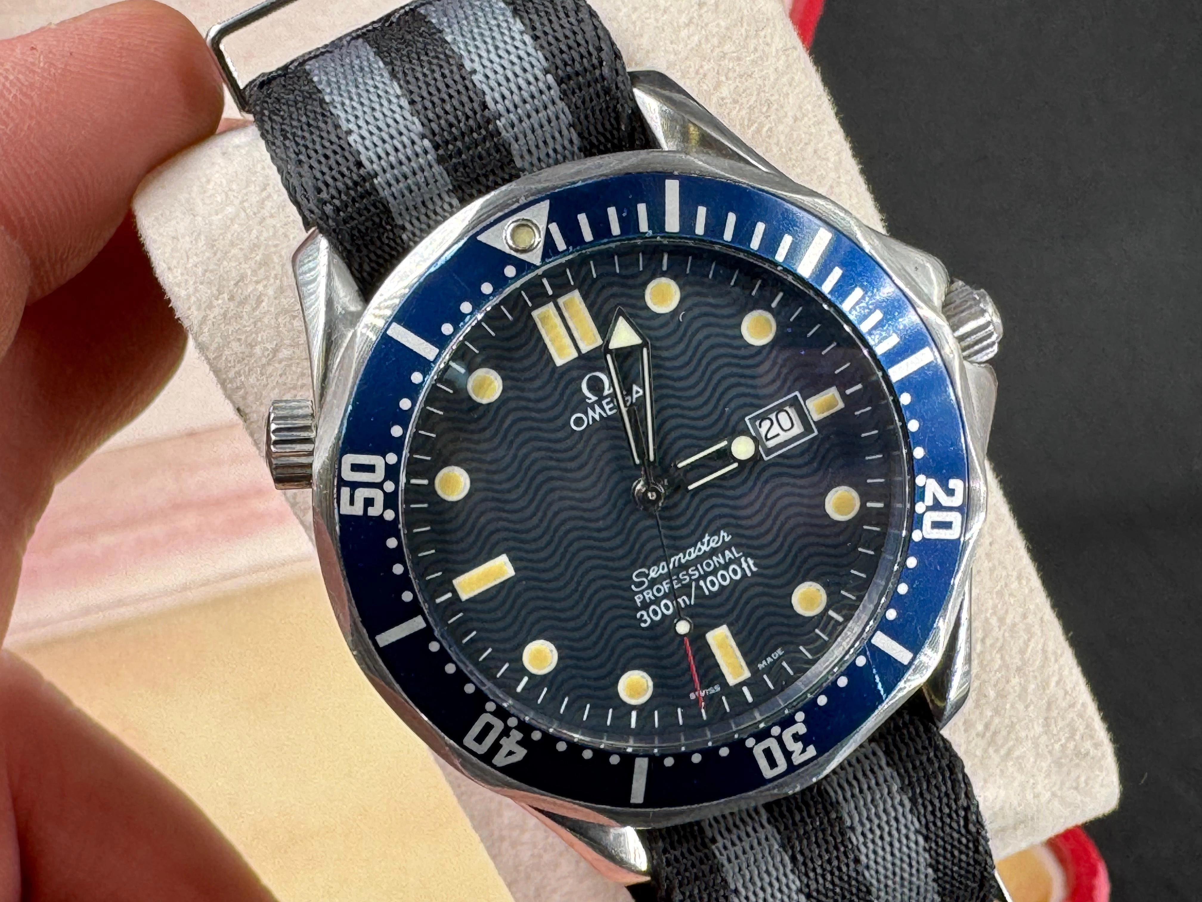

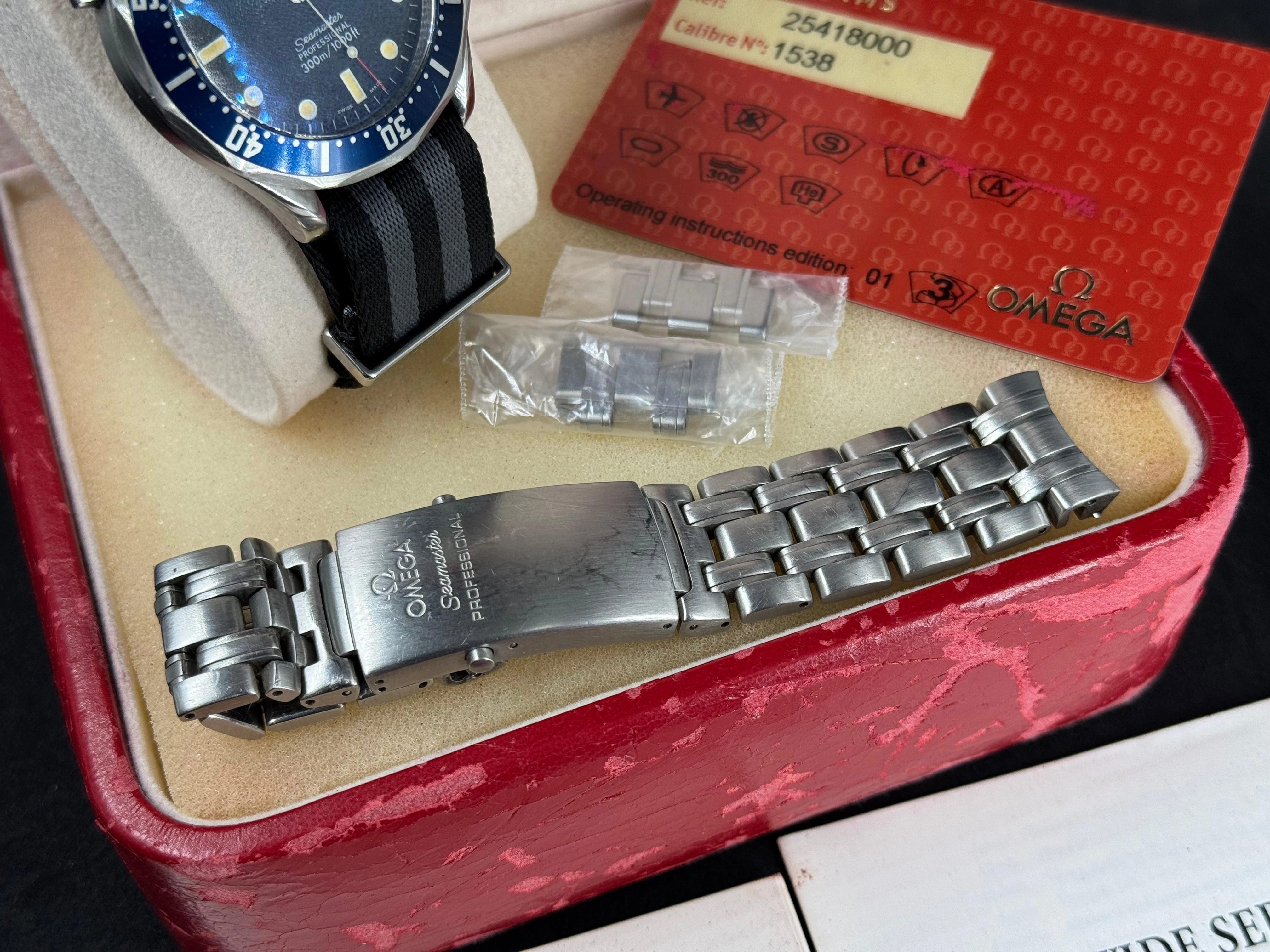

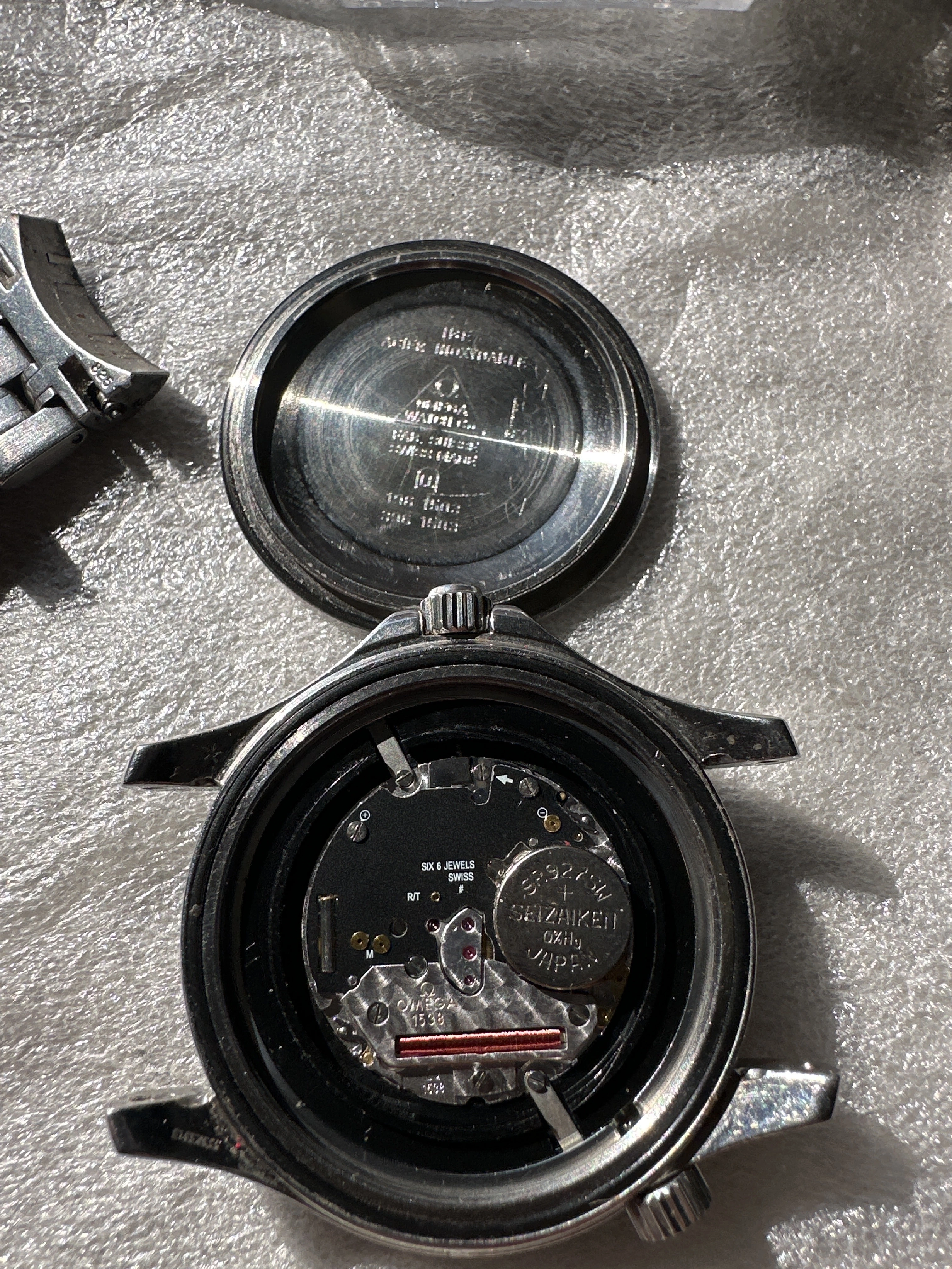

I have recently acquired this Seamaster. Im suspicious on bezel (number 4 mostly) lack of lume comparing to hands.
Can you please help me on this

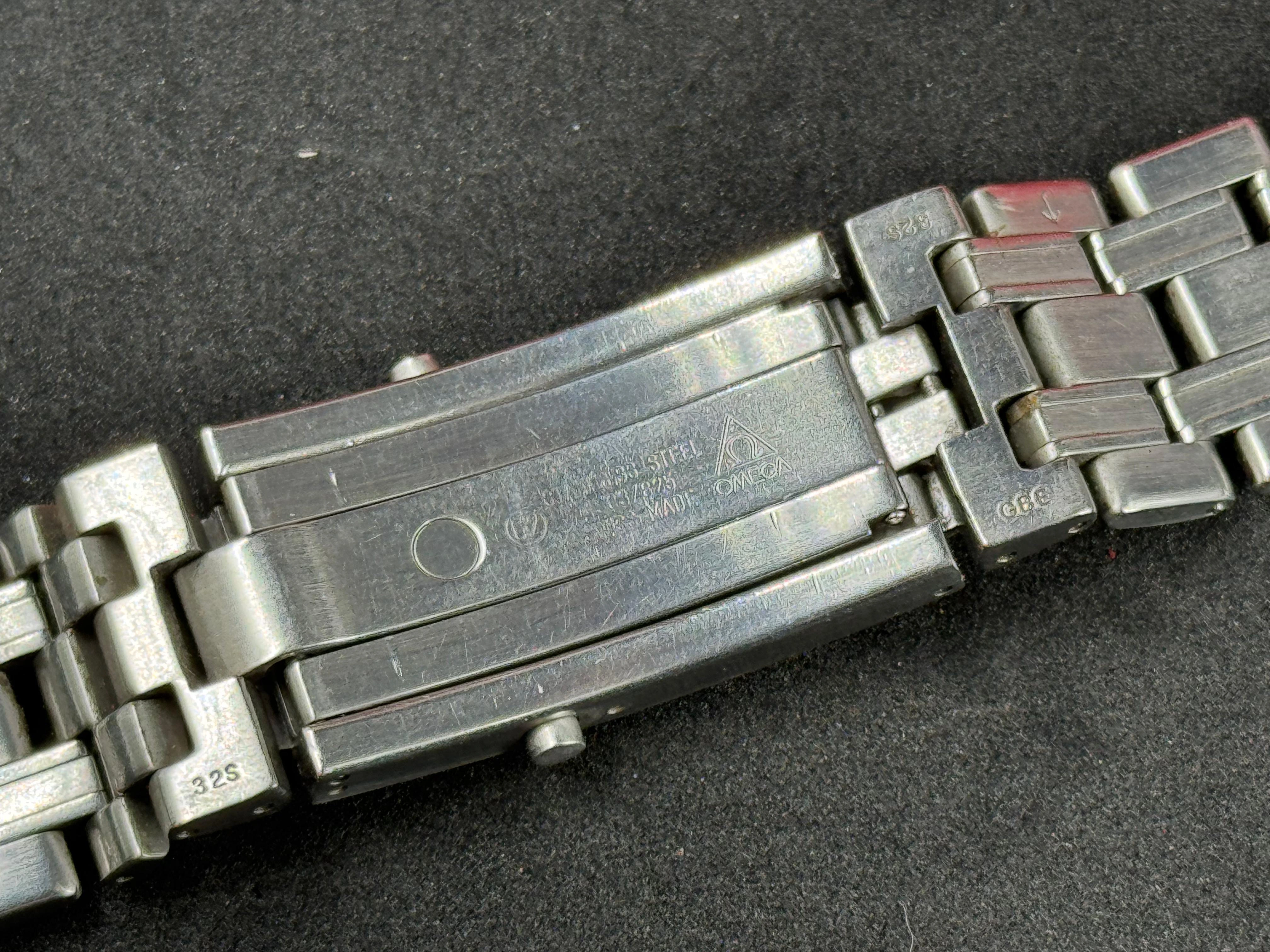

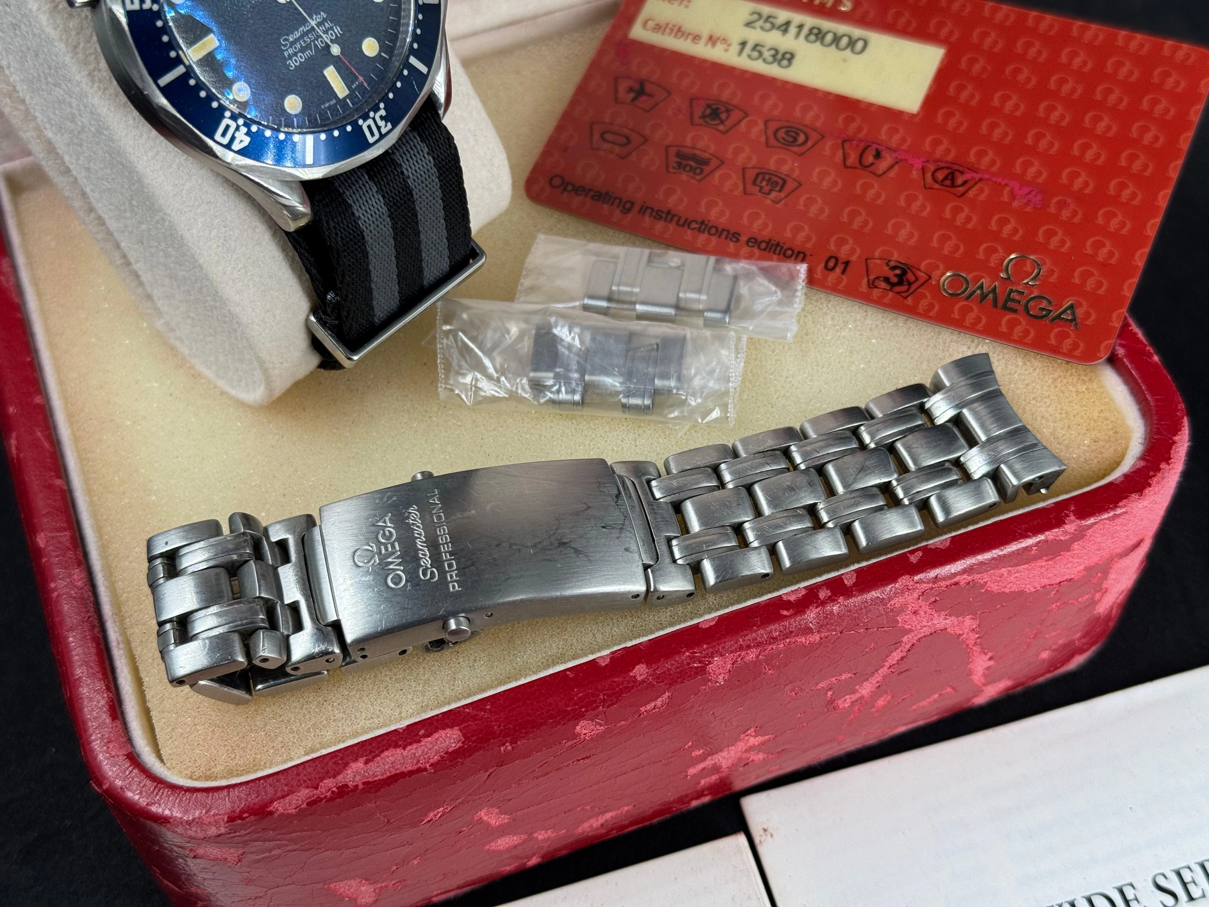

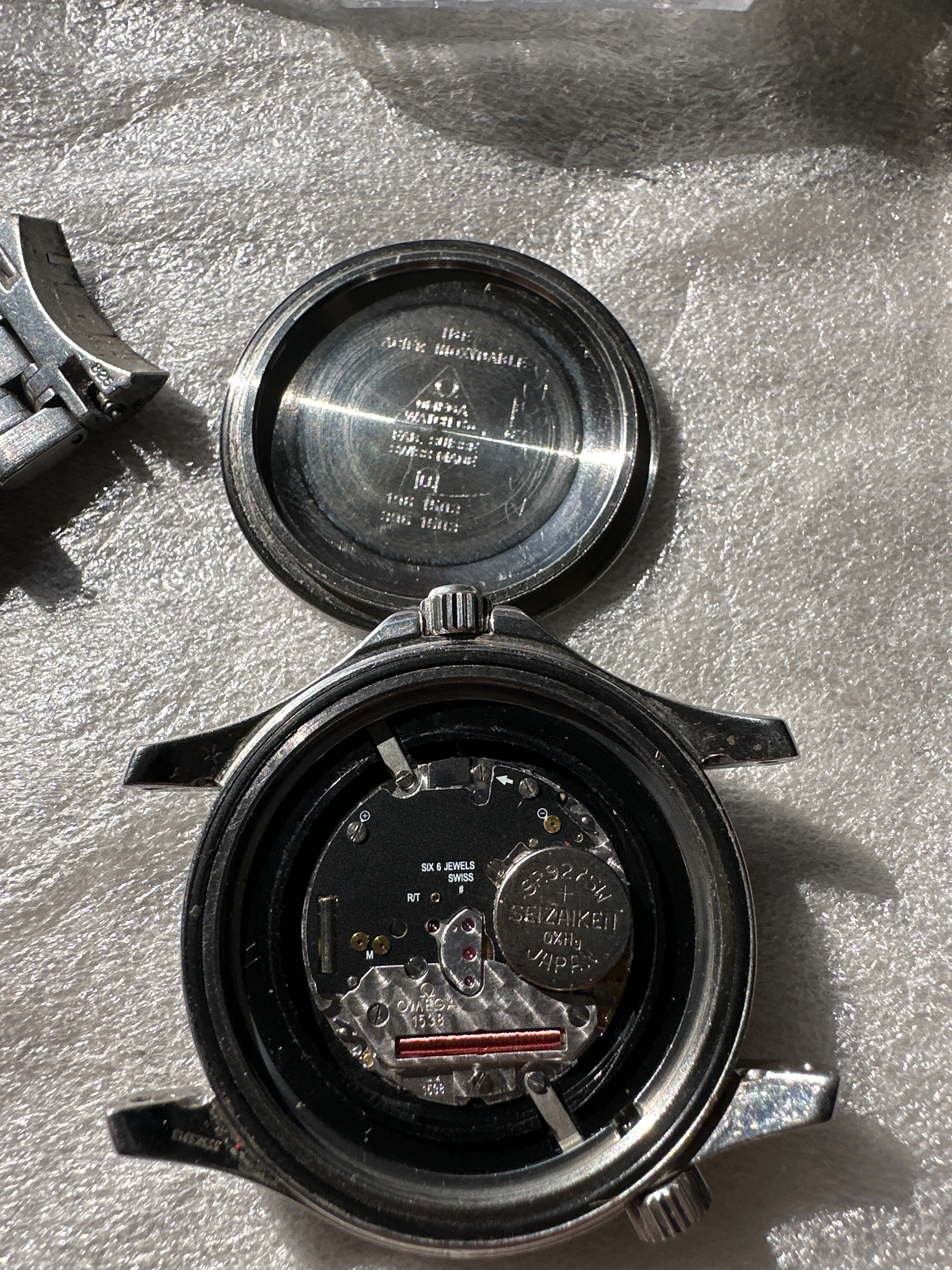

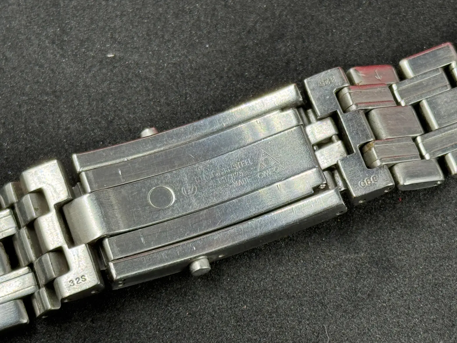

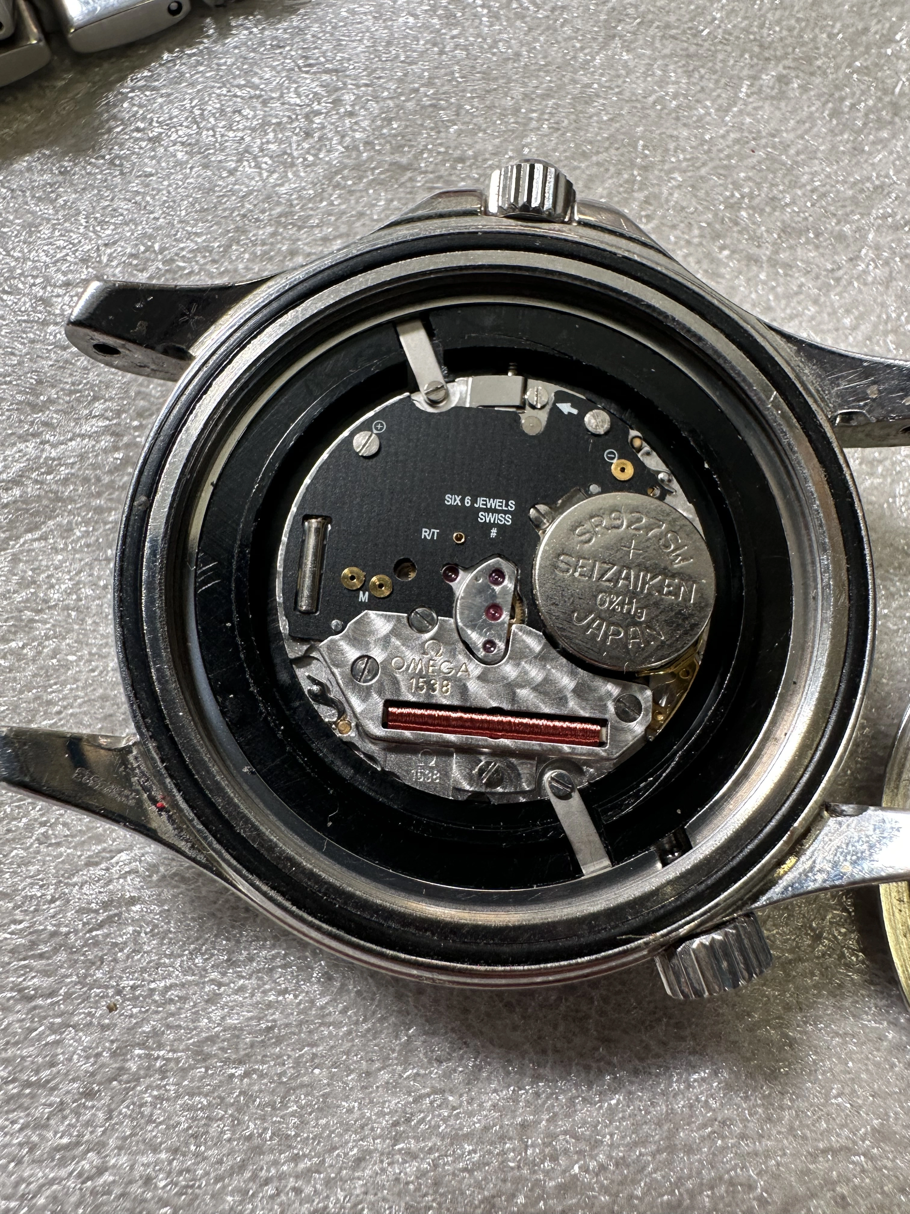

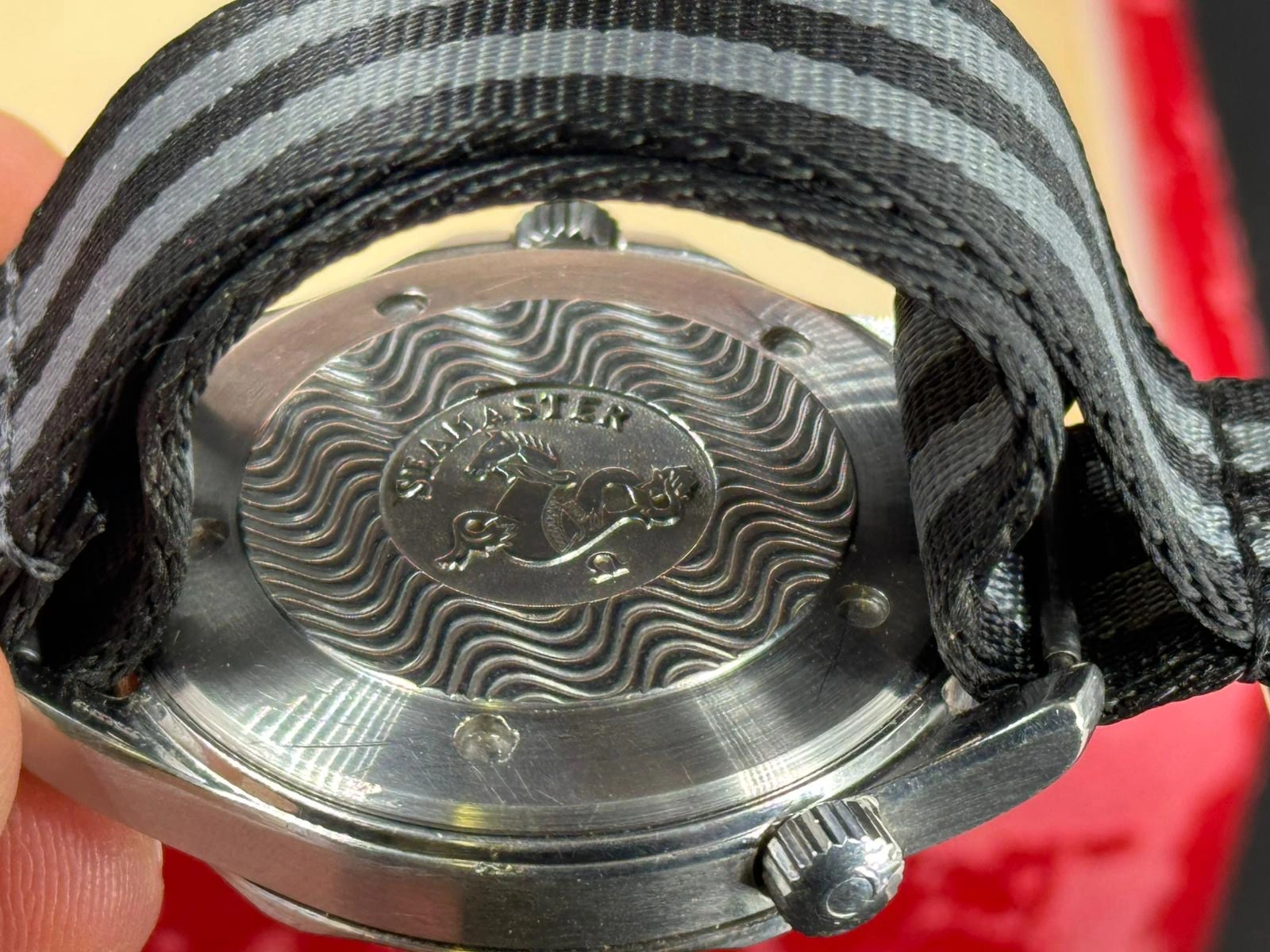

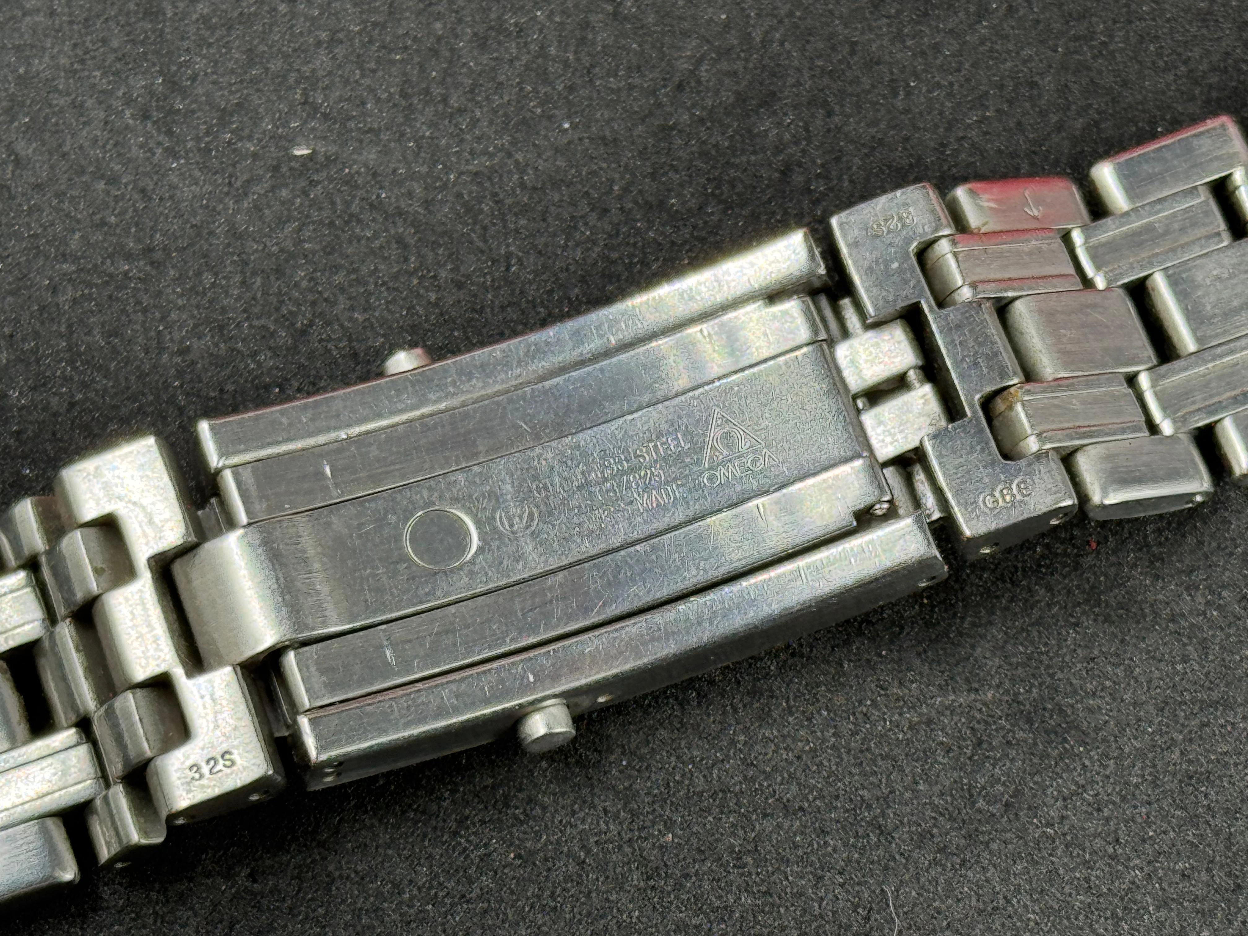

It looks fine, legit but obviously used. If you are worried because it looks cheap, I trust you are aware it is the quartz version which is like ~$300 cheaper to buy than the 2531.80 auto version? Just saying. If you tell us what you paid we can tell you was it really a good deal. Most posts like this are for this reason.

Thank you for the reply i have paid $1352 just few days ago

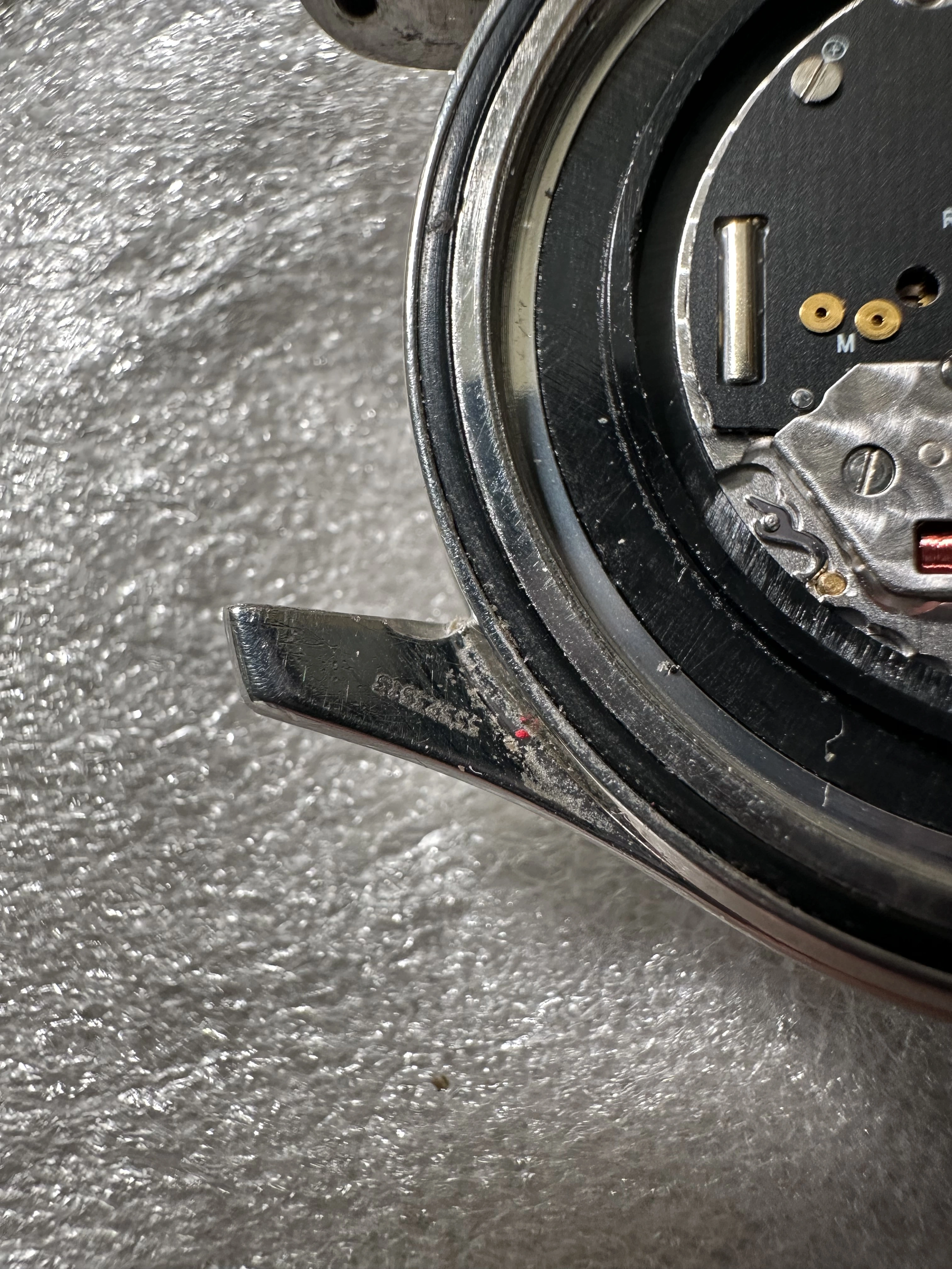

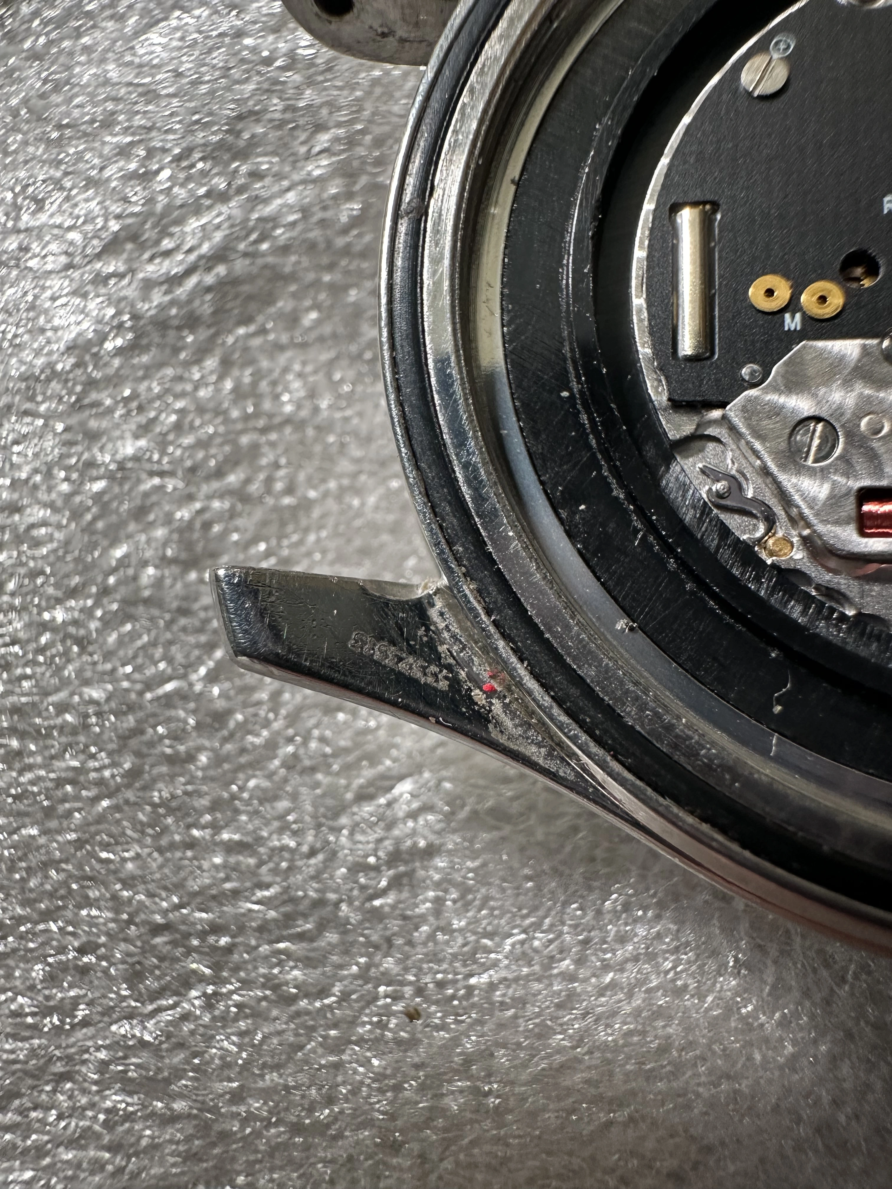

Well that does sound cheap it is true but it does look legit. As long as it it running OK you did well. If not well you only did OK but it aint fake. I see that in one pic you highlight a snag in a seal. Don't assume it is waterproof at present as it likely is not. That would be fixed with a service.

Thanks alot.runs fine changes the date as well. Thank you for your time and attention

I just noticed something, the dial has original tritium lume but the hands have been changed at service for Superluminova which is perfectly normal. Hence the pic with glowing hands but no lume glow.
