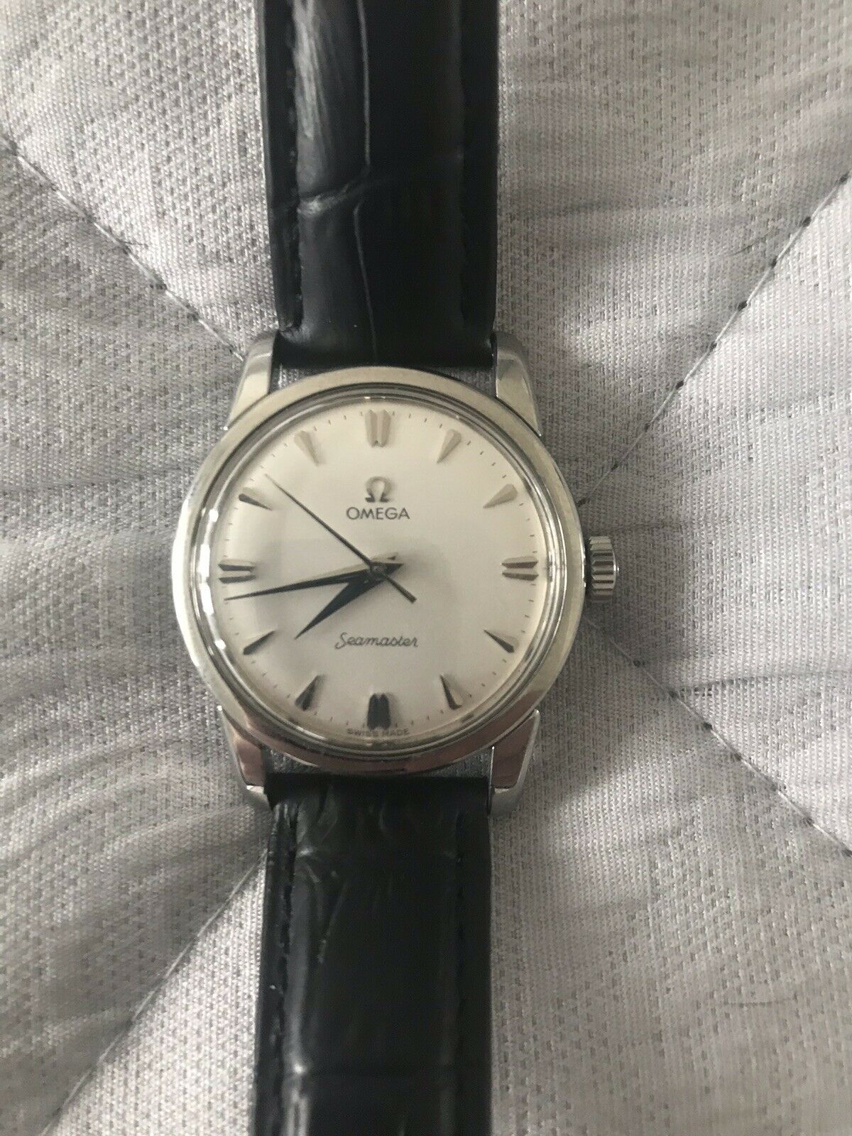

Hi all,
This Seamaster looks interesting. There is no info from the seller. I like the look of it but slightly concerned about the 'Omega' print and font? Have looked at loads of 50s and 60s seamasters today and none of them have the same! Any ideas what model this is?

Lettering in Omega does look off a bit. Plus the 'S' in Seamaster. And the lack of alignment for "Swiss Made"

Crown is a recent replacement.
Does the seller say it's an automatic or hand-winding?

Thanks all for your input. Really interesting observations. I should have posted link to item as easier to come to a view I guess.

It is automatic. I love the shape of the case. I’ve been looking for a nice 166.010 and this one caught my eye but something about the omega font put me off.

It is a redial. It should say automatic if it's an automatic right on the dial.
Leave it.

Excellent thanks for the advice
