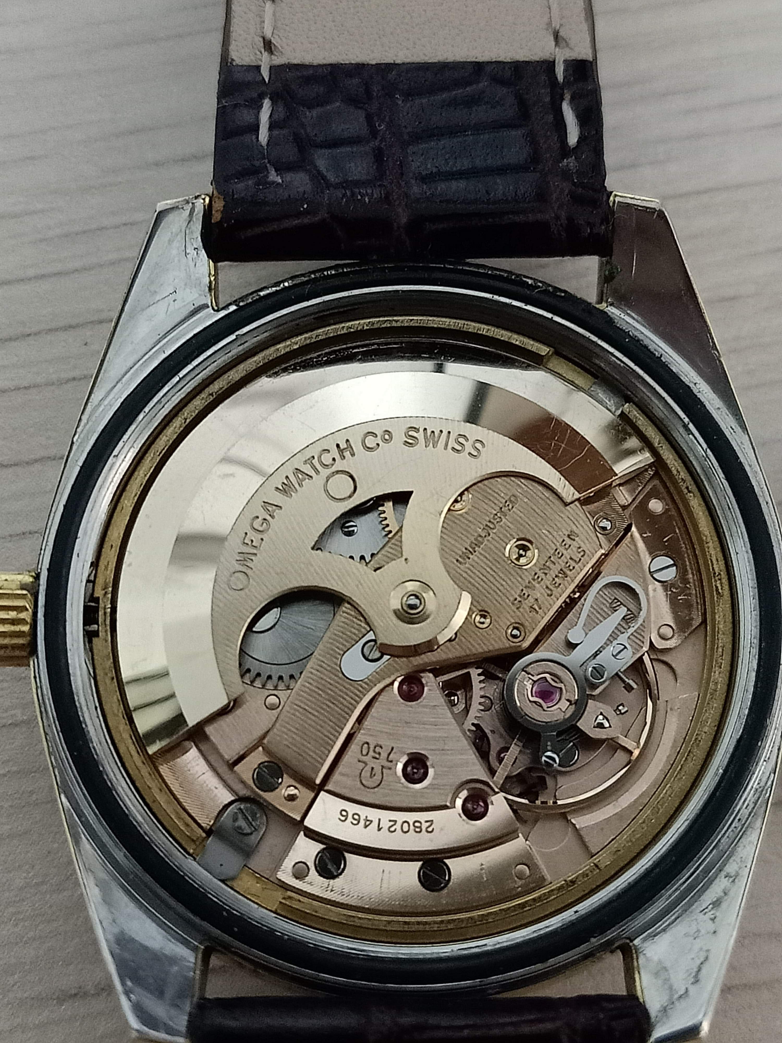

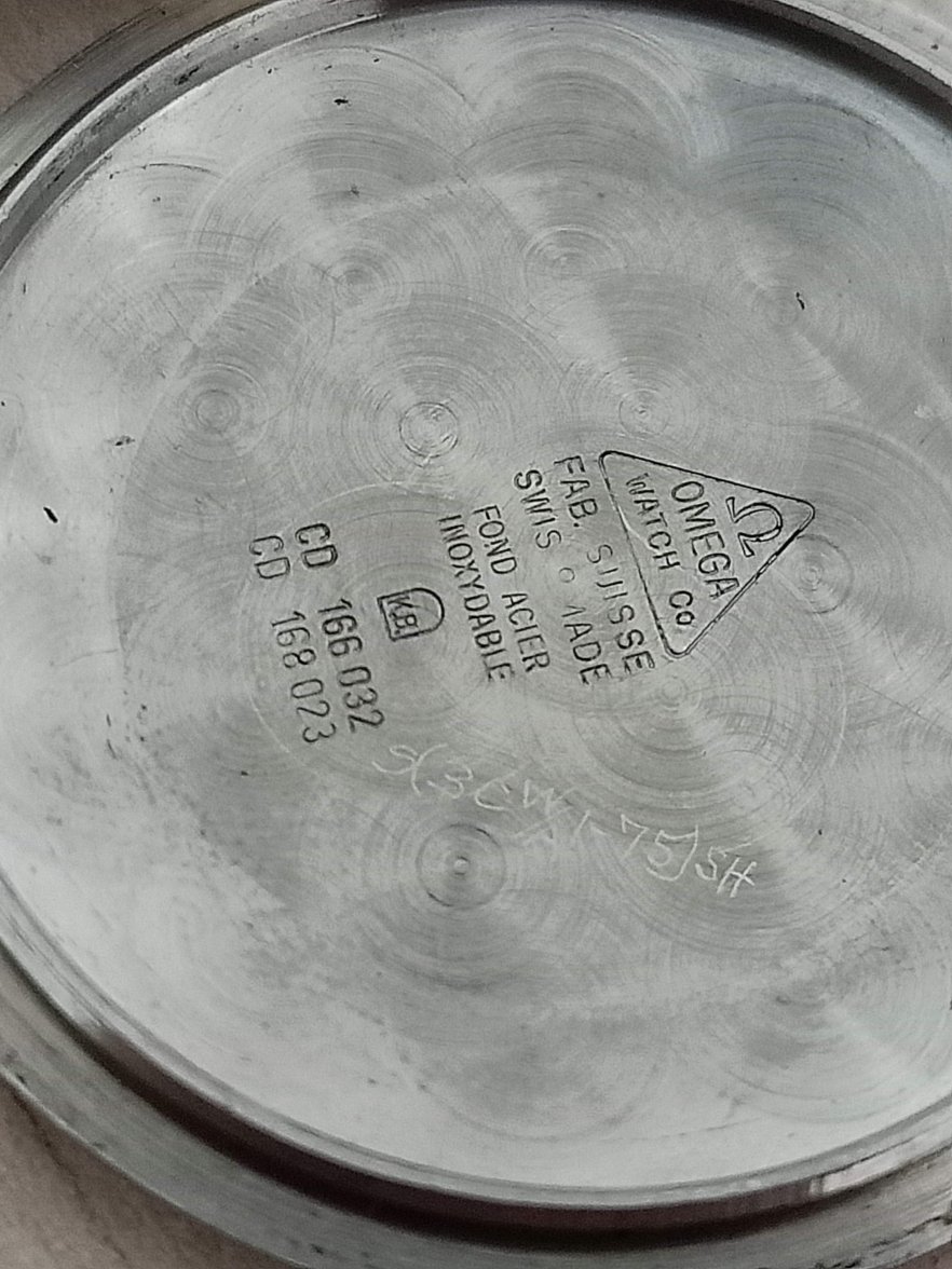

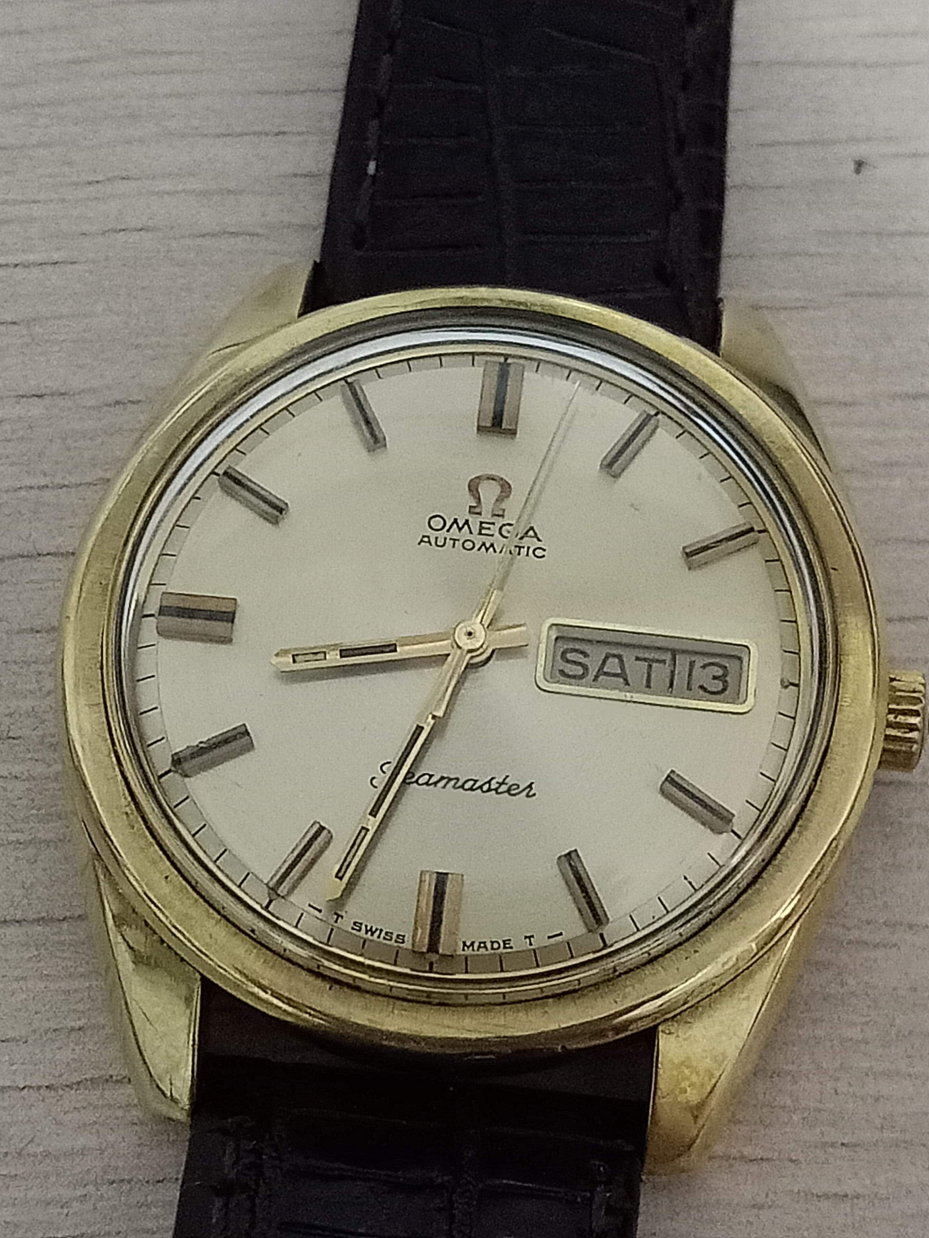

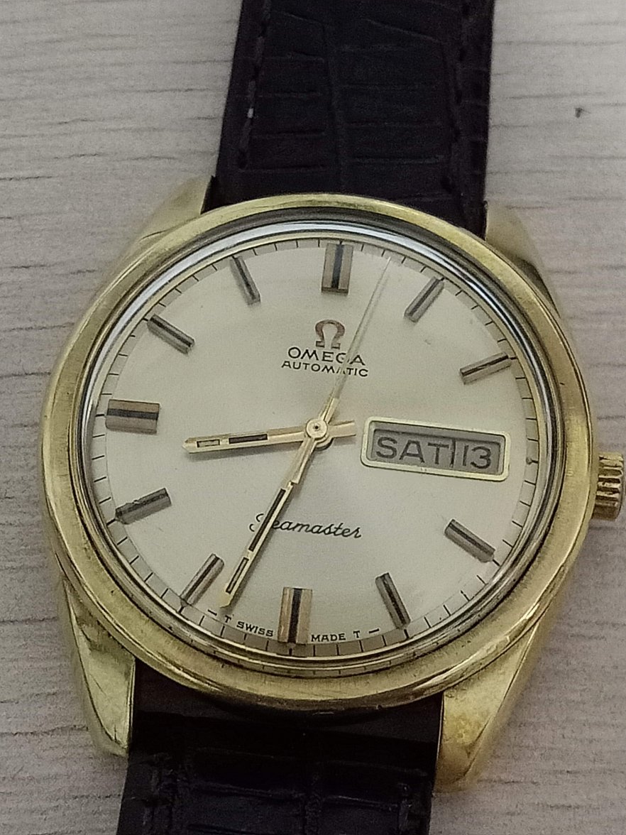

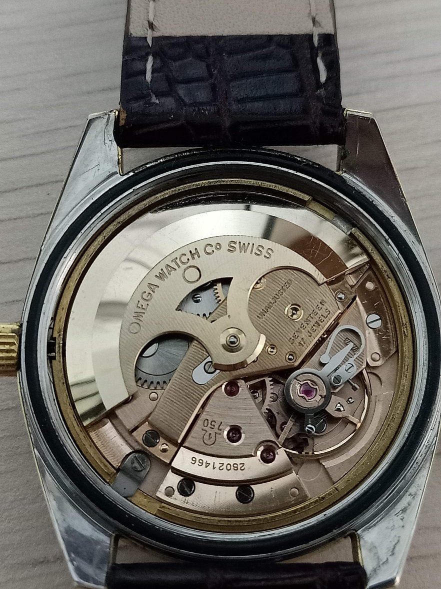

I came across this piece and the seller told me it had a gold jacket. May I ask the ff:
- is the watch legit?
- is the watch redialed?
- what is "gold jacket"? Seller told me this is the reason why he gave me a steep price.
Thank you.
13,493
31,812
Yes, it's genuine.
The dial looks original.
More typically referred to a gold capped, these are stainless steel cases with a heavy layer of gold fused to them. Although preferable to gold-filled or gold-plated they carry absolutely no premium in value and the condition of this one certainly wouldn't carry any premium either.

As stated above, often referred to as gold-capped. IMO, premium over gold plated would be minimal, if any.

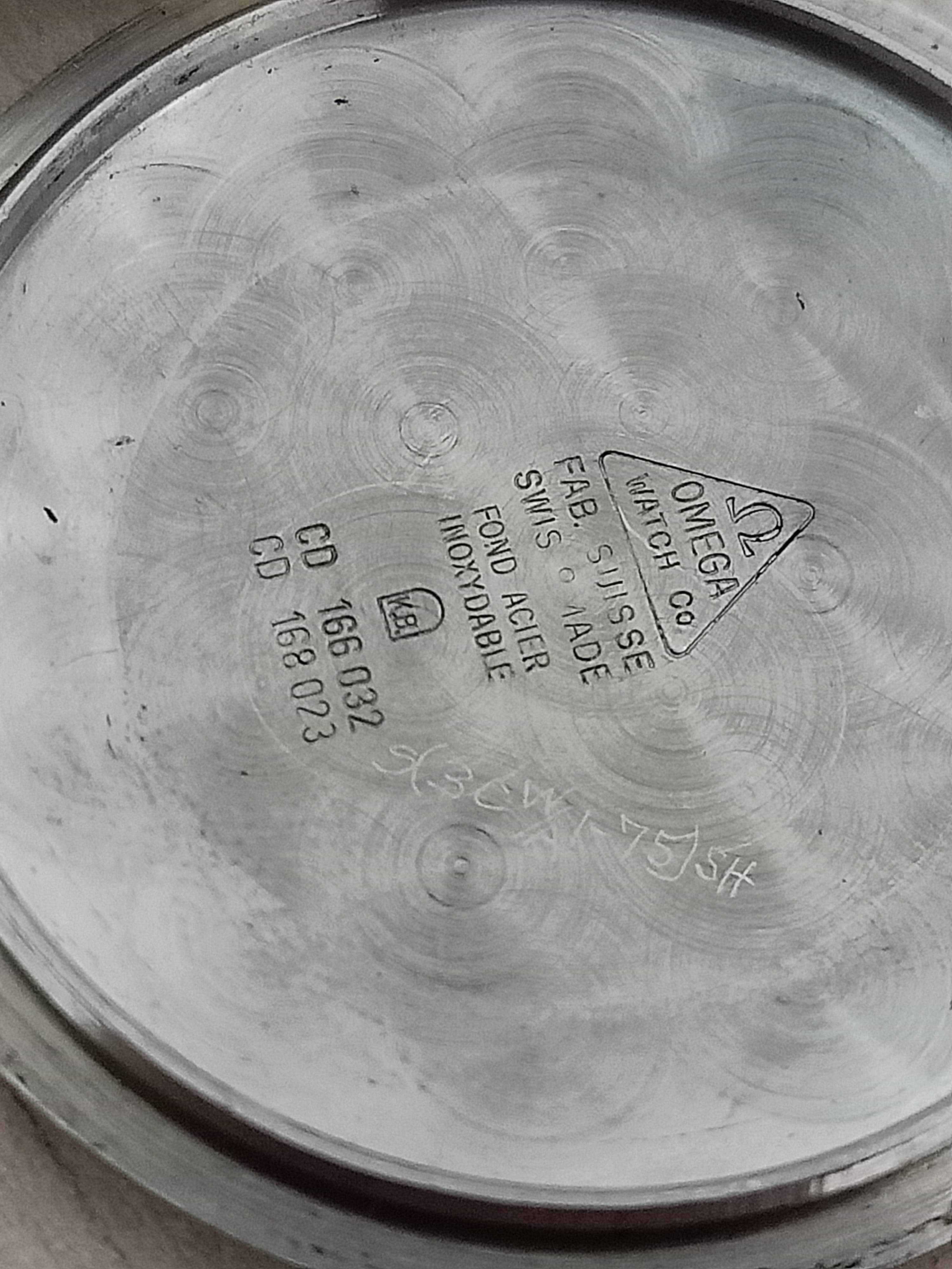

Yep, CD in the reference number stands for "Coiffe d'Or", pretty poetic, eh ?
You can spot them because the back of the lugs is NOT gold colored. I have one and it looks a LOT nicer than any of my otherwise decent looking GF Omegas. In fact it looks like a gold watch, less the weight. As for the premium...
13,676
19,044
Not sure that is correct. For some gold-capped models, Omega used a KO prefix.
Does that mean it was soaked in Coca-Cola?😉😀
Not sure there is any rhyme or reason to those old Omega prefix codes.
gatorcpa
655
348
Well the thing to remember is that all CD watches are definitely Coiffe d'Or/Gold Capped so if by extraordinary CD didn't stand for "Coiffe d'Or" it wouldn't matter anyway.
Now it doesn't mean that Gold Capped models didn't used another reference at some point...and according to this site KO was indeed used by Omega "For watches made until the early 1960s" https://wahawatches.com/how-to-identify-a-vintage-omega-2019/
Something that might be of more interest to the OP is this great document that I came accross again about CD/Gold Capped Omegas : http://users.tpg.com.au/mondodec/GoldCap.pdf

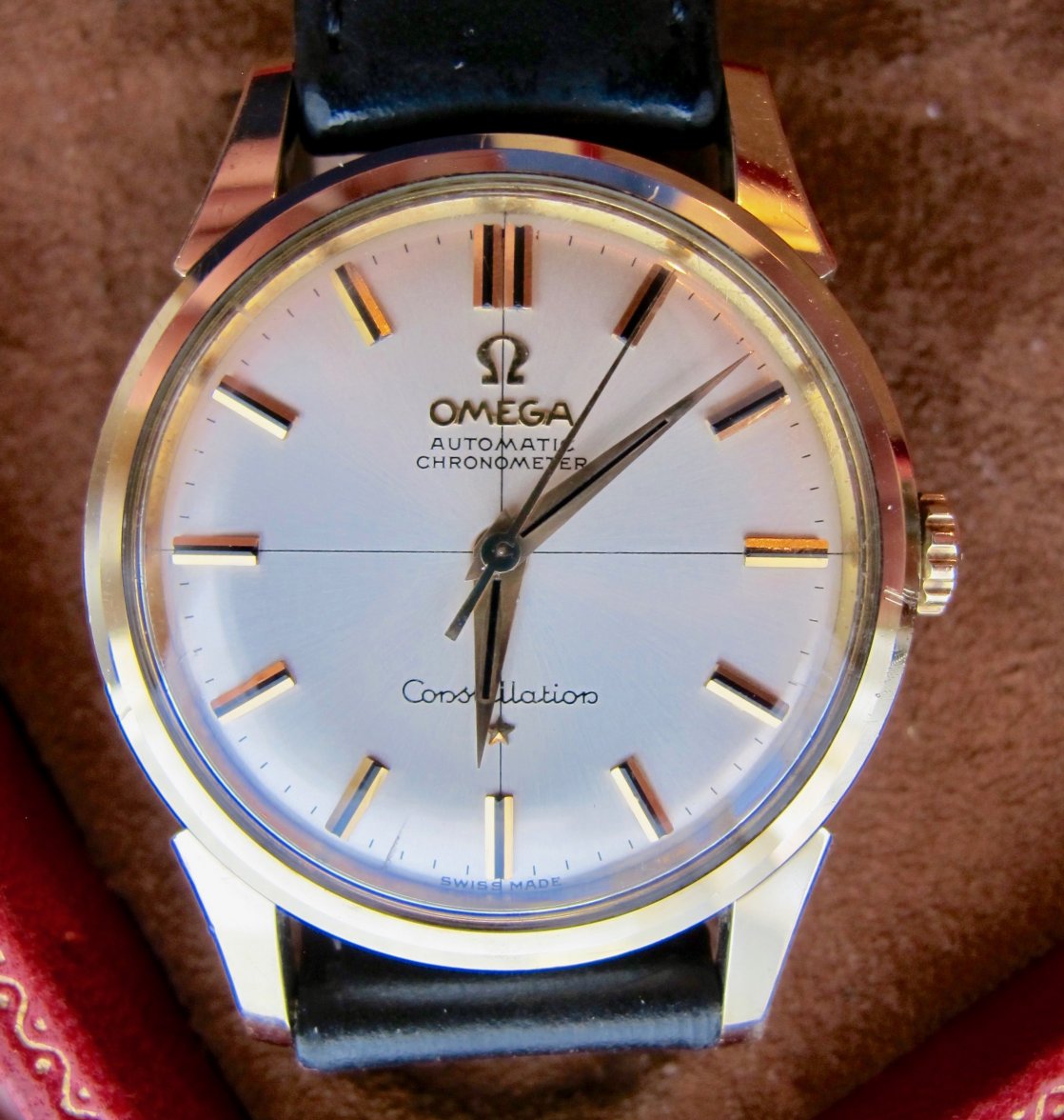

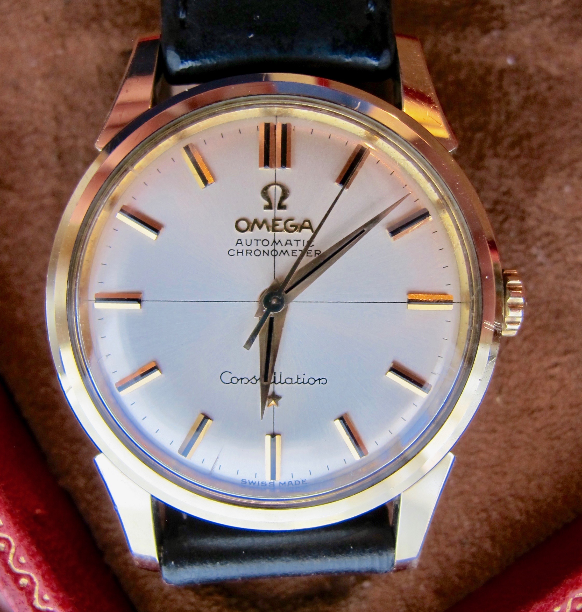

I agree: Desmond's (mondodec) article on gold capping is the best I have found on the topic.
Another point worth noting is that Omega 14K gold capping is exceptionally hard. Last year I bought gold capped 1959 Omega Constellation in beautiful condition, but having applied a hand rubbing with a silver cloth to remove dirt, grease and tiny micro scratches, I found that the micro scratches refuse to come out. Applying the same relatively light rubbing to micro scratches in 18K gold cases works wonders, but the 14K gold capping is much harder, and I have decided to let them be.
You can see what I mean with the micro scratches adjacent to the crown.

Sorry everyone, was unable to indicate prices. It is being sold for $1k
1,501
5,694
For 1k you can get a Constellation, it's really a 300-400$ Watch at best, like @X350 XJR said. Negotiate the price down or search a better example.
188
41
Thanks guys, decided to not push through with the purchase. Was tempted though. Lol
