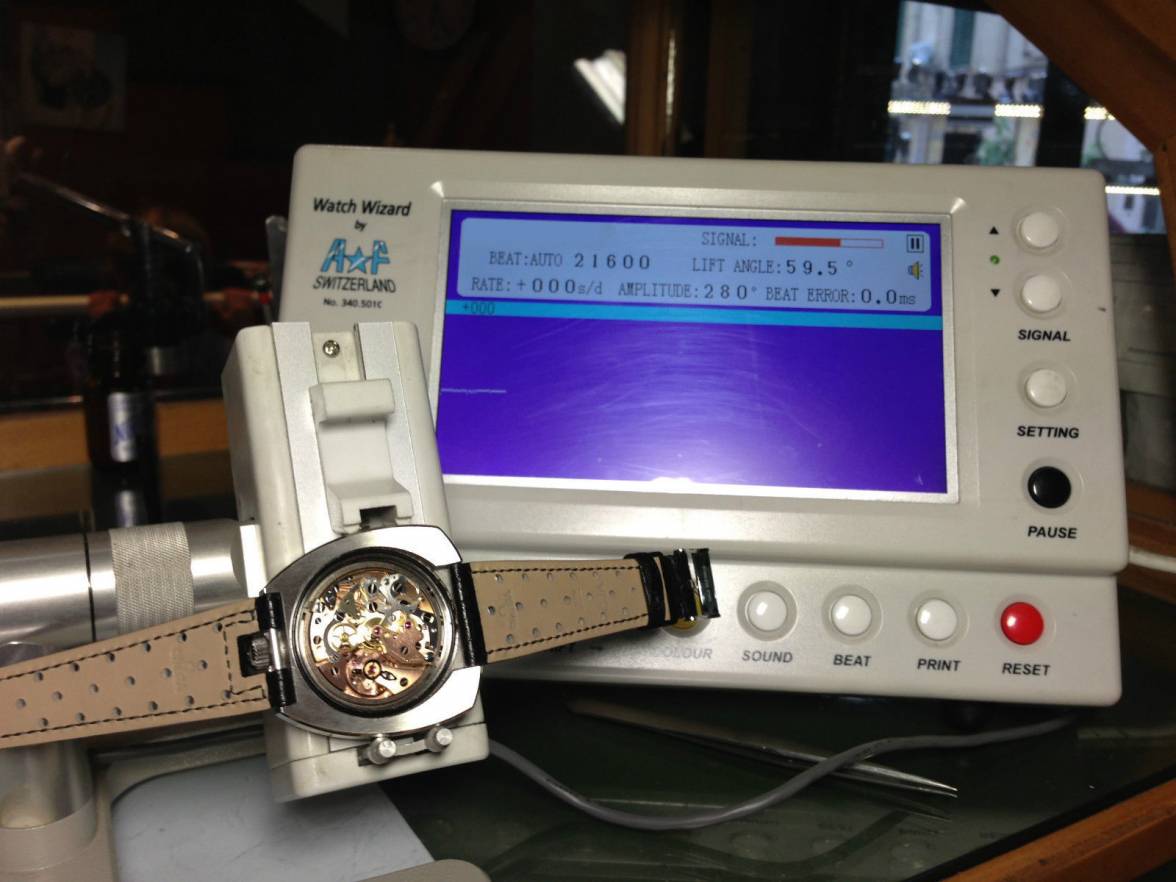

This was quite a timely thread because I saw a Bullhead on eBay, earlier and one of the photos showed a timing machine. What made me think something was amiss was that the machine was showing a really healthy amplitude, but a lift angle of 59.5 degrees. I thought the 930 movement was 860 based - which I know to be 50 degrees - but I was going to search for Al's post where he cited a rule of thumb for correction.
I'm not suggesting that the seller is mis-representing the watch 😗 - after all, 220 would still put it in spec. after 24 hours, but he is overstating the amplitude by about 57 degrees and let's not mention the asking price.

That is an impressive piece of manipulation there... you'd have wonder what else he was fudging...

One thing I learned recently is that there was a special tool for removing the Bullhead's case back. Even stefan had to send his one away to have the back removed - after hearing that, I would want to see a picture of the case back of any Bullhead, that showed a movement shot, on today's newspaper.
Keep in mind the tolerance for the low amplitude would always be measured in a vertical position, not horizontal. The amplitude is always going to be less in a vertical position.
Also, the low end tolerance for an 861 is 180 degrees after 24 hours from full wind...which is quite low....
