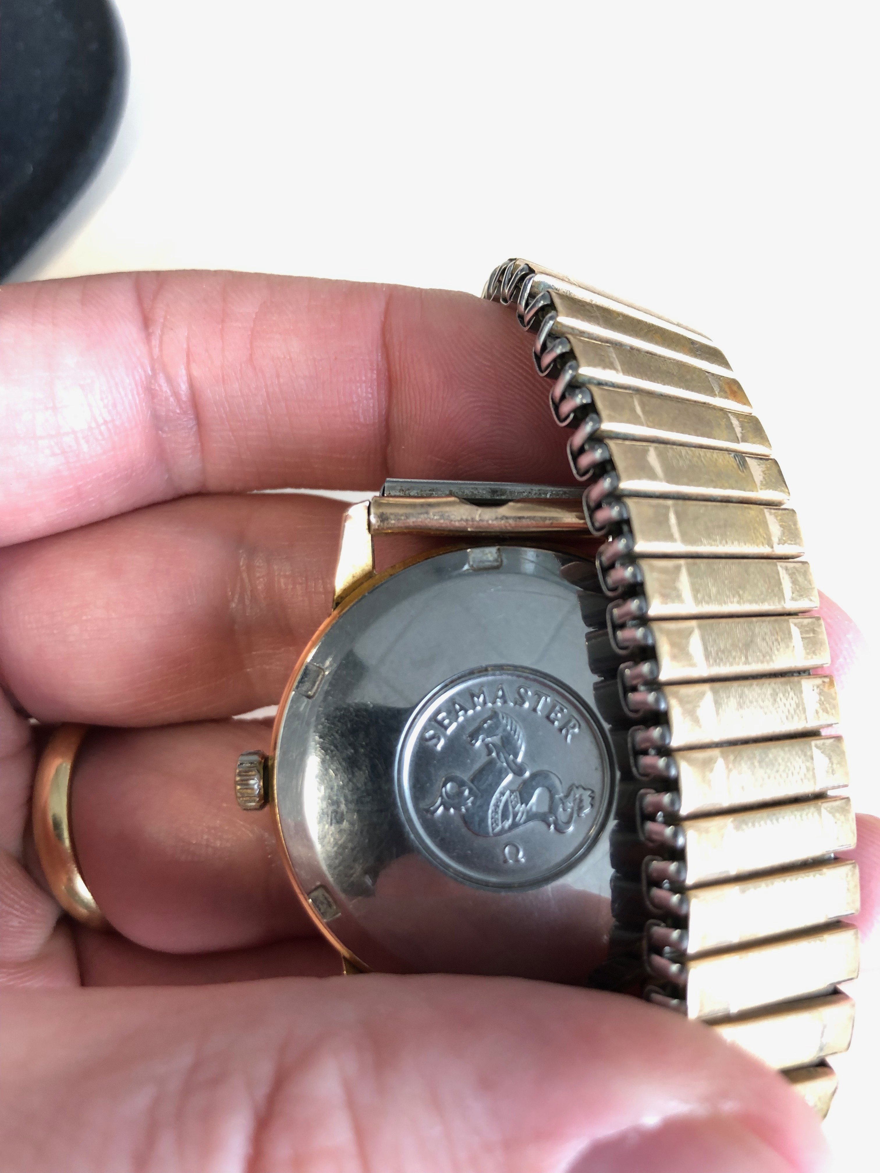

Hello,
I am posting here as I just received a Omega seamaster from my father. it was first owned by my grandfather, this to say that it is quite old I think.
I have few questions:

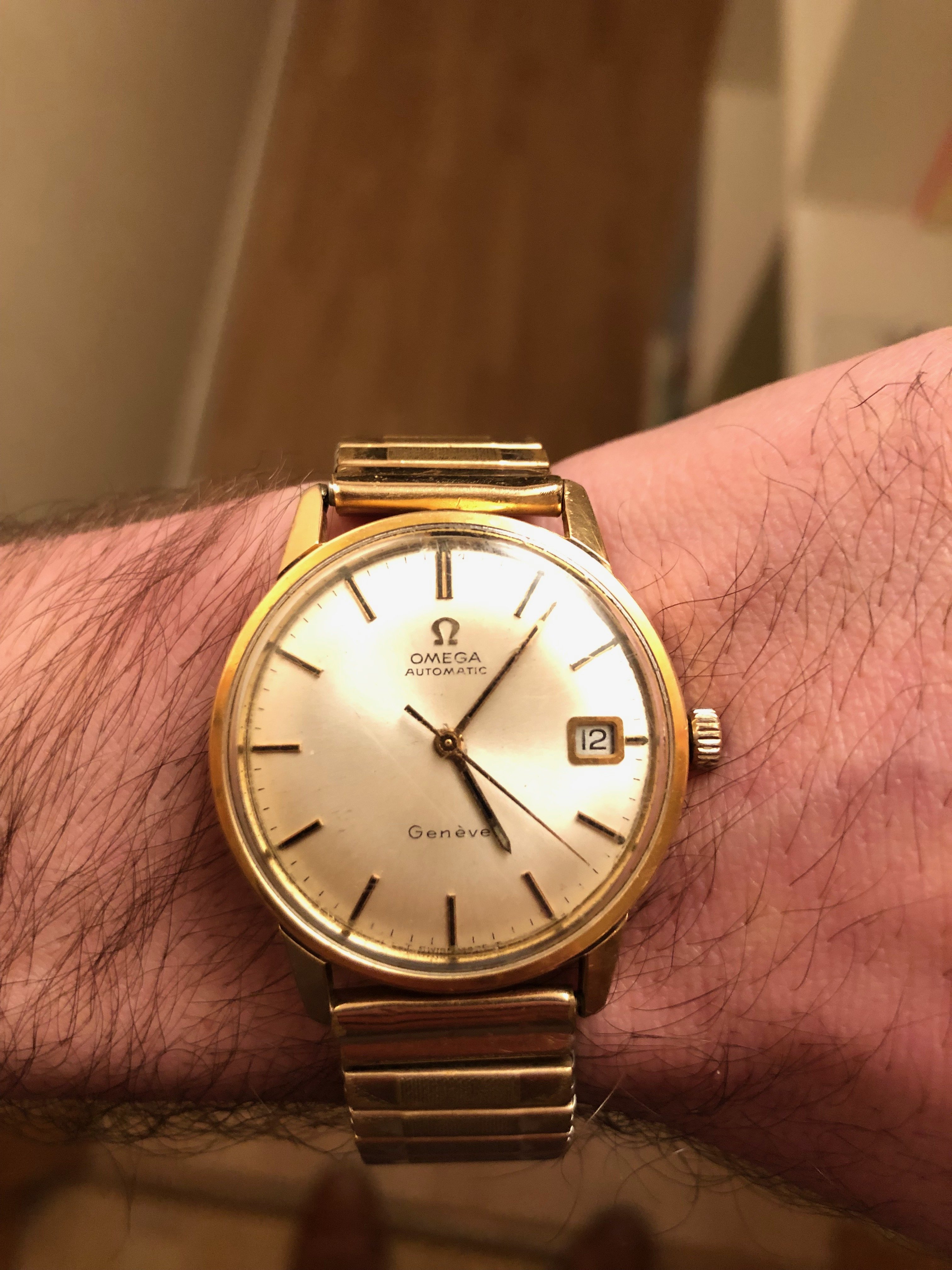

what is the exact reference of this watch?
what is the estimate date of manufacture?

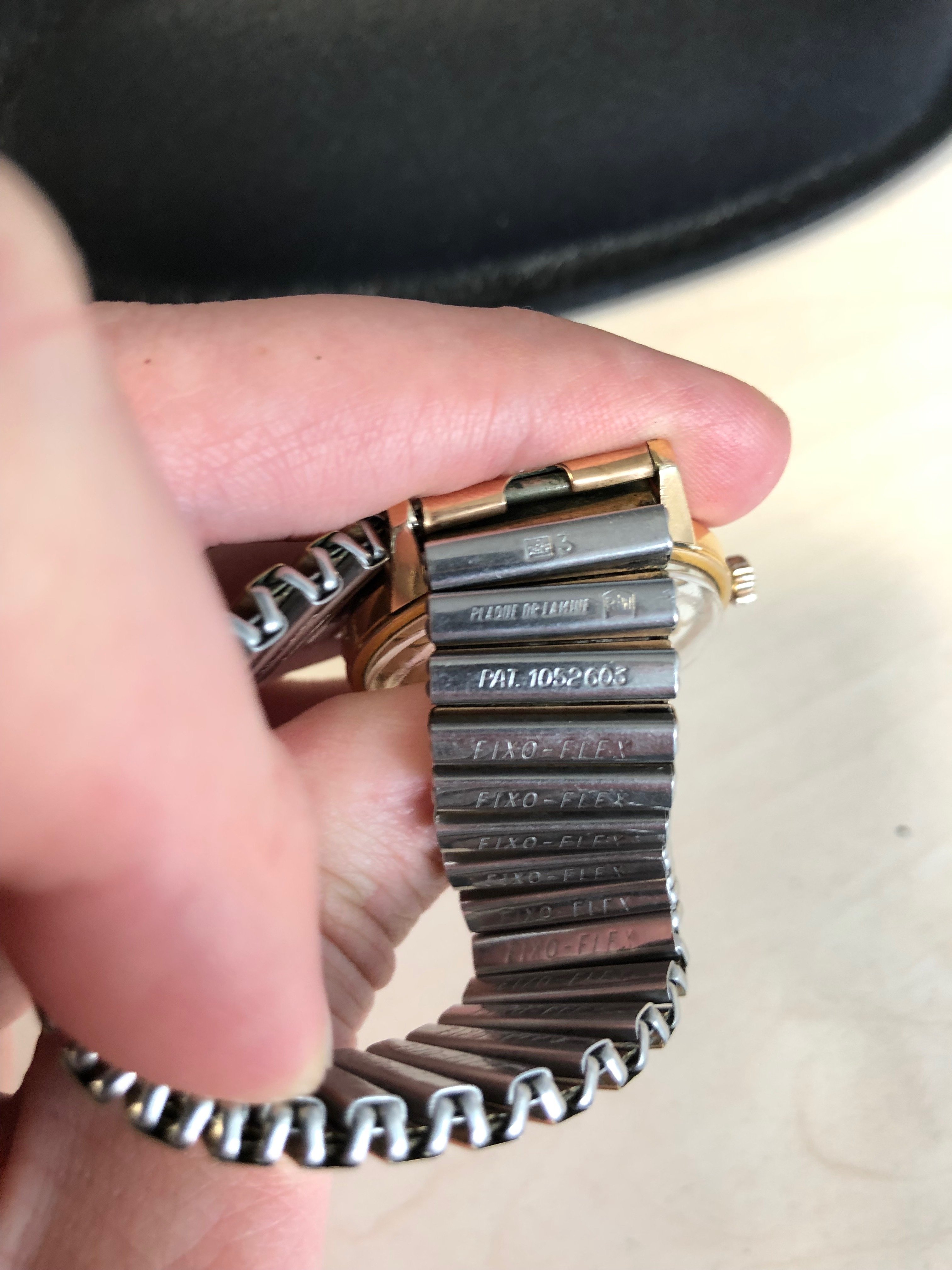

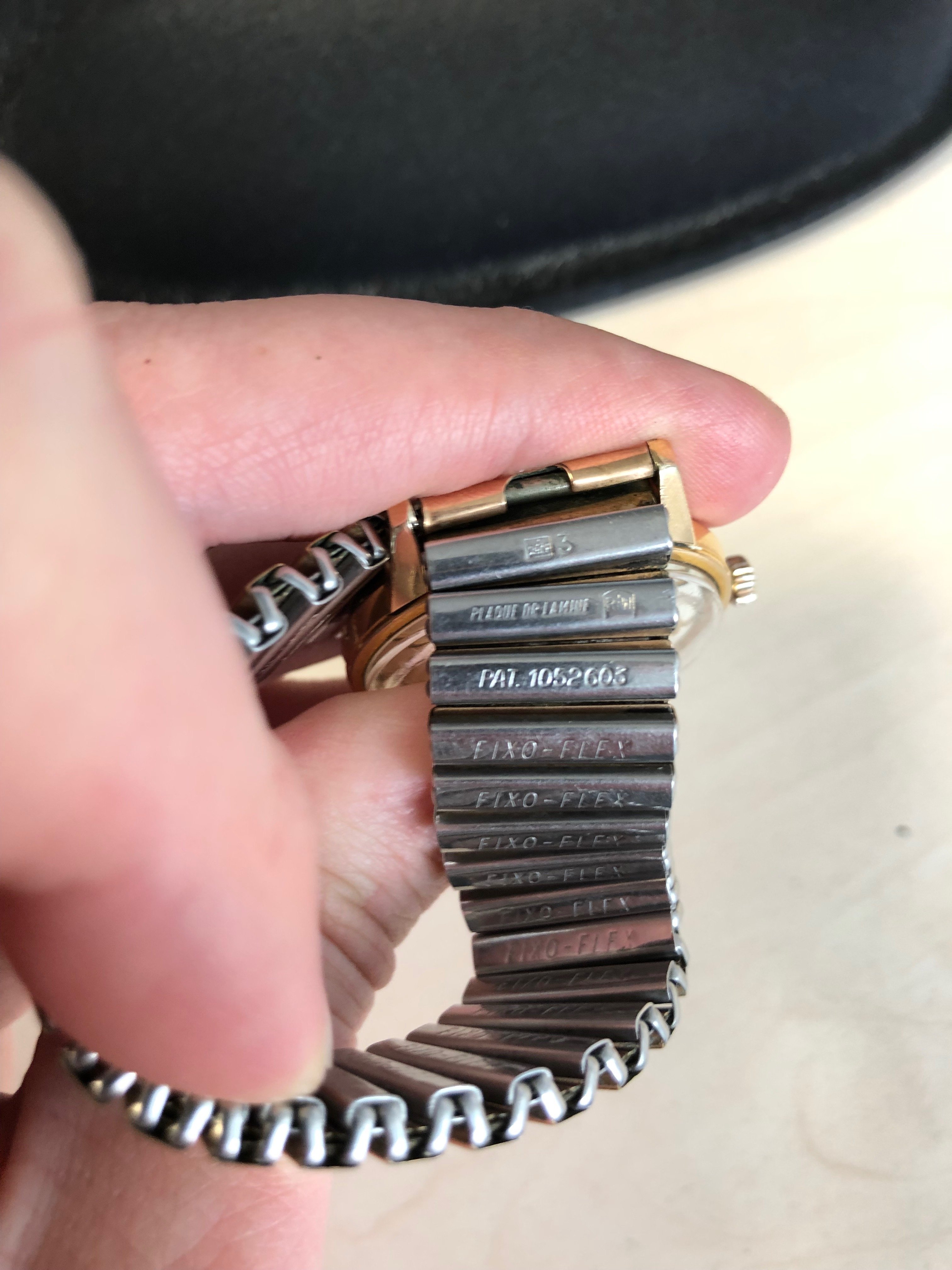

is the watch strap original?
when I try to adjust date I have a strange result:
the crown can be move to 2 position as we see a lot. the first position give me the possibility to adjust time.
I believe the second position is for the date but here is the problem. I can't adjust date by moving the crown whatever the direction.
the date will change only when I move the crown to position 2, it will move up to the next day then if I want to go further I must put back the crown to position 0 then again to position 2 etc....
I have never seen that before, I believe this is not normal but I would like a confirmation.
I attach pictures, I have not opened it yet.
Thank you for your help.
Martin

what is the exact reference of this watch? (Take it to a watchmaker and have them open the caseback - it's engraved on the inside)
what is the estimate date of manufacture? (I estimate 1970)
is the watch strap original? (Probably not)

I have never seen that before, I believe this is not normal but I would like a confirmation. (I think you are doing it wrong, have you tried advancing the time until the date changes then backing up past 9pm and then past midnight?)
I attach pictures, I have not opened it yet. (Don't try to open it, take it to a watchmaker unless you like really marked up casebacks)

A lot of vintage omega's had a fixoflex bracelet. Possible the bracelet was bought original together with the watch but it's not omega.
Maybe it has a caliber 565 inside with a quick set function. Pull and push to change date.

I think I need to service it anyway as now I can't anymore change the date and when I try to adjust the time it will block me when I reach 10pm10. I think it is related to the date disk that is most probably damaged and this is why I have a strange result when I put the crown in position 2.
@Shabbaz so it does exist this option of pull and push to change the date?
Thanks
2,219
4,955
As @Shabbaz says, the push/pull is a feature of the 565 (and some other calibres). These instructions all relate to the 565, for the men's watches:
http://www.old-omegas.com/sea71-565.html
If I understood your explanation, you weren't getting a strange result but it needs a service so, any issues should be resolved then.
