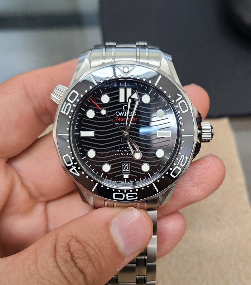

I am new to the forum and new to luxury watches and mechanical.
I recently purchased a brand new omega seamaster from local AD.
I have noticed the date seems a little bit off centered... it looks like its leaning more the left. on single digit date 1-9 seems a bit more noticeable than on double digit numbers.
this is very minor and might be consider normal. I am not sure but want to ask the more experience watch experts here.
hopefully someone can share a picture of their seamaster to compare?
your thoughts?
Thanks in advance

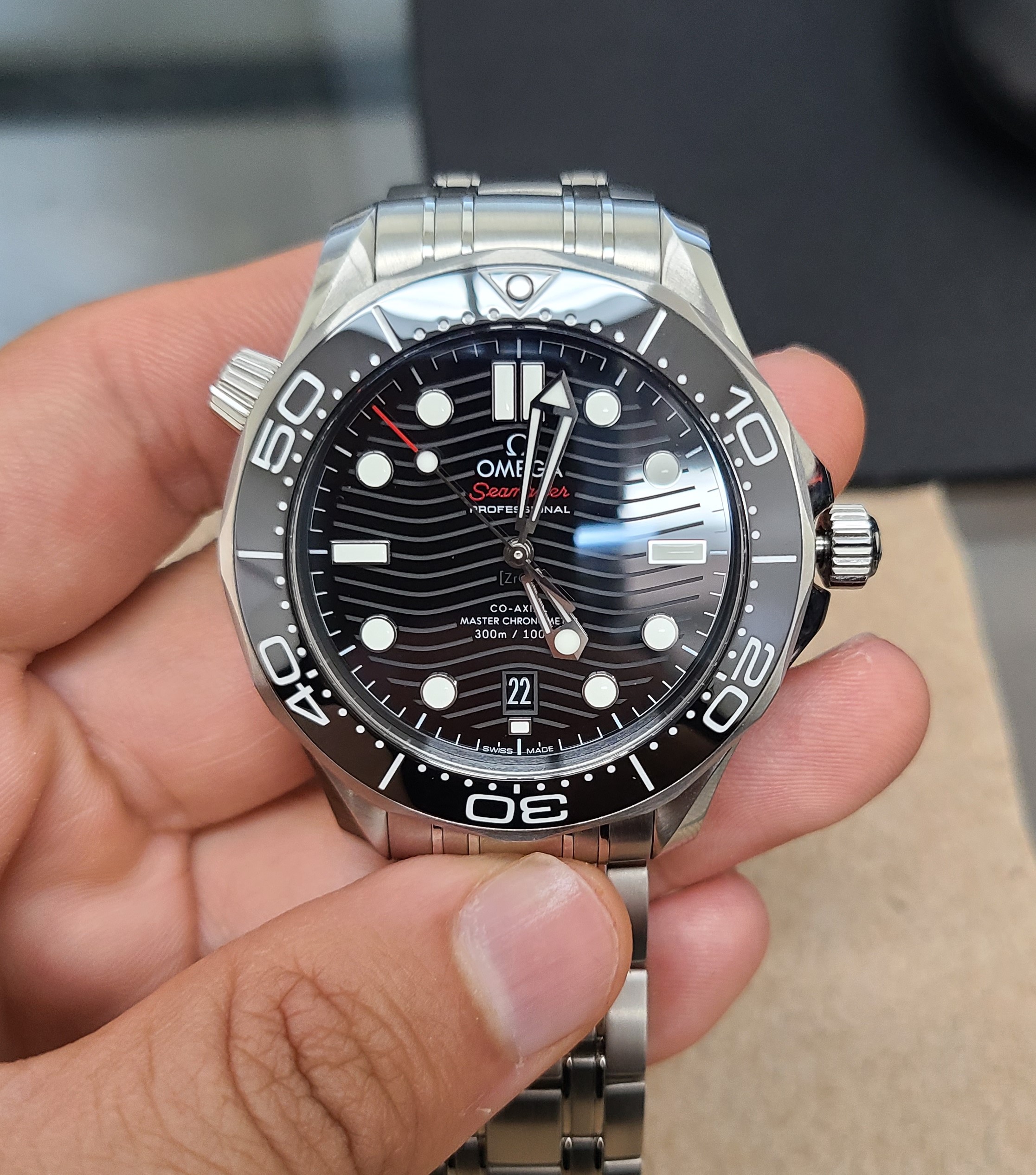

Could you share some pictures of the date being a number that is flat at the bottom? That should be the easiest way to tell. If its the 2nd and the bottom of the 2 isn't horizontal then its not centered. Also I'm not sure if this model has an instant date change but if its after 10PM it could be slowly creeping to the next day.
8
5
Here is a picture with date 22. The date seems to be maybe 1 or 2 millimetres towards the left. very minor and less noticeable on 2 digit dates
362
563
Yes, it’s left justified. If you’re happy then that’s fine. Personally, I’d not be happy with it, certainly not after spending several thousand $/£/€ etc on it. I’d return it and ask for another.

I had the exact same problem and it did bother me. Was sent back to Omega and was fixed. They had to recenter the dial through the screws on the movement.

Translation - they had to bend the dial feet to center the dial properly.
There are tolerances for how centered the date is supposed to be in the date window, but they all reference date windows that are at 3 o'clock, so the tolerances are a little difficult to translate easily into a date window at 6.
Essentially for a date at 3, there is a gap around the digit on the date indicator - ideally you would want that gap split evenly between the top and bottom of the digit in the window, as that would be centered. Omega allows deviation of 1/3 of the gap on one side and 2/3 on the other, so not quite centered.
With the date at 6, this would become the gap at the sides of the date, rather than at top and bottom. Not sure if this tolerance translates directly or not.

Swatch Group Greece and Switzerland both told me that the date position was out of spec. Funny thing is that i have seen this issue in dozens of the new generation SMPs... I think there is something wrong with the design in this model.

Like I said, I don't know how they are using the tolerance for the date at 6, since it's meant to be read for a date at 3. If you were to use it for the width of the gap on each side, then yes this is out of spec. I just can't say for sure that's how they are using it.
I don't think there is any design defect, but as you can see the clearance between the inside of the date window and the numbers on the date indicator is very small. This means they have to pay very close attention to how the dial is centered on the movement for it to line up properly, and not look crowded.
If you look at how the date is centered on the OP's watch in the last photo he posted, but look at the vertical spacing, you will see it is shifted high in the date window, but no one is complaining about that, because there is more space there and even when it's not 100% centered, it doesn't look crowded. If they wanted to make life easier, they could widen the date window in the dial slightly, but you can't do this too much or you will see other dates...

I agree. I also DID notice the shifting of the date upwards when it came to double digits on my own watch too. This guy is having the exact same issue i did.

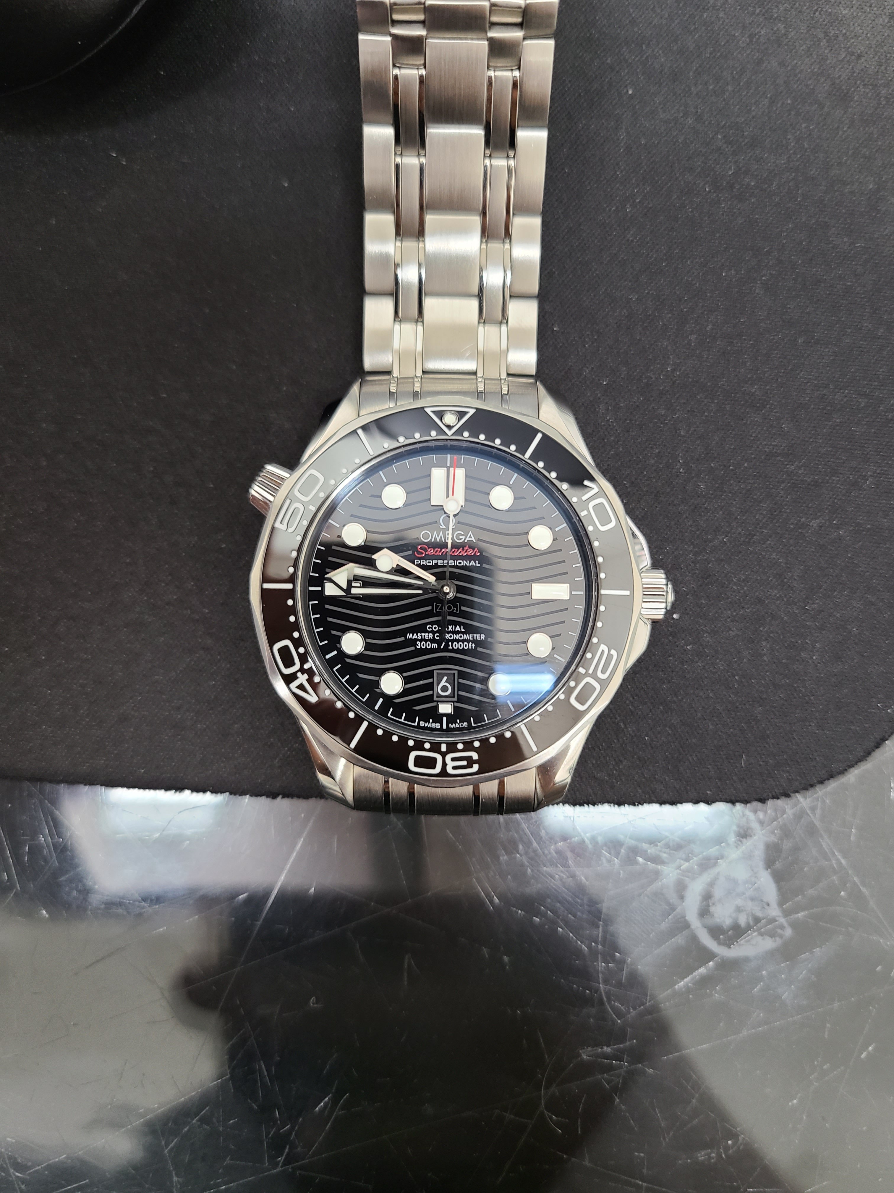

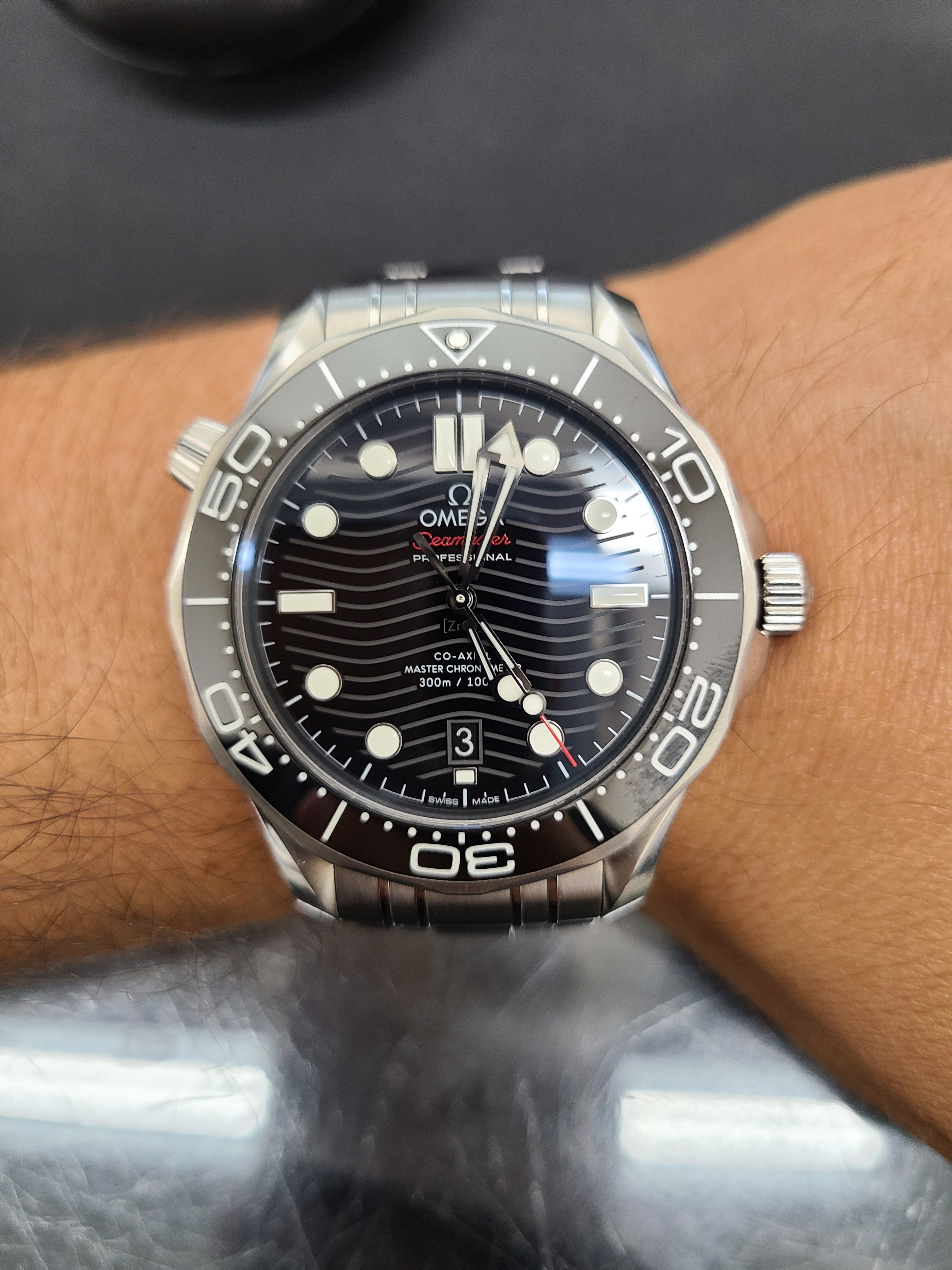

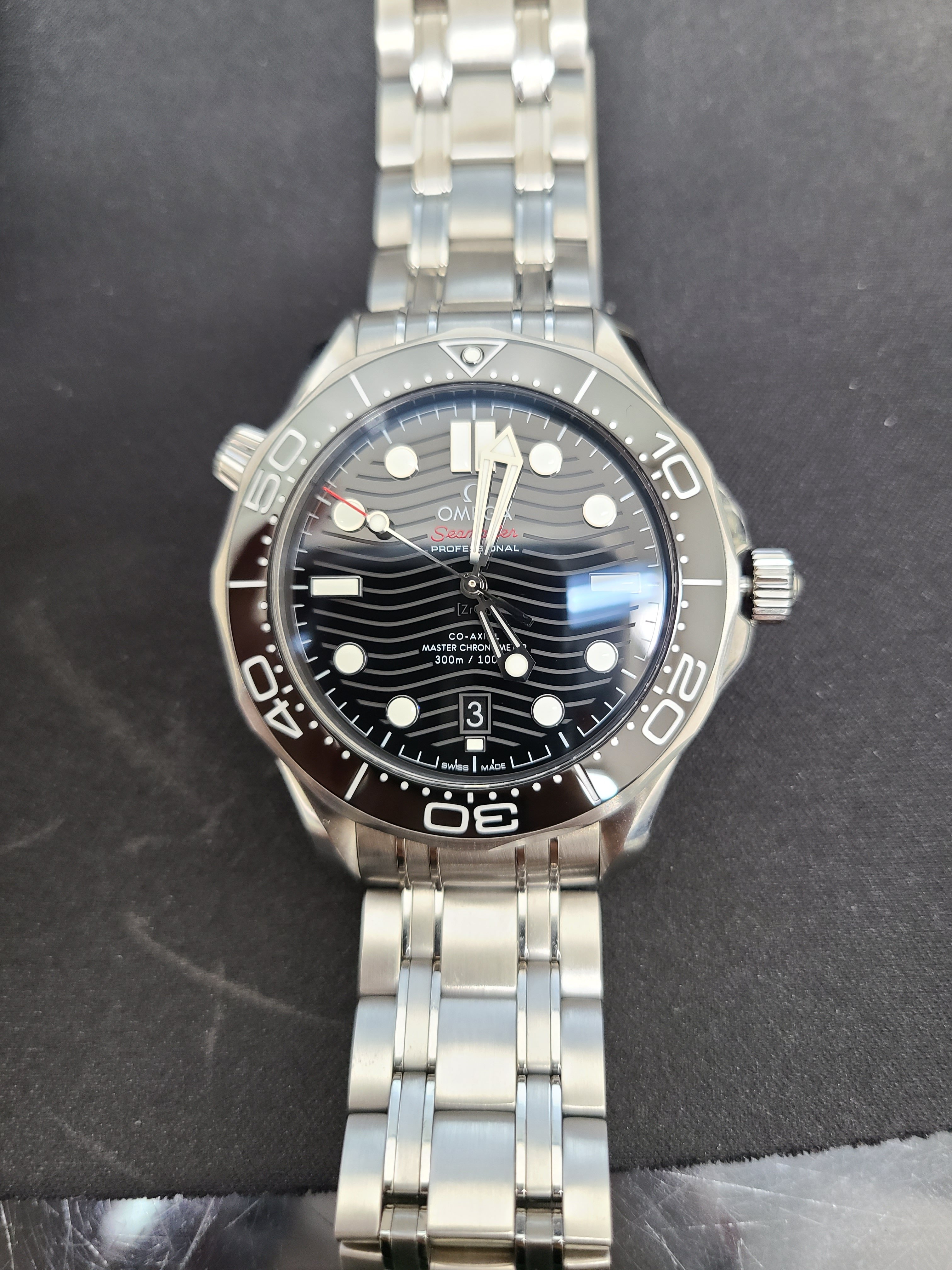

Thank you all for your feed back. @Archer I have attached some pictures with date set to 3. Surprisingly it almost looks perfect. Maybe 1 mi millimetre to the left. Let me know your thoughts
Although you didn't ask me I can answer this, @Archer was talking about the location of the date window on the dial at 3 o'clock not the date itself.
Oh... I get it now. he meant at 3 hour date position instead of 6hr date position. Got ya. Thank you for clarifying. I am a noob 😀

It looks like the date line’s up with the bezel perfectly. But the dial needs moving 1m to the left.
